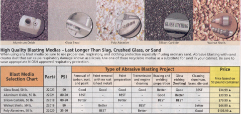

Eastwoods has a nice little chart that shows the types of projects you might need to use the abrasives on, and which ones are good, better and best for each as well as the recommended pressures for each.
Don't know if it is on their webs-site or not, if not, I'll try to scan it so you can get an idea of which media is good for what.
Here's the chart. I couldn't find it on their web-site so I scanned it out of their newest catalog.
