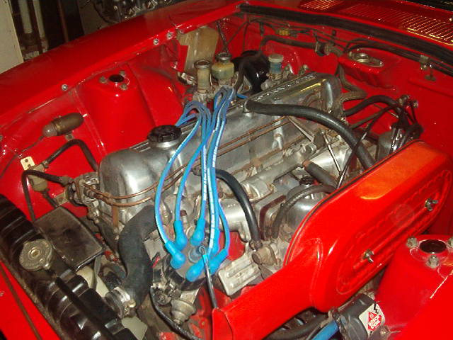

At the moment I think a picture is a 1000 words as im in a hurry and will disect what you just wrote later bruce.
Here is a shot of my engine don't know if that help much.

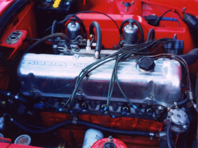

I had a set of British SU carbs on one of my z's I will take a photo of them to show you I don't know much about em' just they were not as good for tuning and seemed to not stay in good tune.
