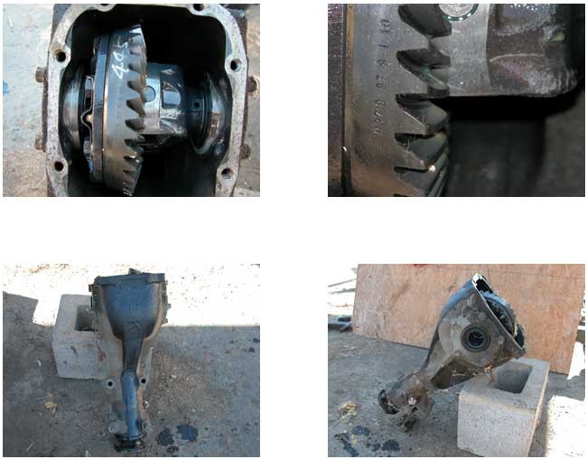

Looks like one to me too, but you might have to use the 280 output shafts with the clips in it and not the bolt in ones from the 240...unless it's been converted to the bolt in ones already. If it came out of a 78 it probably needs the 280 style.:ermm:
