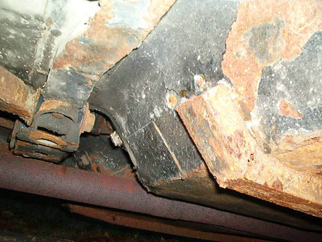

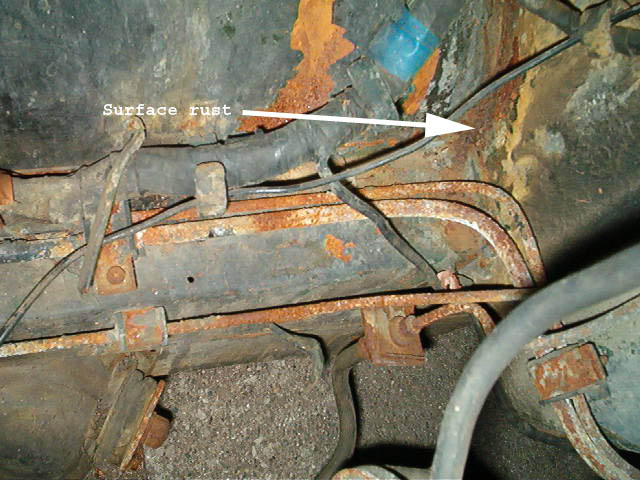

Yup, that's the kind of stuff I've asked him for. He actually has now responded with a little of the info. Near Battery tray:
https://www.classiczcars.com/forums/topic/8499-opinions/#findComment-54158
From a California point of view, I say....... Uggh. IMO looks like Stage 2 cancer. Not fatal yet, but it needs to go under the knife for ANY chance of survival.:(
