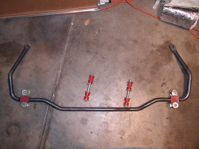

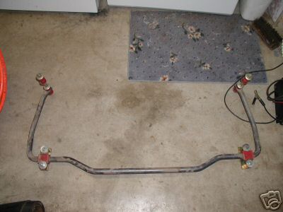

The one labled as front "looks" like an after-market one for a 240Z. As large diameter as it appears, I would modify the mounts as bars this big tend to wreck havoc with the front frame rails. These big bars transmit so much force to the frame rails that the rails eventually rip open. Not a good thing to have happen to your car! :cry:
Not so sure about the rear one, though if it is for a 240Z, it is the type that some of us don't like to use because it would require drilling holes in the chassis to mount.

The one labeled front is huge! It's 1 1/8" dia. So it would not be recommended to use something this large. Ok, I have not bought it yet and now will not. What is the largest recommended size 1" or what?
The one labeled rear is also one I'm looking at buying. It is claimed to be from MSA. Is theirs the one that you have to drill to install? If so then what is the recommended one for the rear?

Whoa, didn't say that the front one is not reccomended, just that to ensure that your frame rails don't get ripped apart you need to modify the mounting. A 1" bar will do the same thing. I would not use anything larger that stock without modifying the mounts. Even a 1" bar is pretty stiff.
Regarding the rear bar, YES the MSA bar is the kind that many folks don't like to use. The preferred type mounts to the brackets that Rear suspension is mounted to. (Flat metal brackets that hang down on either side of the diff.) The sway bars come with a bracket that replaces the stock ones. I believe that Suspension Techniques is one company that sells that type. I bought mine so long ago that I don't remember what brand it is.

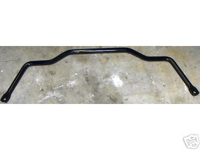

Update!! The seller just sent me the correct pic of the rear sway bar, the one above is incorrect (it is of the front that he no longer has). Here is the correct pic for the rear sway bar. Still the MSA model.

If you buy and use that rear bar, be sure to scrap the provided hardware. The bolts are too short and grade 5 (!), Needs locking hardware and much larger washers to spread the load.
Here's the install on my car with Grade 8 and BIG fender washers
