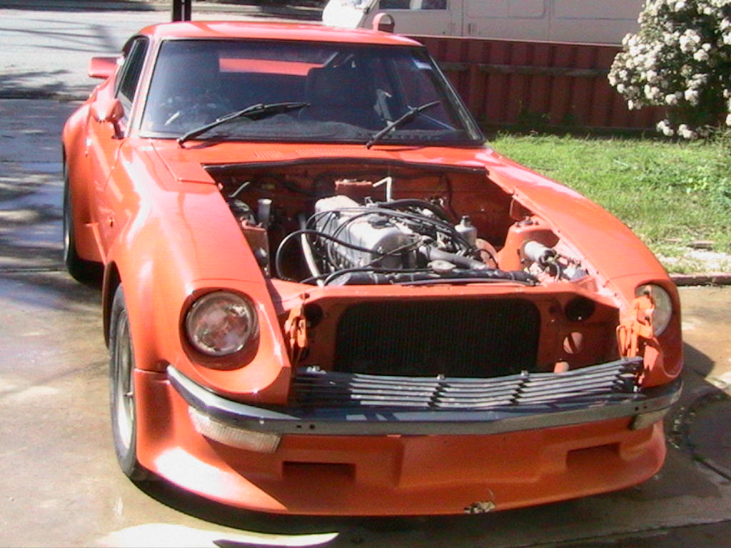

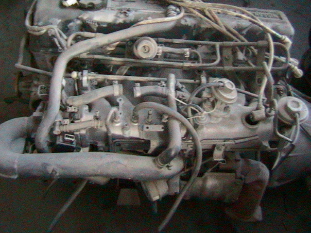

I have uploaded some pictures of my Zed. Taken a few
of the engine block of the L28ET can you tell me anything
about it. Is it an orginal Turbo block? Or has it been built?
N42 9402A is what is stamped on the block I know
we do not have too many here in Aus as they only sold non
turbo here. Imports and custom made I quess is all we have.

Hi Sam,
I'm located in the southern suburbs. We should hook-up at some stage & have a look at your car.
I await the approval of your gallery sumissions & will have a close look at what you post there.
The N42 block is the 1st-generation L28 casting, with the F54 being the 2nd-generation block, used from around 1982 onwards.
I don't want to comment on your engine without seeing some shots
:classic:
BUT, converting/building an L-turbo is a piece of cake!
I was of the beleif that the F54 block was the turbo block along with the P90 head.
The N42 block and head were the NA L28 combo.
Not that there is too much difference in the blocks mind you aside from the slight strengthening....

Kinda, but it's a bit more murky than that.
The earliest 280ZXT's actually ran the N42 block & head (the automatic '81's)
When the BW T5 gearbox was sourced for the manual 280ZXT in '82 the F54/P90 combo was also available.
Late 280ZX's & Patrols here in Australia have F54 blocks & I believe that some of the patrols have P90 heads. I have no idea what car my P90 came from, but it was locally delivered.
With suitable chamber mods (or lower-comp pistons), a stock N42/N42 L28E can be force-fed without dramas up to around 300HP.
How does 170kW's @15psi on LPG sound from an internally stock L28?
