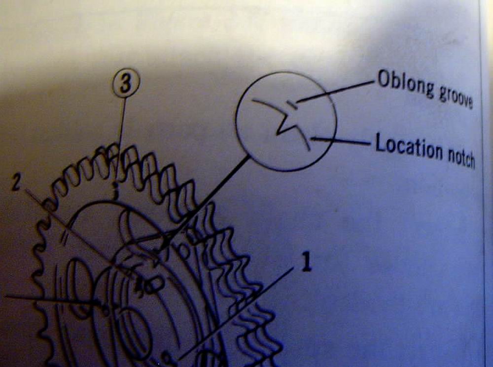

After inspecting the oblong groove and location notch, I have been putting the groove dead center in the notch in the cam, not to the left of the notch.....
See the attached photo, I did get it to lline up like this, that would tell me that with the notch dead center of the groove would make it off about a tooth and the timing would be a mess cam wise...
Agree? And is the photo correct with the notch to the left?
Thanks!
