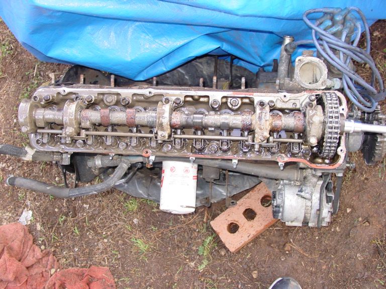

While we are on the topic of heads, why would there be a corner of a head gasket missing???

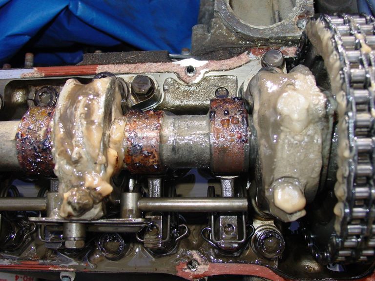

It did wacky stuff to the oil
It has some weird properties, where the jello covered well it stopped rust, but the cam has some rust issues. grr
Me thinks the name of the photo should apply to the cam!
Head may be OK
Yeah the head may be alright (but it would need a slight shave) its a freshly rebuilt head and engine (less than 20,000k's ago), and seems to have been put together missing a big corner of the headgasket. The company who did it for the previous owner, not naming any names seems shonky, there were far too many nonmetric bolts on it for my liking :mad:
Yep thats what happens when you mix oil and water
