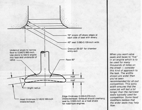

Actually it's a 3 ANGLE Valve Job. What that means is that the sealing surface of the individual valves and their corresponding Valve Seats (in the head itself) are ground to 3 separate, different angle's instead of just one angle. This results in a better seal as the valves close. This keeps the power generated by combustion inside the cylinder where the power can be applied to the crankshaft (engine output power) instead of possibly leaking through the valve seats back to the intake manifold or to the exhaust manifold before the valves are opened via the camshaft, & rocker arms.
HTH, Carl
It makes a good bit of difference to the engine (I imagine) since that is what the factory manual specifys.
