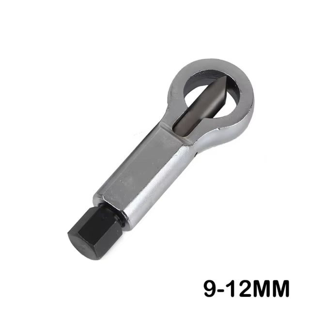

Posted 19 hours ago19 hr comment_677663 Nut breaker if it attracts wives or girlfriends?Imagnaryto🔥Last Day 49% OFF - 🛠️Nut Breaker Pliers - 9-12 mm❤️TIPS: All goods are authentic, with genuine patents, counterfeit must be investigated! Customers, please identify our products! SHIPPING WORLDWIDE. 💯Payments Via PayPal® and CreditCard.⭐F... Link to comment https://www.classiczcars.com/forums/topic/69480-this-is-cool-if-it-works-found-on-fb/ Share on other sites More sharing options...
5 hours ago5 hr comment_677679 I've had one of those in my toolbox for years and, yes, it does work. However, if the base of the nut is flush with face of the part it secures, the chisel point will tend to climb up the side of the nut when you start applying torque to the drive bolt. That means that part of the upper part of the nut gets split first, while the lower part hasn't quite separated. If you're lucky the nut will pop, even though it hasn't been completely split.Remember that you'll need adequate clearance in all directions to make the splitter fit, as well as enough room to get a wrench or socket on the drive bolt. That makes the splitter useless for recessed or restricted-access nuts. For example, it'll work great on the top nut on the front anti-roll bar link, but it won't work for the nuts used in some locations to secure the intake/exhaust manifold. Link to comment https://www.classiczcars.com/forums/topic/69480-this-is-cool-if-it-works-found-on-fb/#findComment-677679 Share on other sites More sharing options...
