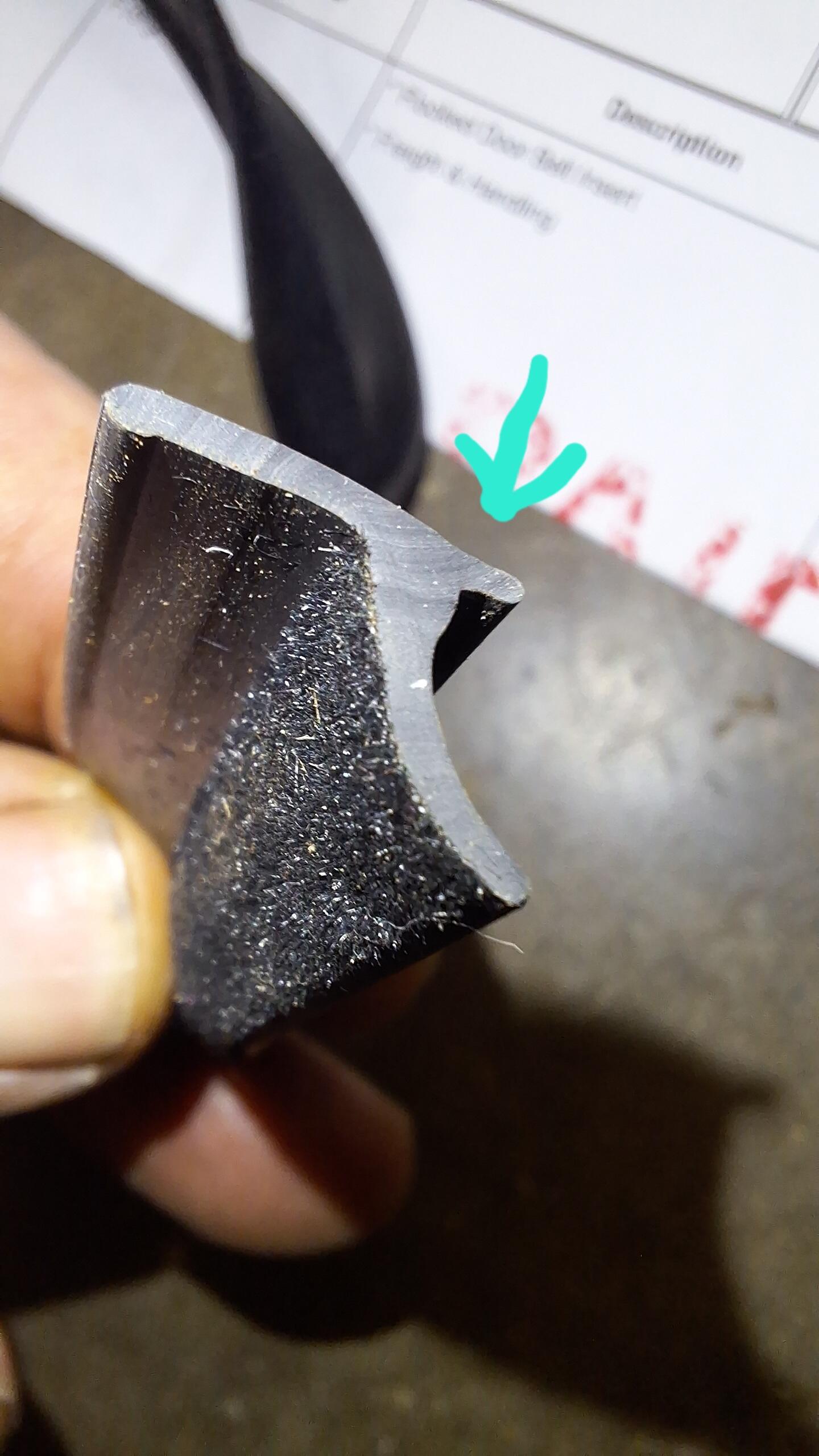

For some reason, I can't locate my pictures of this, but the hardest part was finding the rubber. It's in Australia somewhere. Lol, sorry but I also misplaced my receipt. Edit: It's called "Old Auto Rubber" Update: Found it! Here's the part number, the old rubber, haha and the new one. I took a razor blade and sliced off this protrusion all the way along. Now it matches real close.
Okay, get a dremel tool and grind or sand the staple folds or if the heads of the staples holding the rubber are showing, I took a small cutoff wheel and ground the heads of the staples off so the rest of the staple can be pushed through. Remove the old rubber strip. Then I had some T-50 staples, I took the same cutoff wheel and made them the correct length, even pointed the ends. I cut my rubber strip to length, held it in place and I believe I took a small drill bit and going through the staple hole in the stainless moulding, drilled through ther rubber. After installing that staple, and crimping it over with small pliers, I continued that process until all the staples were replaced. I remember in the YouTube Video I saw, he used rivets. I thought they would stick out too far, so I went like the original, with staples.

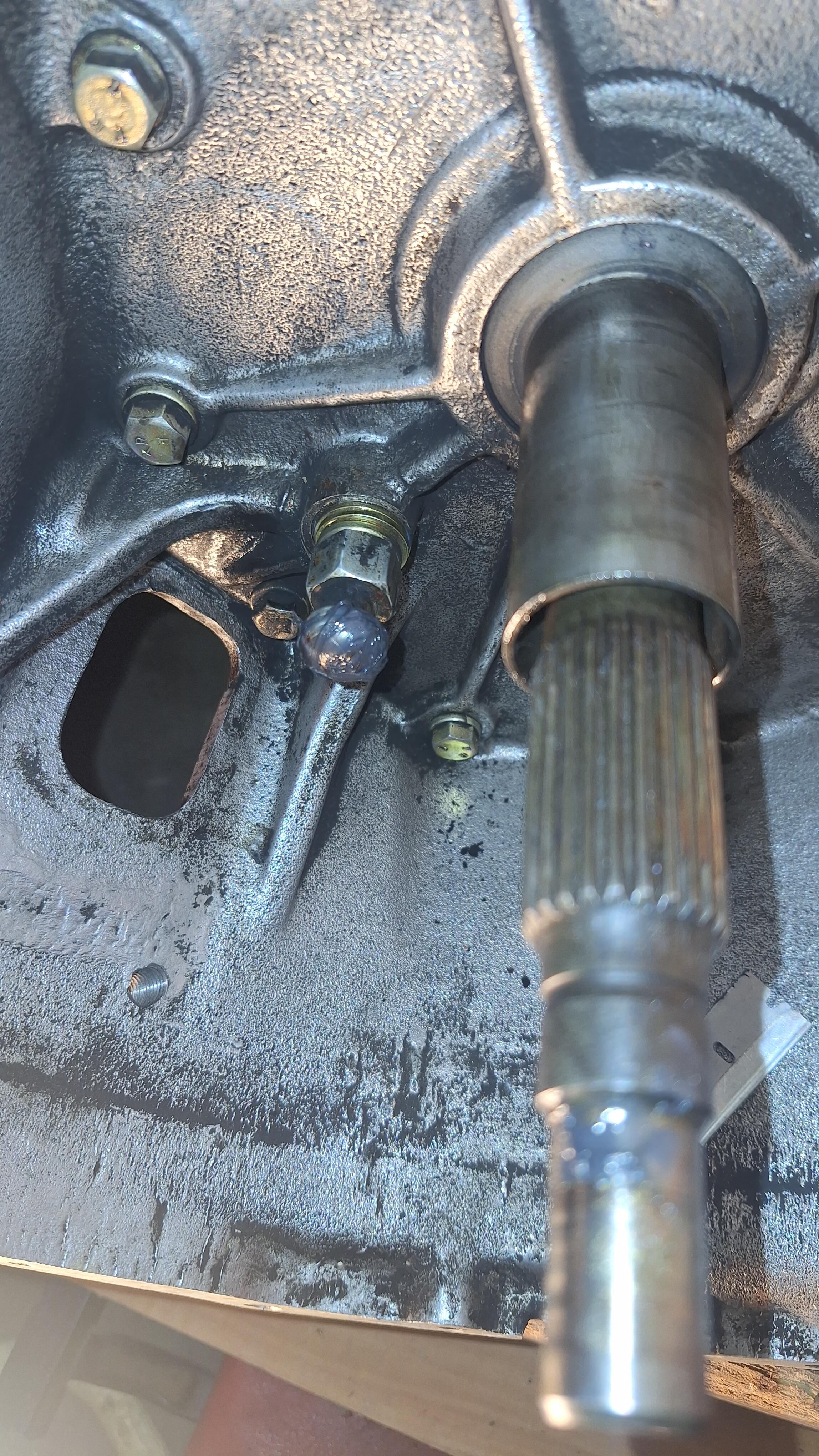

went underneath to torque some bolts and noticed the clutch fork was loose, what! I had to adjust it all the way out just to get the throwout bearing against the clutch forks. That isn't right.
I'm used to doing everything twice or more by now, so after reading the same issue on this site, I removed the engine.
I added washers behind the pivot ball, I don't know why I had to, but it fixed my problem.

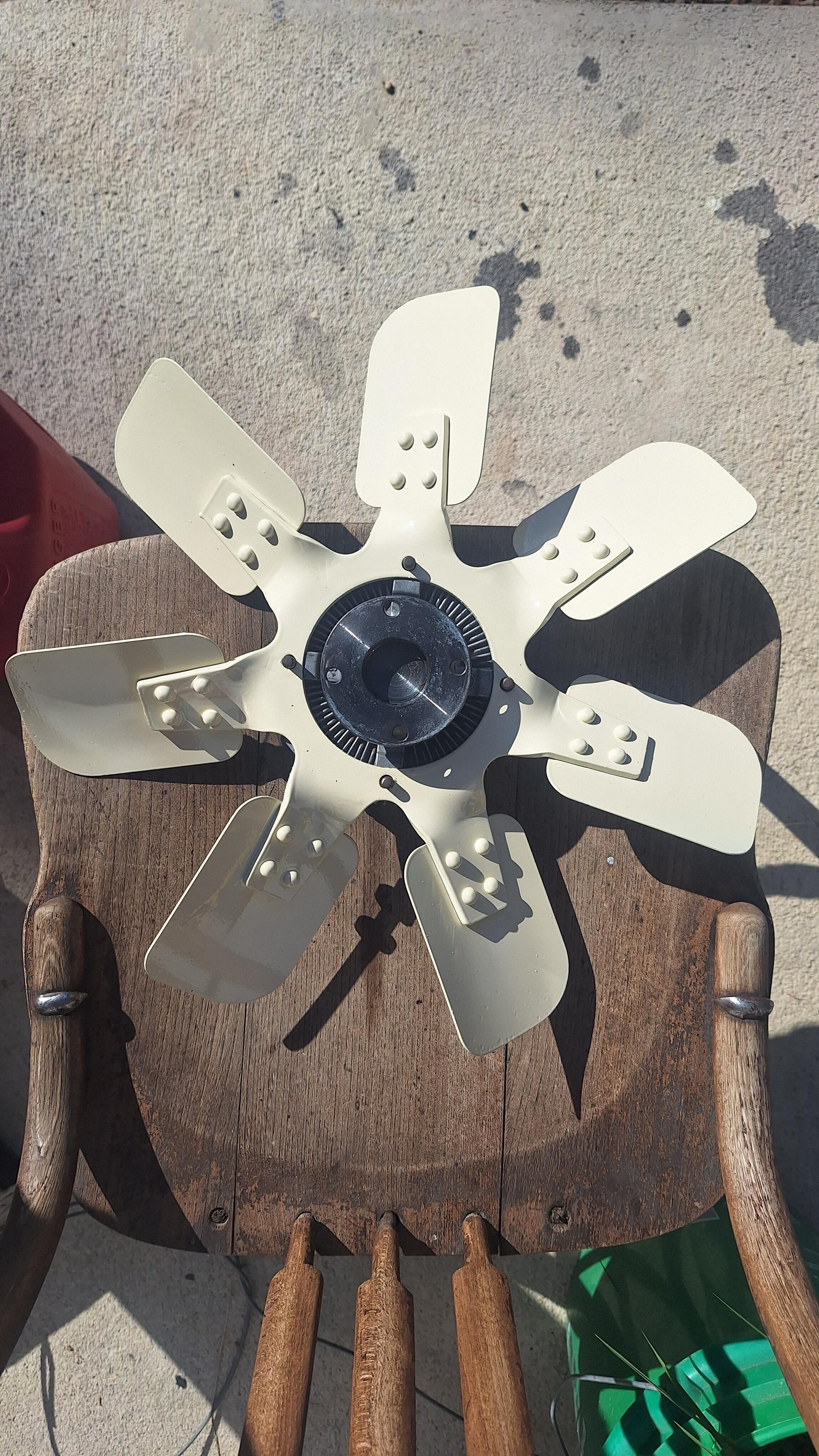

I decided to move on to refinishing other pieces, starting with the fan. I took my fan into Carquest and went through their paint color books. I found a match! They mixed it up. I bead blasted my fan blades, primered and painted them.

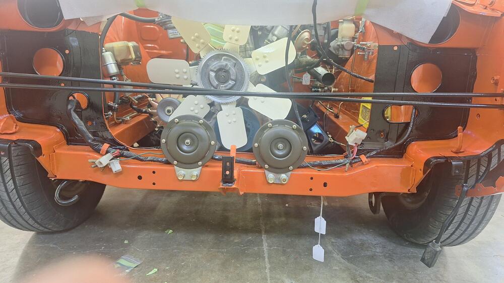

Installed the fan, 1st of many times, and the horns. I had the radiator re-cored back in 2021, it's been in a box in the loft for 4 years. I had the brake booster re-done as well in 2021. I tried to rebuild the brake master cylinder but...........I'm about to learn something.

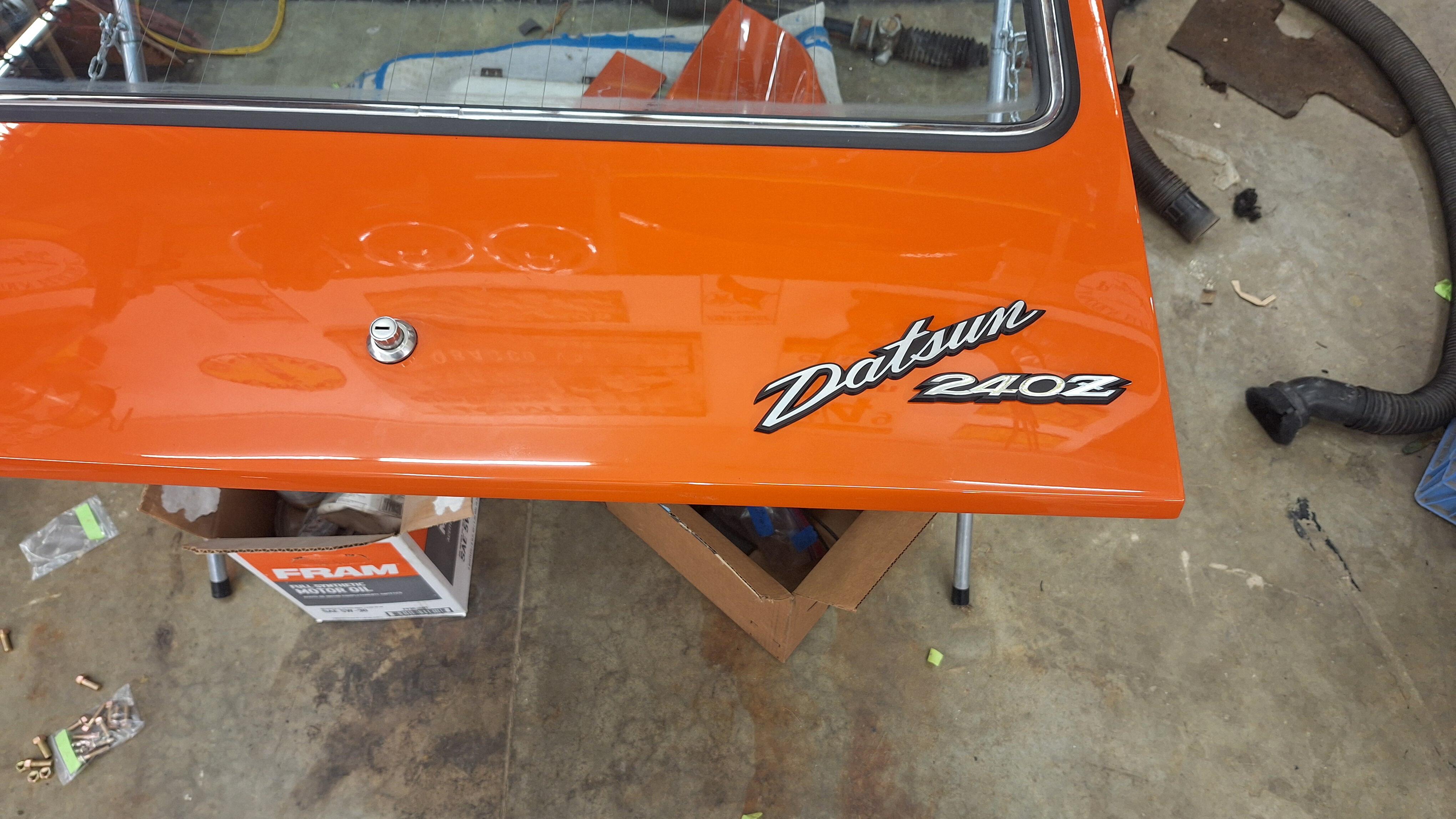

I have a few fenders off that parts car and measured and located the holes for the emblems, as well as the hatch. My hatch emblem holes were covered up, but I could find them from inside the hatch, underneath. So I removed the hatch. The fenders had no holes as the bottoms of them were replaced.

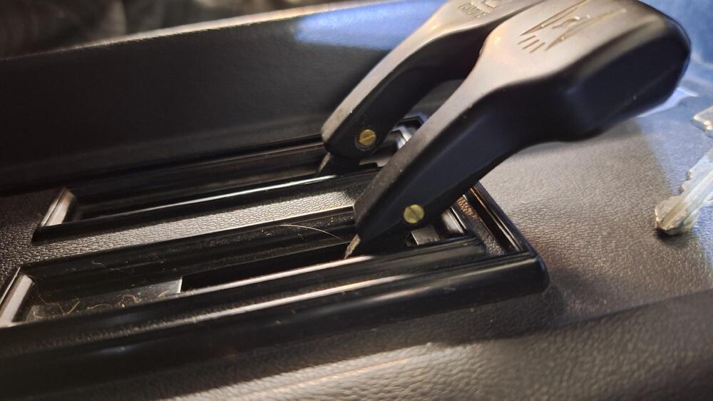

I started installing the console but first I had to route the choke and throttle cables. This is when I noticed how long the throttle cable was. I routed it this way but it was still a bit long at the pedal.
If anyone needs some choke lever knob screws, I have 98 of them left 😆
I wasn't about to cut it, it looked original. Then I researched here a bit more and found the length of one for a left hand drive car. Huh, I had one for a right hand drive car. How in the world did it get on a car here in Montana? My solution was a piece of motorcycle fuel line, slit lengthways, and used as a spacer. It worked. I later cut the firewall pad around the throttle shaft so the wing nut rests against the grommet.

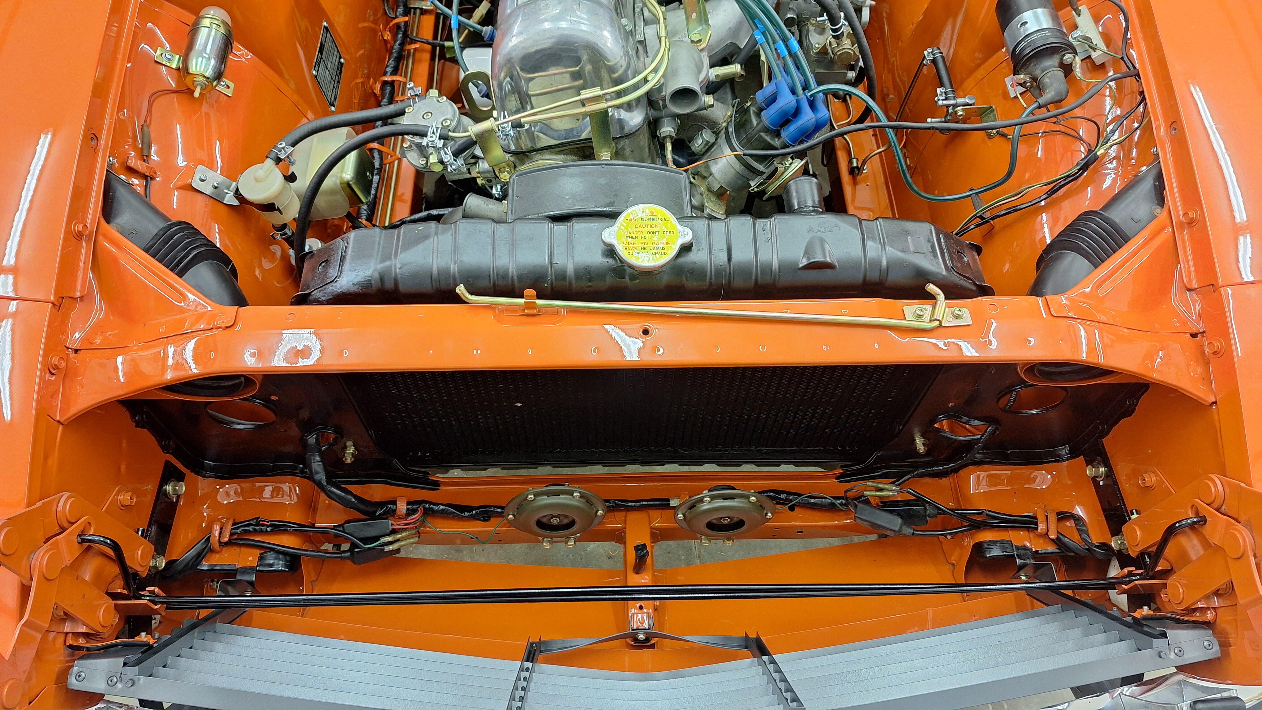

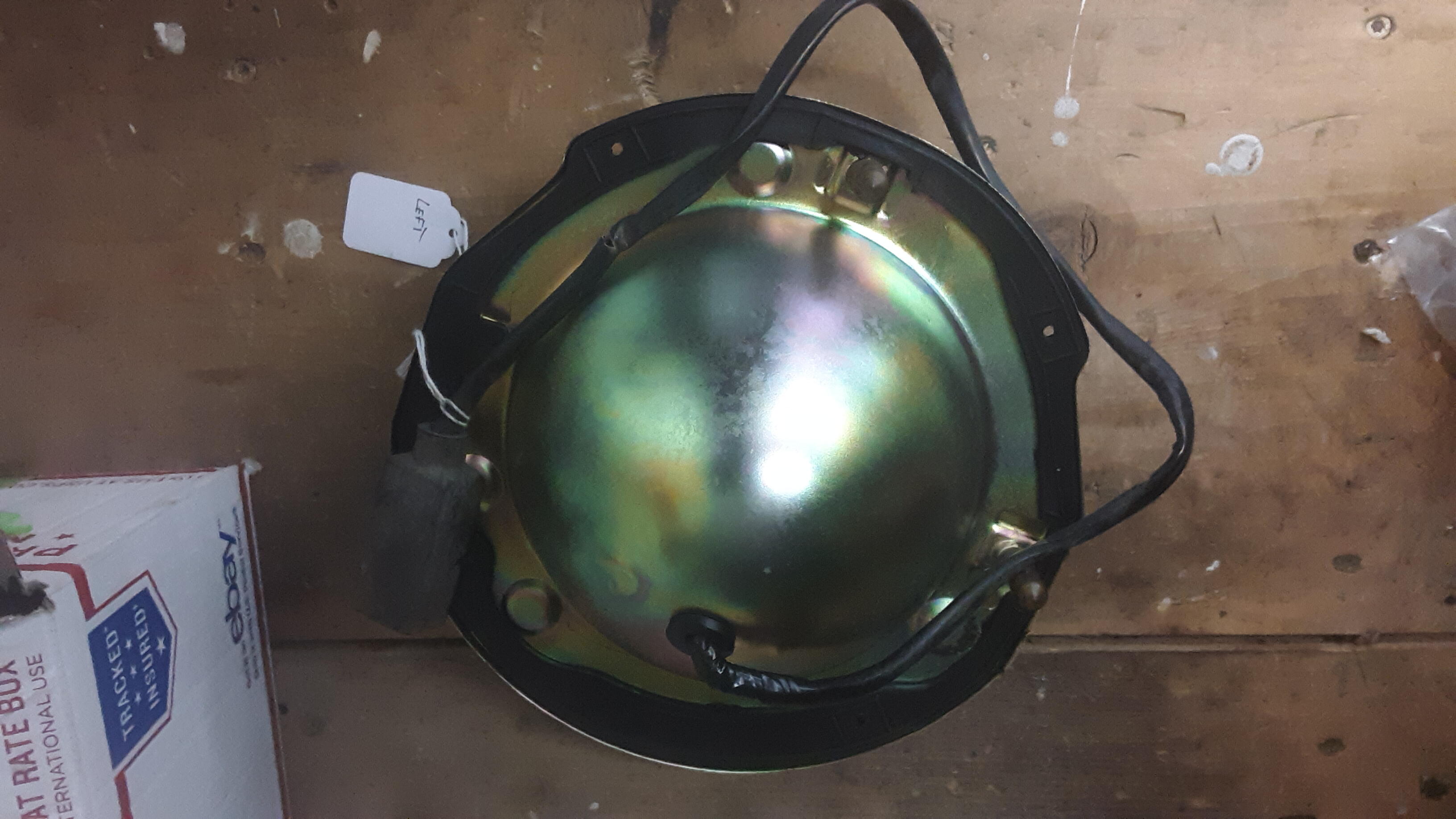

Installed the under fender brackets with foam, the fenders, headlights and the radiator, grille, horns, and bumper

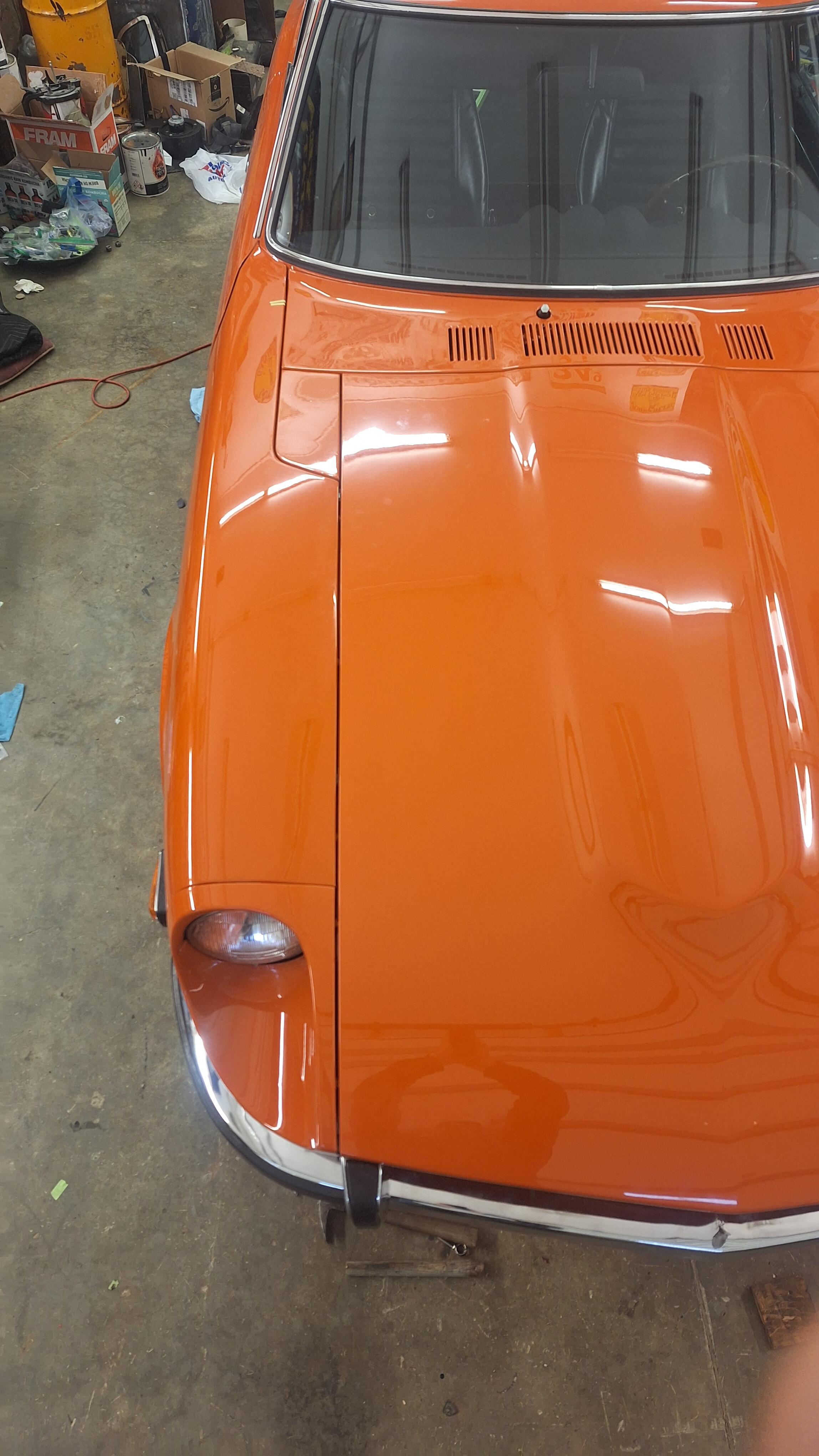

Time to install the hood. I noticed I had some areas that were not aligned that great. But one day I realized they were all related. I loosened the left fender and slid it forward. All these bolts are painted so I used a piece of plastic bag and inserted it into my socket, so to cause minimal damage to the paint.
hood alignment off.jpgalignment off fender.jpgalignment off.jpgalignment off door.jpg
After sliding it forward a bit.
hood alignment fixed.jpgalignment lid fixed.jpgalignment door fixed.jpgalignment right side good.jpgalignment whole hood fixed.jpg
