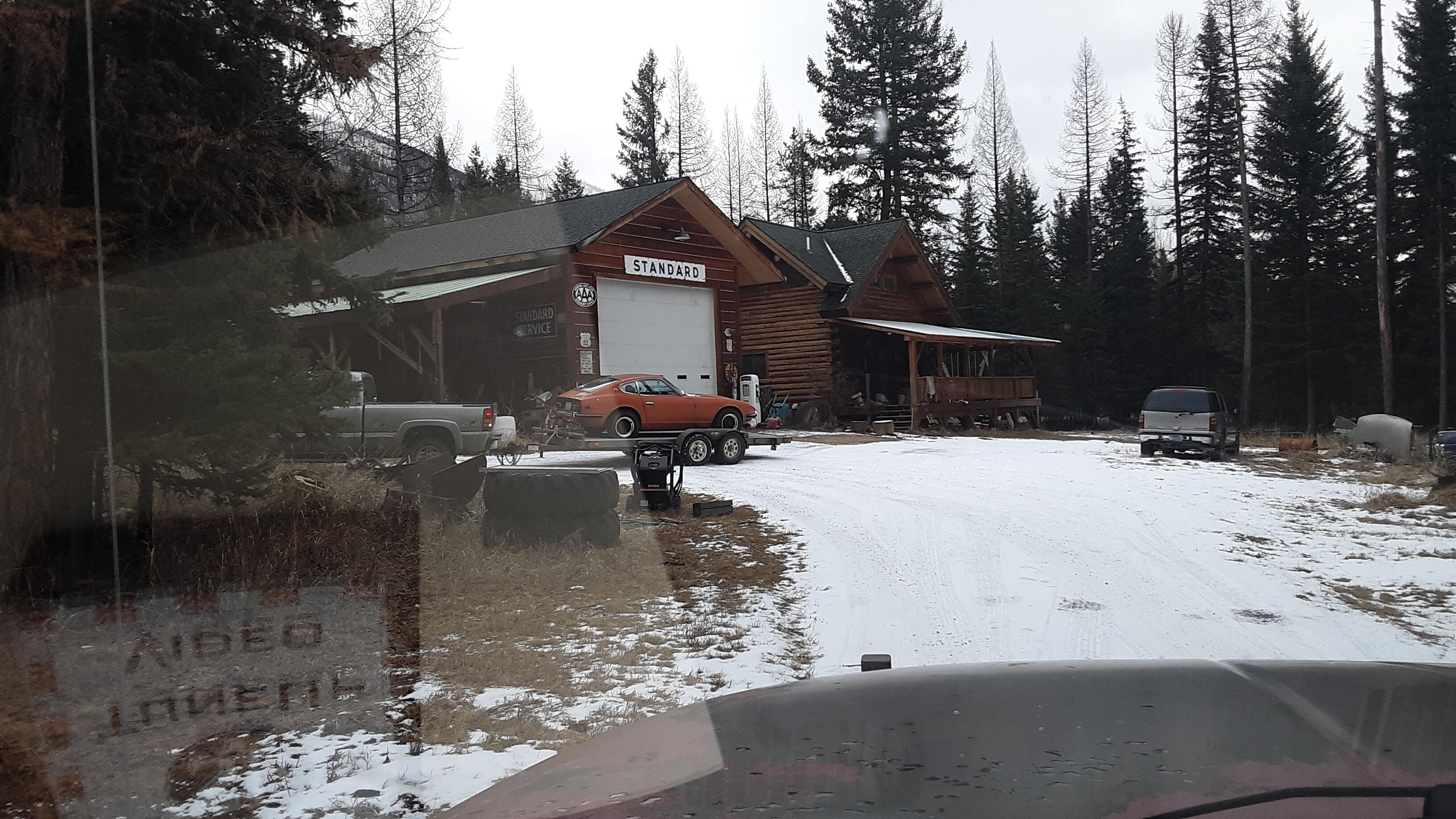

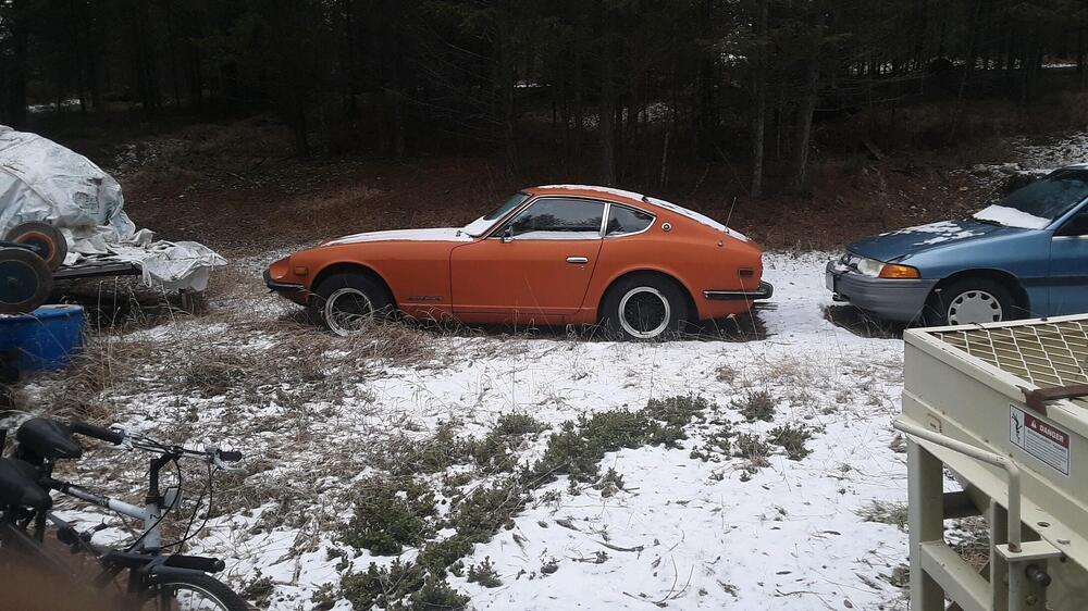

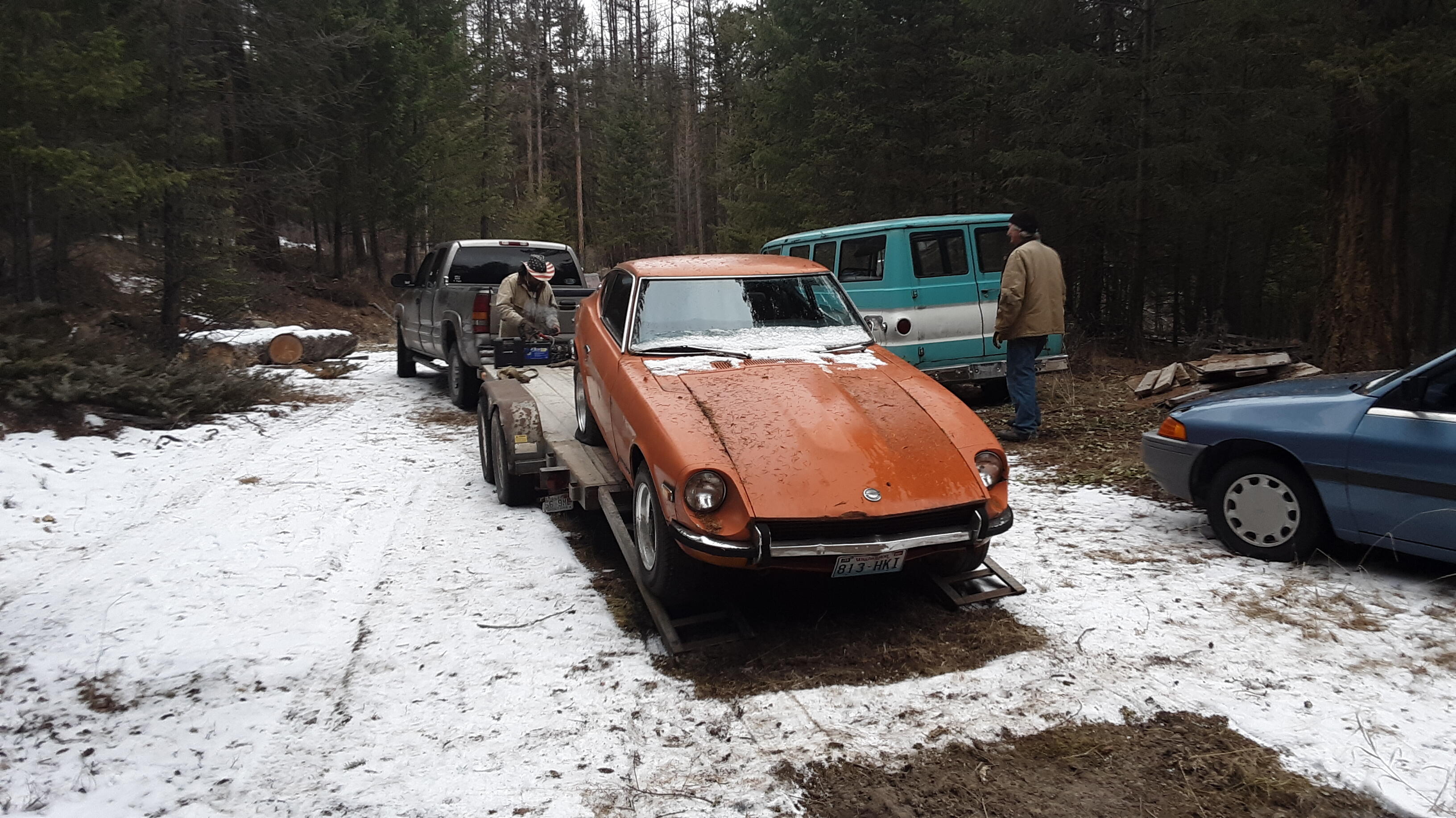

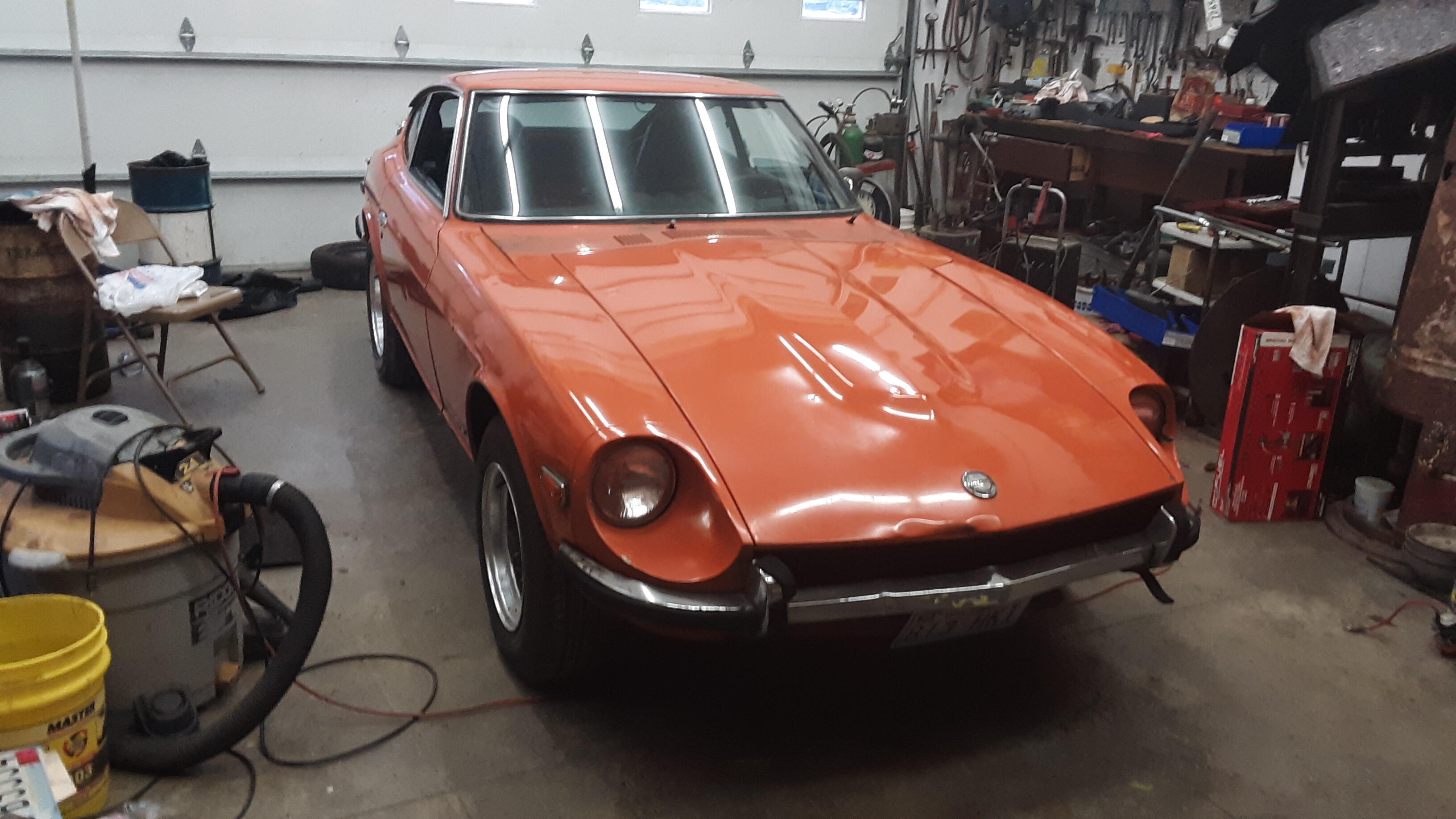

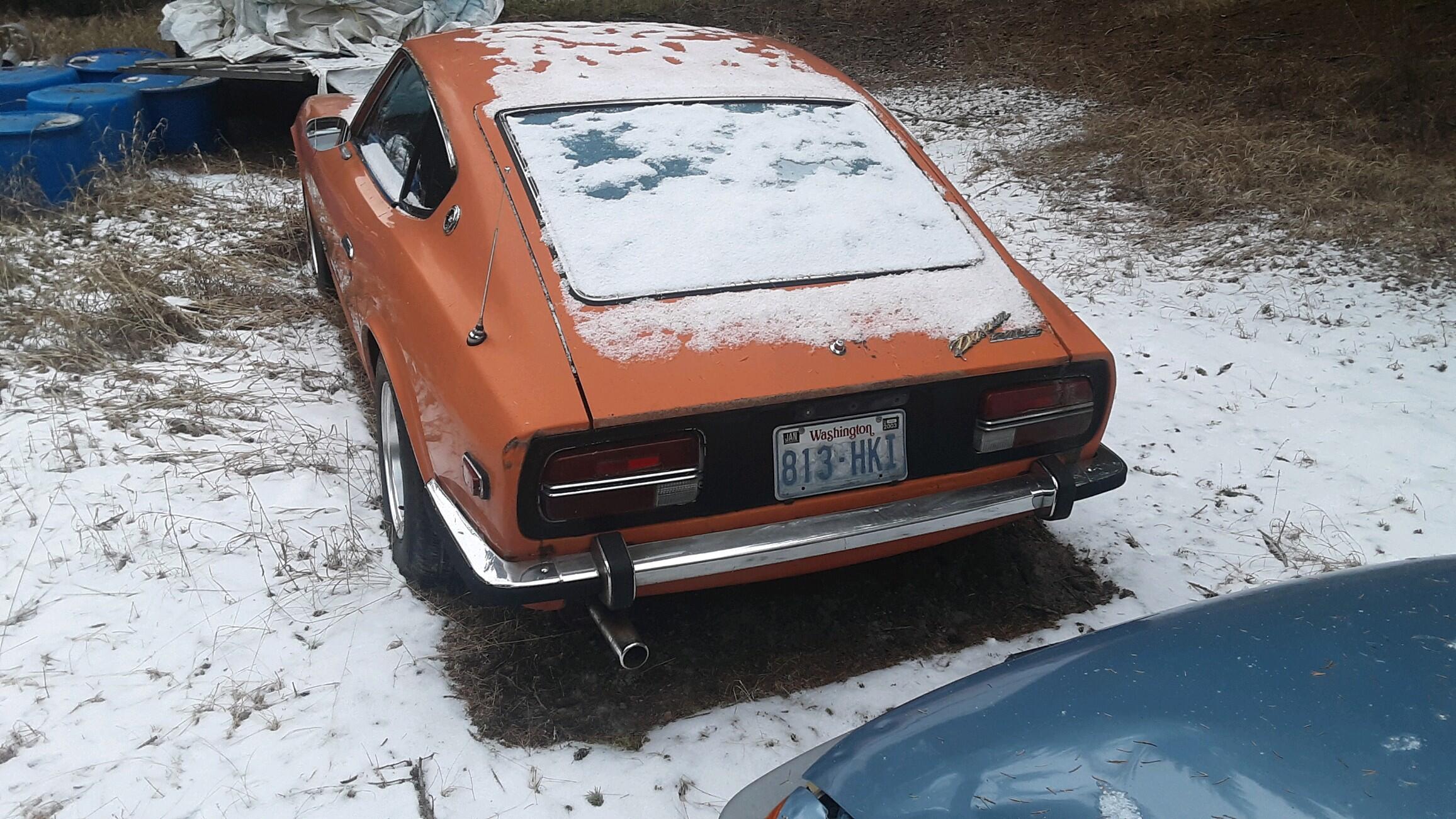

I stumbled upon this car in January of 2021 while logging my neighbors property about 1/2 mile away. The owner, who moved here in 2003 to help his aging parents on their small ranch, brought this with him from the Seattle area. He offloaded it here in the woods, and it remained there until he showed it to me. He kept mentioning something about the darn squirrels and mice getting in a car, and he was kind of sad about it. "What kind of car is it?" I ask. Oh, "It's a Zcar". Hmmm, I remember those in high School in the late 70's, my friend had one. Let's go look at it! So off through the forest we go, and wow! this is cool!found sitting 20 years 2.jpegfound rescue time.jpgfound sitting 20 years here.jpeg
I opened the hood and was immediately in awe. Then, when I opened the inspection lids, This is really cool. He started talking about side draft carburetors and I was lost, but he thought they were amazing. Life on the ranch became overwhelming and time just got away from the gentleman, he is now in his mid 70's and it's been 18 years since he parked it. He tells me he found it on Vashon Island completely buried in blackberry bushes, along with an old VW, back in the late 1990's. So he rescued it, got it running, and his wife drove it for 2 years before it ended up here. I went home, did some research on 240z's and couldn't sleep. I had to save this car! I went back the next day to work and made a deal with him, brought it home. What did I just do? fou from woods to shop.jpg

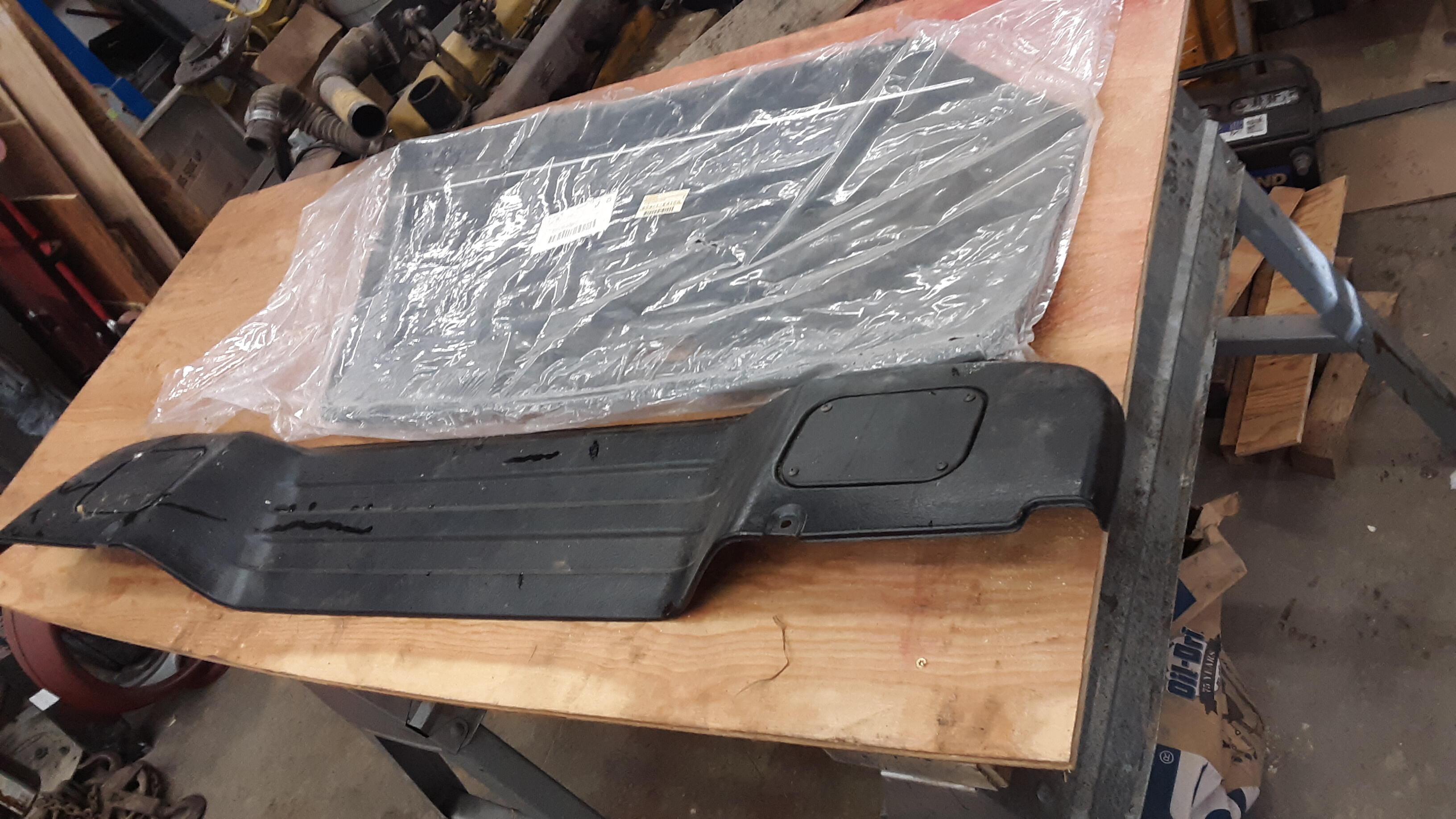

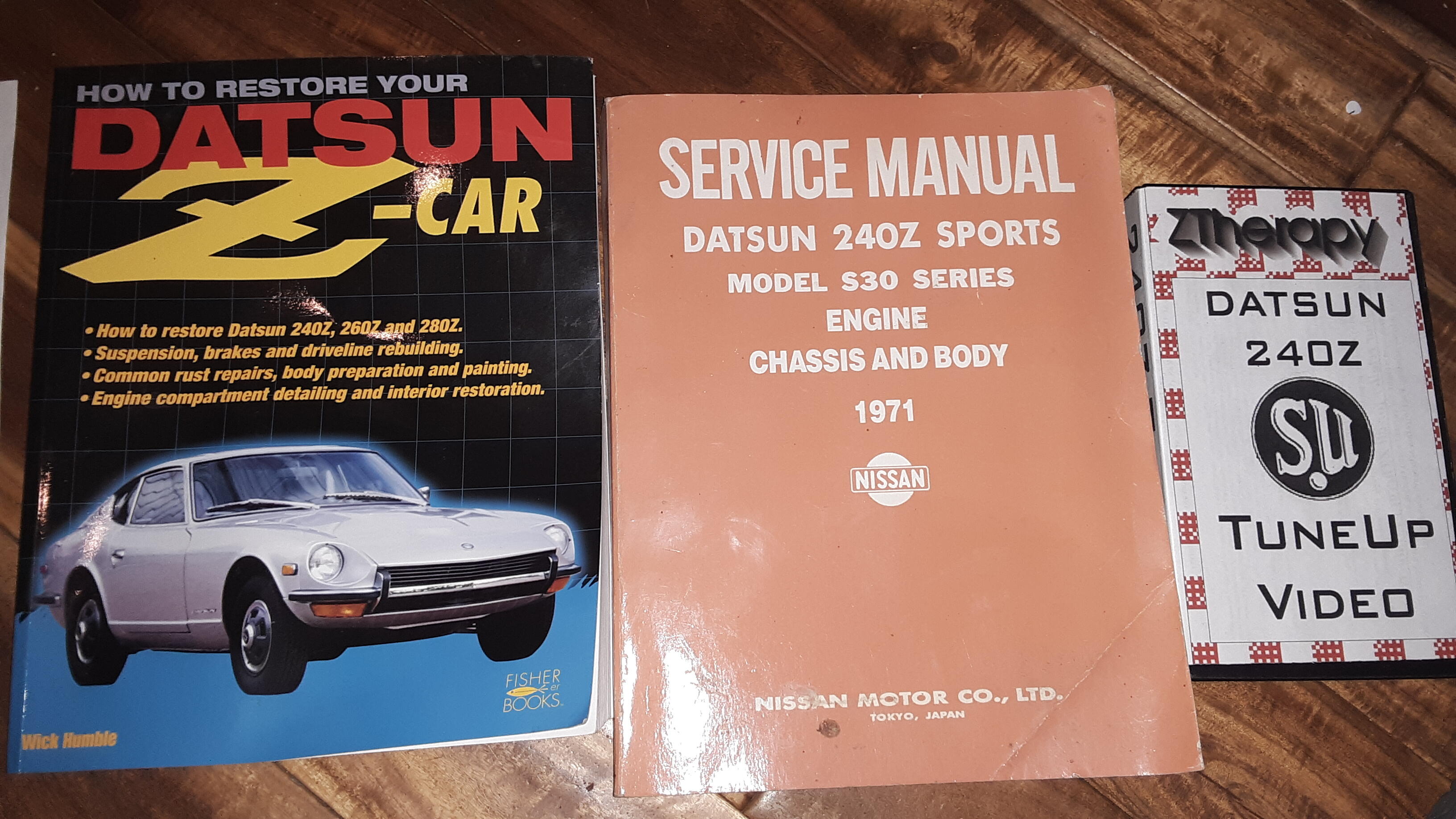

Along with the car, he had a few things, books and a few parts. Back in 1999, you could go to a Nissan dealer and pretty much still order anything you want for these cars.books that came with.jpgmore parts from the barn.jpg

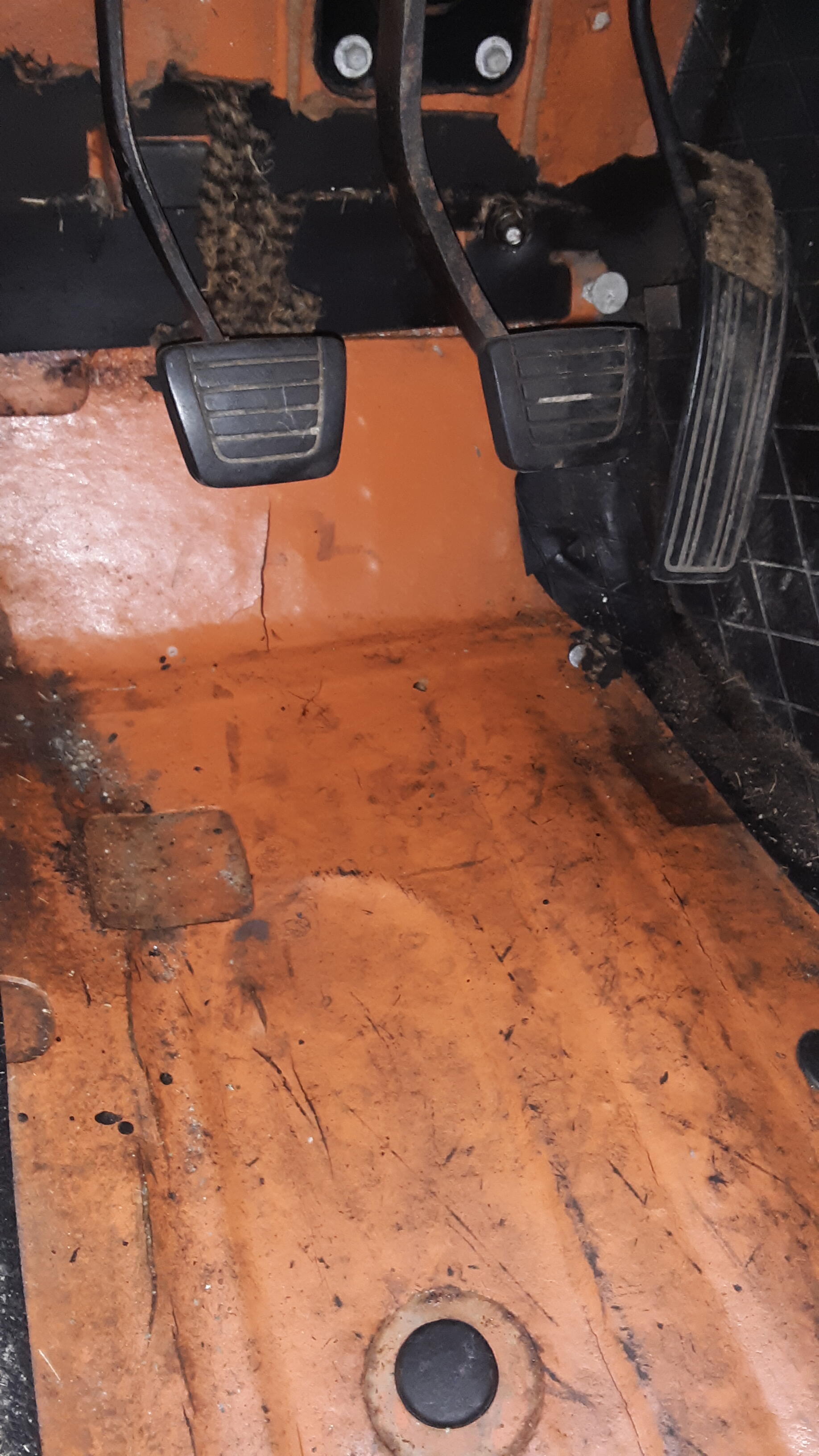

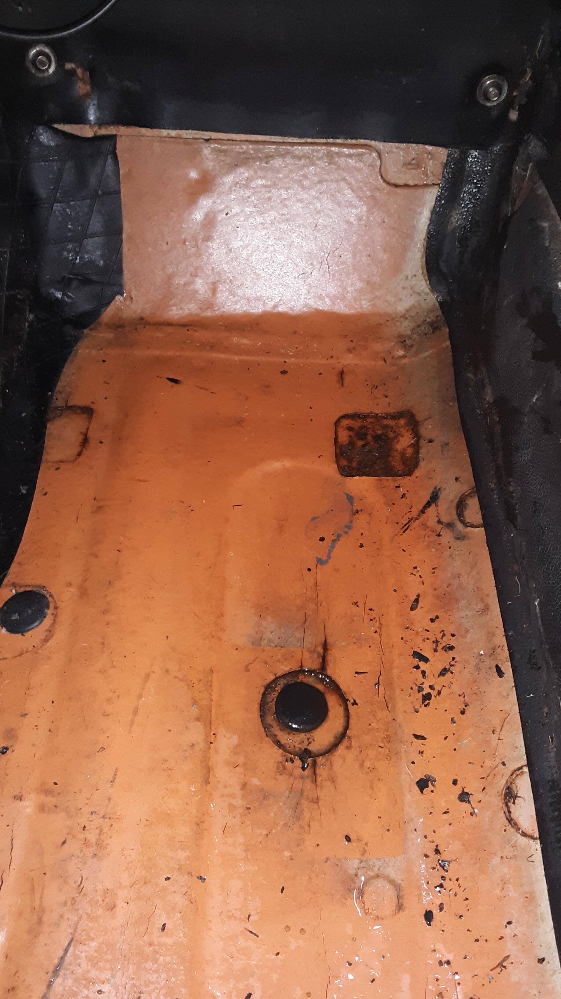

After getting it in my shop, I started removing things, carpet, etc and at first glance, being naive as I was, Wow, this car has no rust! I didn't know that what I was looking at was painted tarmat at the time. fou drivers floor no rust ha.jpg
But, it looked pretty good. Water continued to run down the passenger side floorboard for several days, where is this coming from?

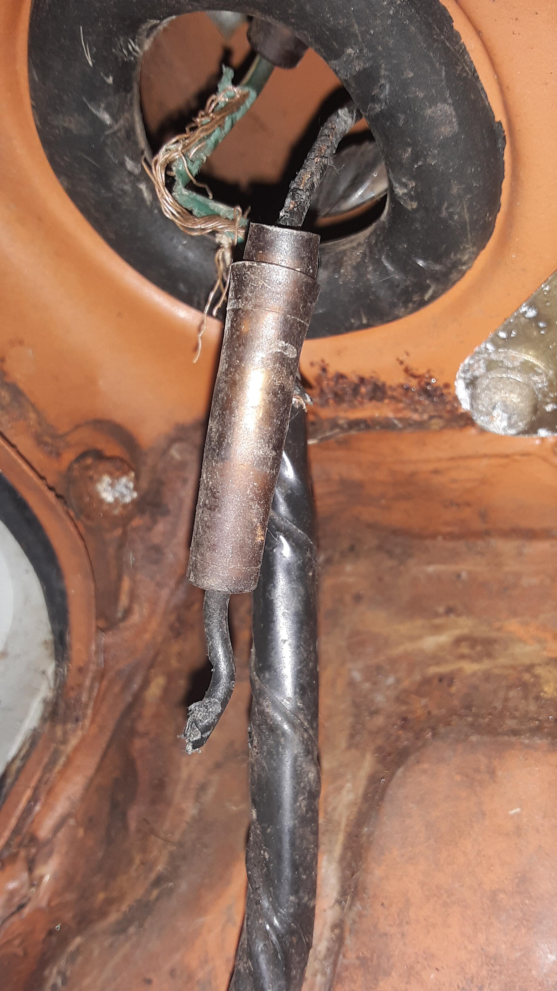

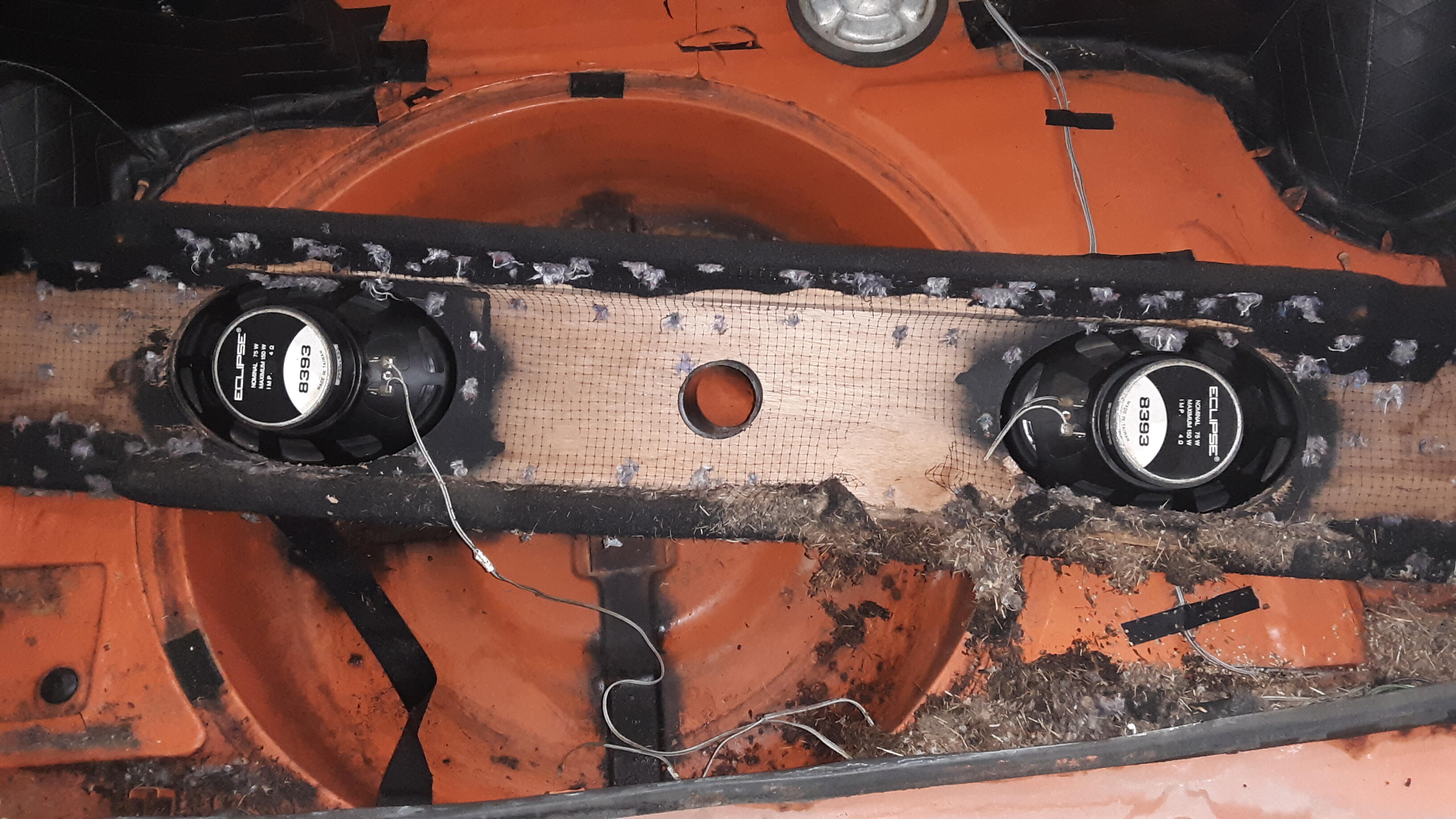

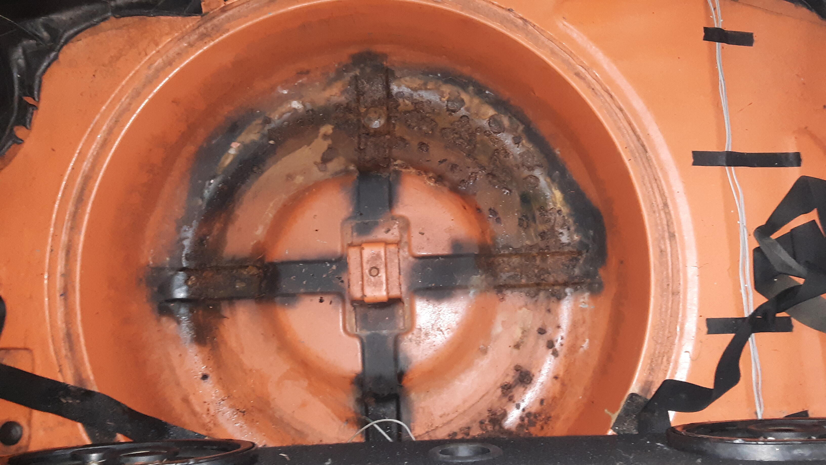

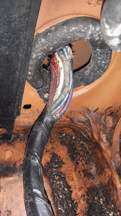

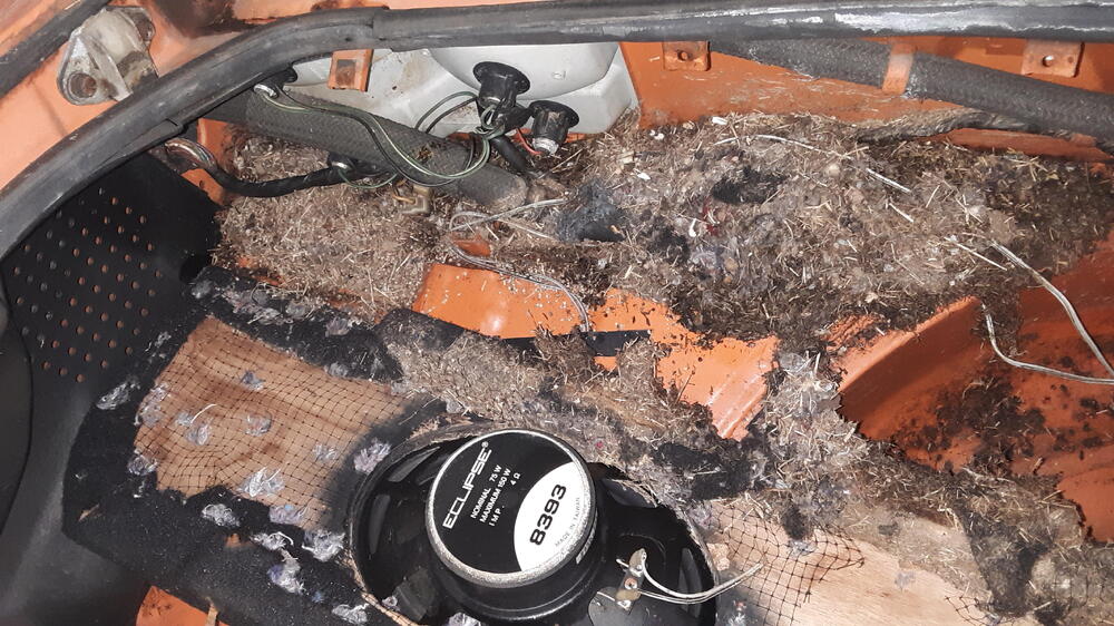

He had a homemade speaker box in the back and when I removed it and the spare tire and found what he was talking about, MICE!
fou speaker box nest.jpgfou homemade speaker box nest.jpgfou wiring damage mice2.jpgfou wiring damage mice.jpgfou spare tire tub nest.jpg

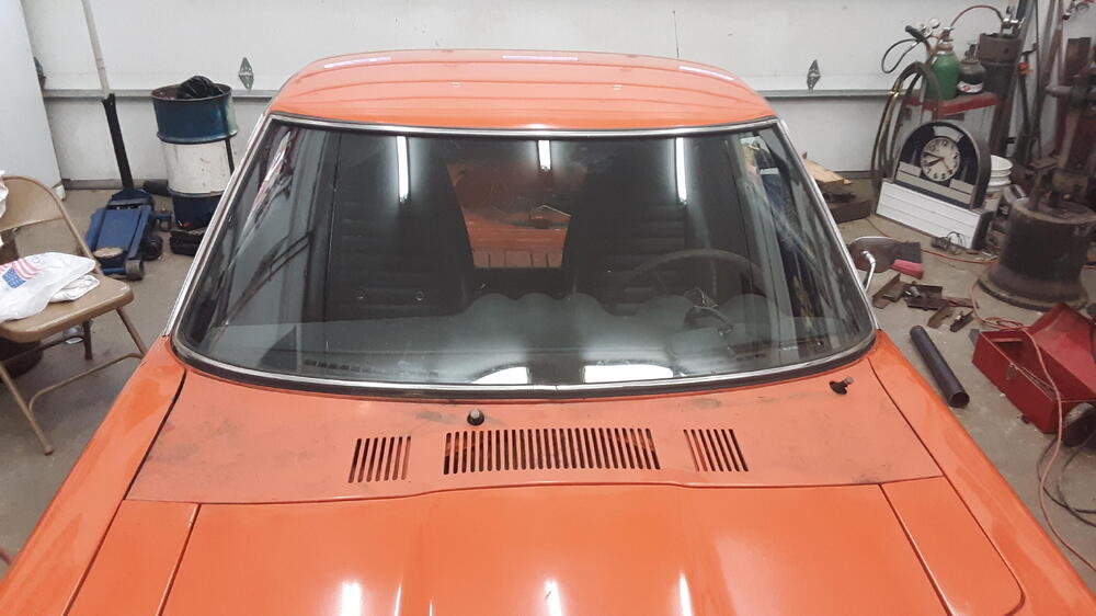

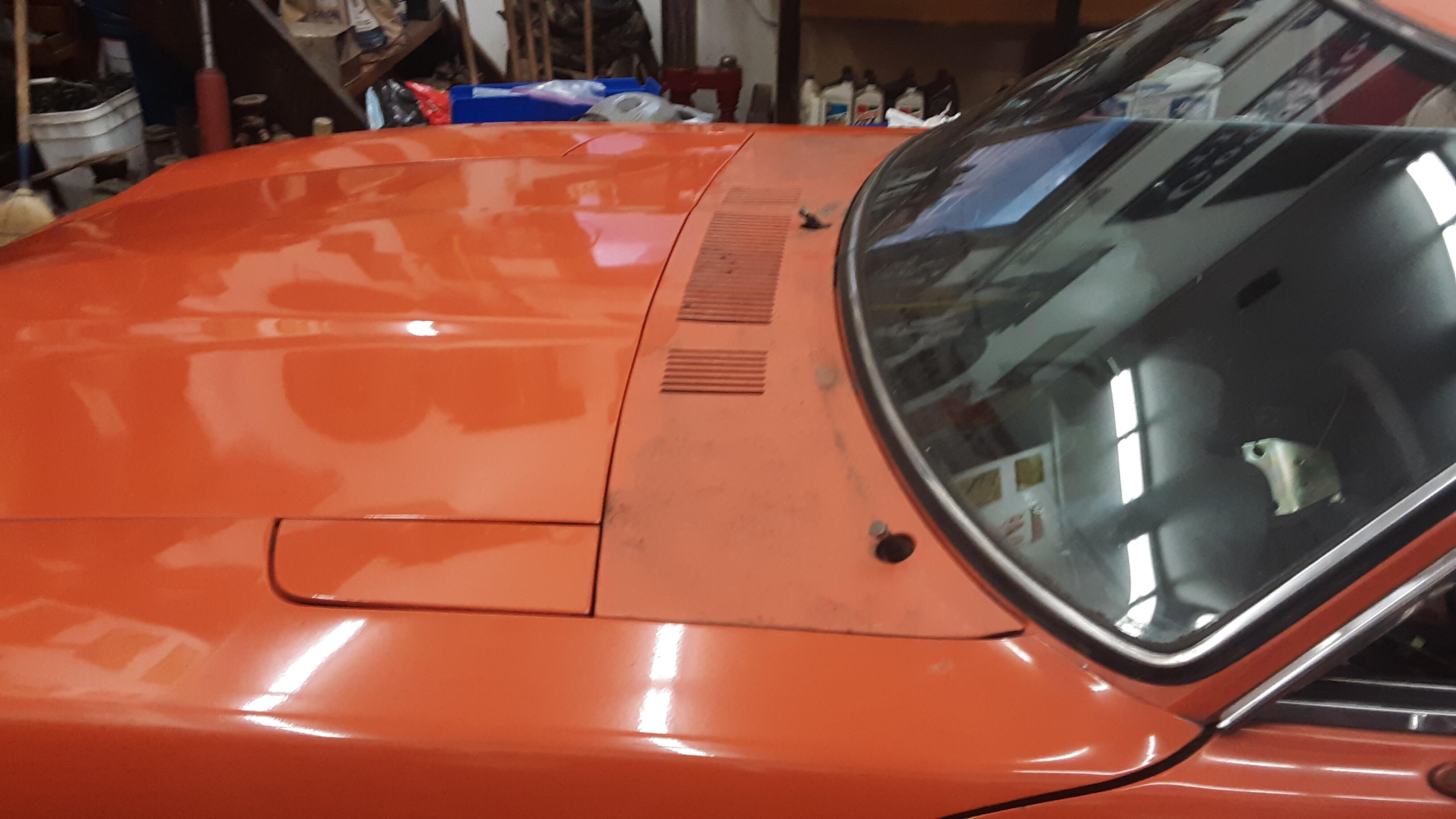

I looked at the book I got with the car "how to restore your Z-car" and said to myself, I am not doing that, way over my head. So I got some polish and my girls started helping me shine it up.
car home girls.jpgcar home polish.jpgcar home polish2.jpgcar home polish3.jpg

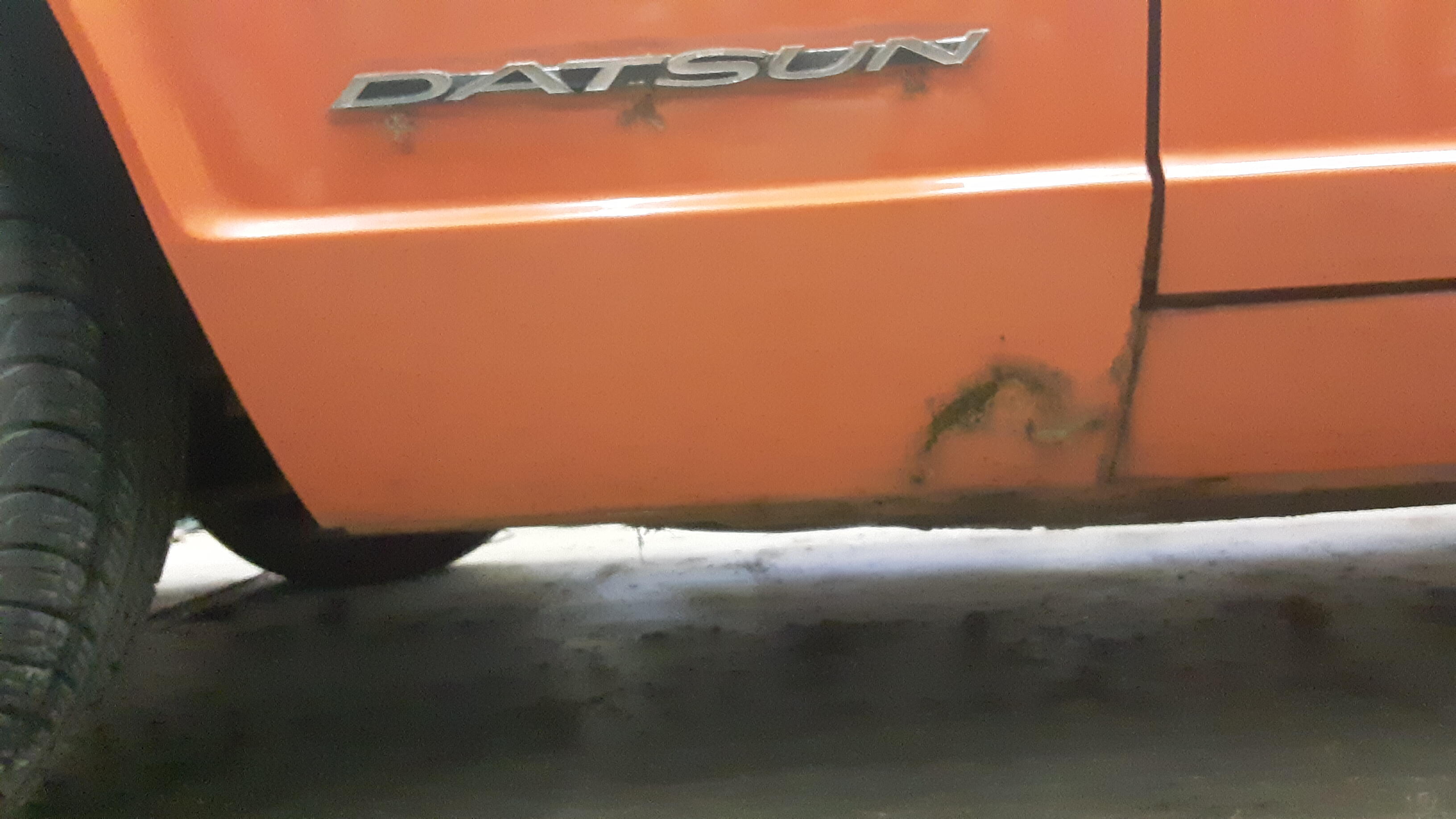

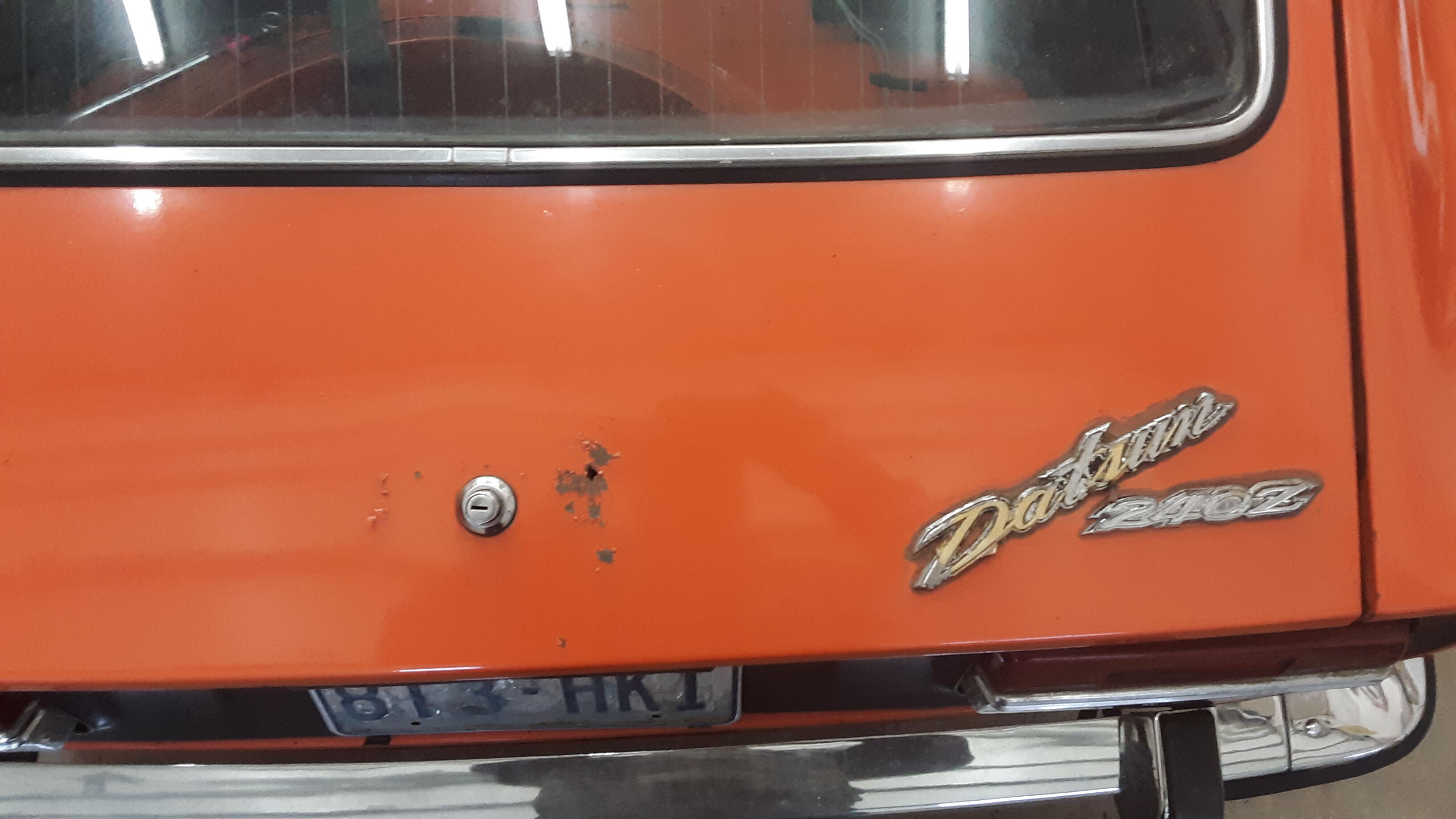

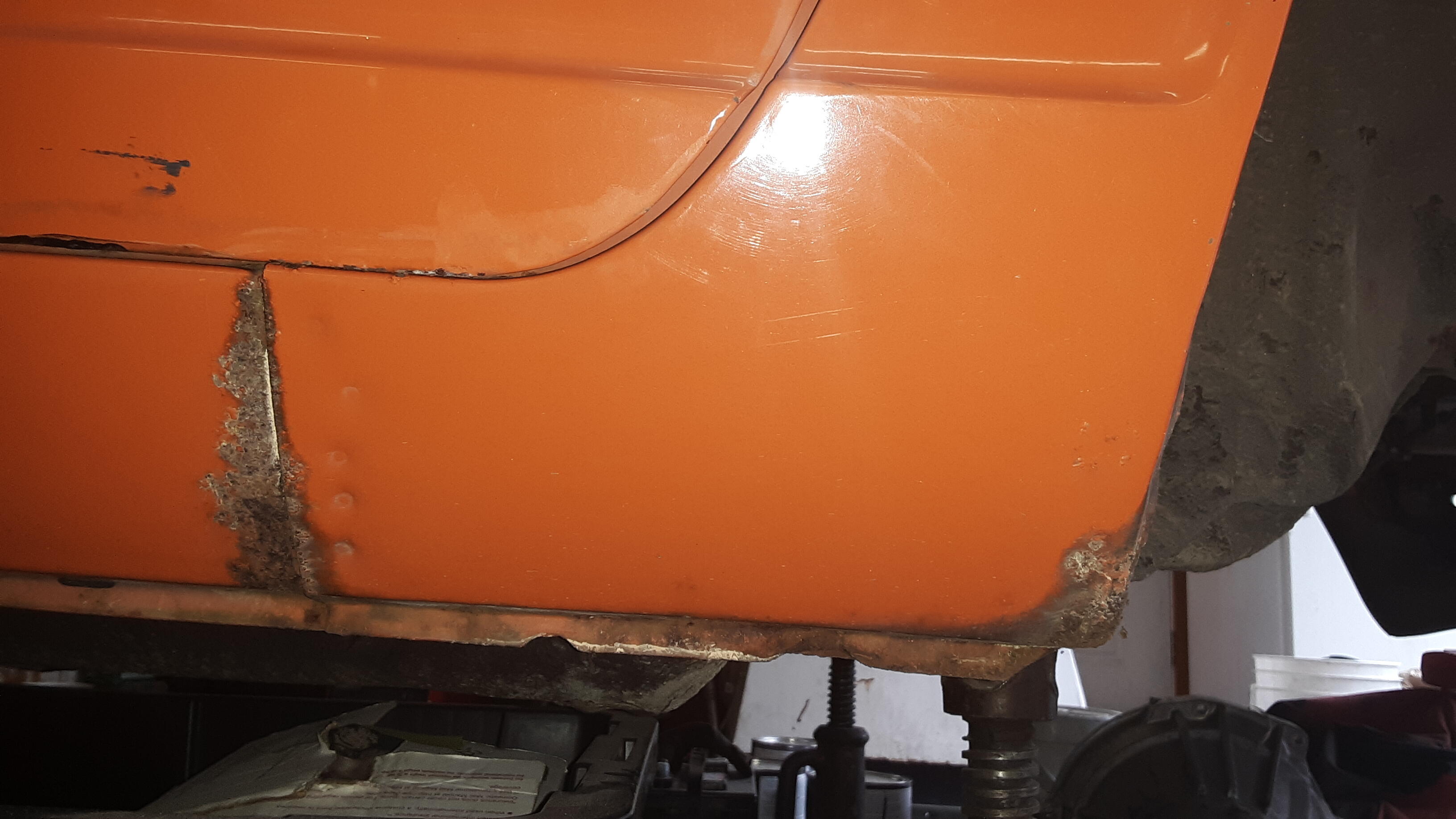

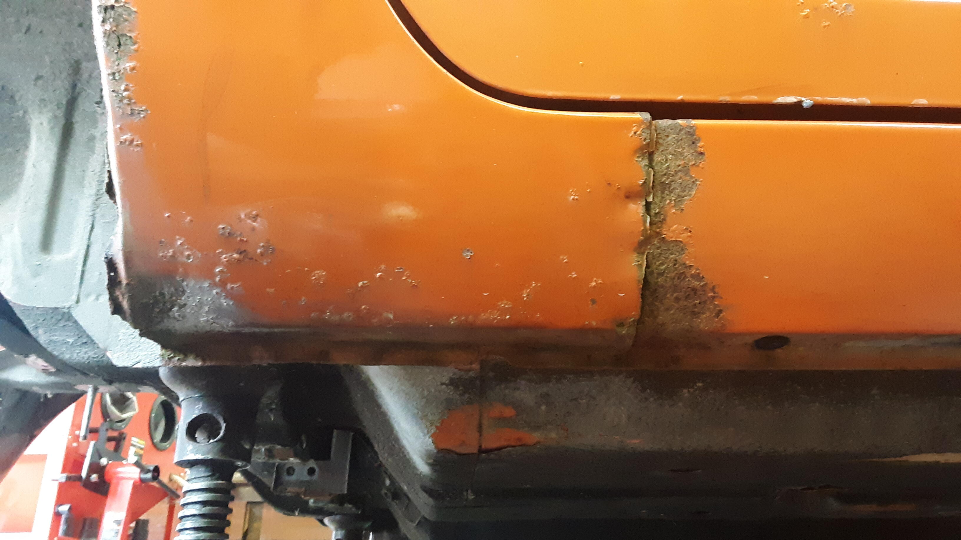

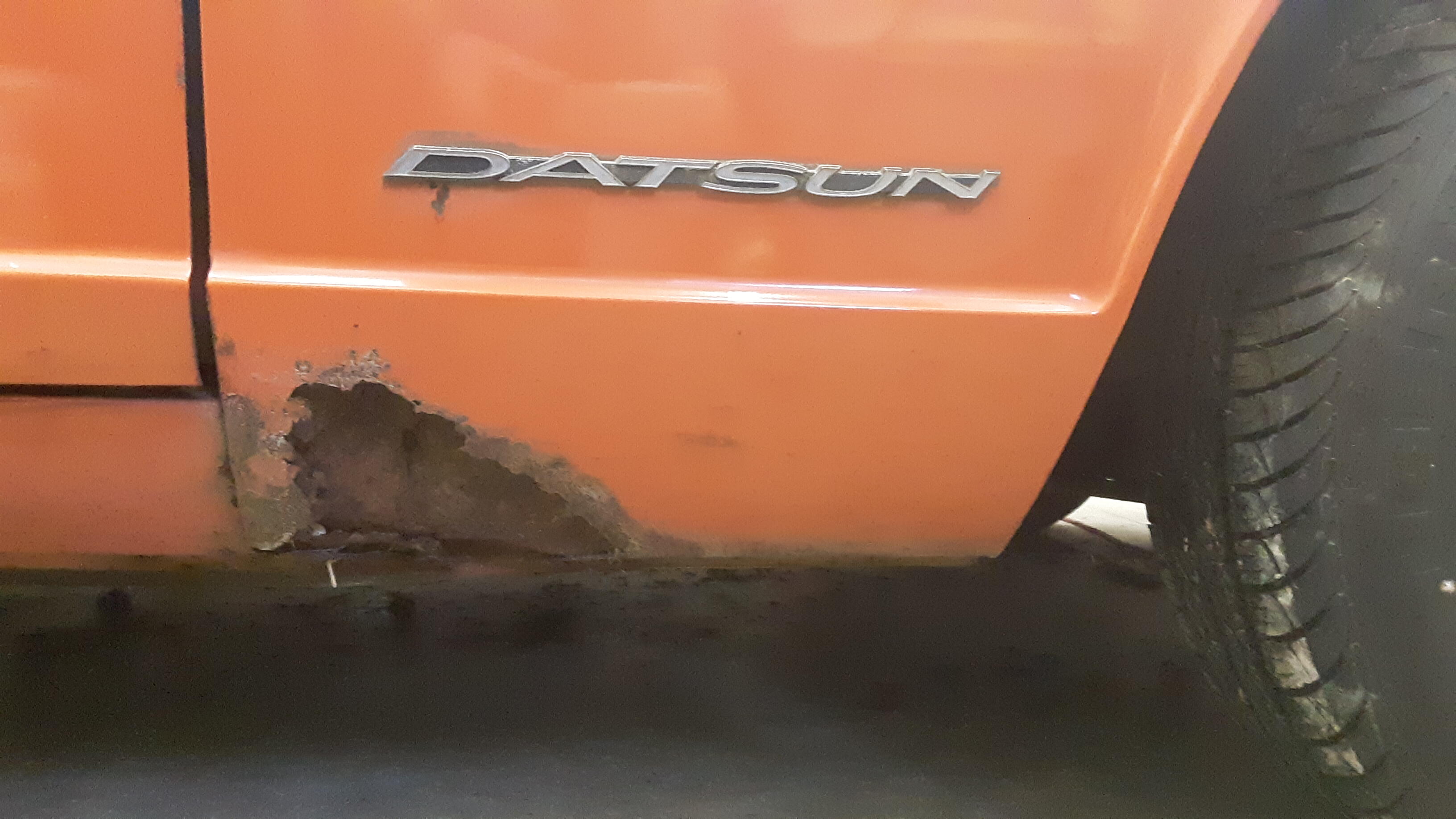

That's when I started noticing some rust. I started reading more and more and learned how deceiving these cars can be.
dogleg right rust.jpgdogleg rust.jpgfou right fender rust.jpgleft fender rust.jpgfou hatch rustthrough.jpg
