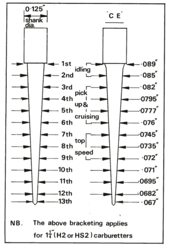

After reading the following post, I got to thinking... If I have the needle station measurements, and I can record my AFRs for each of the general categories of start, idling, pick up, cruising, and top speed, then might I be able to calculate the station measurements of the needle that my engine wants?
Not that I know of. It would give you an idea of where the stations need to change and whether a little or a lot but I dont think you can calculate exact station size required from wide band afr numbers. You would also need a visual reference for piston height (station being metered) at a given AFR. There are quite a few SU needles available with station sizes but like tuning webers there is some educated guesswork
I assume that with enough equipment and calculations, you might be able to predict what would work "right out of the box", but that's way above my pay grade. I would do the same as Patcon and use the AFR numbers as guidance as to which general part of the needle needs to change.

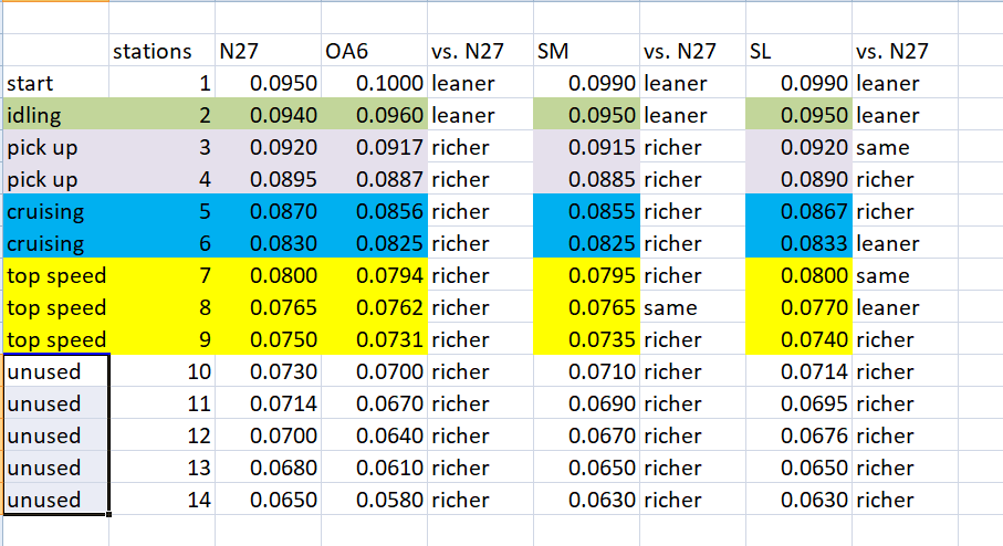

I do plan on at least using the AFR info as guidance as to which general portion of the needle needs to change. I have spent some time reviewing specs for needles. Here is a small selection of the few I have found to not be obviously bad choices:
From here, I plan to set the mixture screws at 2.2 turns out (per the factory manual spec). Then I will make some recordings with the LM-2 wideband. My RPM signal is not being capture accurately at the moment, so I will have to address that first. I think fixing that will assist with some of the repeatability that will be needed for testing.
When I do that, AFRs will change from what I have seen thus far, as right now, the mixture screws are about 2.7 turns out. While I am seeing around 11 at idle, and 16s pretty much everywhere else (other than throttle lift off, which will cause AFR to hit 19-20), I may find that idle moves to 14 instead, and everything else jumps past 18. Who knows. But, I will attempt to get some AFRs with 2.2 out on the mixture screws and use those as my N27 "reference" AFRs.
Once I have these, I will review the above needles again, comparing with the N27, and consider the change in "general direction" that will be necessary at each station.

I went through a few sets of needles after I installed an AFR gauge in my Z and got a better idea of what was needed. I didn't get too scientific with it, other than making general observations at idle and different throttle positions like you have then looking for a needle profile that was bigger or smaller where adjustment was needed. I'm running a mildly built L28 with SUs. I started with SM needles, which I had to run super rich at idle to get decent AFR everywhere else. I tried SB needles also, but settled on RH needles as the best range for my engine. This is a great website to compare needle sizes https://www.classicminidiy.com/technical/needles. I never found a good source for needles in the states and ordered mine from https://www.sumidel.com/ out of Australia. The conversion rate was decent a few years ago when I ordered, so the price wasn't as bad as their site appears. Good luck!
Thanks for the reply. I overlooked the RH, but it looks much like the OA6 - leaner than the N27 for the first two stations and richer at every other station. I'll add it to the rather narrow consideration set.

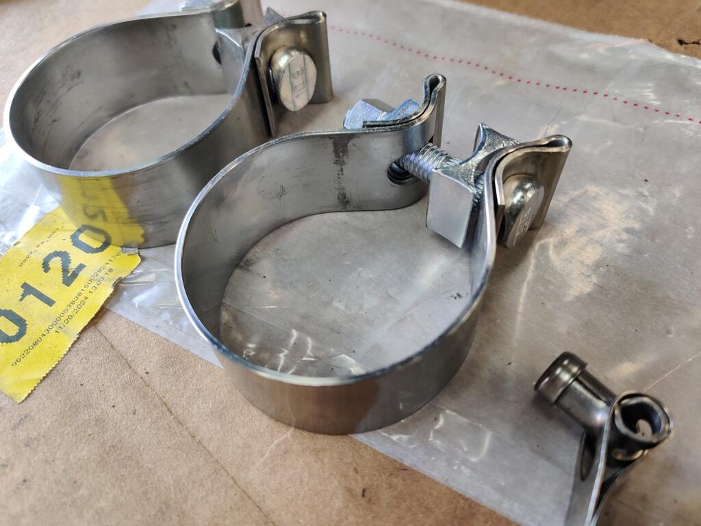

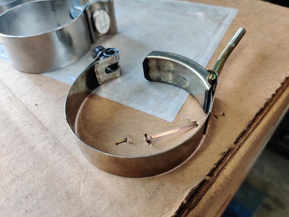

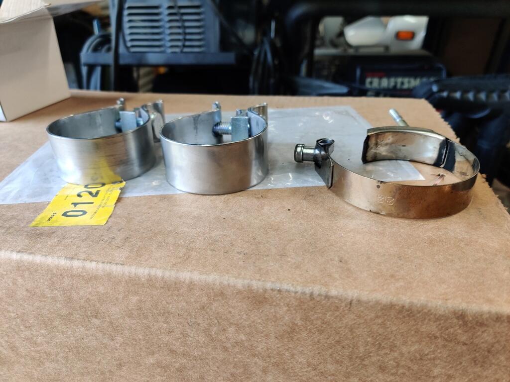

I installed the new exhaust clamps today. As is often the case, I had to modify them to fit the pipe that slips over the header collector. The clamps were for 2.5 inch diameter, and while the headers have 2.5 inch outlets, the merge pipe that slips over top of those has an OD of 2.665".
The "T bolt" clamps that were supplied originally were not heavy duty enough to clamp the slip fit connection tight enough to eliminate leaks. These new ones are strong enough, but I had to use a die grinder to slot the holes for the bolt and trim a bit off of the aluminum spacer to achieve a larger overall installed diameter when on the pipe:
One of them still leaks a tad, but the other seems air tight. I will mess with the one a bit more some other day.

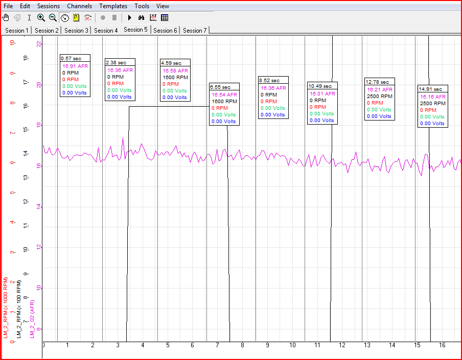

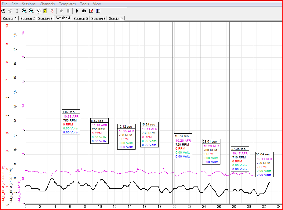

With that done, I went about the main task of the day, which was to get some baseline AFR readings. Stock N27 needles, new nozzles, remanufactured carbs, in sync, etc. Mixture screws are turned down 2.2 turns.
Here is idle:
Let's call it 10.2 - 10.4.
Here is steady state cruise. I will note that at a steady cruise on a very slight incline road, the AFR is a bit leaner than steady steady cruise on a perfectly flat, or very slightly declining road. Also, my RPM are only being recorded properly at idle. Any revs, and the signal is getting lost. This run is basically cruising in third gear at something above 3000 RPM
Let's call that 16.2 - 16.5.

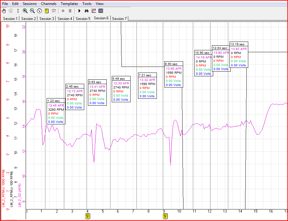

And finally, a near, if not full throttle pull in first, and second, and part of third:
accelerating.pngThis
This one is harder to read. Wish the RPM signal was recording accurately. That said, looking at the above and recalling from watching the AFRs while accelerating with near full throttle, I was surprised to see numbers in the 12's and 13's. I am near certain that the two drops in the AFR line above (I put yellow notes at 4 and 9 seconds are shifts from first to second, and second to third. So, "pulling" in second under near or full throttle (look at seconds 6 through 9), I am seeing 12.9 to 13.4?
I think I will work on getting the RPM signal attenuated and then I need to make some more full throttle runs. Perhaps I should do a leak down as a check to see if the engine is fully broken in. I've got about 280 miles on it, and until today, hadn't given any full throttle. That's why I was surprised with those AFR readings - I had only been applying moderate throttle and when doing that I am definitely getting lean AFRs. Transitioning from cruise to part throttle acceleration, I am generally seeing 16.9 to 17.1.
