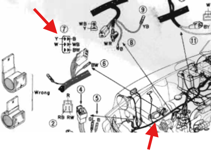

The wiring is there in the back, but depending upon what has been done to the car over the years, getting power to the pump may be an issue.
I would look around the forward console area for something in the wiring harness wrapped in blue tape. In my 71 240Z it was in the wiring bundle on the right side of the console going to under the dash. I've seen pictures on these boards where it's more like around the left side of the radio body. If you find it you should be able to jumper across the plug, like take a piece of wire and put one end in one side of the plug and the other end of the wire in the other side of the plug. This should give power to the leads that are dangling somewhere near the fuel tank when the key is in the run position. I would maybe recommend an inertia switch in that jumper loop to cut power in the event of a crash and the driver is incapacitated.

But since it's a 73, it may be wired with the field modifications. That's why I want to get the OP to answer some questions about his car as opposed to throwing out a bunch of things.

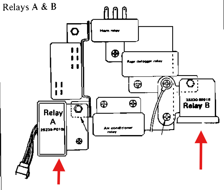

Do you have one or more of these items?
  1. An electric fuel pump mounted at the gas tank
  2. The relays indicated in the drawing below (Look for the ones where I drew the arrows.)
  3. A wire branching off the black/yellow wire at the starter solenoid (Sorry, no picture available)
Does the car have the stock alternator and voltage regulator? The voltage regulator is mounted to the passenger side fender near the alternator. If your car has the field modification, you should see the VR plugged into a 6 pin connector, and that has a short length of wire going to the engine harness.
If you have both the stock alternator/VR and field modification, you have everything ready to wire up your electric fuel pump. If you don't, we can help you with Plan B.
