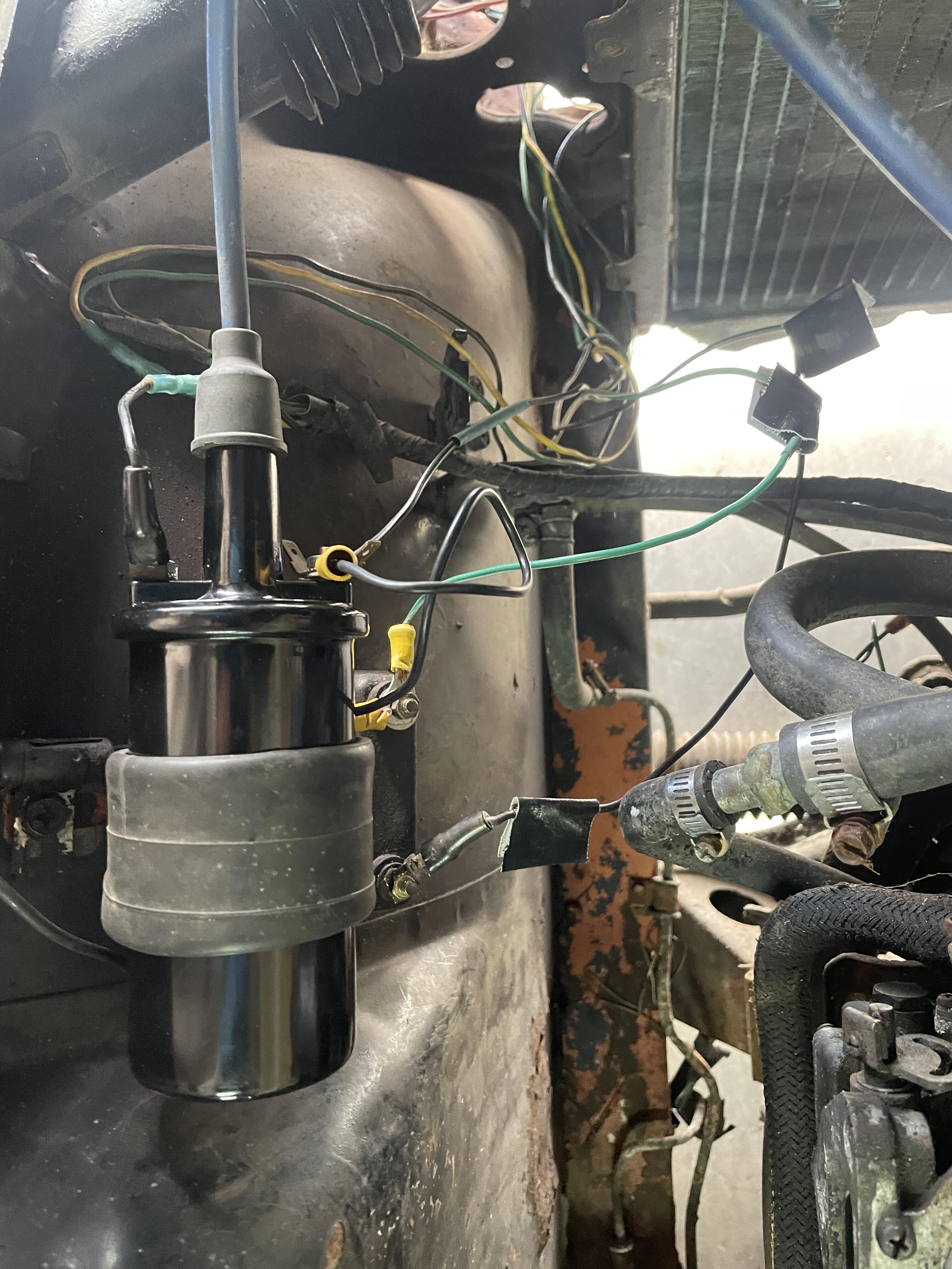

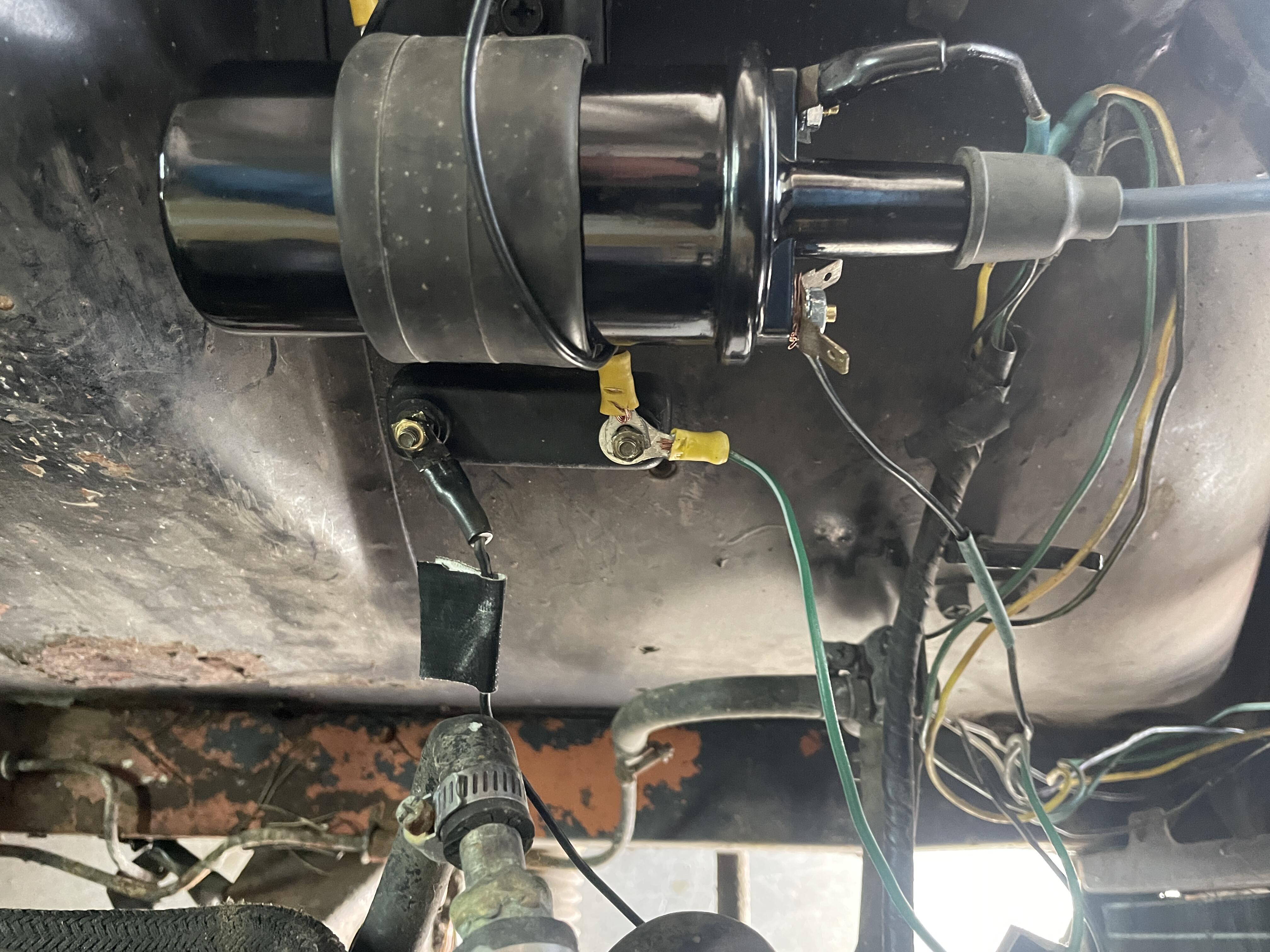

Ok. That makes sense.  That is what I will do next.  I think I tried to do that originally but had smoother wire also on the green wt terminal. That extra wire was the bw with no power. Maybe it was grounding the green out and stopping power? This is how I tried it in photo.

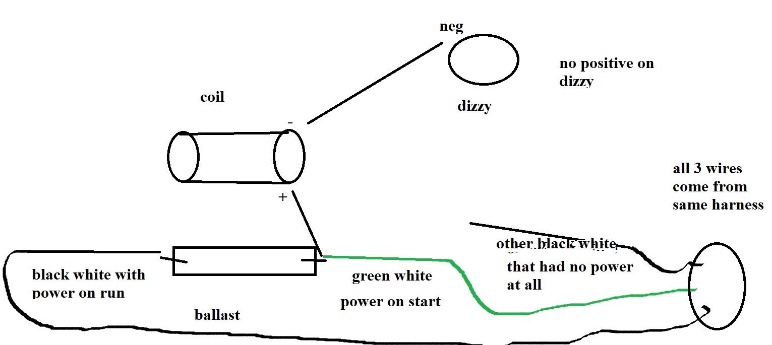

OK when you have it wired like I asked in the last post, start measuring for power at the - side of the coil and dizzy with the points open and the key in the run position . Stop trying to crank it over looking for a spark, We know there is no spark, by measuring the voltage path we can help you find why there is no spark.
Yes both are correct, please tell us what the volt reading is on the + of coil, - of coil, the neg point on the dizzy and at the points. Remember do this with the points open and the key in run. And your meter ground connected to the engine.

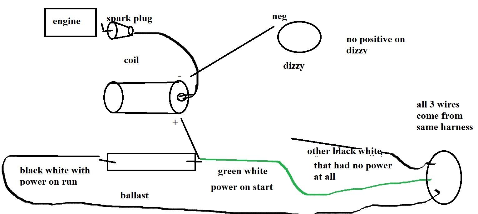

Not till you confirm you have a good 12 volts getting to the points. One thing you can do if the power is good to the points is rotate the motor until the points are closed and then with something non conductive open the points and see if you get a spark across the points. It is not always visible so you can try a few times pushing them open and then letting them close. If that looks good then try the same thing with a plug wire and plug like in your second drawing and see if you get a plug spark. This is of course with the key in run.

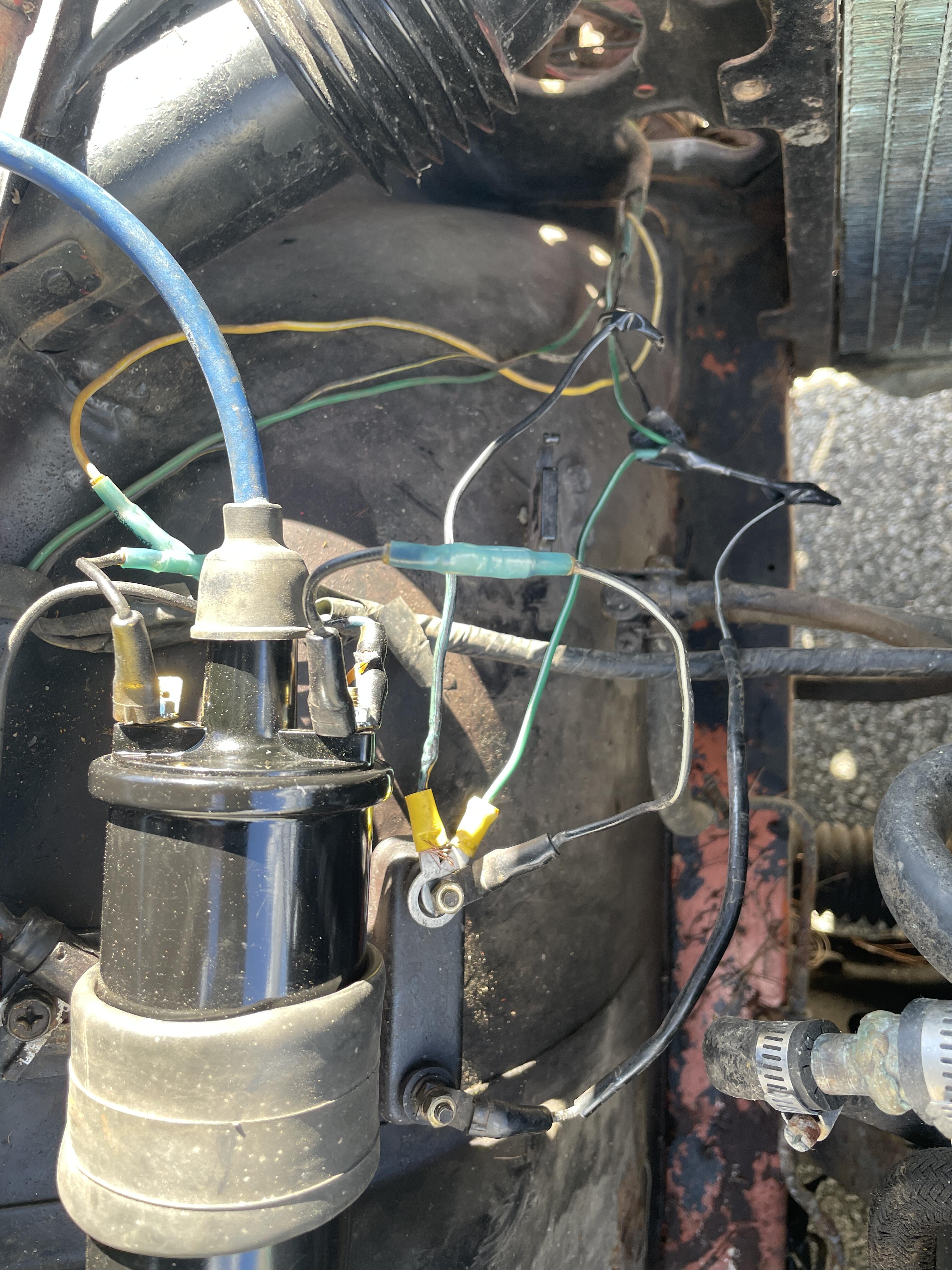

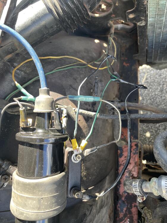

First thing is how is it that you have 12v at the green wire and zero volts at the coil I thought you hooked up a jumper between the two. What about the other measurements? Did you do the measurements with the points open? I thought we already decided that the b/w from the tach was bad and that’s why I got you to install a jumper from the g/w to the coil.
Yes  I did do the jumper as you can sorta see in photo below   Of course with jumper if gets 12v  as green wt is 12v  still no spark   No sure how this works  the black white on ballast has power all the time  it sends it through the ballast do now the green wt has power all the time and with a jumper the coil has power all the time    ??!
