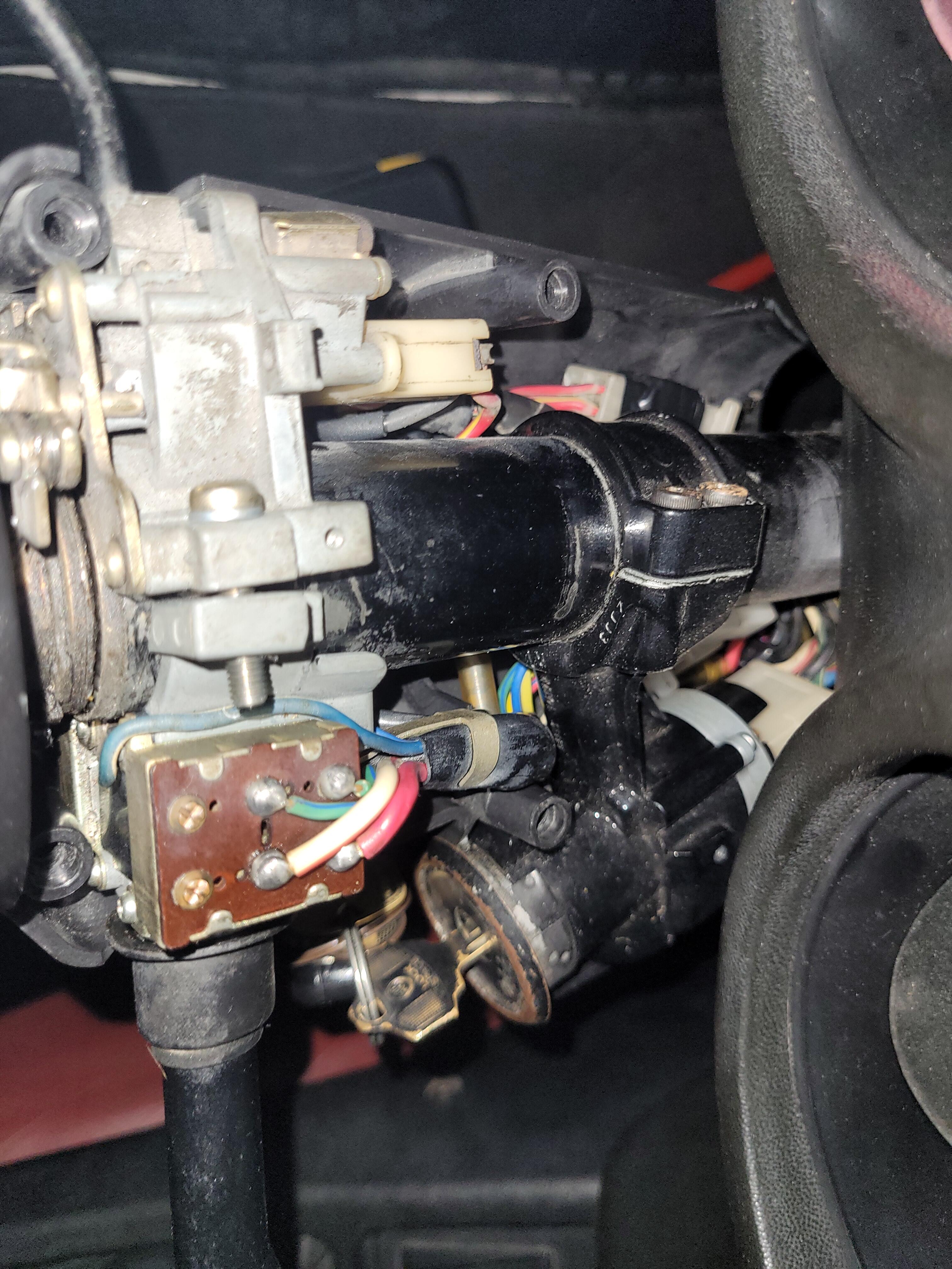

Just noticed the high speed position on the wiper Combo switch is no longer working. Should i just dump that old and tired wiper motor or could it be something else?

It could be the switch or the motor

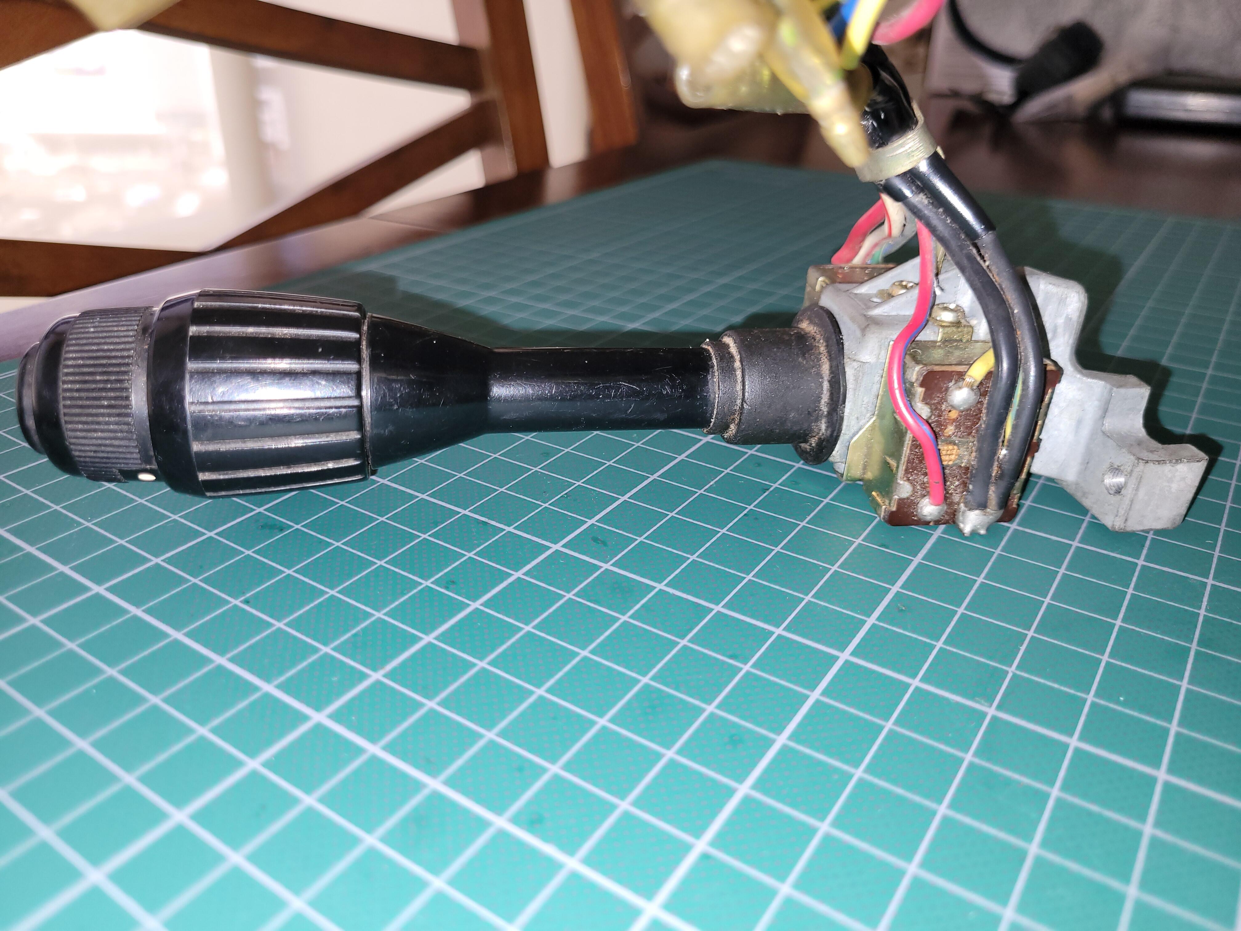

Anyway of cleaning the combo switch with contact cleaner. I was thinking on removing it and spraying some contact cleaner on its contacts. The weird thing is that yesterday it managed to work at high speed. I really dont want to get into that Honda upgrade motor where you have to modify the wiper motor base and other things.
I'm sure you can but I would first follow the instructions for continuity testing that Steve gave me in that post to make sure it's a good working switch before you attempt to take it apart and clean it. As for the Honda upgrade personally I don't think it's necessary if you take the effort to clean and refurbish the wiper arms pivots and other moving Parts on the motor. From what most people said in my research the lack of speed really isn't the motor it's the 50 years of wear and tear on all the moving parts that slow it down.

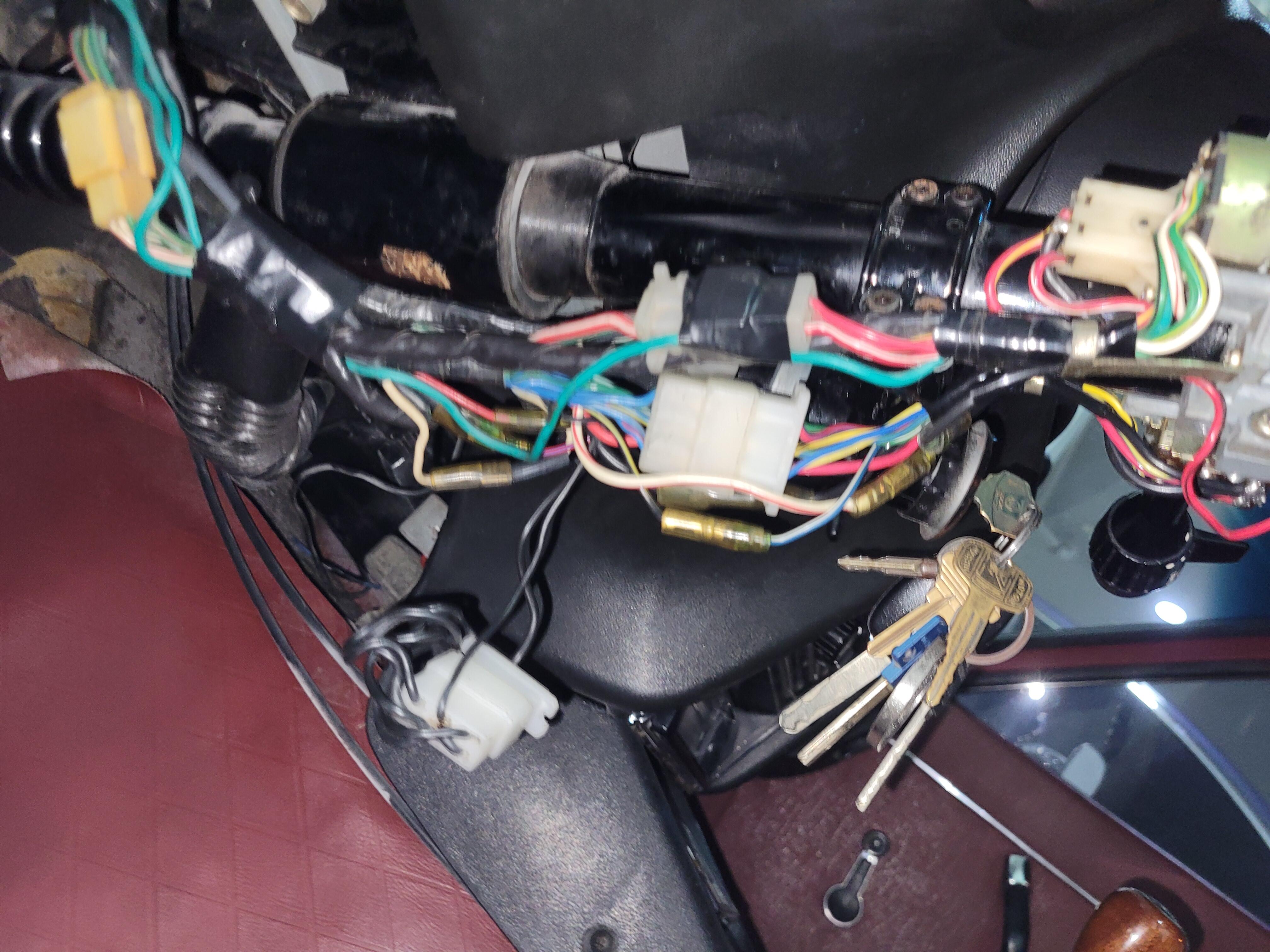

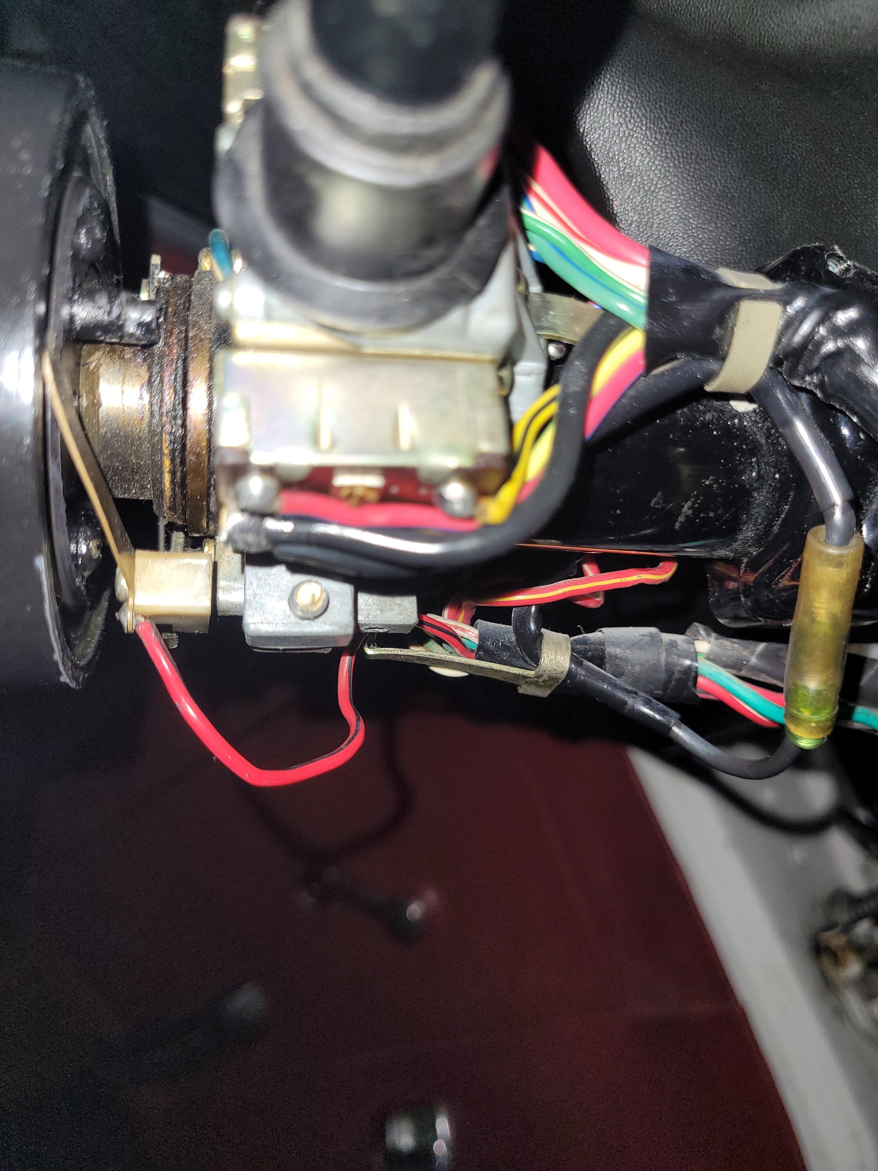

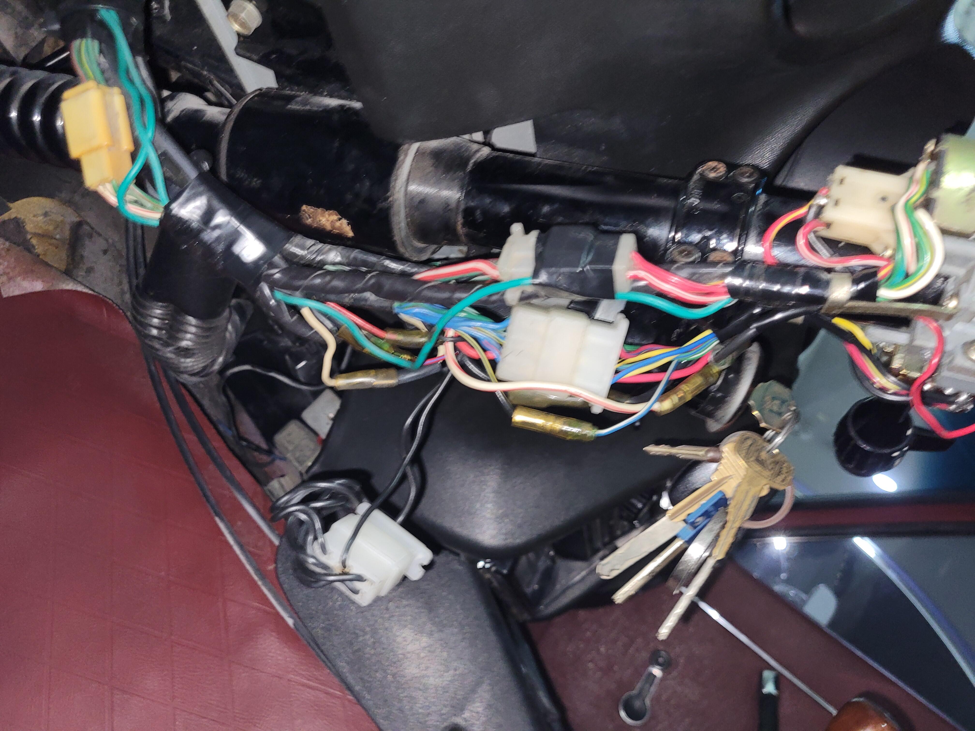

Yes just follow Steve's instructions disconnect the battery on the negative side take off the clamshell under the steering wheel disconnect the wires and harness running to the switch and you should be just fine I was able to test it while it's still connected pretty simple

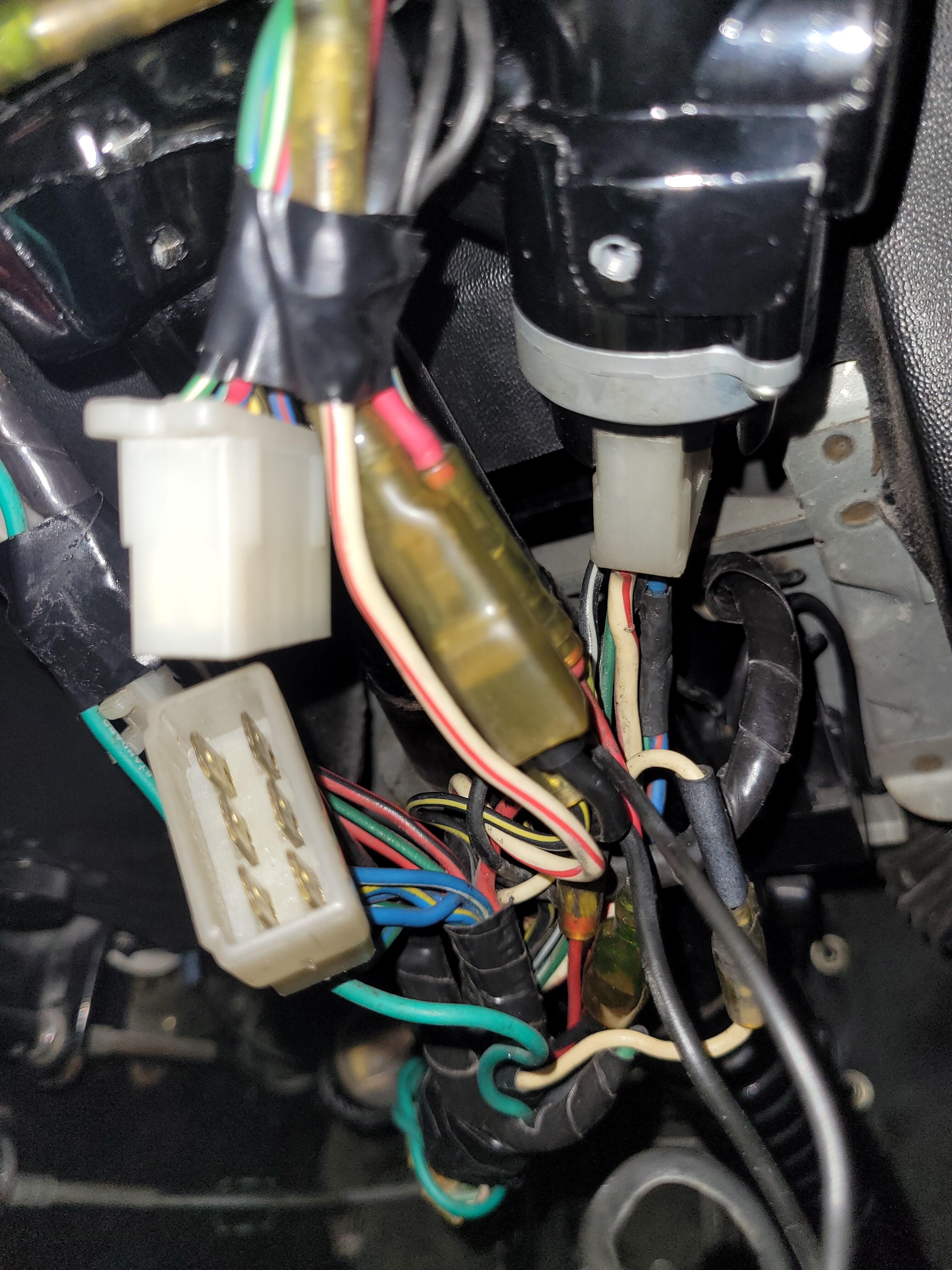

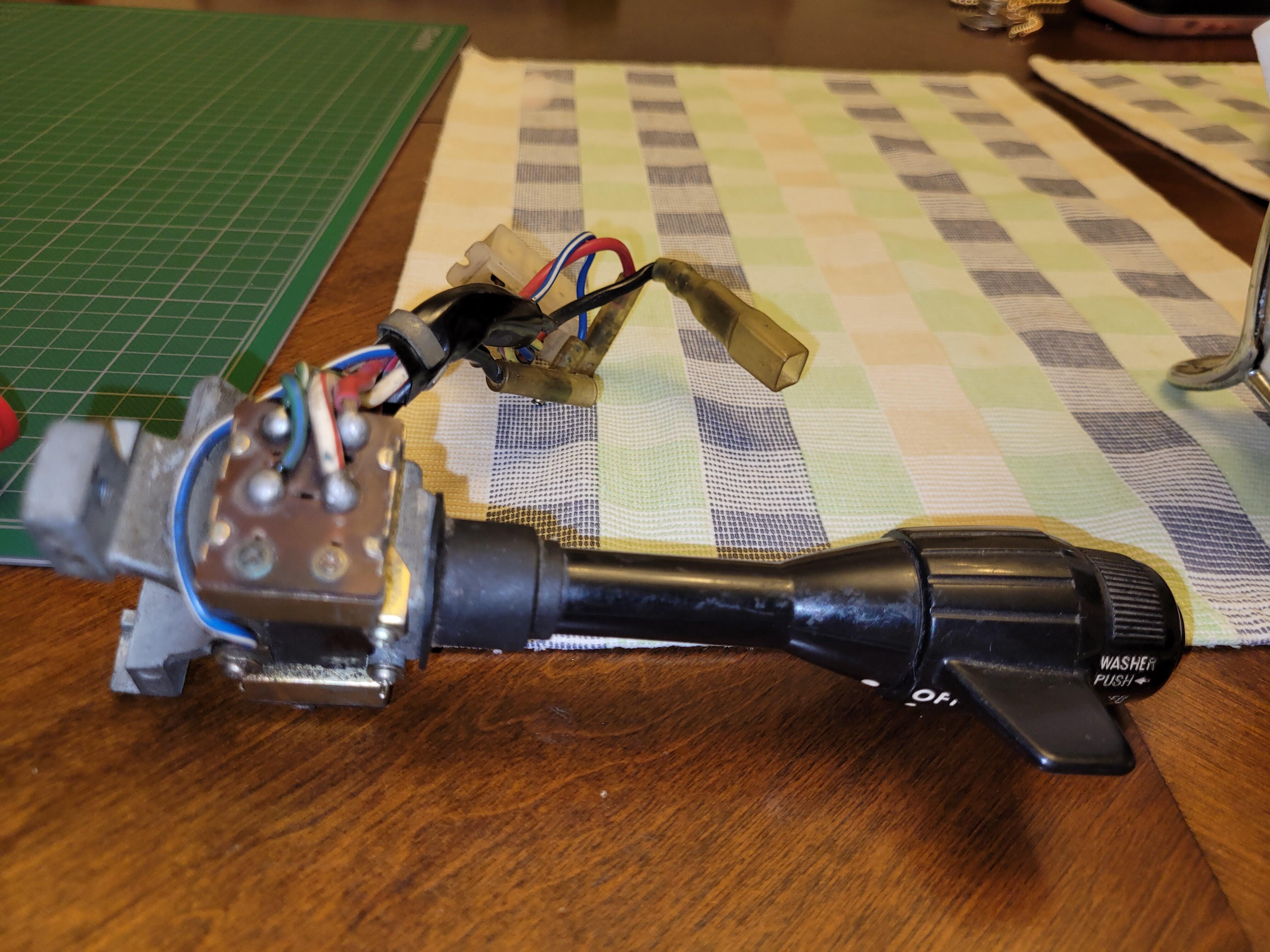

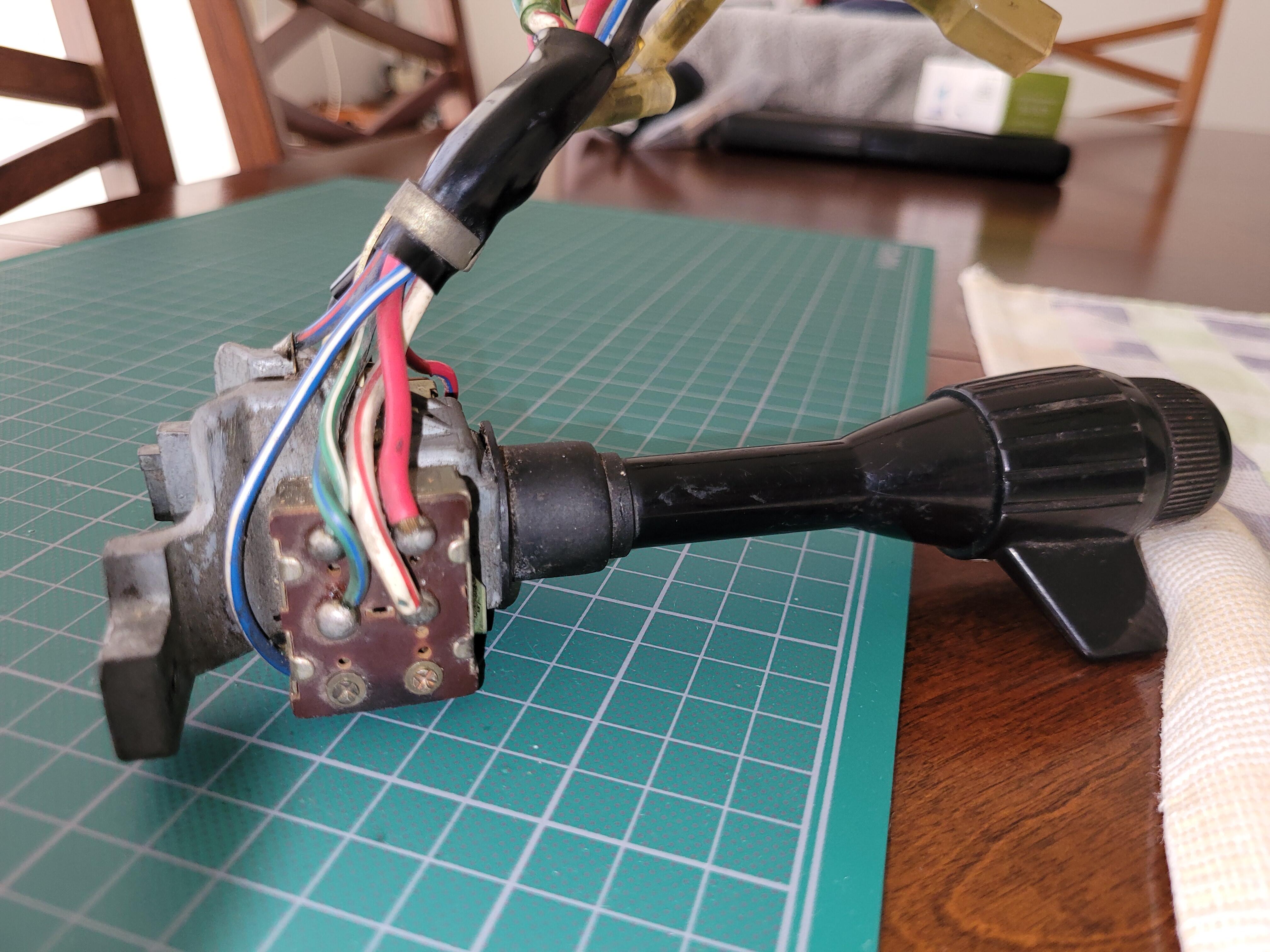

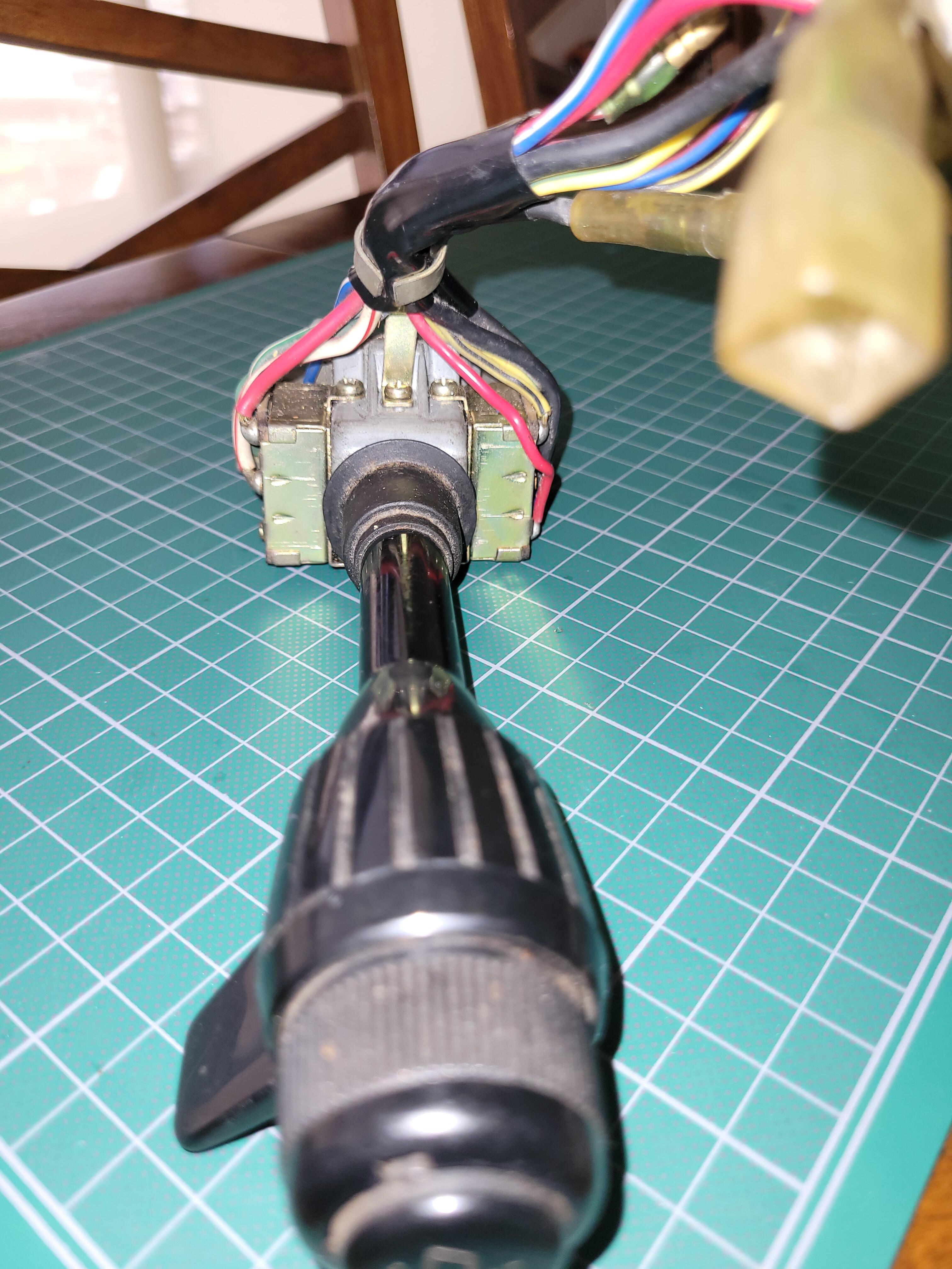

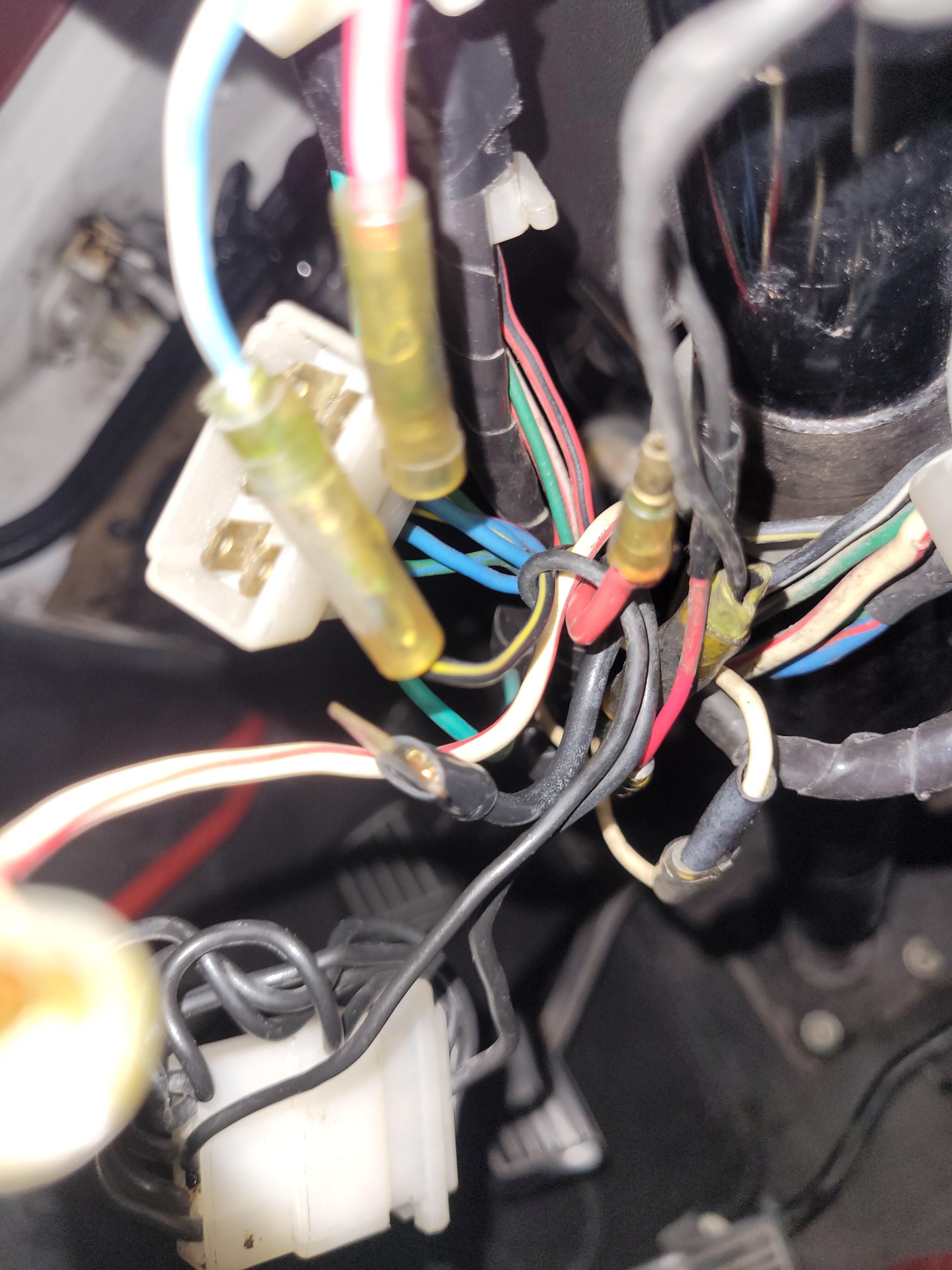

Well i remove the clamshell and took the combo switch out. Sprayed some deoxit d5 fader which i use on my fender, vox and marshall tube amplifiers when require some maintenance. Problem solved and now the high speed on the wipers is working. I did noticed that when i took the car to the shop for a short circuit some one unplugged Dave Irwins harness i had purchased and conected the female and male sockets directly as the car came from stock.

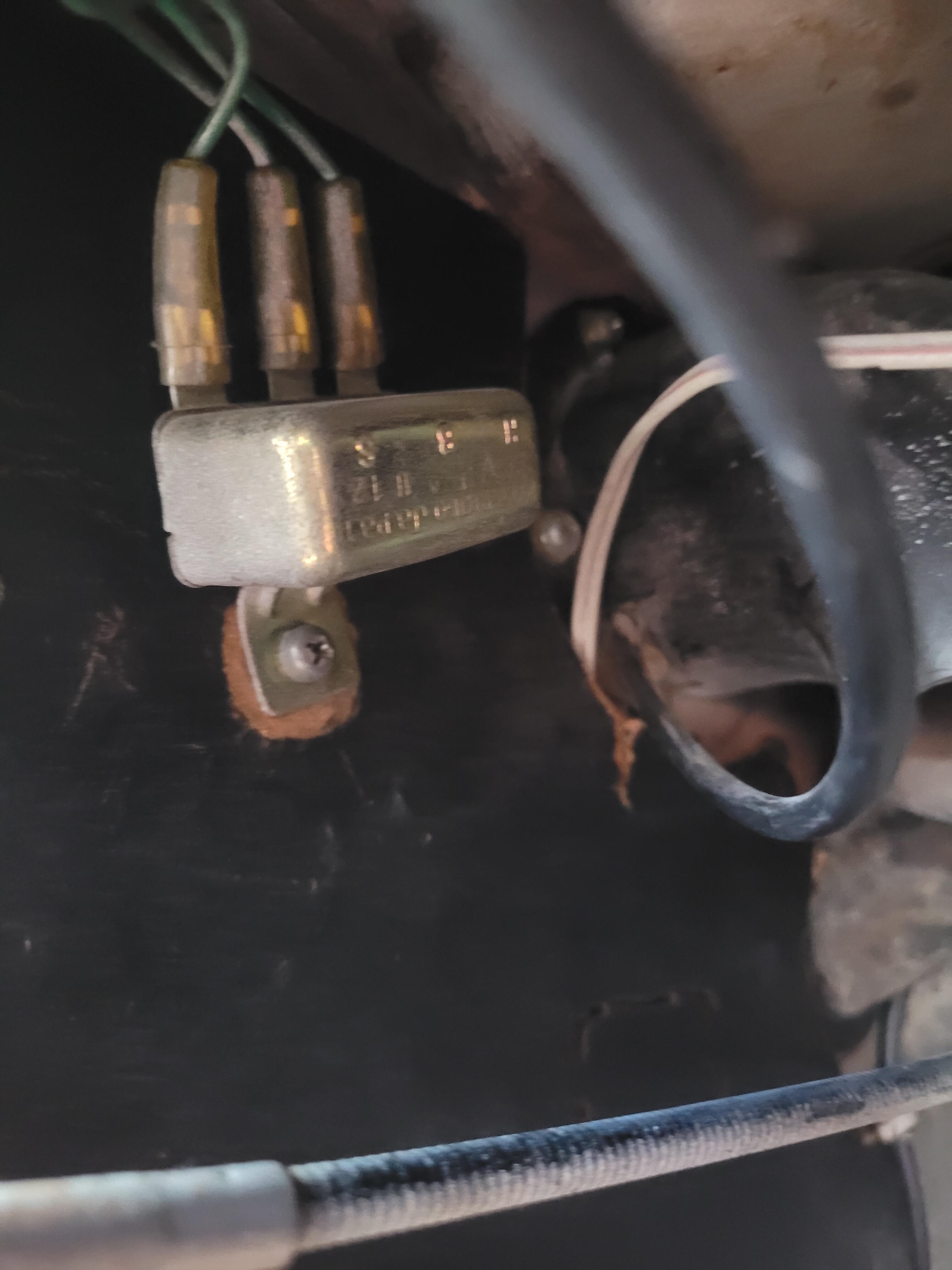

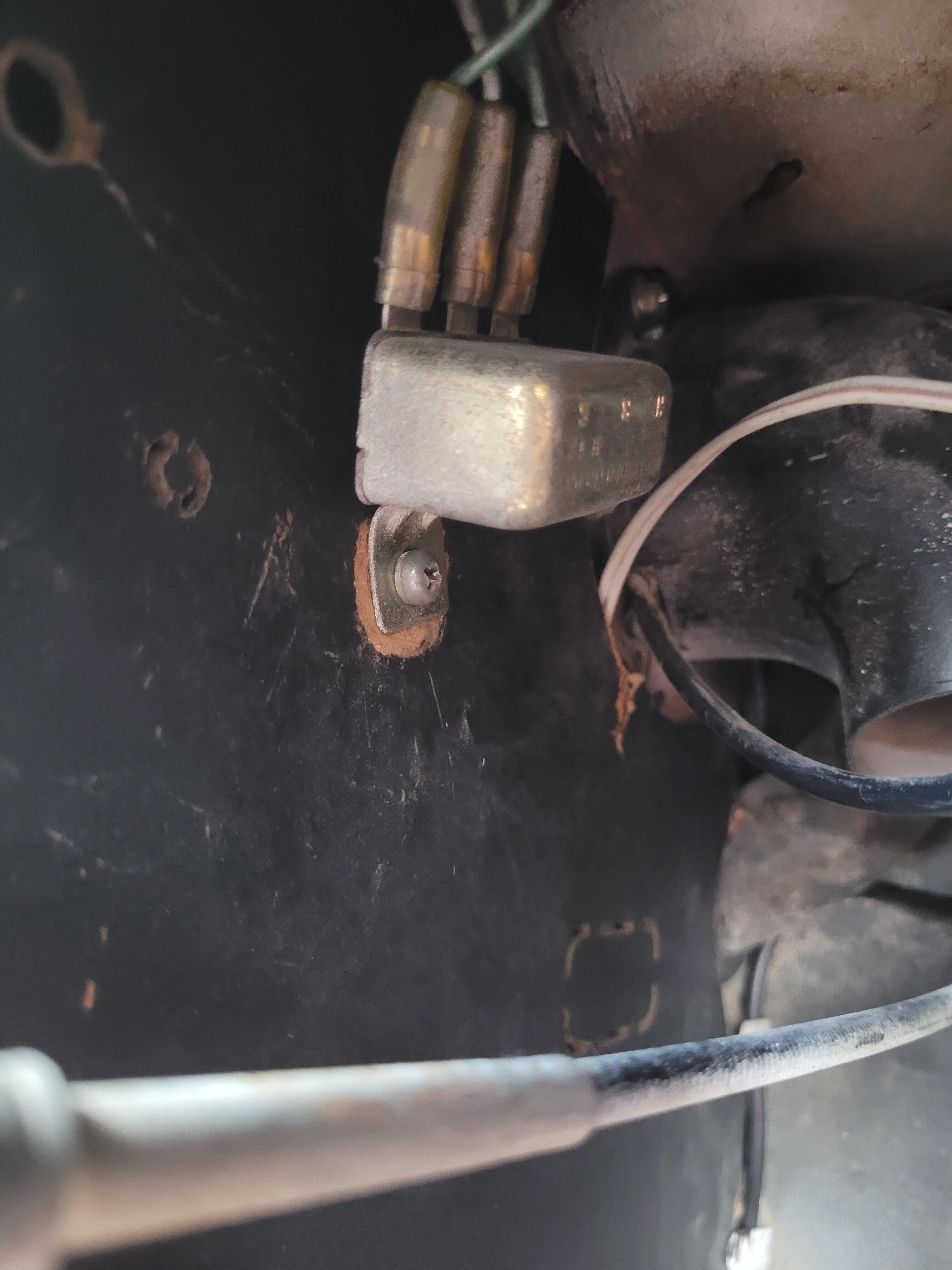

Well its supossed  to bypass the original harness to power up the dashboard and parking lights it also helps save your combo switch. Anyway im still having problems with the horn as it only really works when you are accelerating and not on idle. Maybe its time to change the original relay? What is your opinion concerning this matter?
