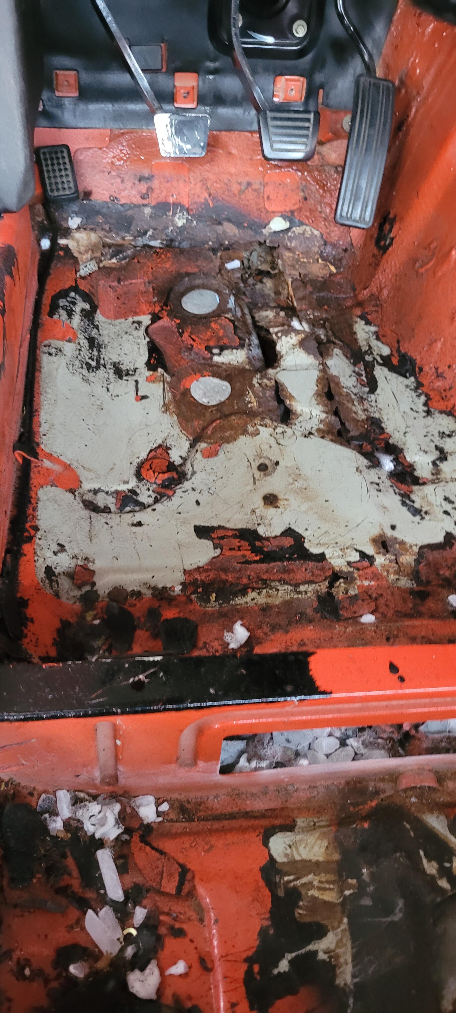

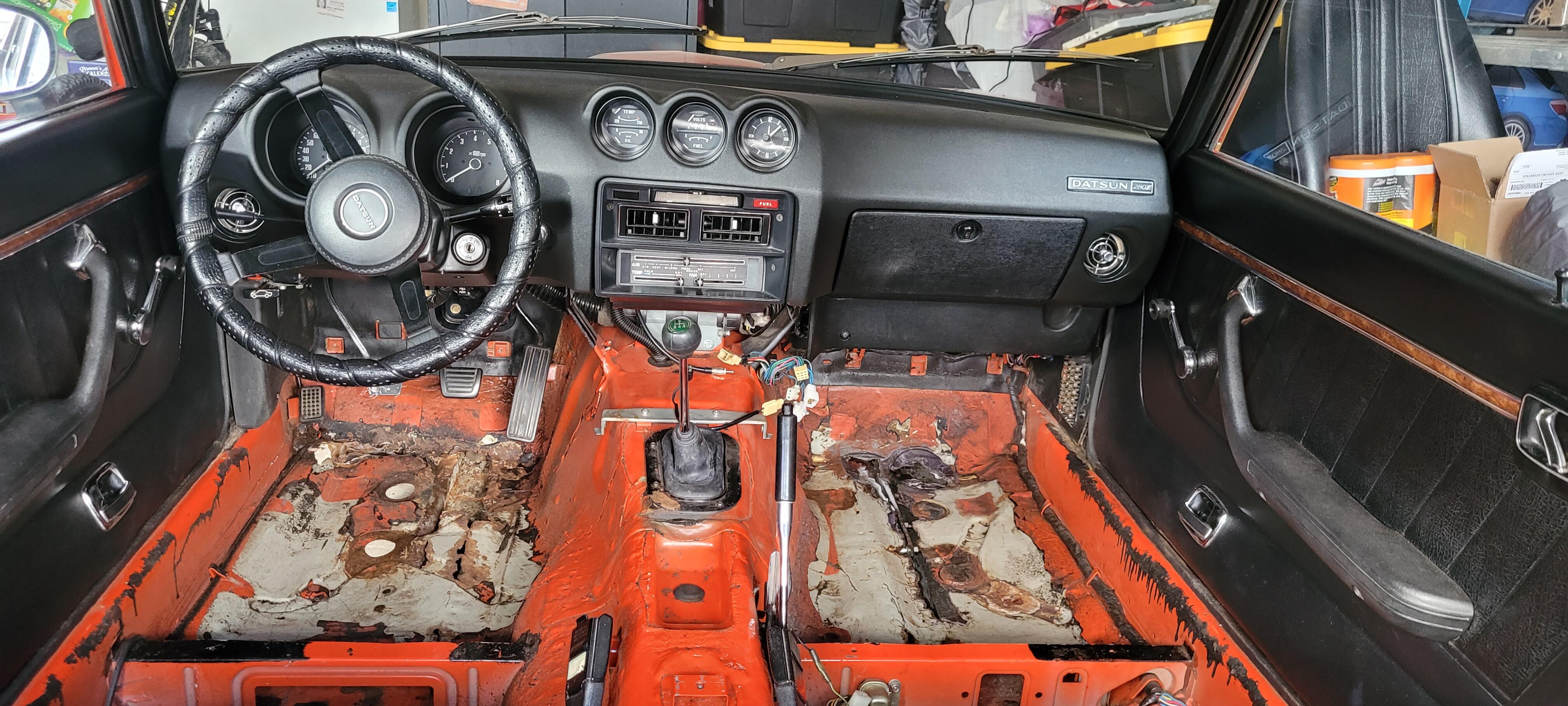

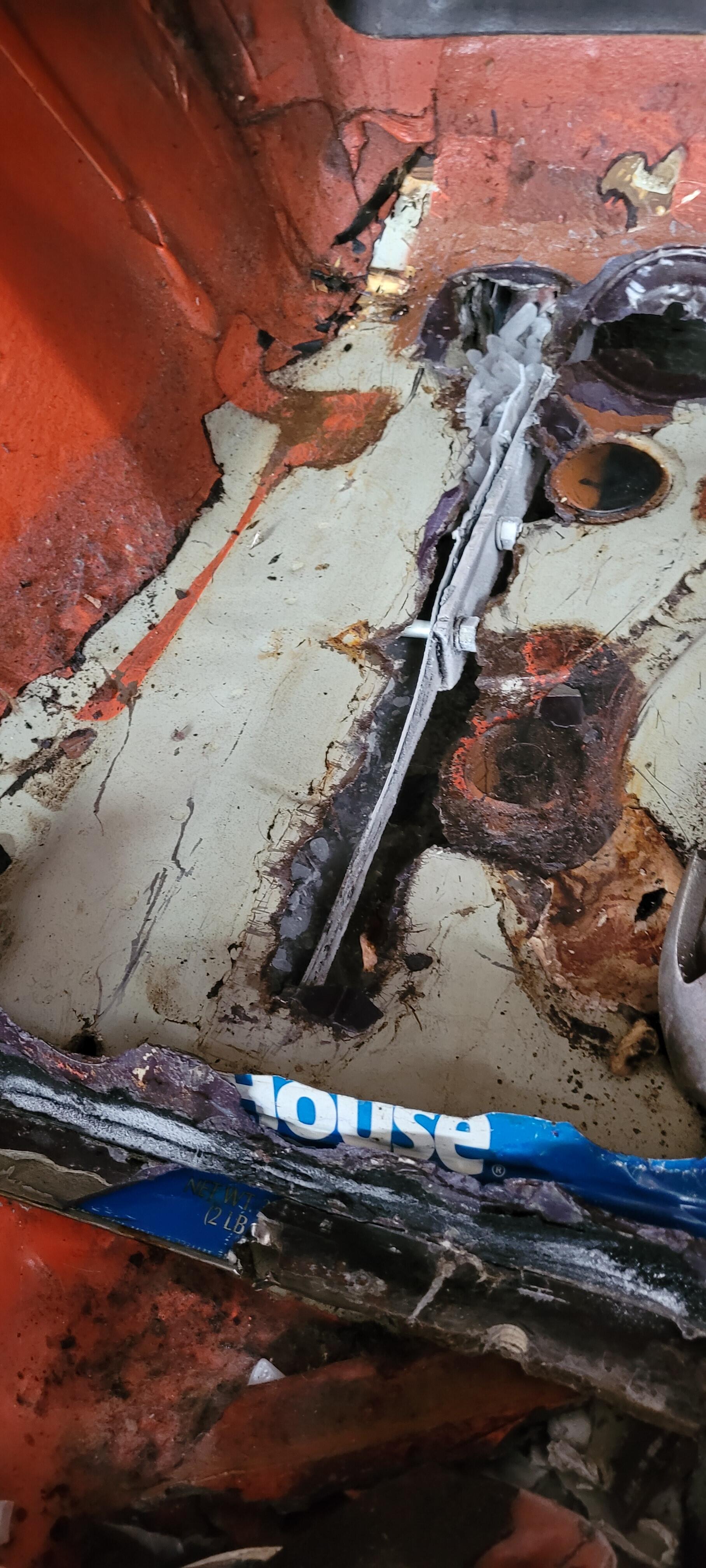

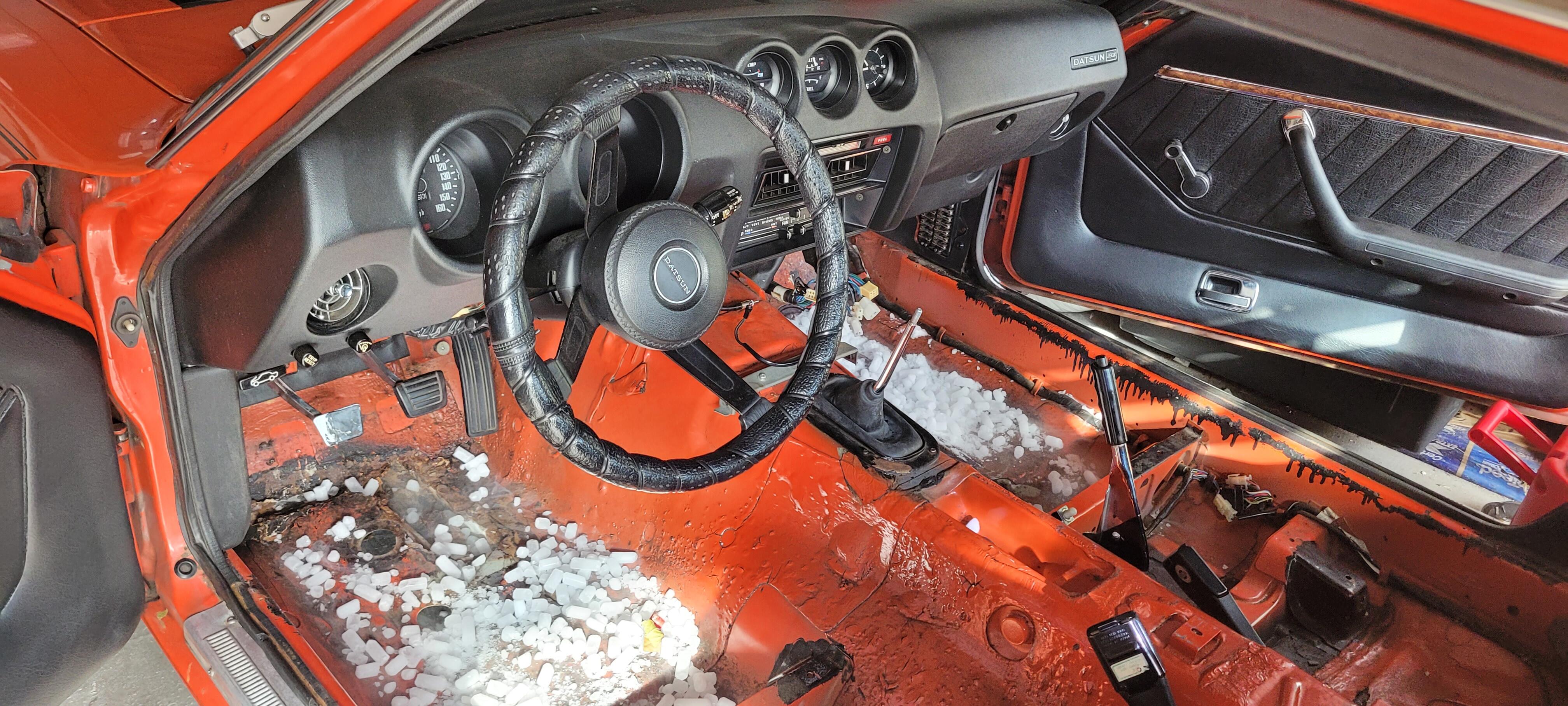

So I had some time this morning today to try the dry ice method to remove the tar mat from the floors and get a better idea of the extent of the rust and other non-welded repair work.  It was definitely easier than just scraping, but was more work than some of the YouTube videos would lead you to believe, unless I did it wrong.  Still, I was also able to turn it into a science lesson for my kids (who were off today for Thanksgiving break) to demonstrate the difference in thermal properties of differing materials.  My son seemed to think it was cool, but my daughter lost interest pretty quickly.
It looks like the driver side is the worst, especially at the front.  The passenger side appears to be localized along the rail, and it looks like there was a bolted repair performed on the rail.  They had put in more Maxwell House coffee cans along the passenger rail with some sort of rubberized coating, tar mat, and what looked like some Bondo.  Despite the holes, the floor feels solid in most places.   I guess I have some grinding to do now to get rid of the rust and see where I need new sheet metal.
   Nice, much better. How is the floor pans under the seats?  Your dash and door cards are in beautiful shape.
Much better viewing inside. Got any pics of the underside where those rails & floor meet the bulkhead? The type of issue that can arise is where there are multiple overlapping panels. This was on my X1/9
Once I removed that perforated forward section: multiple layers to address. That would be my concern with your level of visible floor rot
When you patch panels you have to consider how the new & old are joined - butt, lap, etc., you want to make sure you don't create water traps.
In the end, I cut pretty much all of it out, so I could fit the panel inside at the leading and inner edge and under/outside along the rocker & seat frame area, to match the original flow of the panel welds. You do want to investigate what path makes the most sense. Your DS looks like most of it should go, depending on what it looks like under the seat frame rail....
Thanks!  Driver side has some rust and a few perforations.  Passenger side appears to be in decent shape.
Yeah, I need to get under and take a more detailed look.  My initial glances are that it appears to be solid, and the mechanic that looked at it for me when I bought it didn't see anything when he had it on the lift.  I am looking into getting one of those portable lifts (maybe tomorrow if there are any good sales) so I can get under and take a look.  If not, I have four decent jackstands and just need to verify the jacking points are in good enough shape to support the car.  Of course, this will be after all of the requisite holiday festivities, decorating, and other activities.
