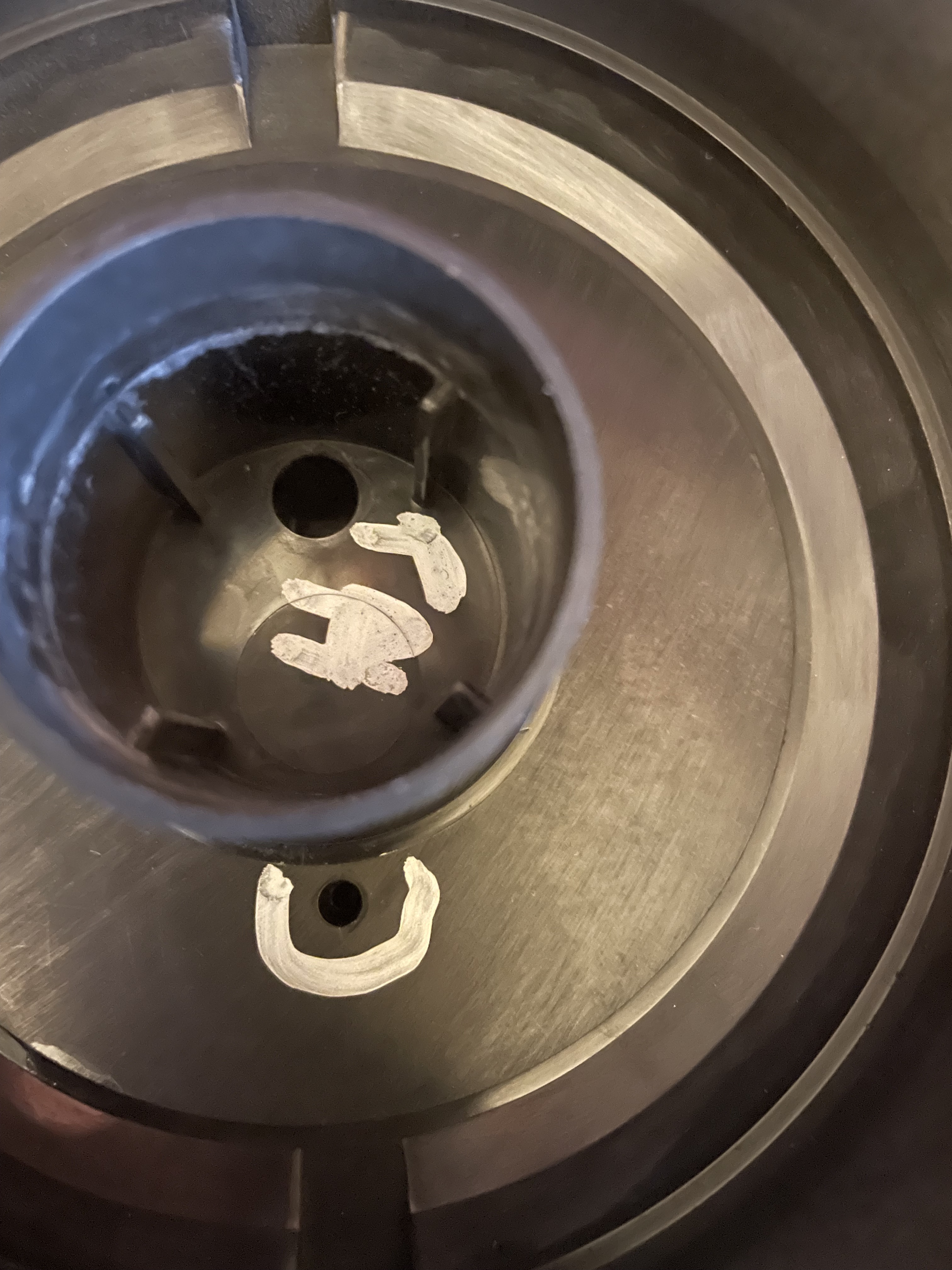

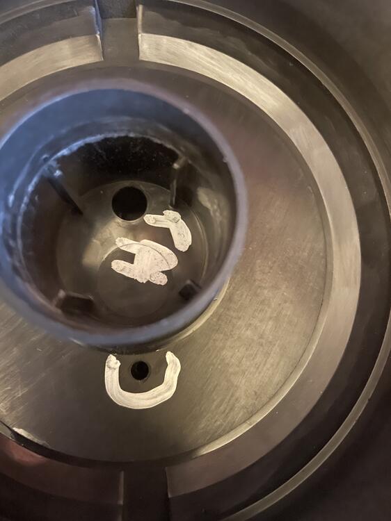

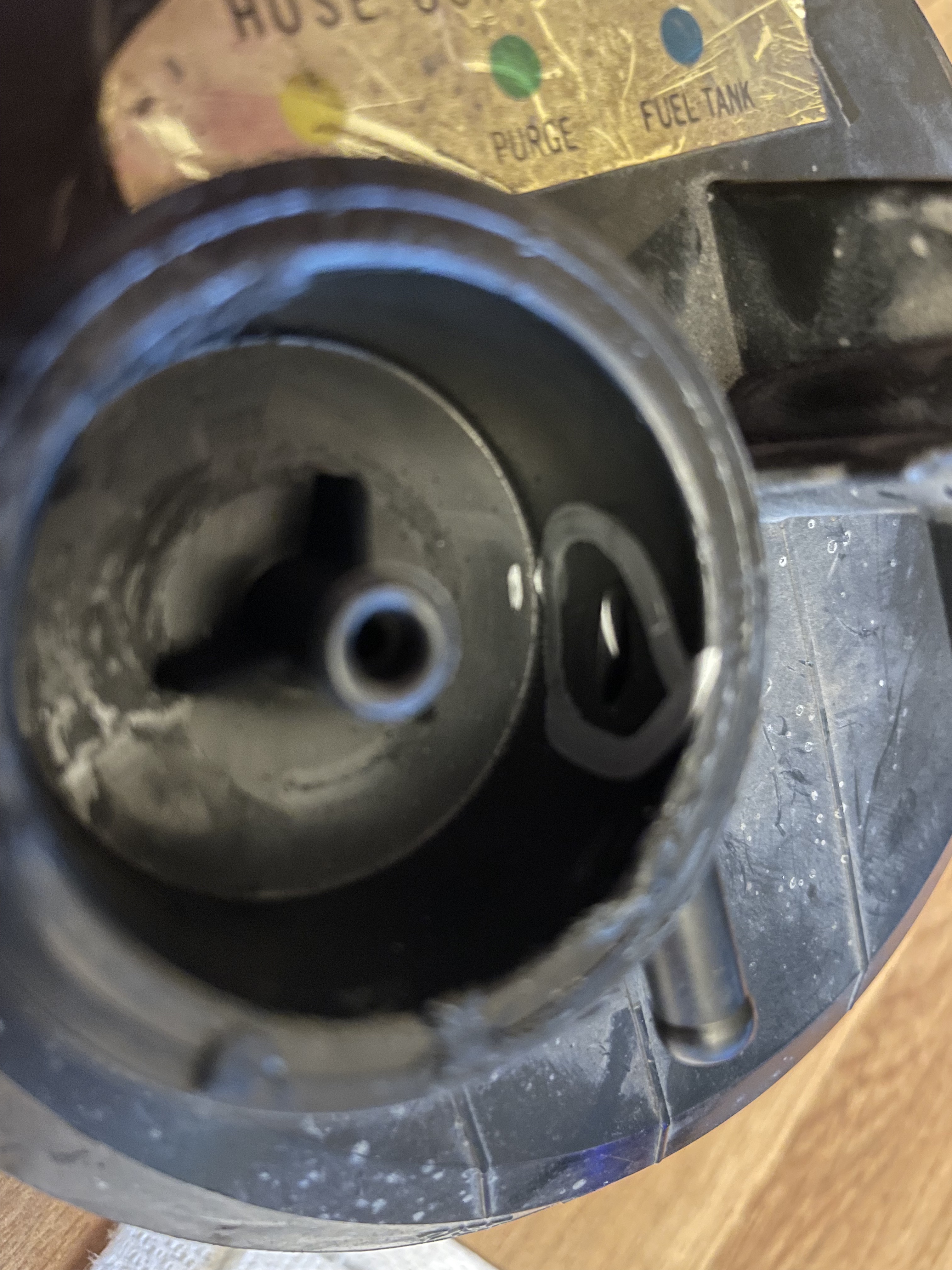

Following you now.  I see why the screw as you said was wrong.  The port is in the side of the chamber.  Sealed the top on now .  Thanks for that tip. I cut the 2nd one I had with same issue open:
And from under the top for reference it is on the side , the tank vent is in the center:

 I see why the screw as you said was wrong.  The port is in the side of the chamber.  Sealed the top on now .  I cut the 2nd one I had with same issue open:
Exactly. The only way the port into the side neck of the canister gets down into the carbon part of the can is through the little hole you plugged with a screw.
I suspect that many of the original purge valves built into the cans don't work correctly anymore and I think your use of a new aftermarket purge valve is a cool innovative way to get around that. You just missed the mark a little bit with your original implementation.

FYI - opening the second unit I had (which was the original 1977 unit) all the internals were in fine shape.  nothing wrong with the filter pads, charcoal or segregation grates (dont know technical term here)
