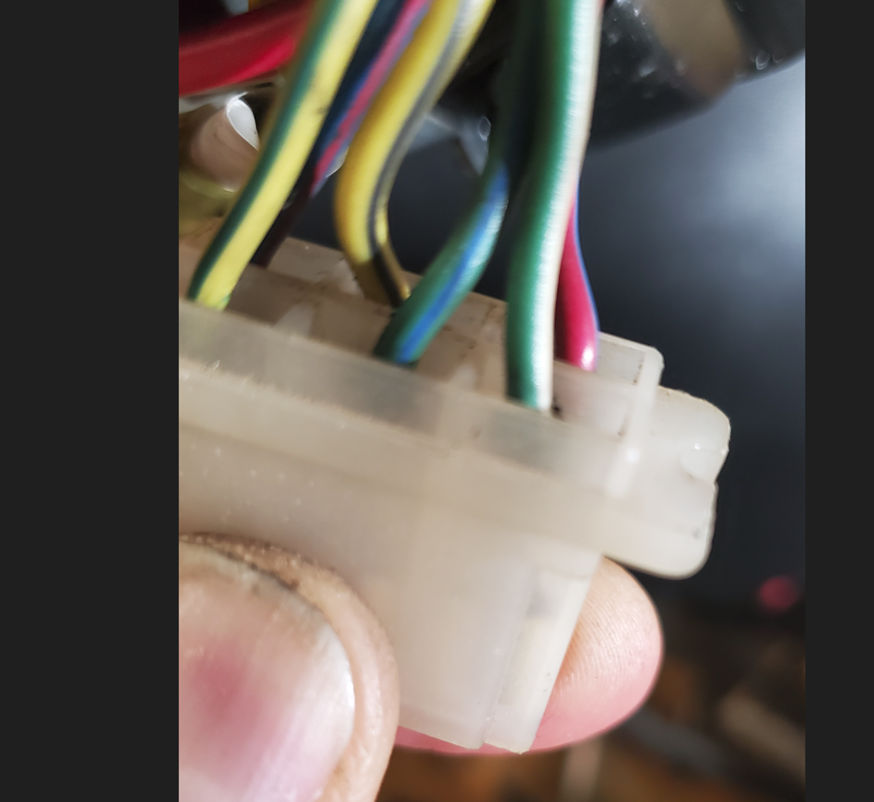

I do have a 6/71 so i am late model series 2.  If I understand this right, the engine bay connector to the wiper motor harness is the same for early and late and that's exactly how my engine side is setup.  Now I have to get under the passenger dash area to see which of the two type connectors I have? Once I know, am I doing a continuity test from the passenger side to steering column connector B for the 3 blue wires?  I took that pic a while ago so i'll have to go back open clam and see what B looks like.  If this pic is still accurate then i can see there are for sure 4 blue wires some striped and twogreen.  theres no black from this pic and seems all 6 are occupied.  I'll report back.
Oh and if this matters, I think the PO used a 72 dash harness becasue I think when i was fiddling around in the console area something made me realize or assume that.  i think it was the length of maybe the fuse box connector.  Maybe if the PO did use a 72 that's why my B connector is different?

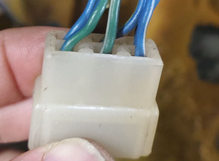

Took the clam apart, looked at B connector here is what I got.
Notch on top
Top Row G-L, G-W, L-W
Bottom Row L, L-Y, L-R
Switch Side
Notch on Top
Top Row Y-G, G-L, G-W
Bottom Row L-R, Y-B, R-L

Thanks.  Took another look and I'm guessing this is the right connector pair, at least for my car.  The second pic that had some of the yellow wires in it is the only connector coming from the combo switch and those wires are directly connected to the switch we were testing.  The first pic is the only corresponding 6 pin connector under there to match up with and everything works on both sides of the column other than the high speed motor.  Now granted I have no idea what the PO did as for custom wiring, but it "should" be the right set of wires if not the right type of connector.  Maybe he combined wires from smaller connectors not sure.  there's a few single wires left over coming from combo switch in either bullet or flat type connector that all line up with the ones from the harness.

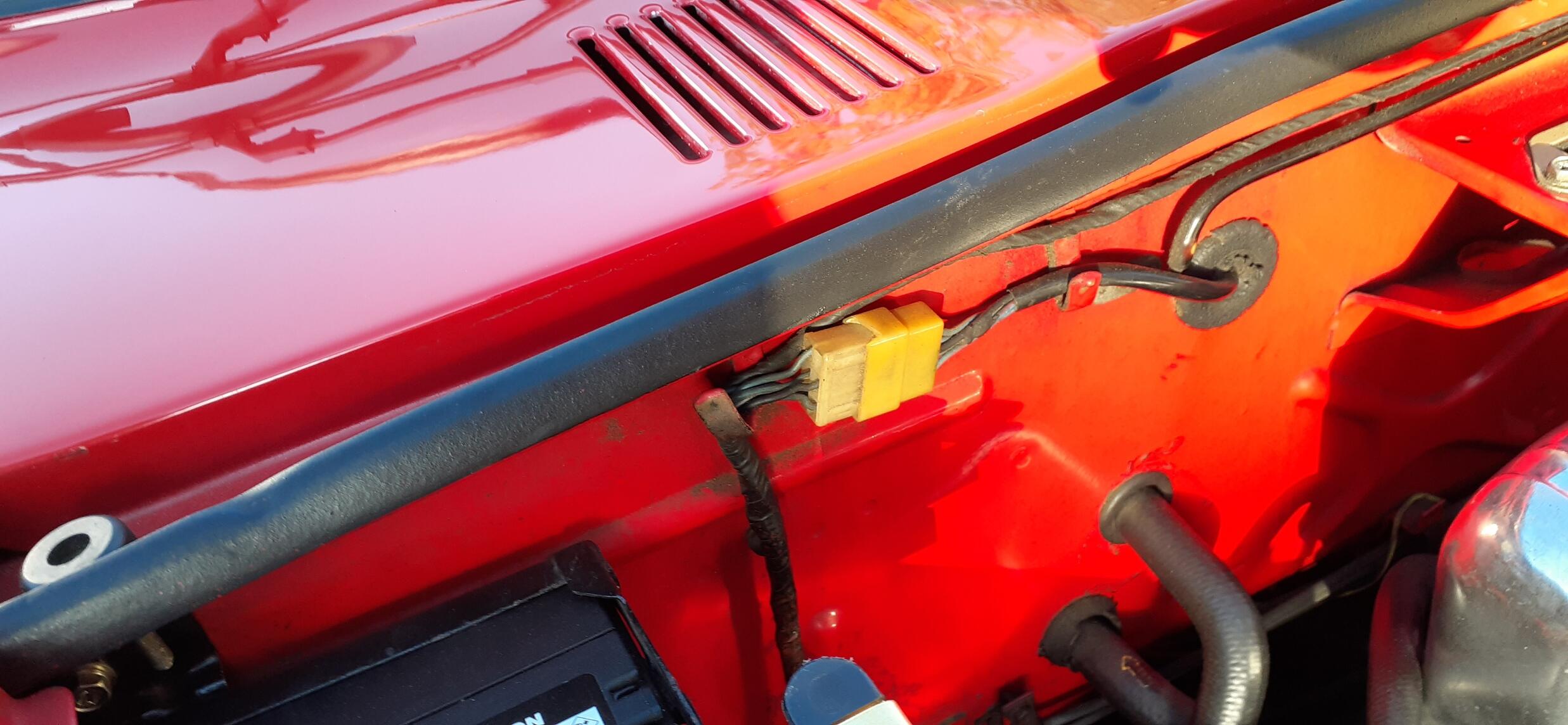

So the connector for the wiper motor in the engine bay should be like this:
Note that it only has 5 wires.
For the combo switch connector, the dash harness side should be this:
GL GW LW
L    LY   LR
So your connector on the dash harness is correct.
On the switch side, you should have
YG GL GW
LR  RL  YB
So your switch is correct.
Verify the dash to engine harness connectors and wiper motor connector per my earlier post.

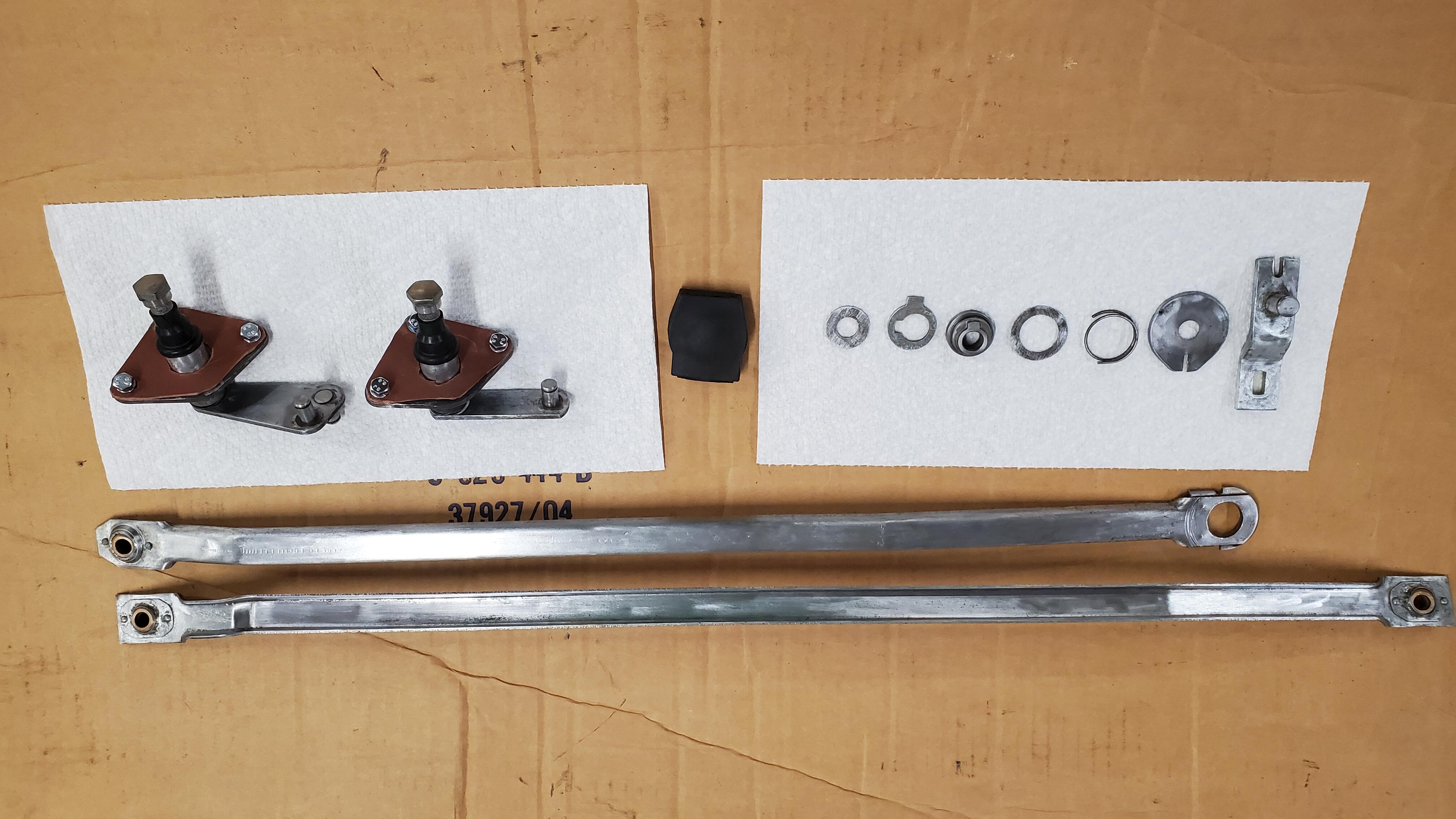

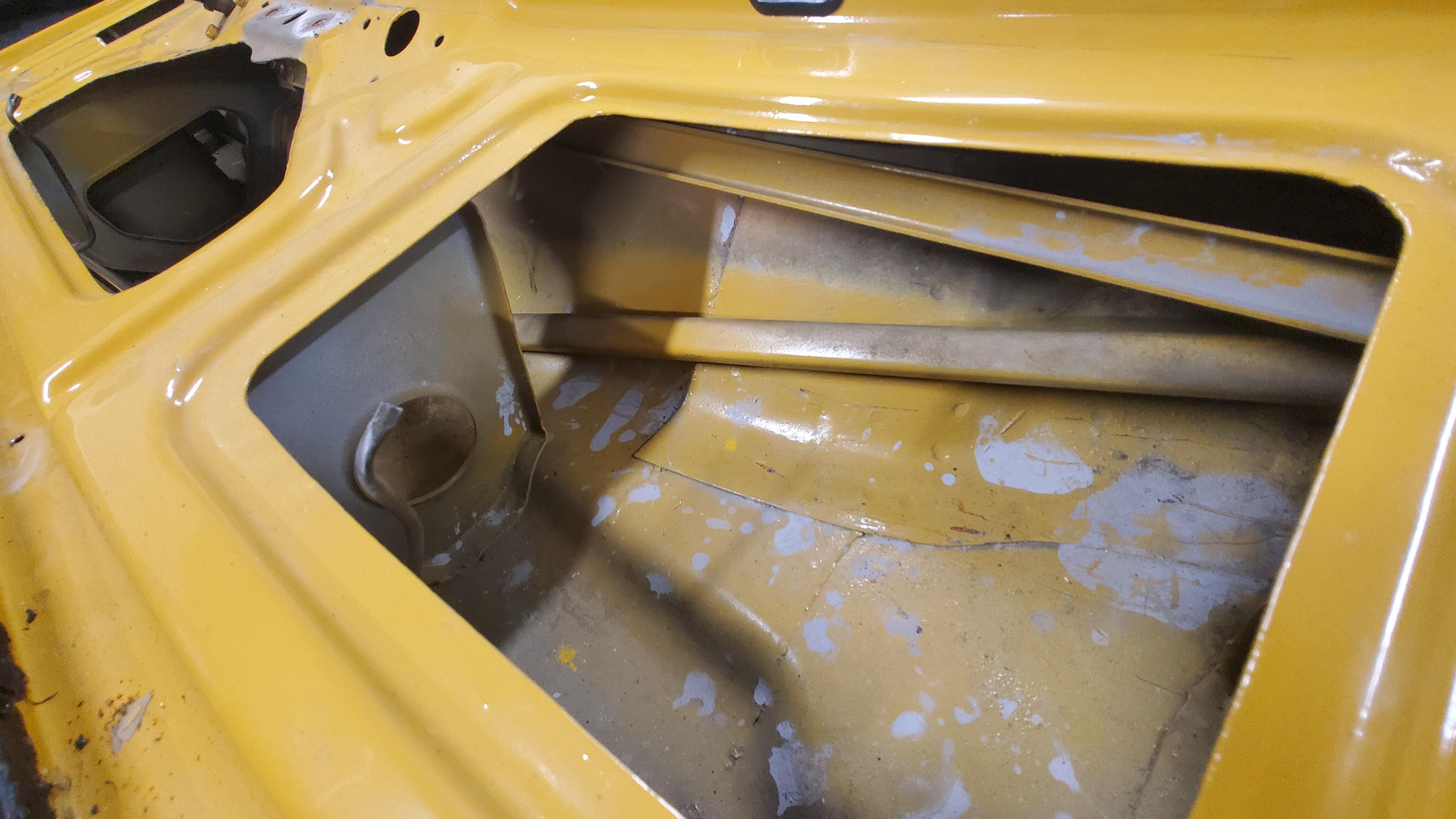

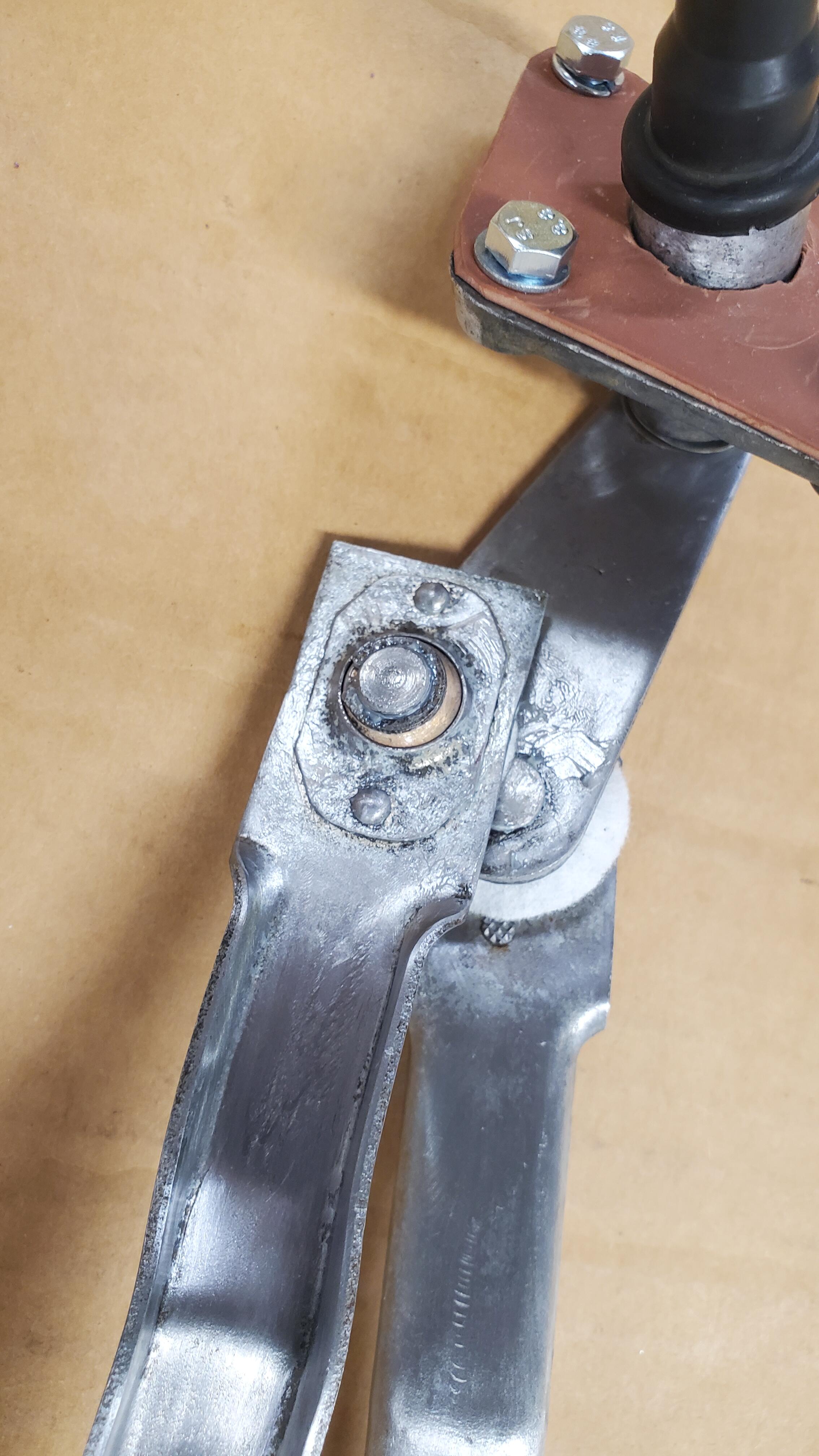

So this started with removing the cowl and man what a mess in there.  the PO in their attempt to paint must have just painted this car with the cowl in place because as you can see here he painted over the arms and the motor and bag (no pic).  So lazy!
So i went about tearing it all down, degreasing and striping the rust and paint, and ended up like this

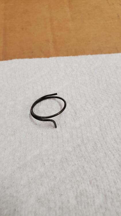

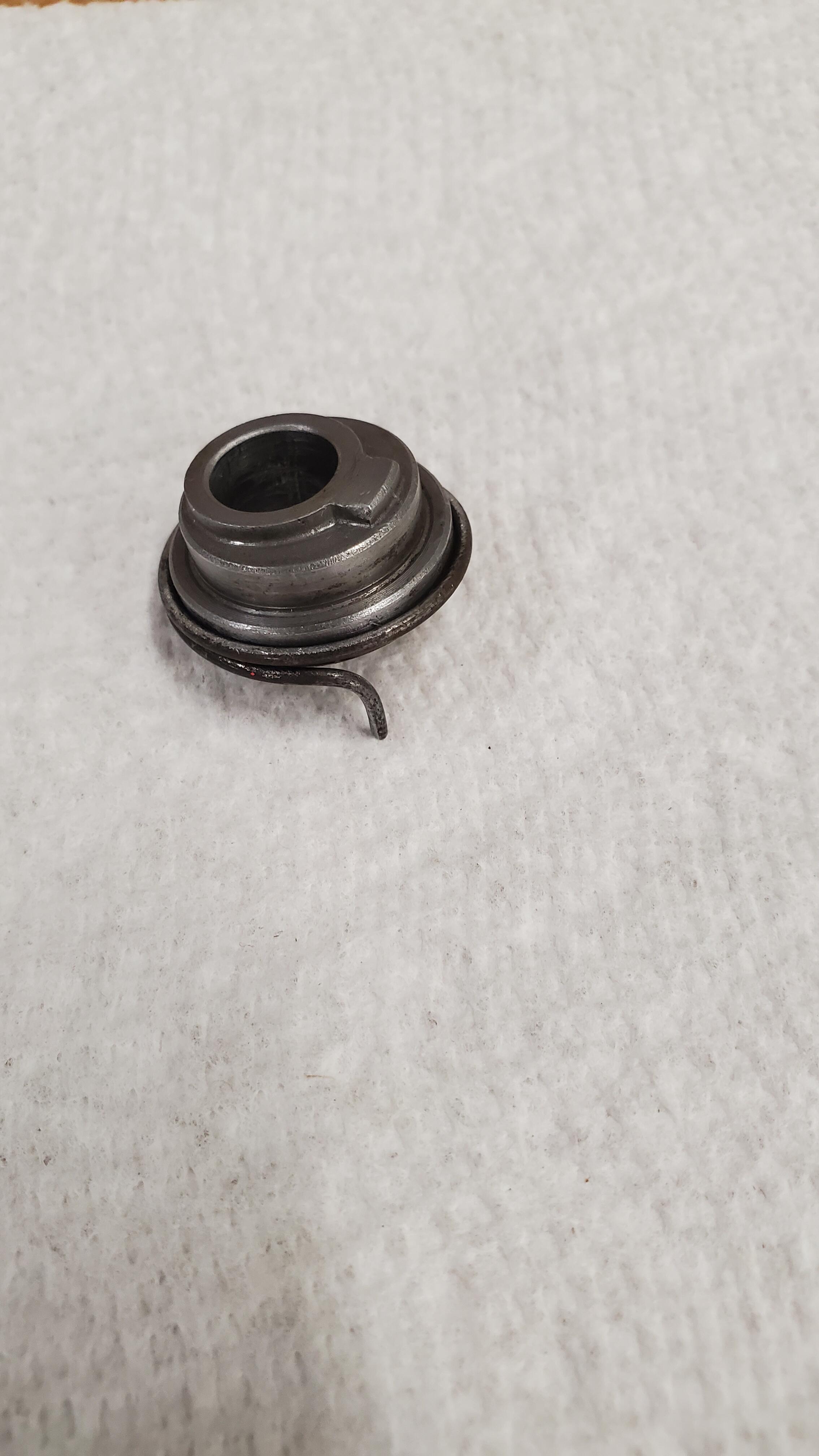

I had to make those rubber gaskets and sourced some new bolts but everything else came out real nice.  You can see the original spring is still there but it was broken like pretty much every other one in the world.  I found some pics from hybridZ i think that showed what it was supposed to look like and thought I might find a replacement at home depot to fiddle with.  Well that didn't work out so well because if you look at one of these the wind is reversed from pretty much any generic compression or torsion spring i could have sourced.  So i ended up recompressing it and bending the tip up and it came out pretty nice
you'll notice its a little less than half a turn shy of complete but in the end it works great.

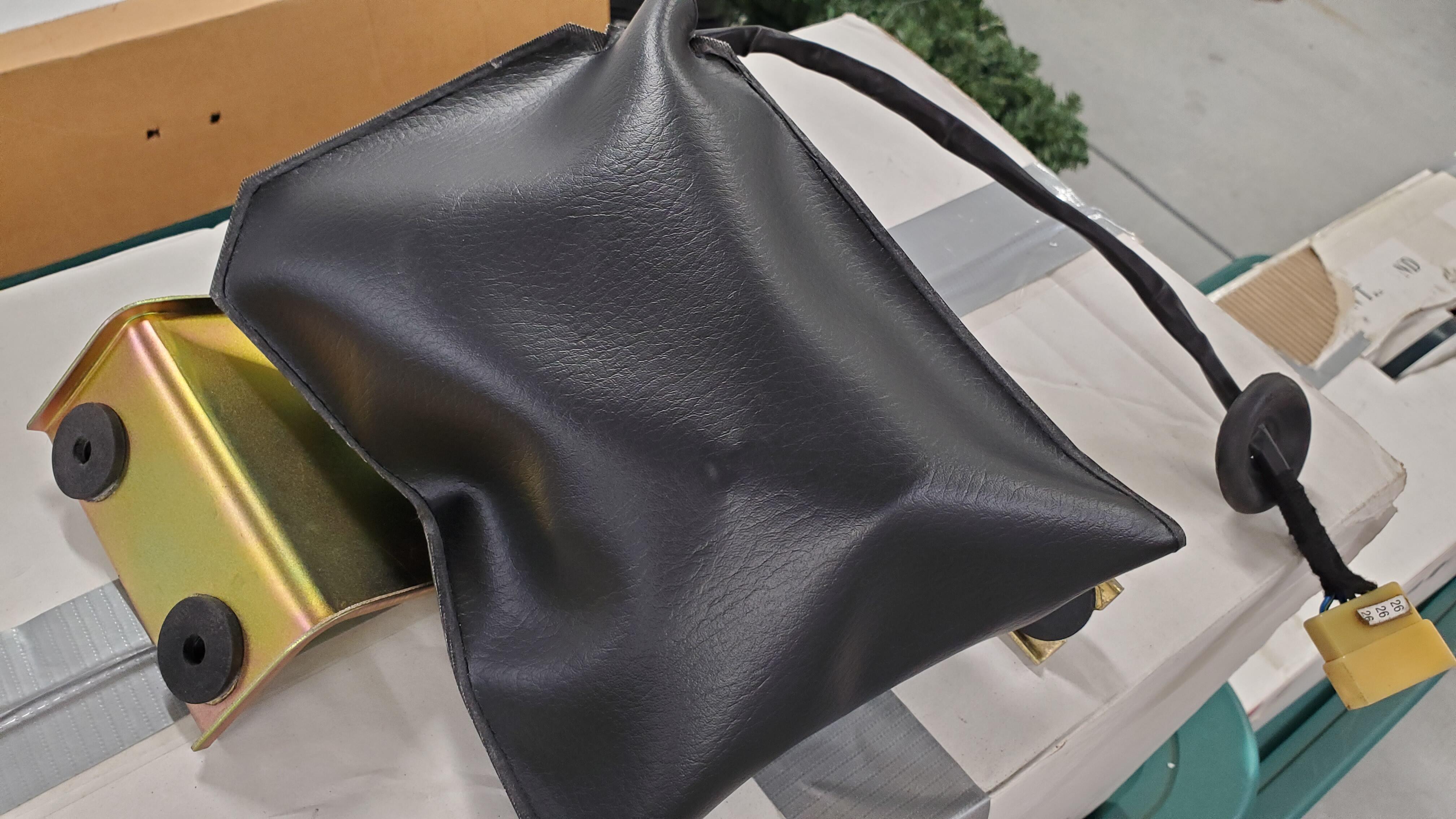

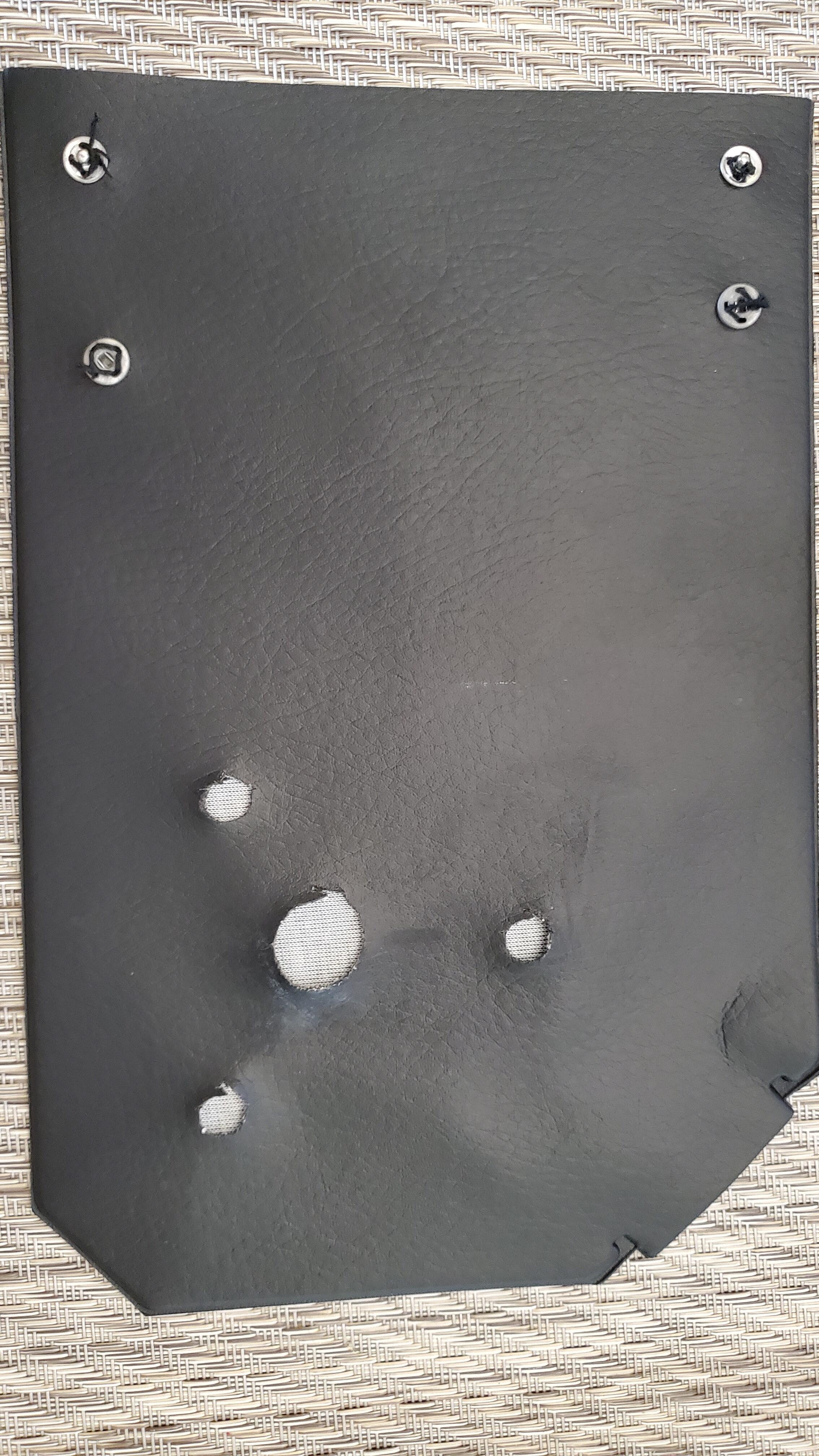

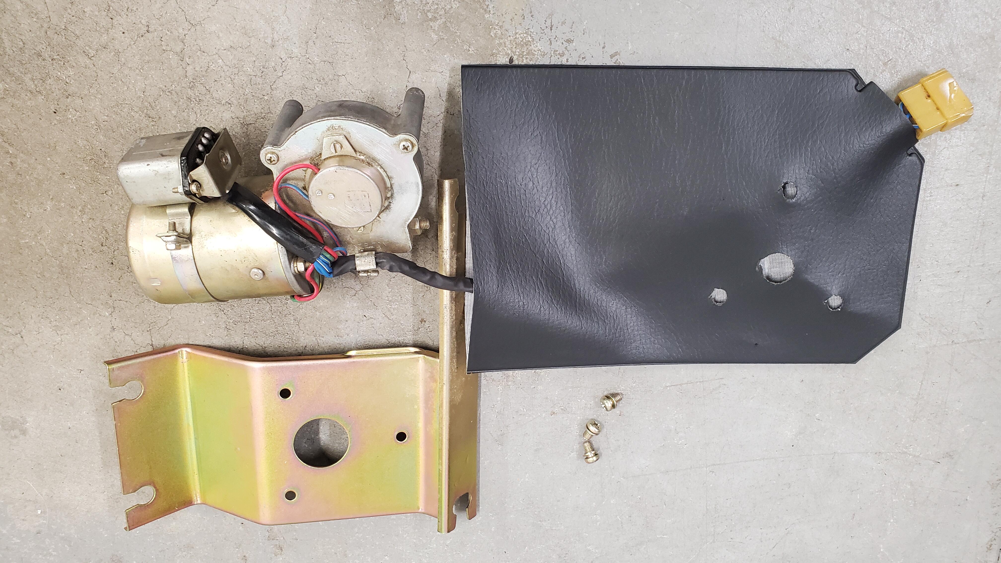

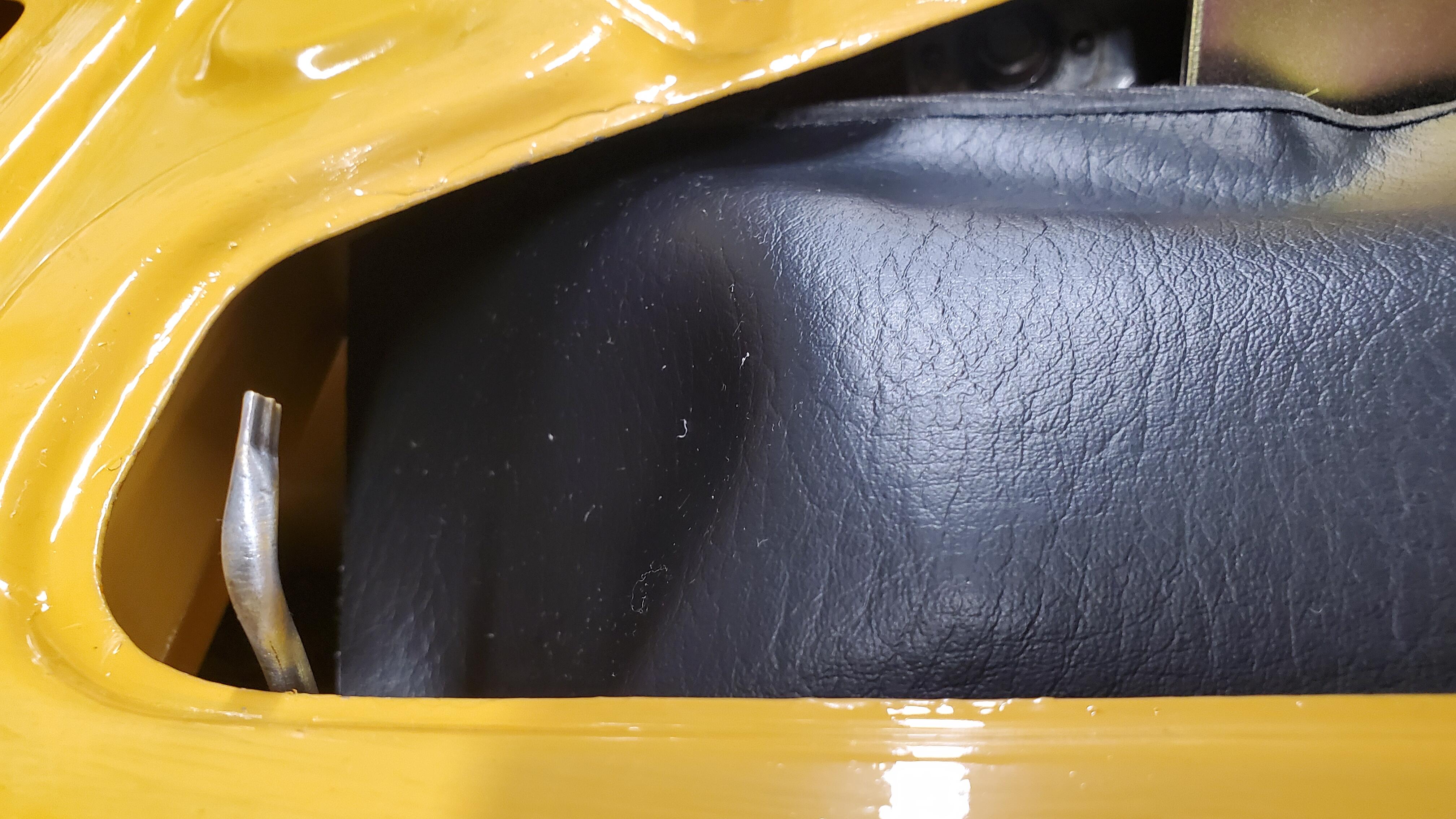

The new vinyl bag finally arrived from Banzai (Distinctive Industries) but I noticed there was no way to really close the end of it unless you glued it or maybe sewn it over the motor.  Didn't want to do that so i sewed on some simple buttons that can snap it shut to keep the bag nice and tucked under the motor

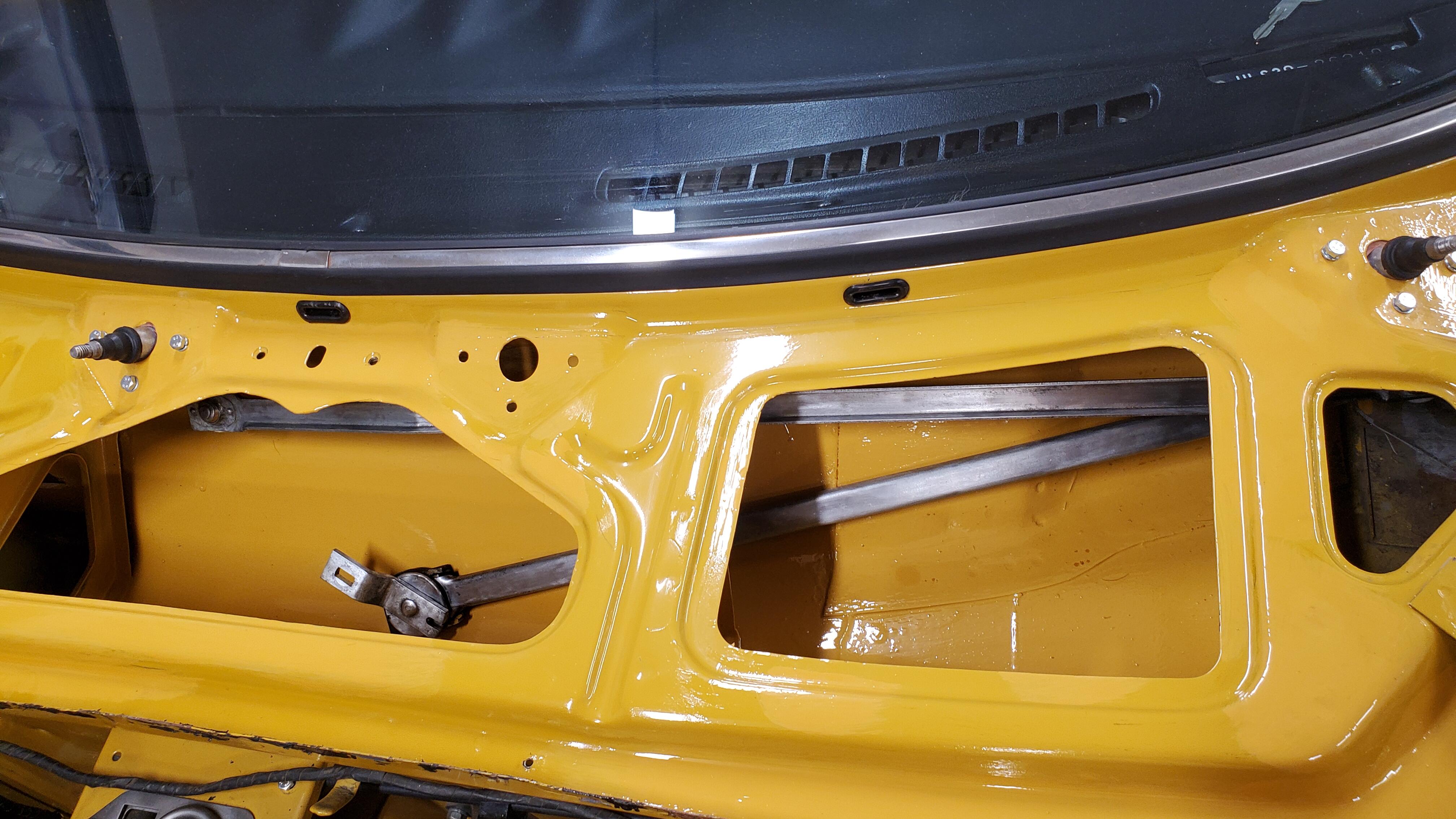

I ended up repainting as best i could the interior of the cowl and addressed any surface rust that was present around the cowl frame and reinstalled the arms, what a freaking difference!

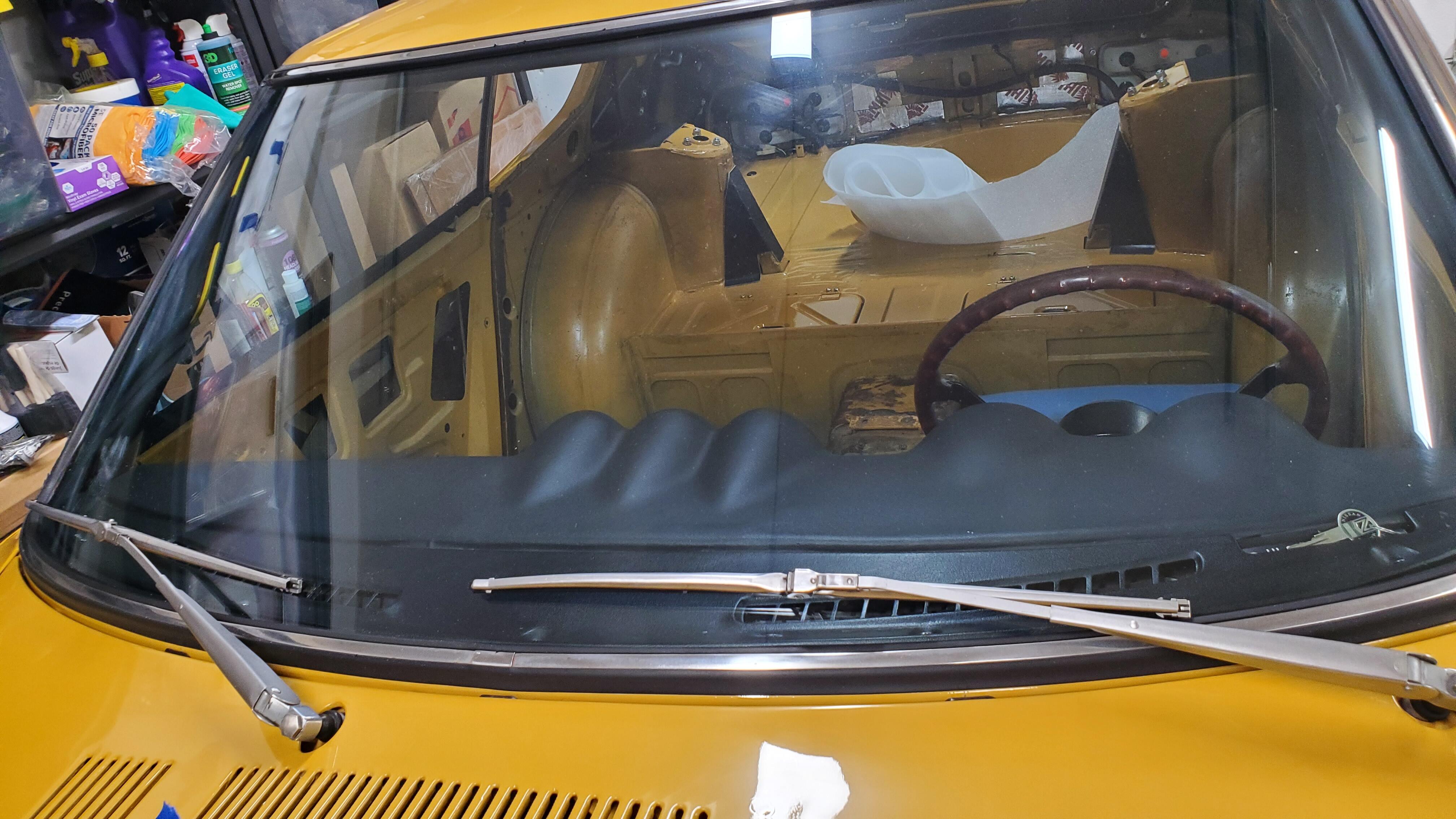

Final product
also took some time to address the cruddy old washer jets by soaking them in degreaser, then carefully threading some thin gauge wire through them to loosen the 50 years of rust, gunk and who knows what else.  i now have a working hi/low set of wipers with actual washer spray hitting the windows!  This refurb motor even parks perfectly but not sure if that's being aided by the spring i repaired or just getting lucky with it returning to the position it started.  It does reverse the motor and end up dropping the wipers into their correct starting location no matter when you turn them off so that's what i would expect them to do.
