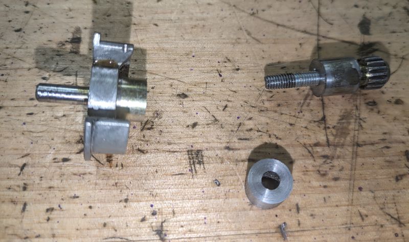

That aluminum chunk is probably molded onto the splined shaft. And if that's the case, I don't think you would be able to get that shaft out without destroying the aluminum portion. There's probably a feature built into that steel shaft to insure that those two pieces rotate as one. Maybe some splines buried down in there or a square cross sectioned area or something. Cross pin. Something.
So I still think the extendo collar is the first thing I would try. Either welded or set-screwed into place.

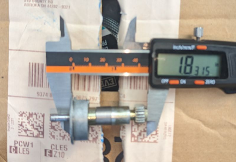

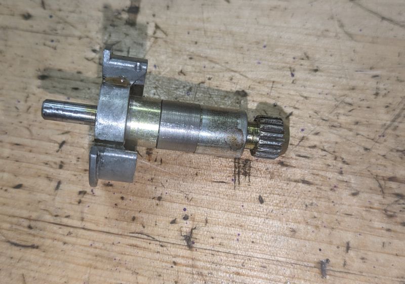

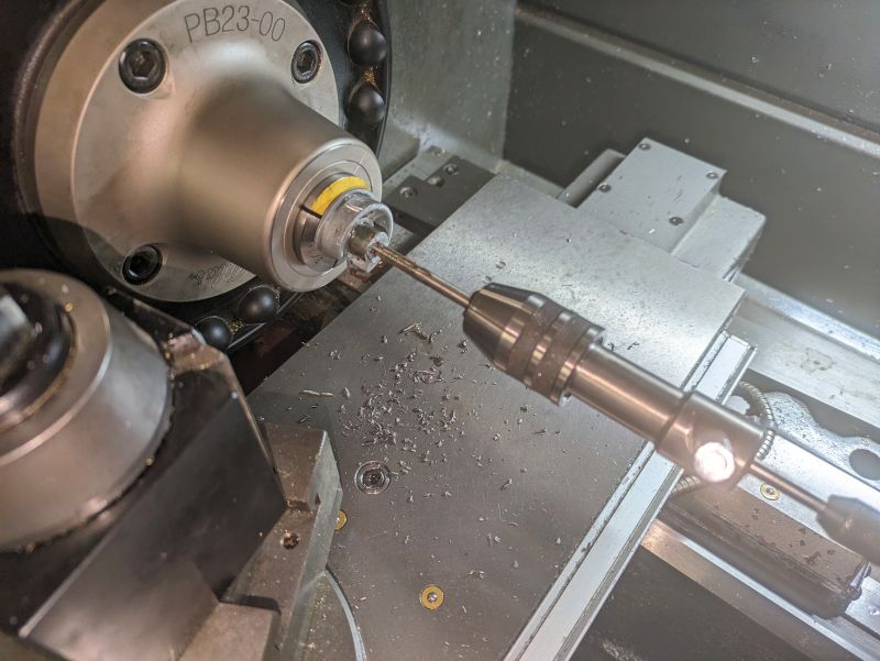

Well here's where I'm at. I cut the shaft; drilled, tapped, faced off the ends; made a spacer from some scrap; and used a short section of all thread to piece it all together. This increased the length by 0.29 inches. I'll need to weld the stack in a couple spots to withstand the torque. I'll then weld the regulator back together. If all works well, I have a second one to do.

Nice work.  :beer:  I was going to suggest a threaded rod through the center, but I wasn't sure if removing the material out of the center would weaken the shaft to the point of being a problem.
If I remember my statics theory, most of the torsional stress should be close to the surface. Couple weld dots and hopefully you're OK.
I welded it up and made a mess out of it but it cleaned up ok on the lathe. I'm just trying to get the window back in the track now and then I'll post a picture of the finished project.

If someone needs a crank shaft lengthened, I don't mind doing it for them. However, it would require them to dissasemble the window regulator, pay for round trip shipping, and most importantly, not raise a fuss if I screw up the job. I didn't show my second modified spline shaft but the small rod extending out of one end of the part snapped off while in the lathe, but I was able to use the threaded rod to replace it.
