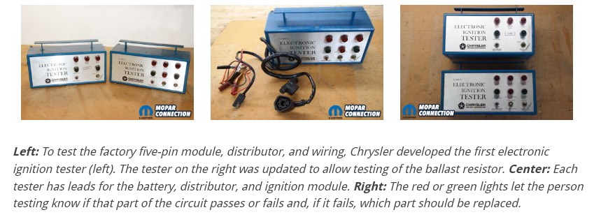

It's an interesting subject.  Mopar had a dual ballast system on some models.  Not sure if one was for starting or if the other came in to play during operation.  Looks like maybe the ignition module controlled or switched the other side on when appropriate, according to this article.  Check out their igntion tester.  They even modified it later to test the ballast resistor.  How complex could it be!?   https://moparconnectionmagazine.com/gallery-mancini-racing-reintroduces-the-orange-box-videos/

Mopar's old video, from that link above, at 4:44 is interesting.  I'm learning stuff.
really interesting watch, thx
