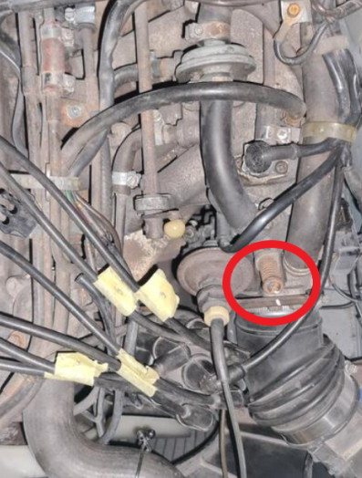

Racer X has a good point.  You have so many different issues though it's hard to figure out where to start.  On the EFI throttle bodies there is a screw with a big round head on it that you can turn by hand.  That is the throttle blade bypass screw that controls idle speed through air supply control.  You could try just opening that up, (unscrewing it to let more air in), and see if that will allow you to start the engine and let it run by itself.

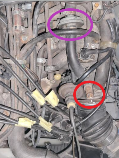

On the EFI engines there is also the auxiliary air regulator (AAR) that lets air past the throttle blade when the engine is cold.  On a properly set up system the AAR keeps the idle up when cold, and the idle speed screw determines warm idle RPM.

Idle speed bypass screw -
AAR -

Idle speed bypass screw -tried adjusting both ways different number of rotations and it made no odds
AAR - it's opened as I checked it before.

The idle speed screw.. I already tried that but will maybe open it more than 10 rotations. When I turn it it makes a clicking noise for some reason so maybe its just turning and not screwing anything... Also to be investigated 😄 so many things to do as well as re assembly , windows rubbers etc. On the windows ( you might know ) do I need to use a glue between the rubber seal on the windscreen and metal of the car or is good enough just pushing it in? 😄
