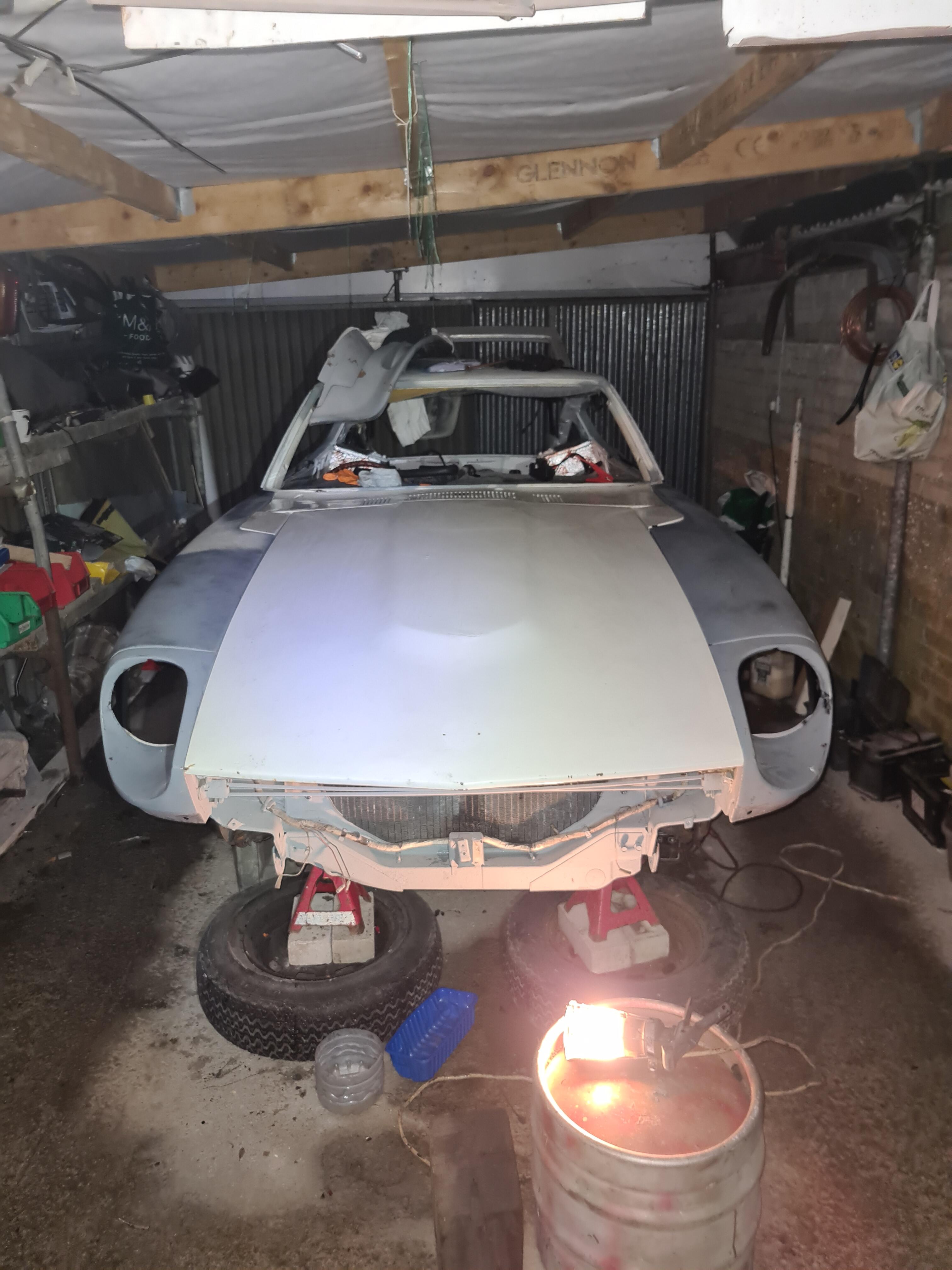

Just to add.. as the tps is bypassed I assume its the reason when I accelerate that the rpm go up slowly. Or maybe its something else and the root of my issue? Car photo because why not 😄

Since letting a little more air in through the AFM doesn't increase idle RPM that seems like a sign that you might have a big vacuum leak in the intake system.  The engine needs a lot more air through the AFM to add more fuel.   Unmetered air leaning things out so that the engine can't run.  Do you have all of the PCV hoses properly connected and sealed?  A picture of the engine would tell more than a picture of the car.  Looks like fun.

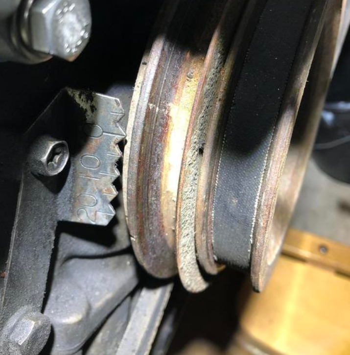

Using a timing light to see that the mark on the damper pulley is correct in relation to the marker on the front cover.  Sometimes timing can be so far off that the engine just won't run right.
This thing...
Picture from here.
