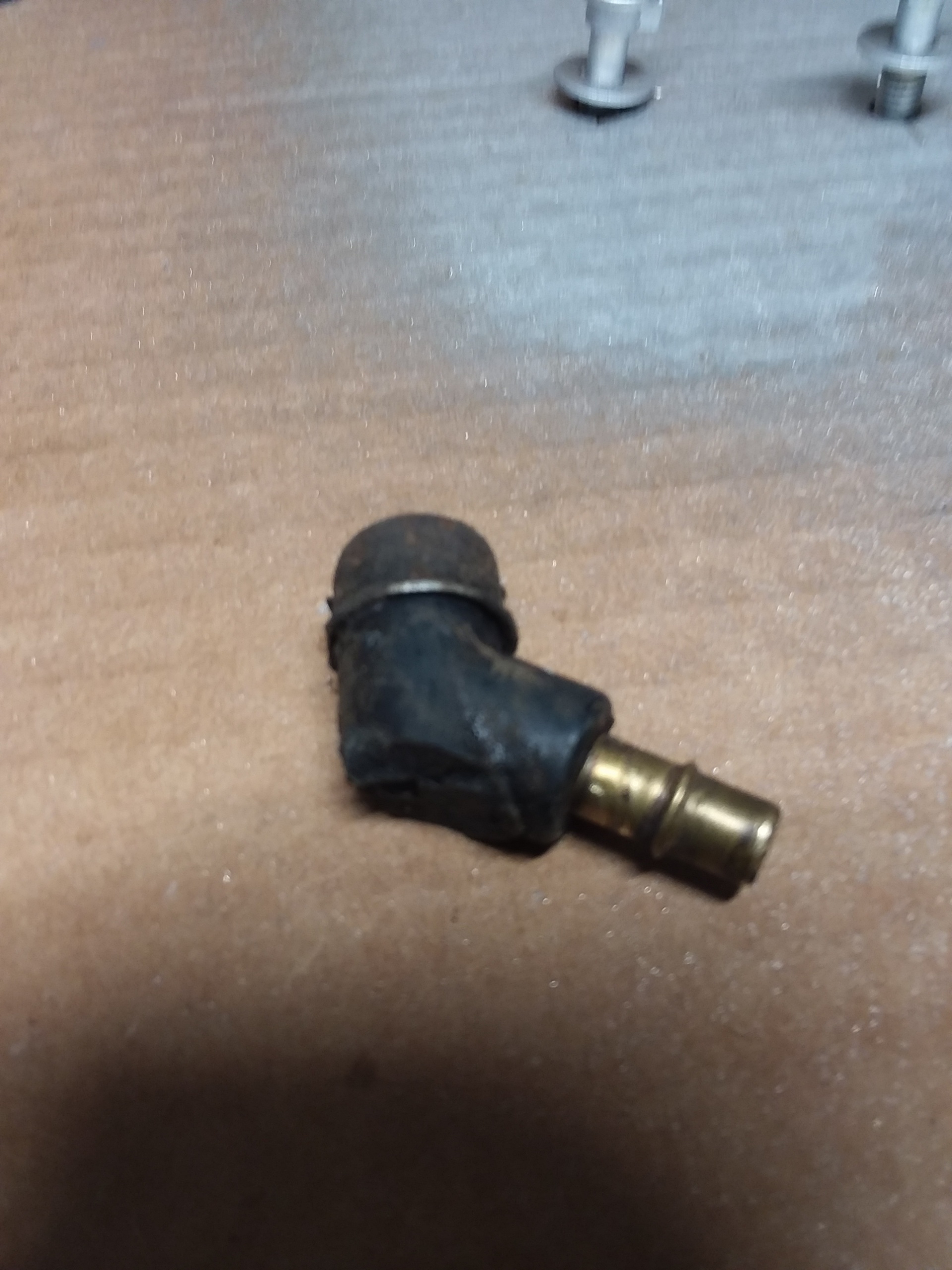

I'm looking for a carb part that broke on the rebuild of my 72 roundtop 3 screw carb .  I've attached a few pictures. The picture with the red arrow is showing the front carb. I actually need the part for the rear carb.  Not sure if there is a difference. The other picture shows the actual part that I need.  If you look at the bottom of the part you can see that it has broken off.  It appears to be some sort of plastic.  The choke linkage attaches to this.  I have the linkage.  I thought about trying to epoxy it back together but since it moves anytime the choke is on, I'm not sure how well it will hold up. Any help would be greatly appreciated.

That's the bottom of the fuel nozzle. Have you retrieved the brass nozzle that attaches to your broken piece? My first thought was Ztherapy (Salem, Or.) as a source for the nozzle.
Ztherapy has them listed in their price list. $120 a pair...
Interesting
