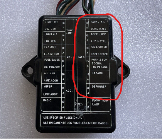

Check to see if you have voltage on both sides of the fuse for the circuits circled in red.
If you don't, check your fusible links. Also post clear photos of the links where they plug into the engine harness. Let's see the condition of your links.

Went back to the fusebox. Started testing all those you circled. All read 12.6V with the ignition on. All fuses read continious. While doing this I heard a click and then the radio turned back on. Voltmeter worked again, and hazards/defogger worked as well.
So far my theory is that one of the fuses is making a bad connection with the block. I think it read voltage when the car is on, because the alternator allowed it to overcome the resistance.  It may just be as simple as I need to clean the terminals on the fuse block.

Also now looking at the fuse cover, the radio, defogger, and hazards are on seperate fuses. So that makes this a little more intersting too...
They read 0V when the ign was off,  when I tested originally. Now they read voltage. Hmmm. Hard to pinpoint the failure until the next time it acts up.
