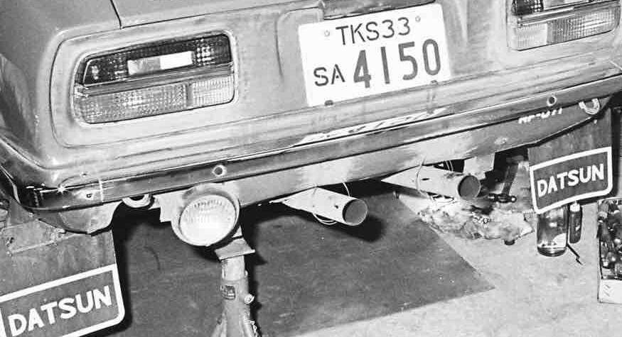

@xs10shlAre the twin exhaust cutouts on the rear under the bumper to the sides original or added later? IMG_2808.jpeg
The left-side cut-out is part of the original rear stamping, but wasn't used. I have personally not seen any period Works pictures where this cut-out was deleted, so I'd venture to say that Nissan did not have a special panel template with it removed.   The straight pipes were mounted right under the gas tank, affixed to the tank straps, with additional wire loops affixed to the rear panel. Some Works cars had rubber doughnuts to aid in support.
As to my car: it came with only bits and pieces of an exhaust system: a rusty (but thankfully otherwise intact) Works exhaust header, and a few feet of rusted-out custom exhaust, that was not installed on the car.  The right-side cut-out was done to the car at some point after the 1971 season by a privateer.  I can only presume it was done to accommodate a custom dual exhaust system which went to either side of the fuel tank, instead of under it.  There were some old rusty brackets in both side locations that corroborated that theory.   They ware almost certainly non-Works, and have since been removed.
At this point I should add that although I have photos of all of these features and many more, they are not always necessarily my photos to re-post.  Apologies in advance. Shown here is a close-up from the 1972 Monte-Carlo car.

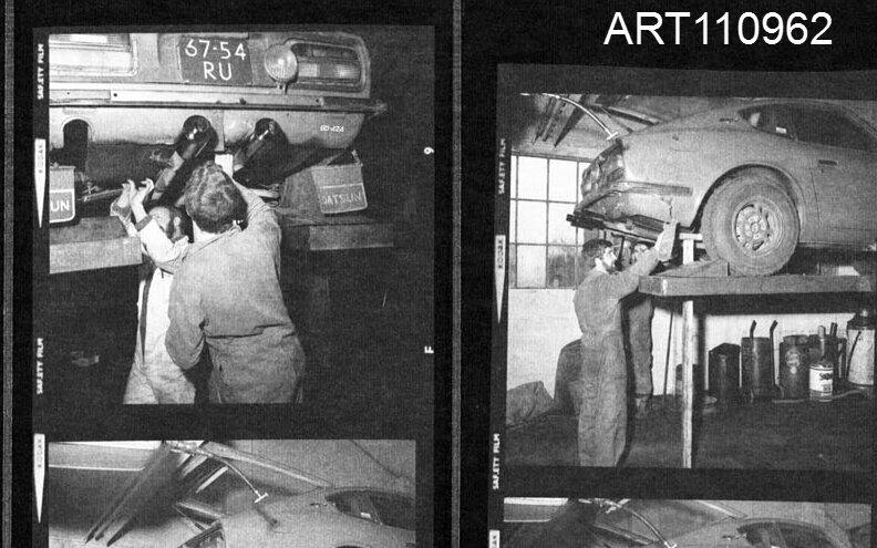

Here's an excerpt from an original contact sheet of photos taken by Neill Bruce at Old Woking Service Station here in England, prior to the 1971 RAC Rally. I purchased all Neill's Works rally-related negatives and he signed the copyright over to me.
Rob Janssen brought the car over from Holland in November and had Old Woking Service Station prep it for the event. They added a thick rubber fuel tank shield to give some extra protection and also a pair of rudimentary silencers to the original Works twin exhaust in an effort to cut down on noise. Not for the general public or the event scrutineers, but for the occupants...
Also visible in the photos: The rear garnish cut-arounds for the quick-change rear lamp units, the mudflaps, the 100 litre tank, the auxiliary reversing lamp, the Dutch registration/license plate and - most importantly of all from a provenance perspective - the factory 'Kanri'/maintenance code number '8D-424' on the bottom RH side of the rear valance.
In the more recent photos the "Kanri" code is also visible but not on the rear valence. Anyone care to hazard a guess where it can be found?
