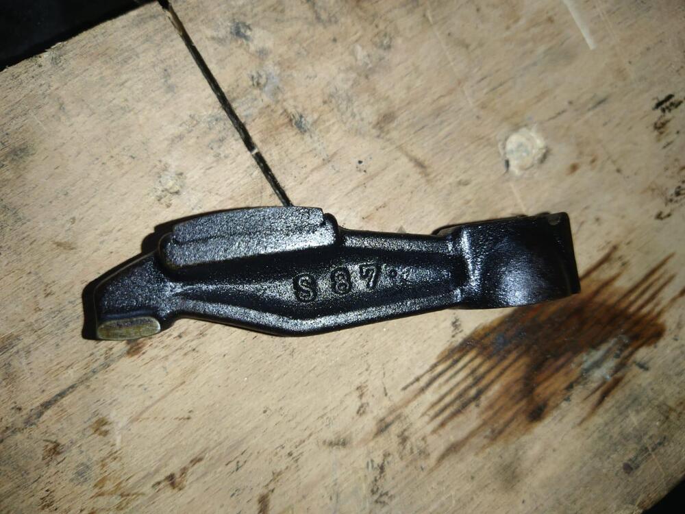

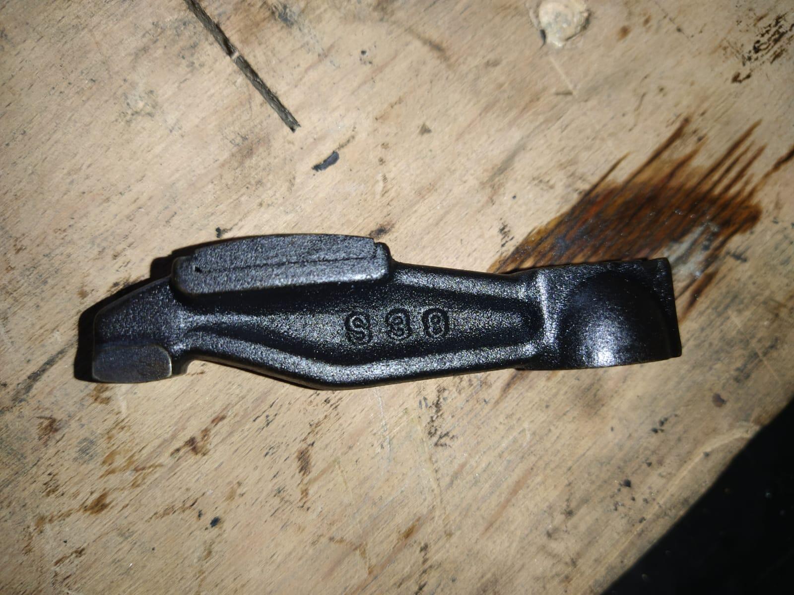

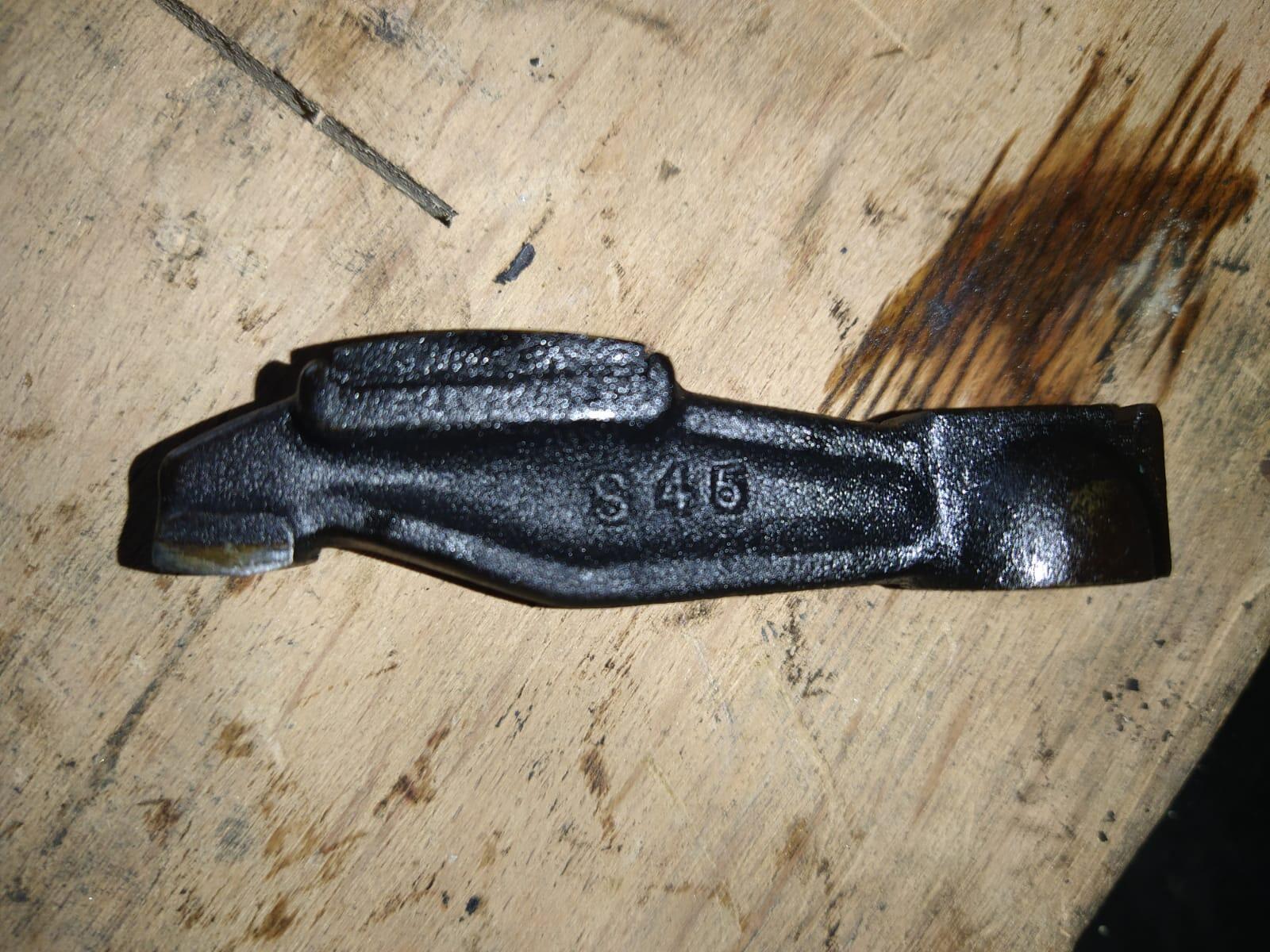

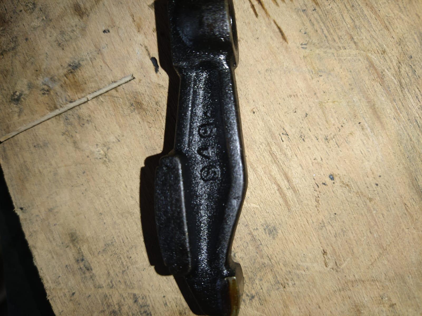

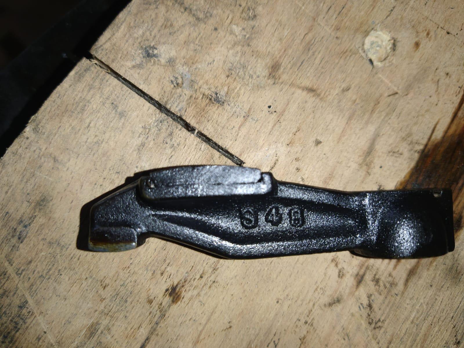

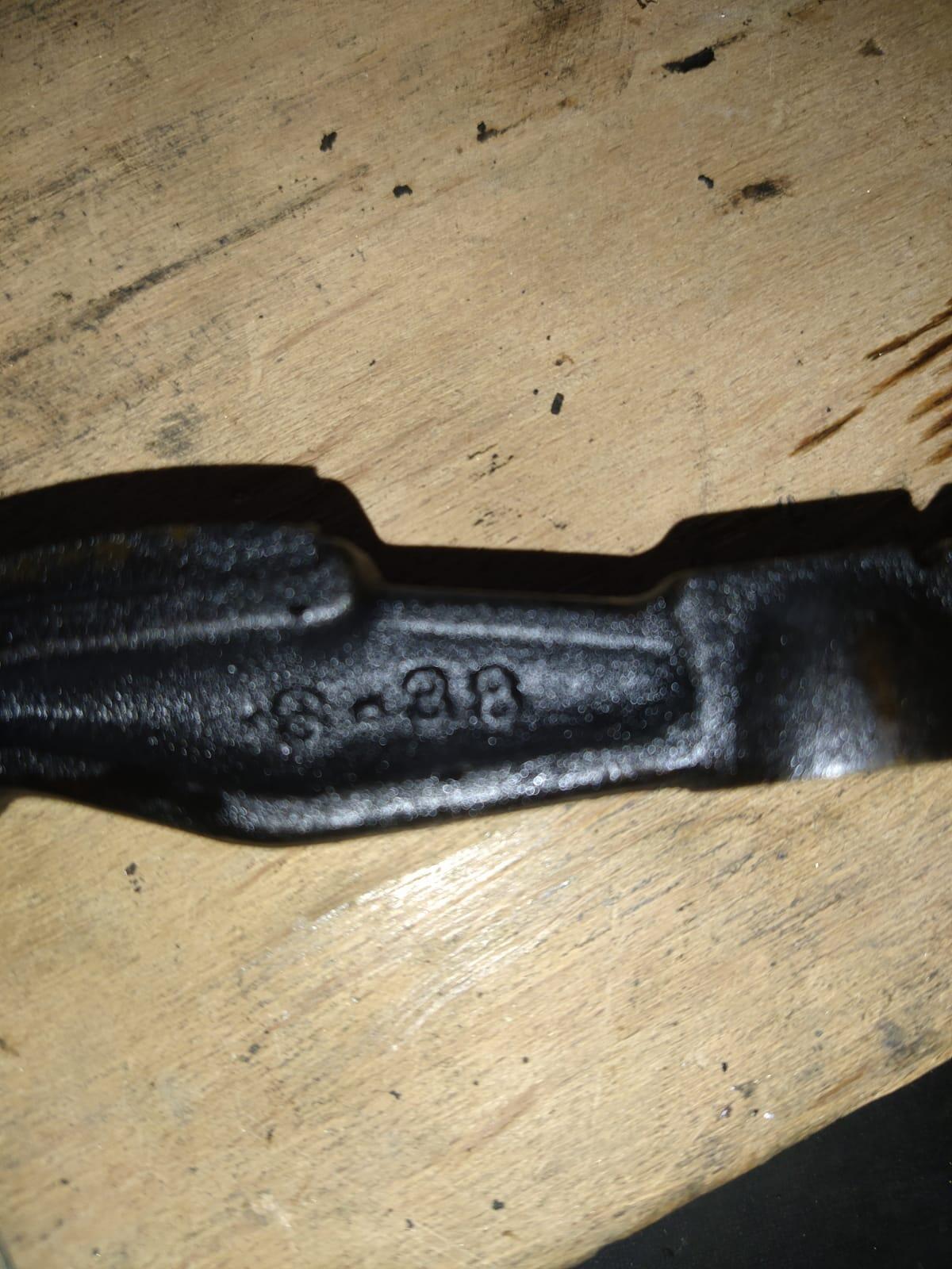

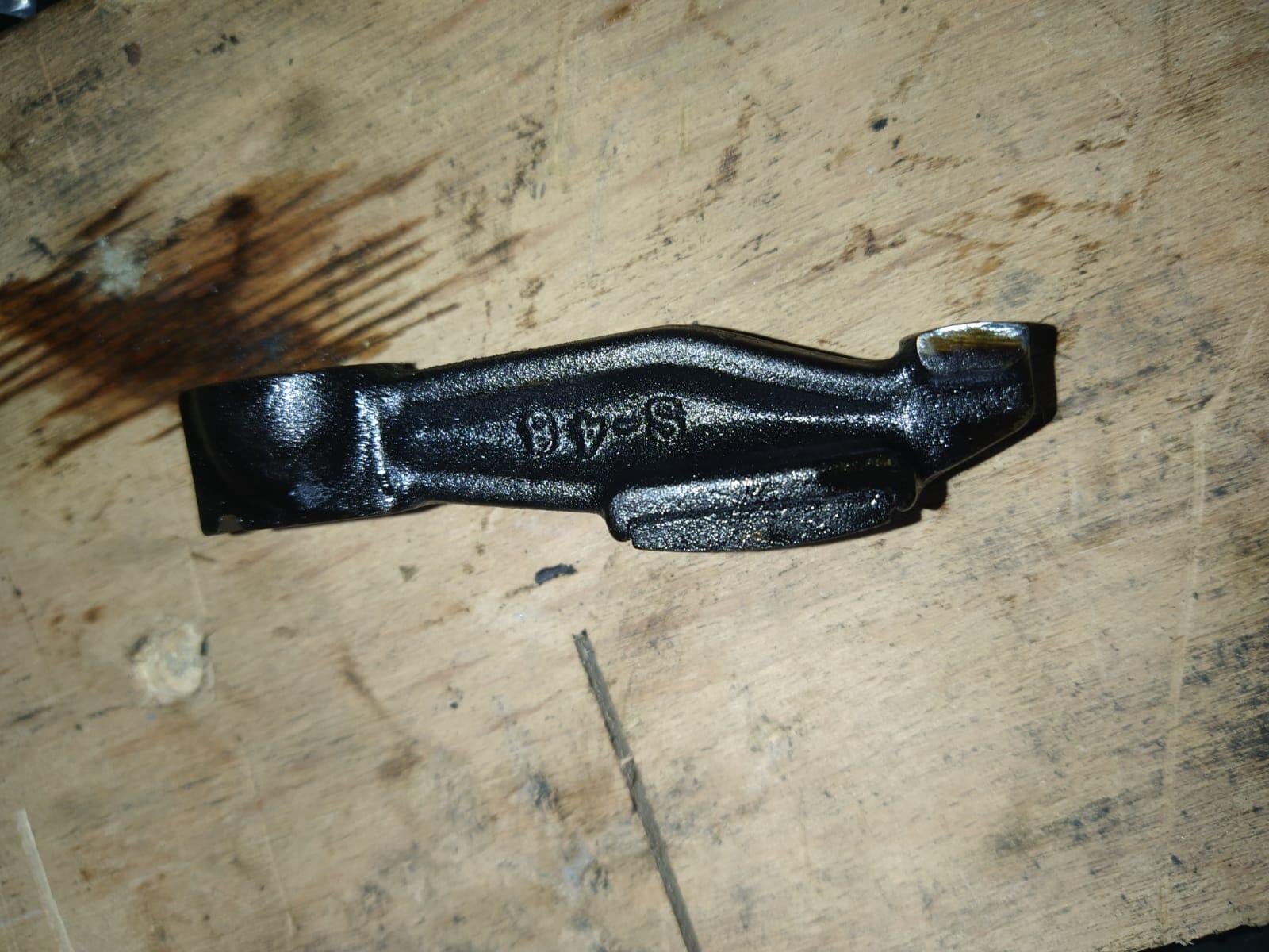

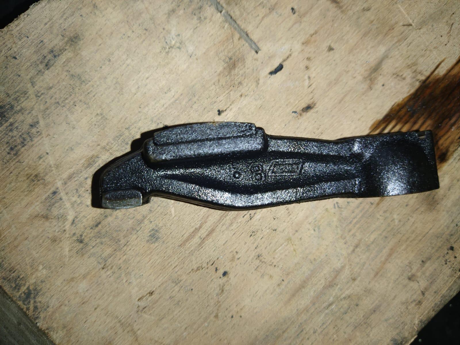

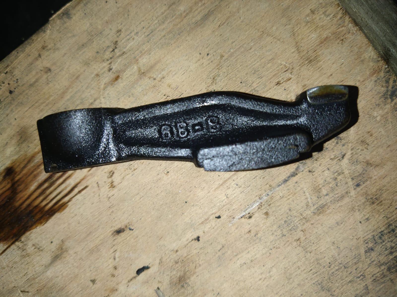

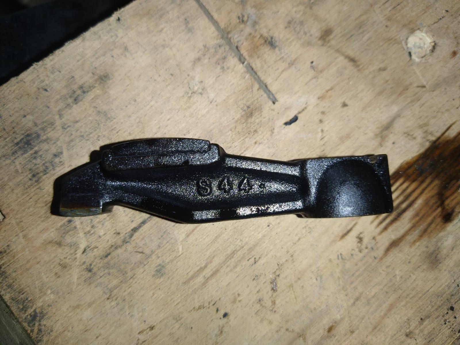

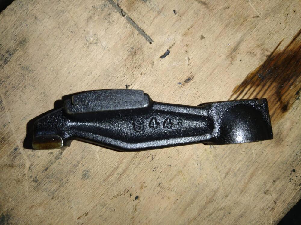

i disassembled my L28 cylinder head yesterday and I was wondering why my rocker arms are not all marked the same.
Are these original Nissan rocker arms or were they already replaced by a previous owner?
Thank you for your help.

I think that those are just mold/casting numbers.  Same part design, same factory, just different forming stations.  They're all collected together then sent off to another manufacturing station for the pad attachment and final machining.

I can't find the different numbers but they're the same. Seems like I have some S numbers and some E numbers?

Another 280Z owner told me that his rocker arms and all rocker arms he ordered from Nissan had this parallelogram on them.
