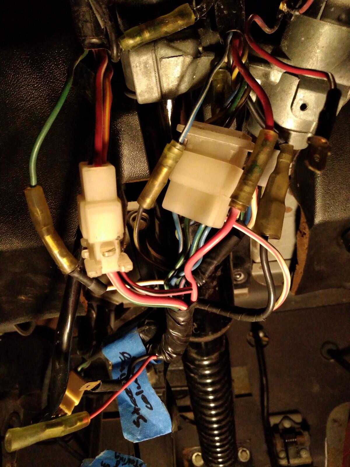

Now I'm trying to sort out the remaining connectors in the steering column area.  I have no turn signals, hazard lights, brake lights, headlights or dashboard lights.  The wiper switch activates the wipers.
Can anyone see where I might have gotten crossed up?

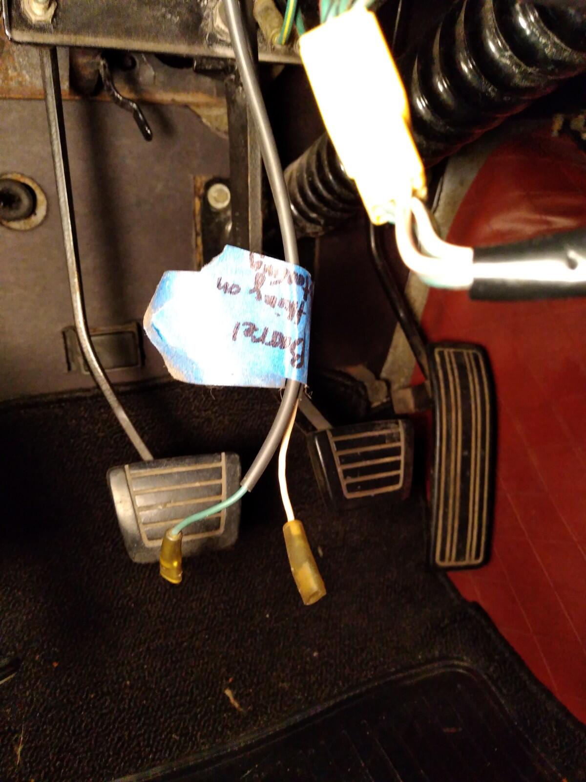

These two are white and green and are labeled "barrel thingy on steering column" but I can't find where they connect to, and I can't find a "barrel thingy" in my remaining parts stash:

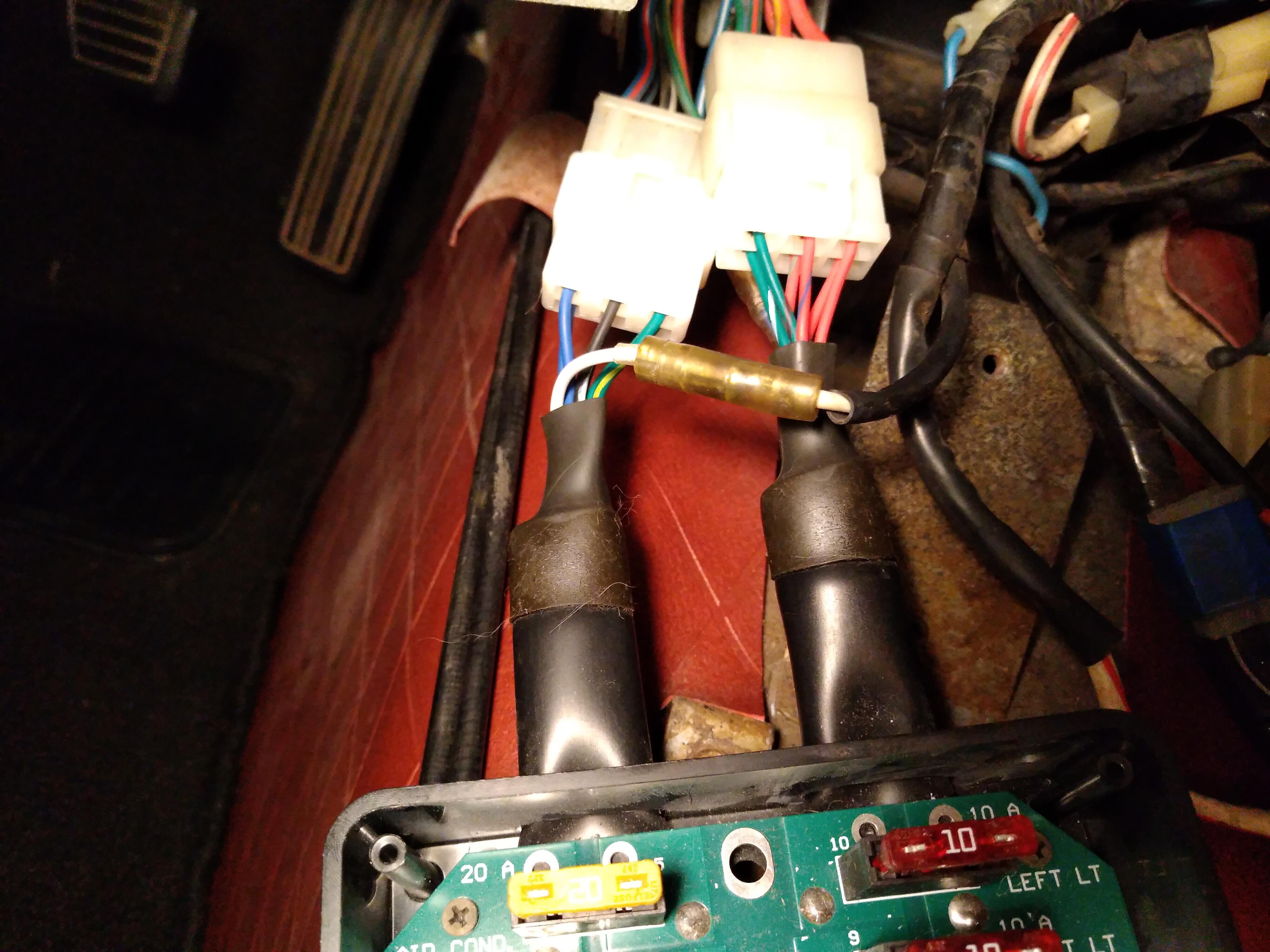

The 6-pin connector doesn't look properly seated. You may want to take it apart and put it back together again. That could fix your running lights. For the headlights, there should be a black wire going from the turn signal switch over to the ground on the right side of the steering column. I didn't see that one.

Thanks Steve.  Appreciate your input.  I reseated all the connections, with some dielectric grease for good measure.  The short black wire between the turn signal switch and the headlight switch is connected.

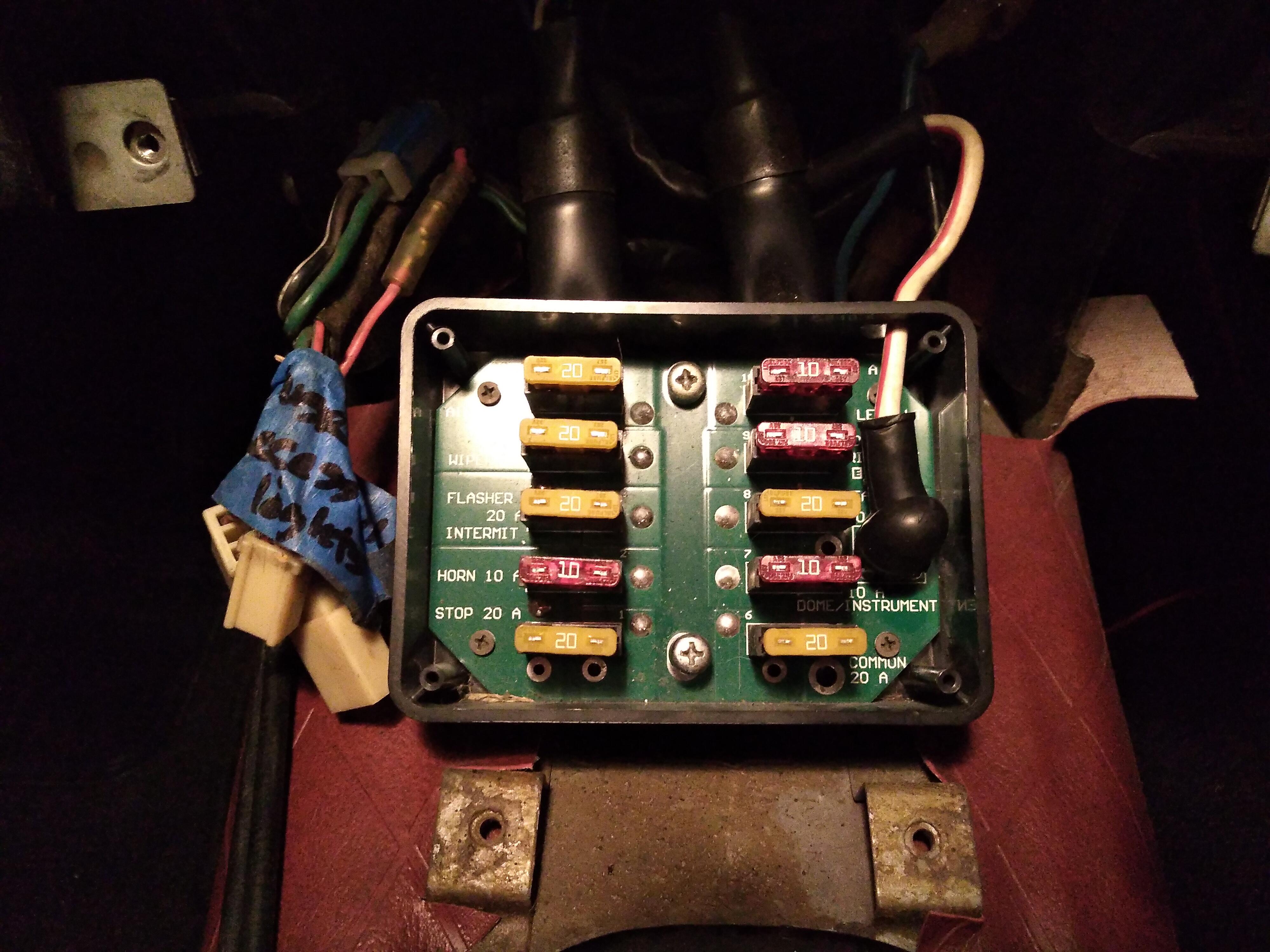

I managed to get ONE brake light to work, the left one, by connecting this white wire next to the fuse block:
I tried reseating the right side brake light connectors, no change.

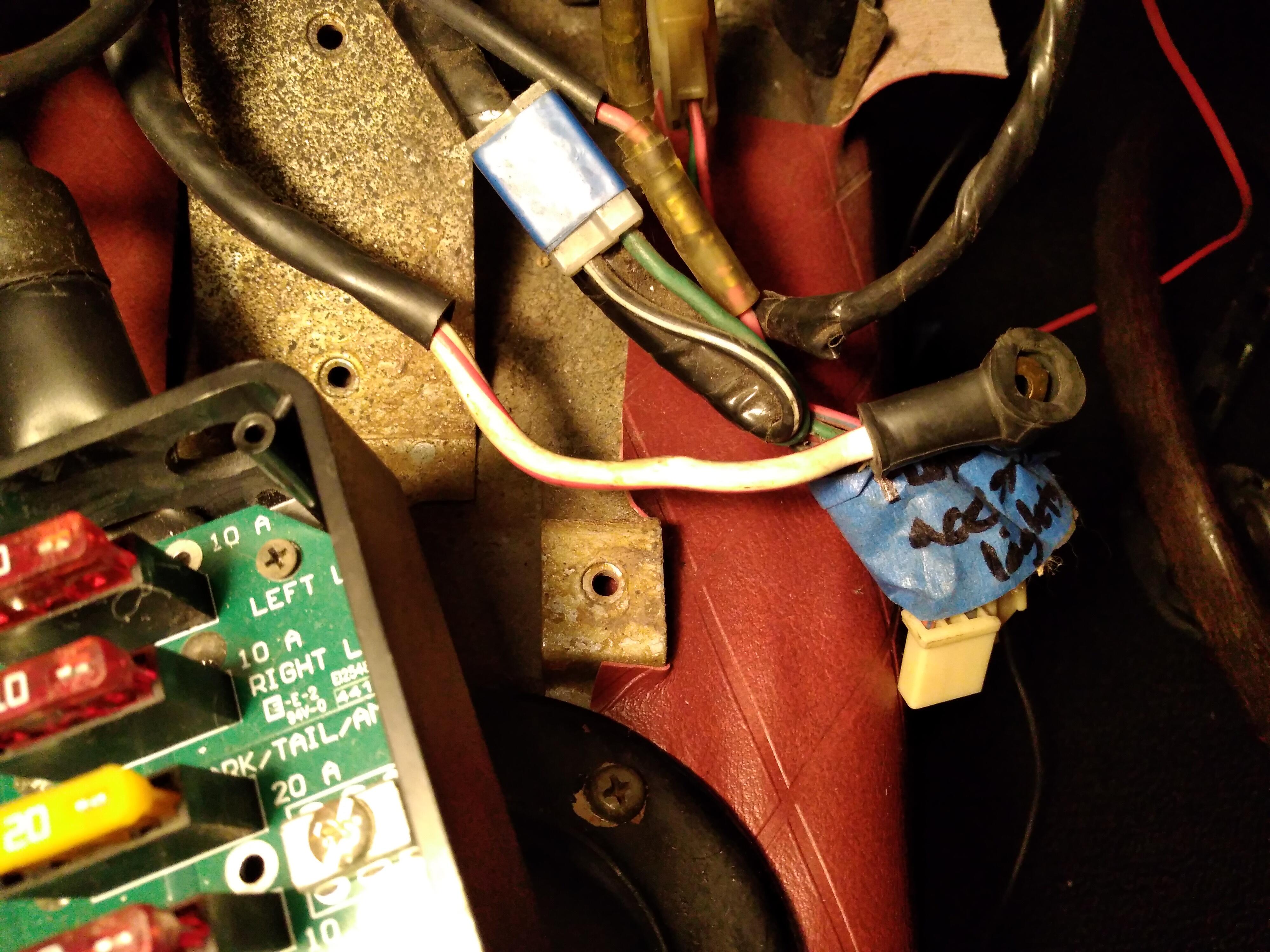

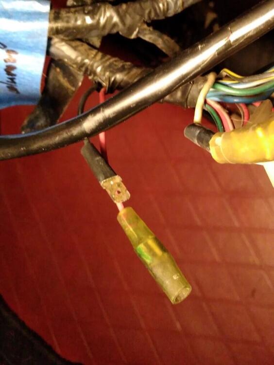

Can anyone tell me where this thick white-red bolts to?

- I found the "barrel thingy:" It's the turn signal relay (duh).  Tucked up inside the dash, I connected both the green and white wires, and...

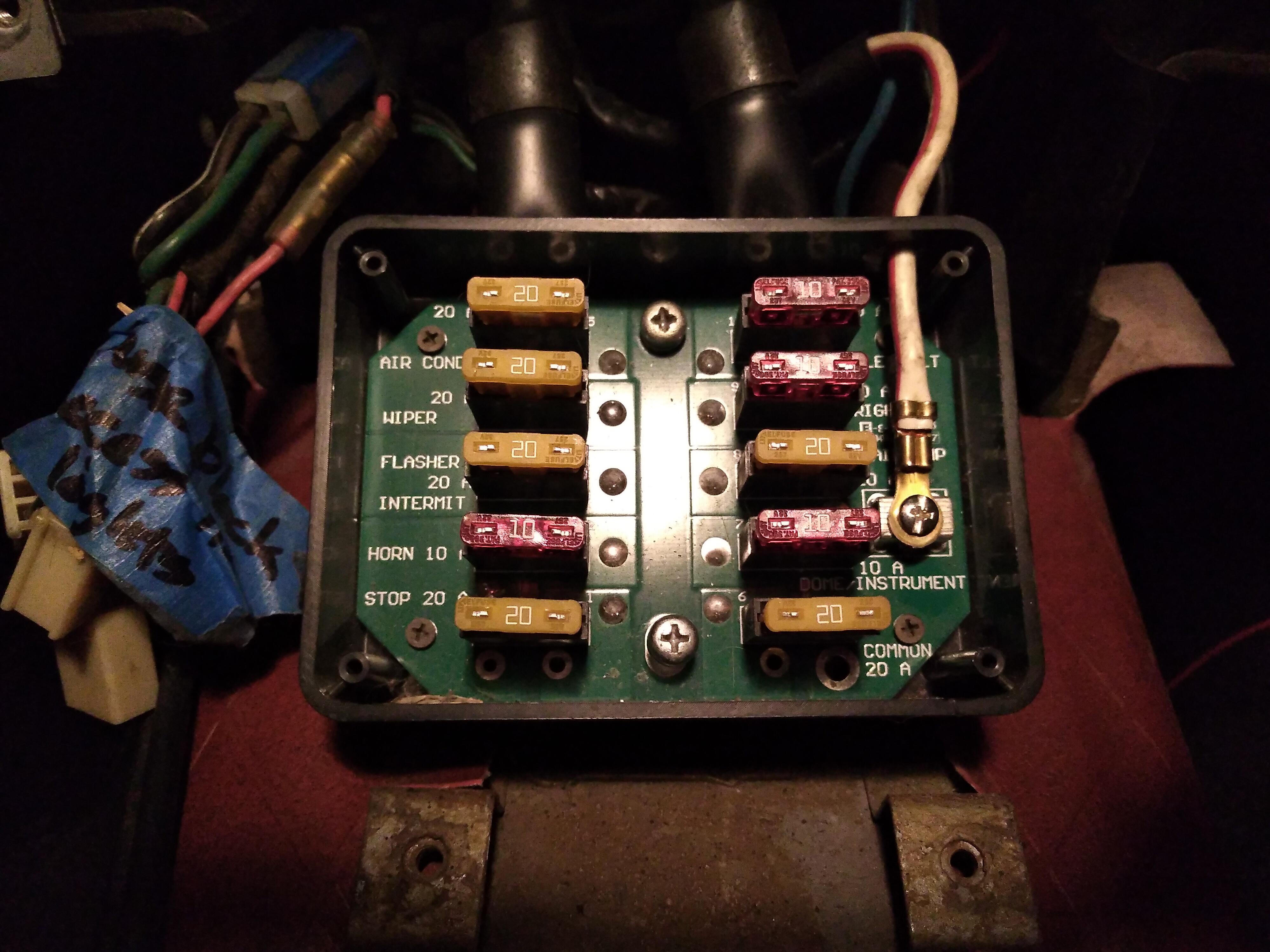

The white/red wire that is loose should power the fuses boxed below. It should mount to a stud on the bottom side of the fuse box. (This explains your parking lights.)
If you know how to use a multimeter (voltage and resistance testing), I can give you some diagnostics for the headlights. The brake light & rear turn signals could be the turn signal switch. Again, if you know how to use a multimeter, I can give you some diagnostics.
Thanks Steve.  Got it hooked up (the stud is on the inside of the new-style blade fuse box):
Unfortunately that didn't make a difference.  Still no parking lights or headlights.

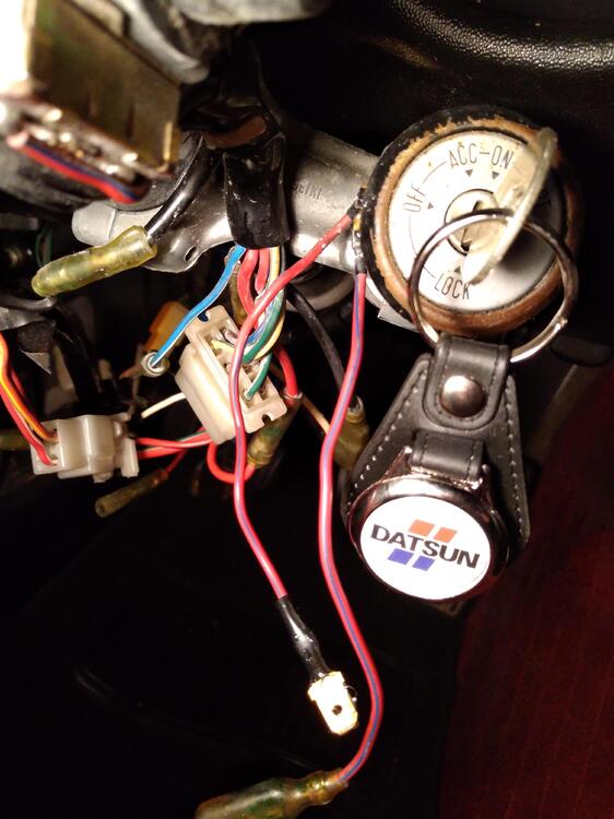

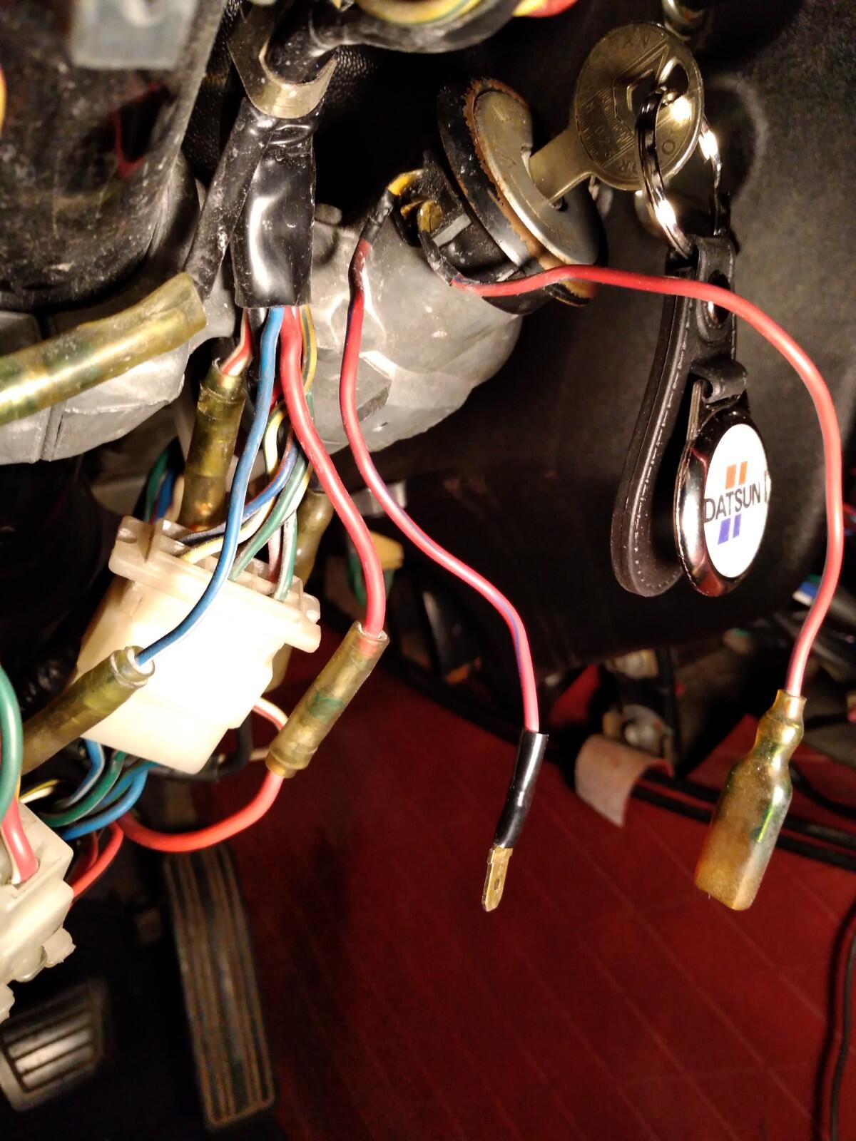

Can you tell me what these two red and black pigtails go to?  Besides the two red w/blue stripes wires coming off the ignition switch itself, they're the only two left to be plugged in.  I can't find their mates.
Thanks again.  Yes, I have a multimeter and can check for voltage/continuity.

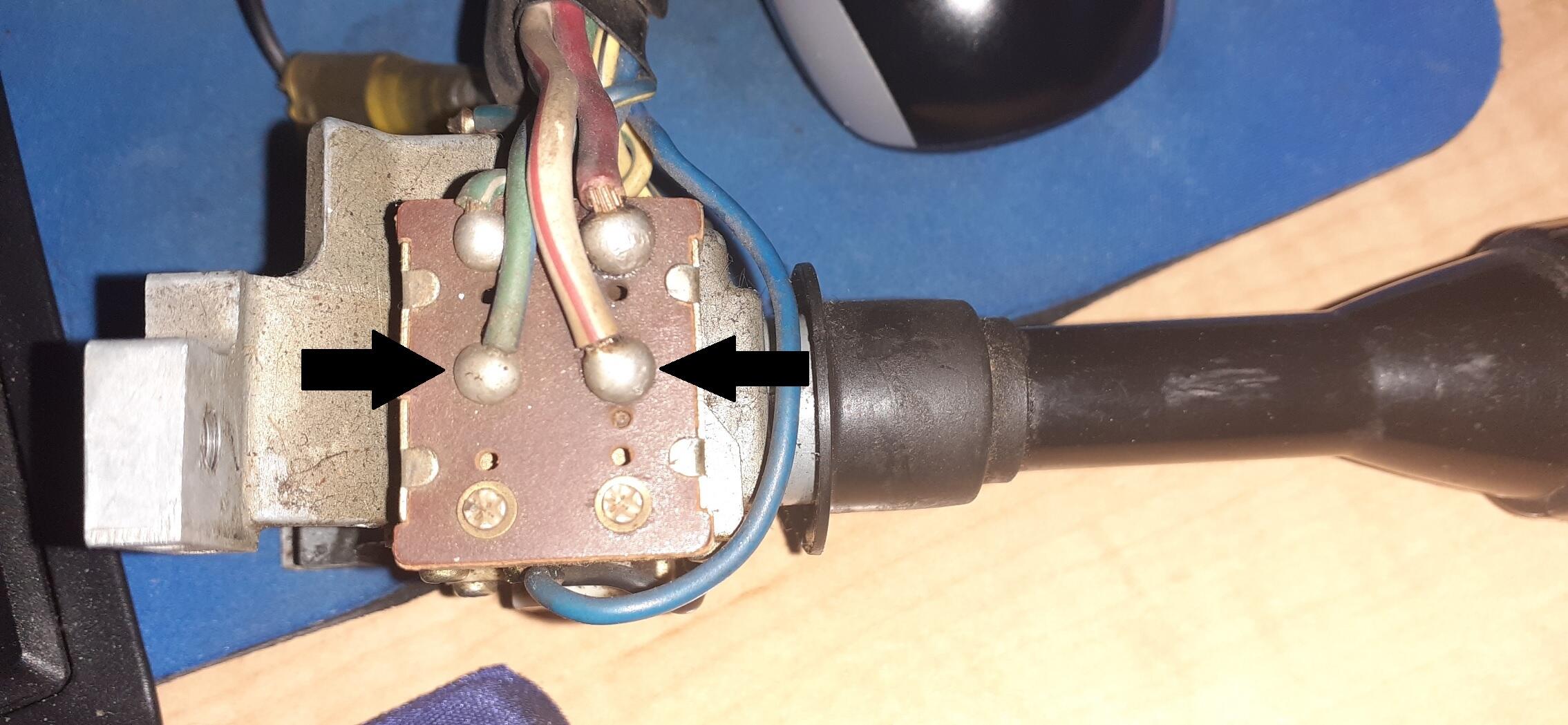

  1. Do you have voltage to ground at the middle fuse on the right? (Touch the positive probe of the meter to each side of the fuse to make sure you don't have a bad fuse.)
  2. No on voltage at the fuse? Do you have a good ammeter installed? Stop and fix before proceeding. (A disconnected or bad ammeter would cause both parking lights and headlights to fail.)
  3. Yes on voltage at the fuse? Check for voltage to ground at the headlight switch at the arrows. (See picture below.)
  4. No voltage at green/blue - Bad connection between fuse box and switch.
  5. No voltage at white/red - Bad connection between ammeter and switch
Let's get that working, and then we can focus on the brake lights and turn signals.

Double check the voltage for the parking light circuit at the headlight switch and check both wires for voltage to ground.
The 72 FSM identifies the wire for the parking light circuit as being green/blue. Note that this is the dash harness color. Some vendors would use alternate colors within a component such as a switch or fuse box. For instance, the wire coming off the parking light fuse in a 73 fuse box that I have handy is green/white. The color is different in the dash harness.
OK, progress.
I doubled checked the blue/green wire, no voltage.
I jumped the blue/green and white/red wires, and the parking lights came on (dimly).  Conclusion:  Flaky combo switch.

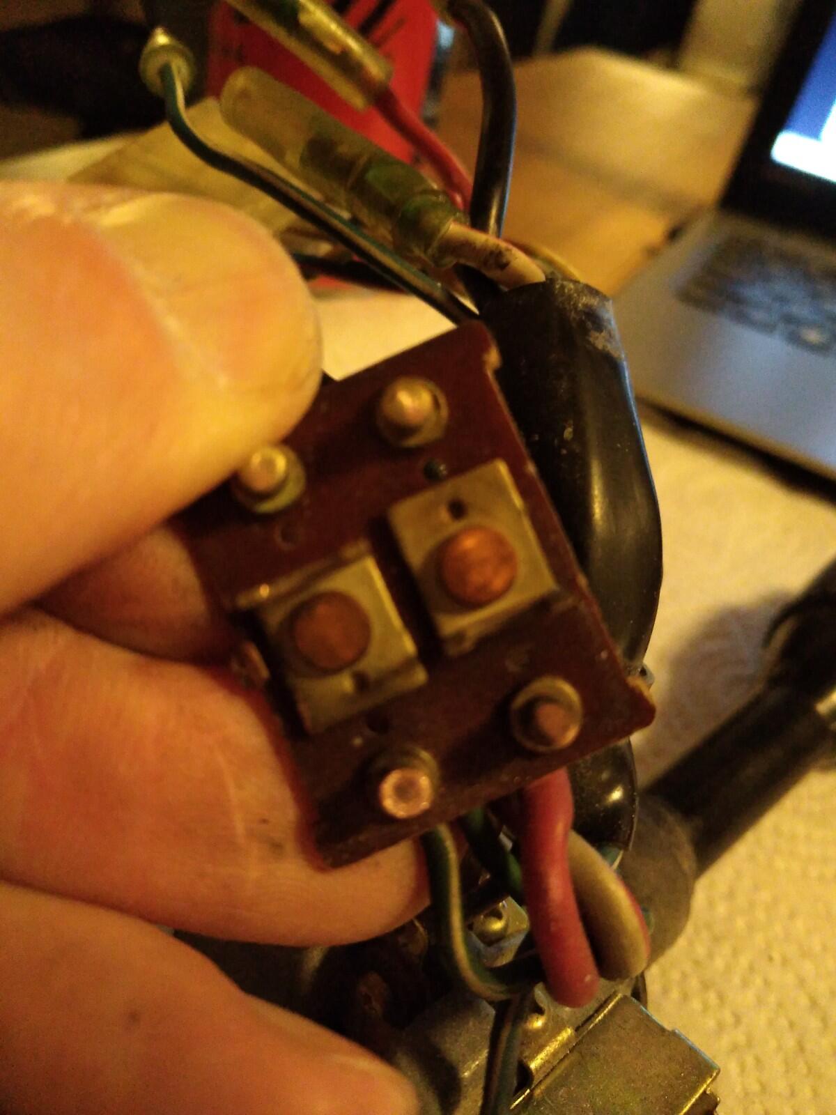

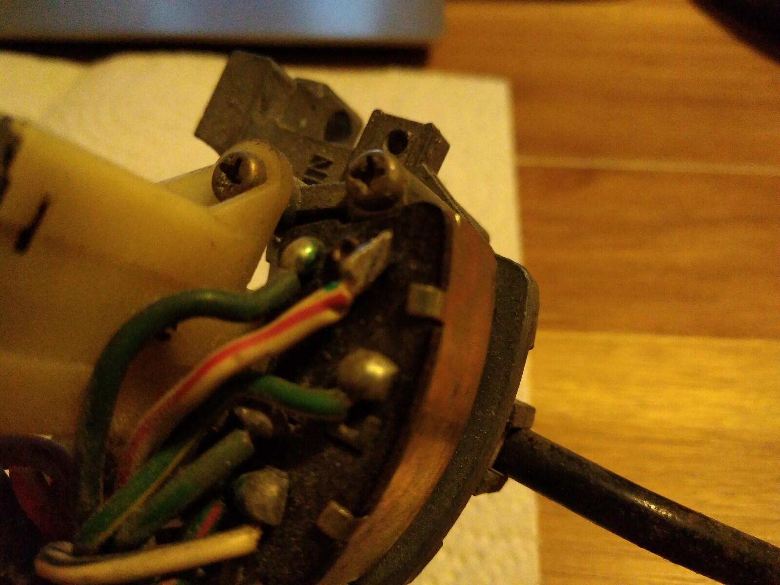

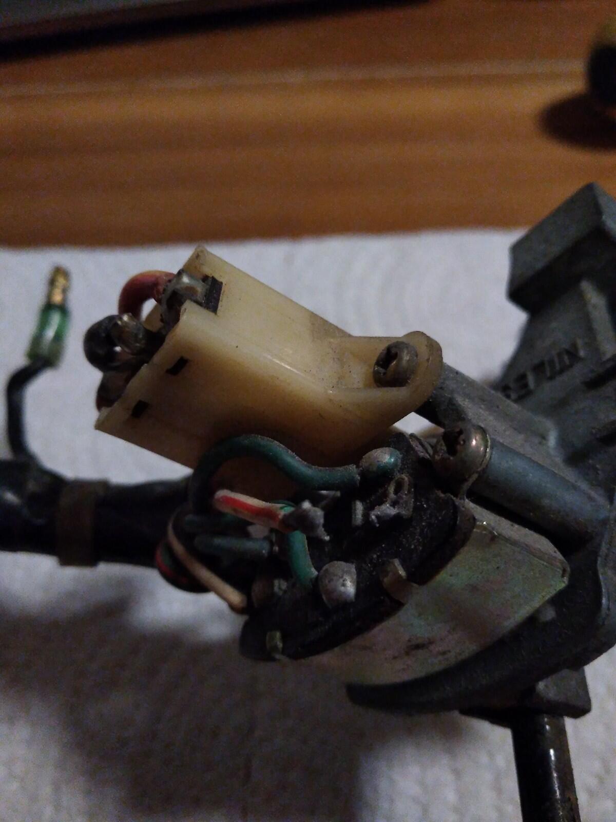

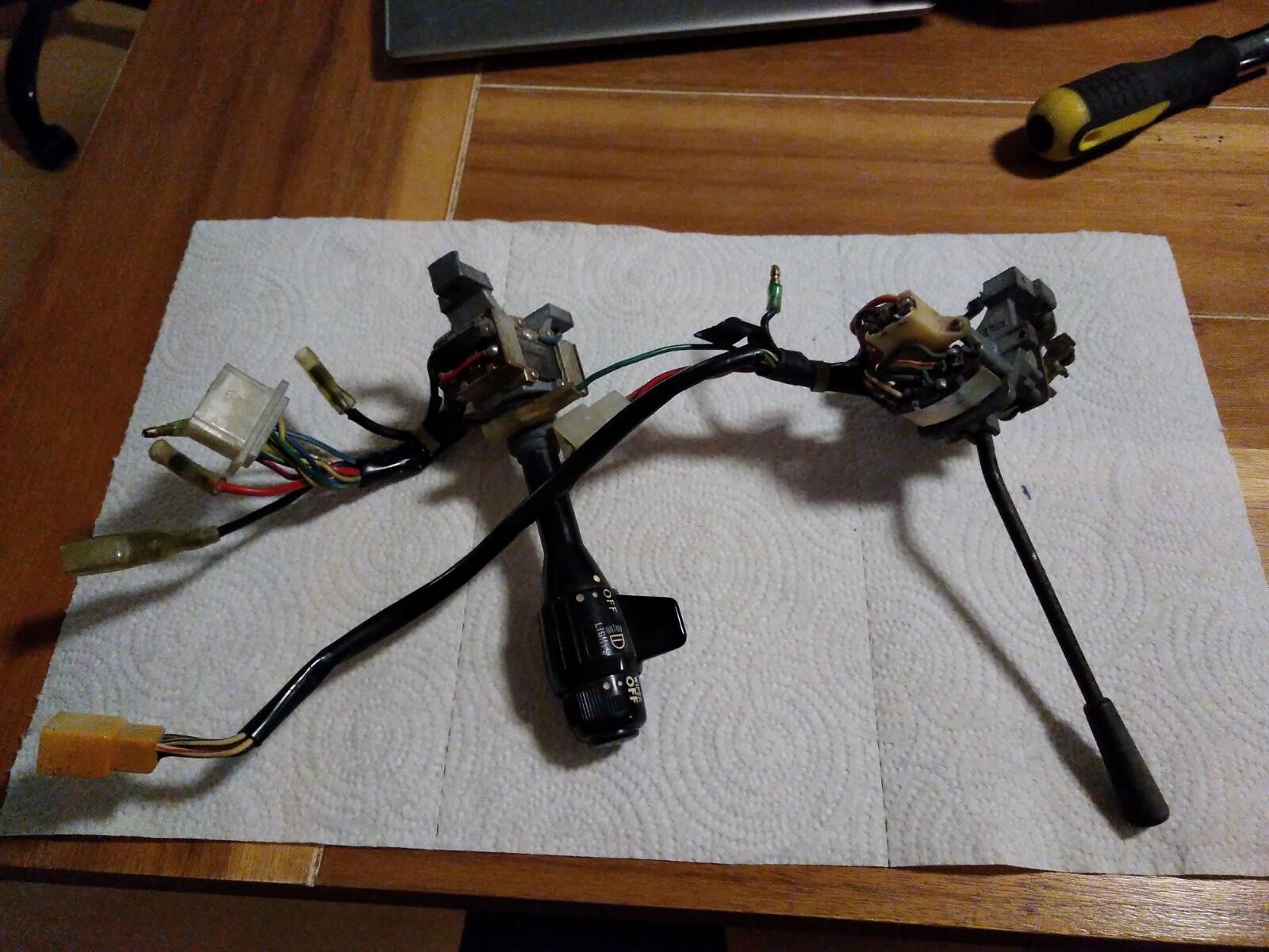

I removed the turn signal and combo switches:
and discovered a broken solder joint on the back of the turn signal switch:
(the white/red wire)
Resoldered:

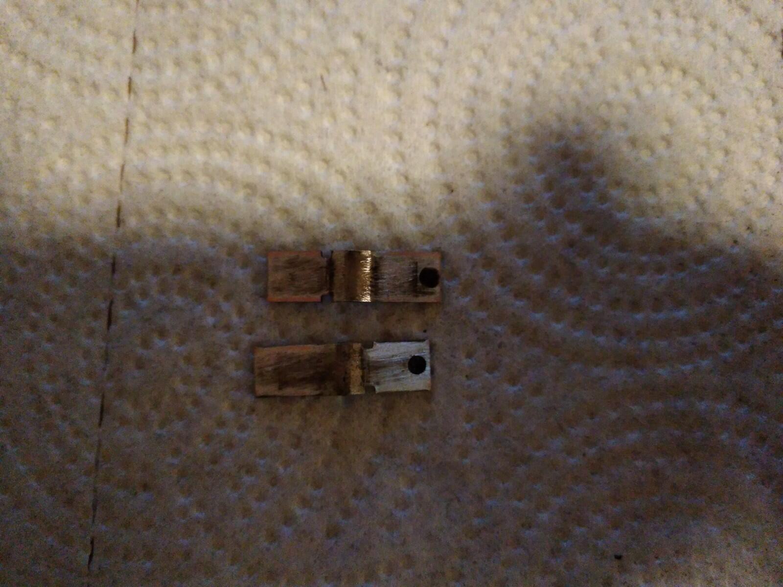

Next, I used this guide to clean the terminals inside the combo switch:
