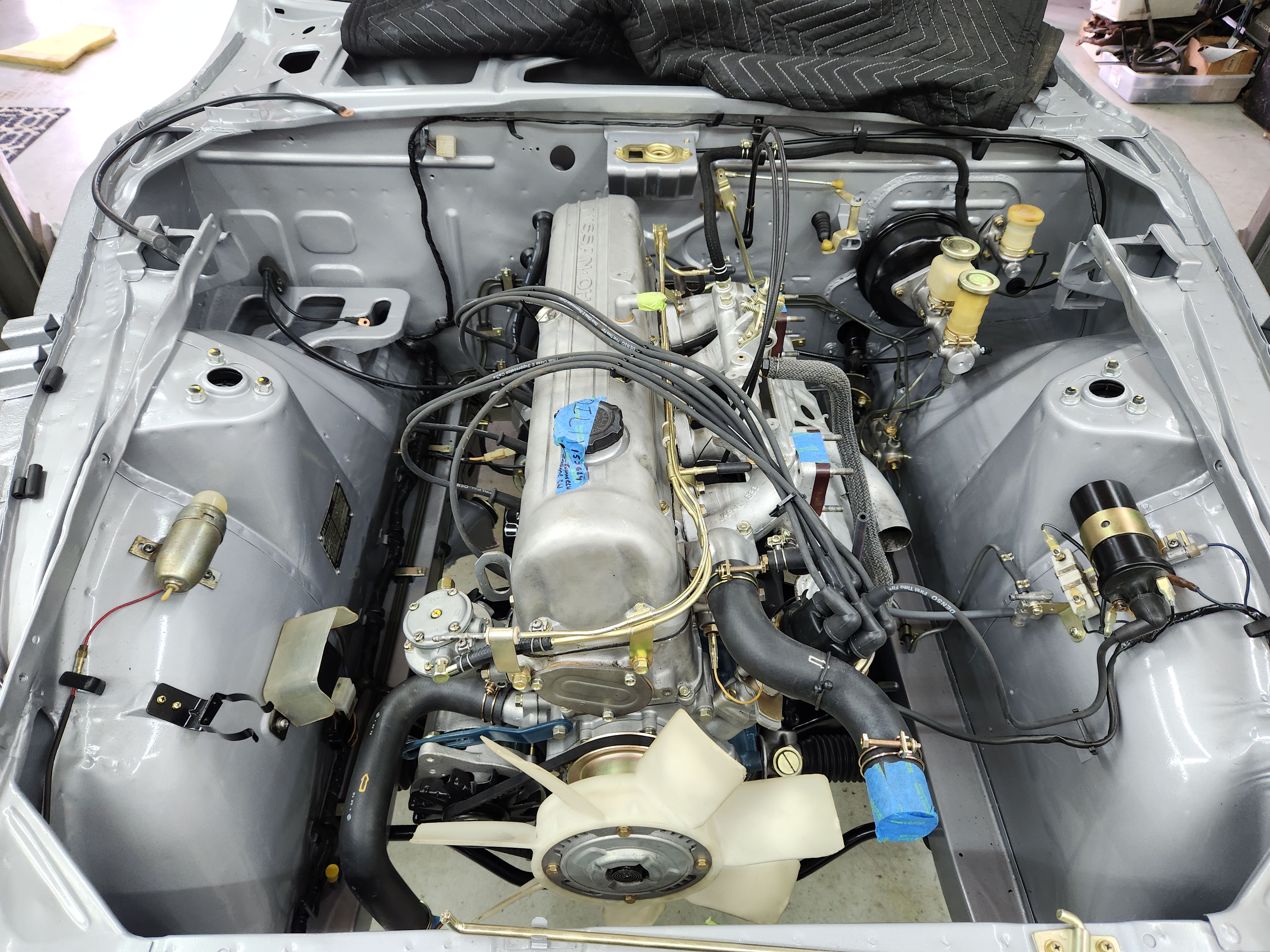

Motor/trans installed yesterday. It sure takes a lot of tipping to get it to slide in. I had a good helper and got it in without scraping the hood latch or rad support.

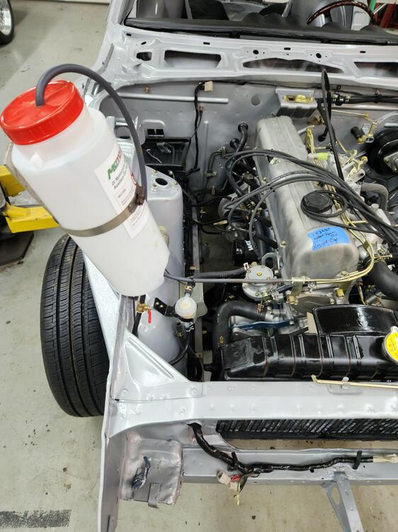

Carbs are due back from Ztherapy next week. I rigged up a temporary fuel supply as I dont want to install the tank until after the exterior bodywork and paint. This a temp tank for testing motorcycles I found online.

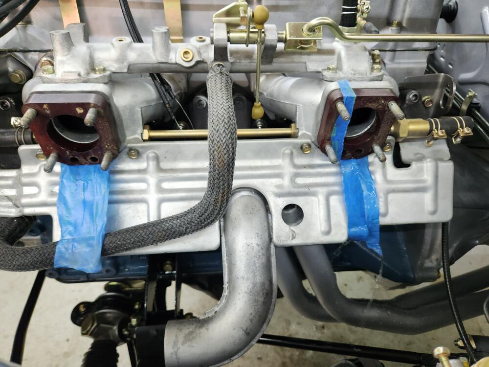

I learned that water will in fact run out of the manifolds if you fill it up with water without the carbs in place 🙂 . Good thing I filled with distilled water for the initial start and testing. For now, I am going to keep the manifold water lines. I debated blocking them off or adding a bypass hardline, but I am going to go with stock and see how it works out.

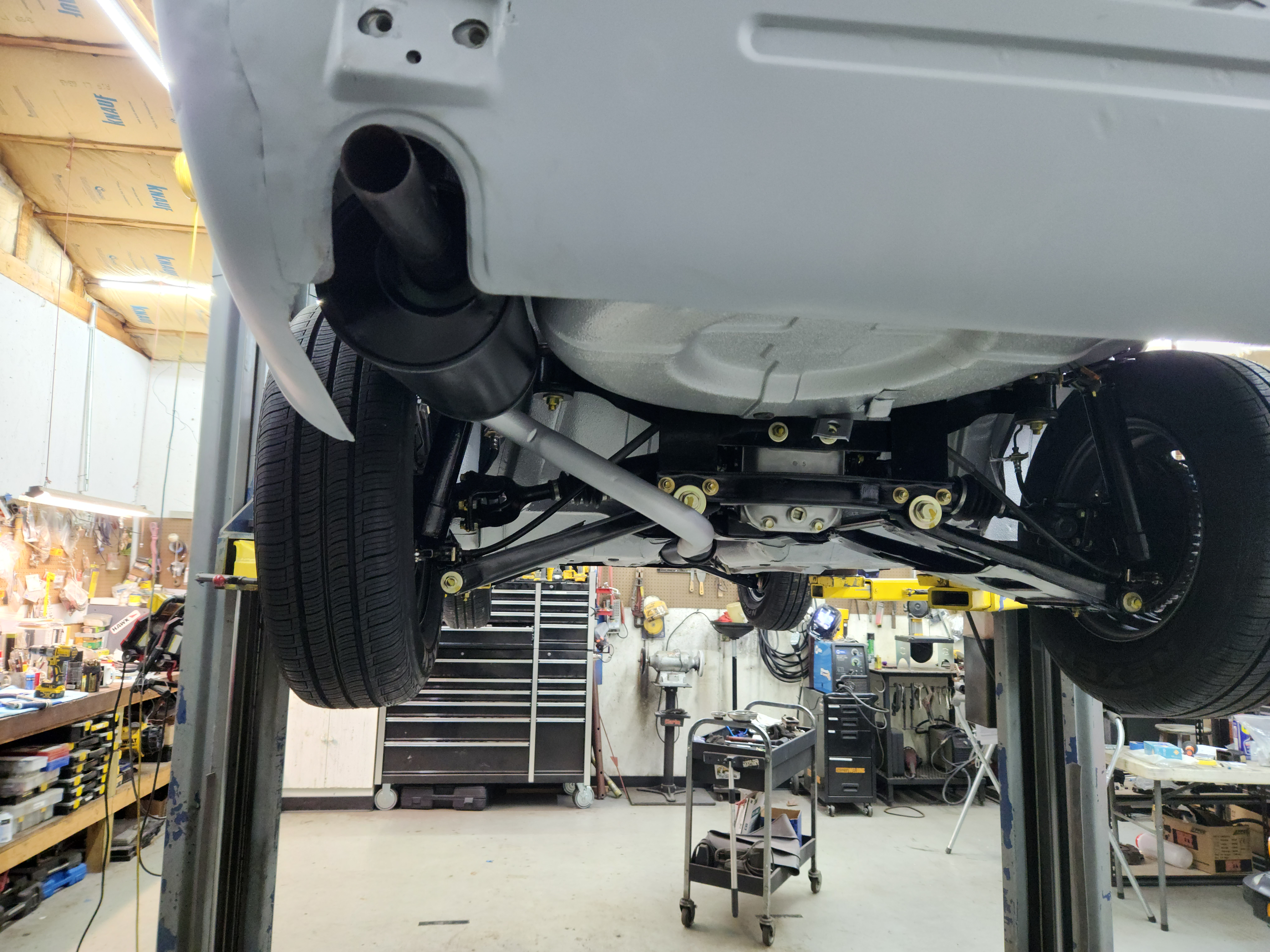

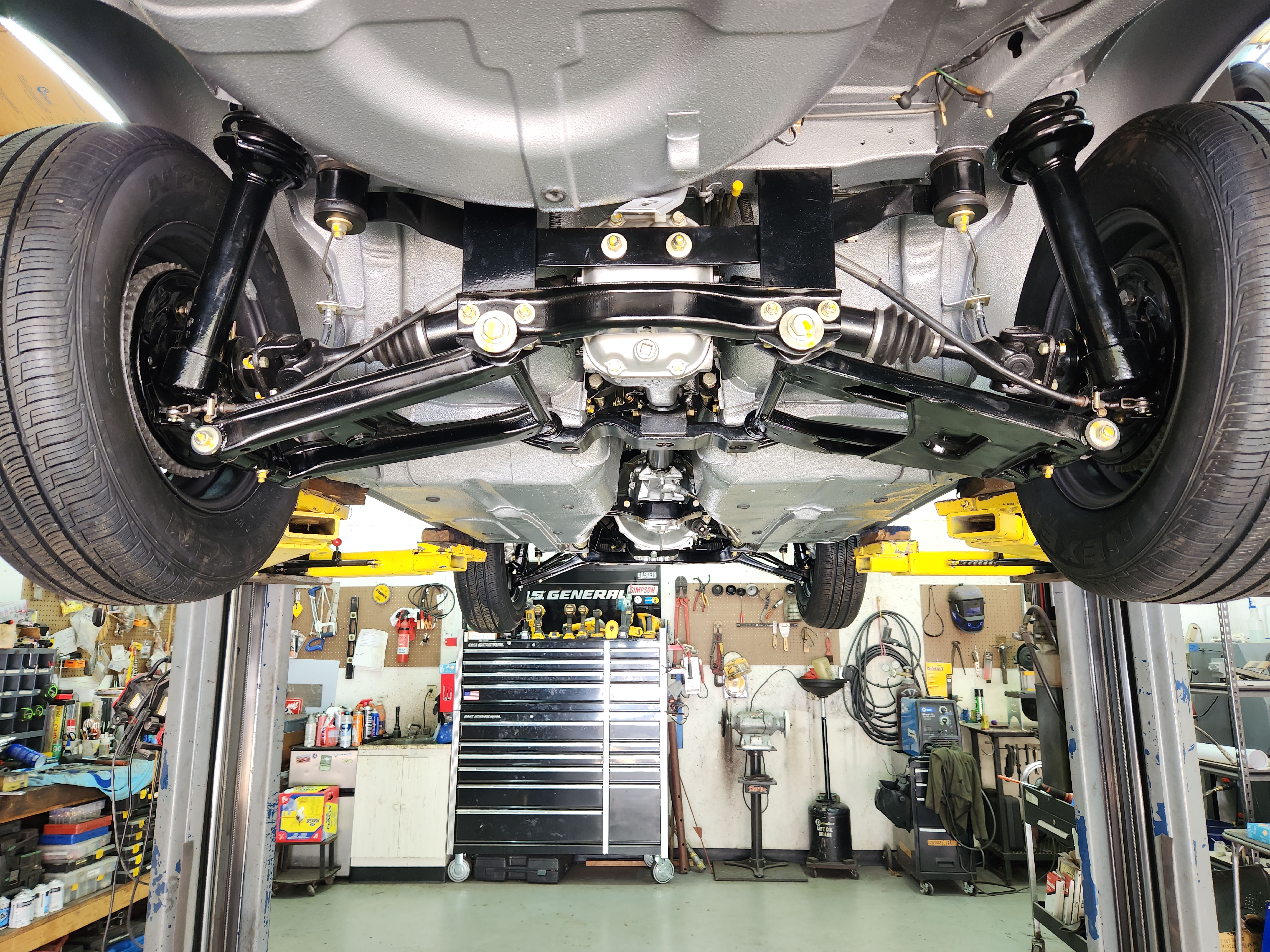

Old muffler/exhaust cleaned up and installed. Fit is very good. I fully expect the muffler to be toast, but I am not going to order one until I am certain. The header and pipes are very solid.

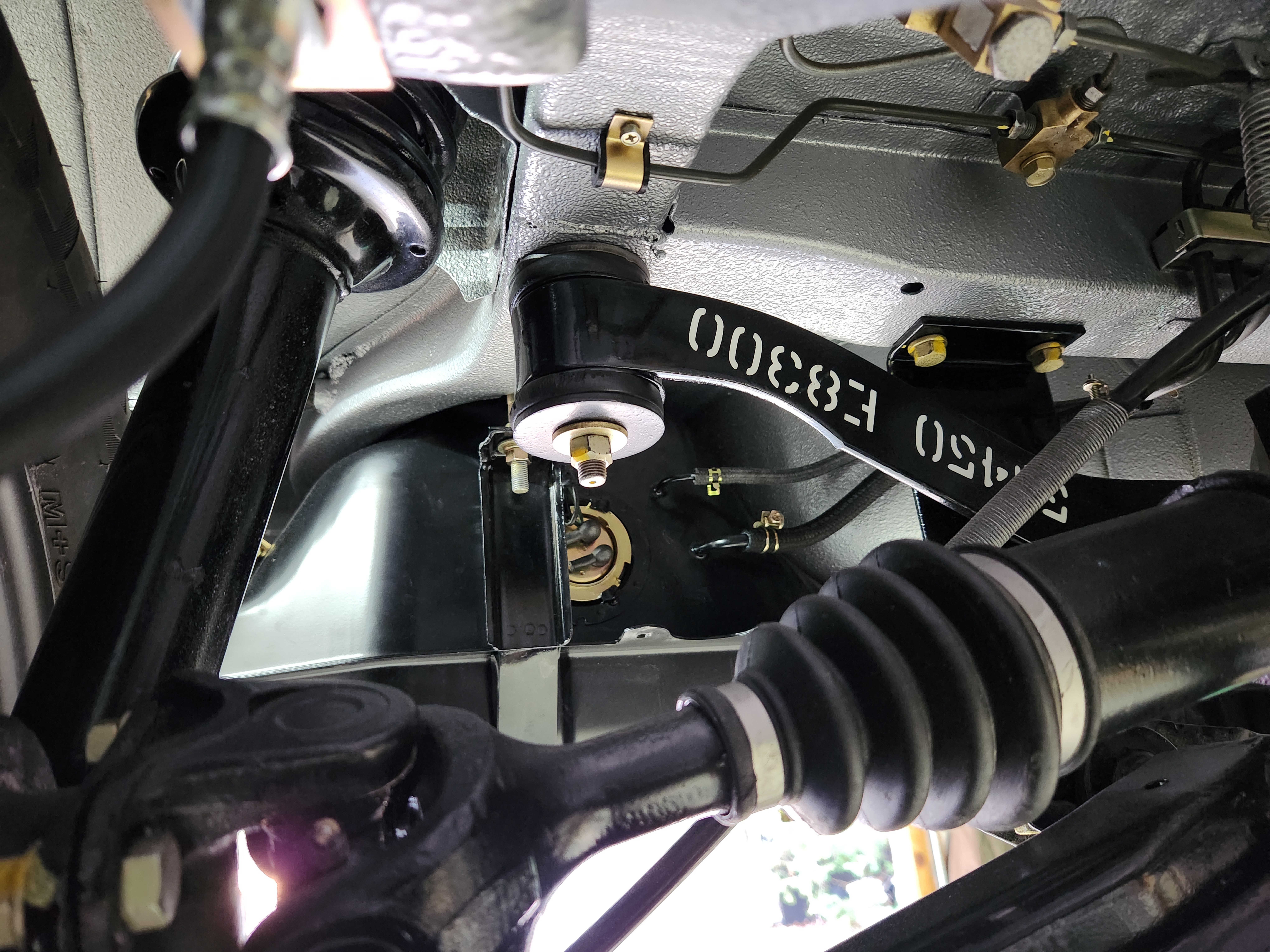

Little by little it goes back together. Once I get it running, it is headed to a frame machine to double check it. I was having some issues with the front right fender/hood alignment and decided it may have had more contact than previously thought.

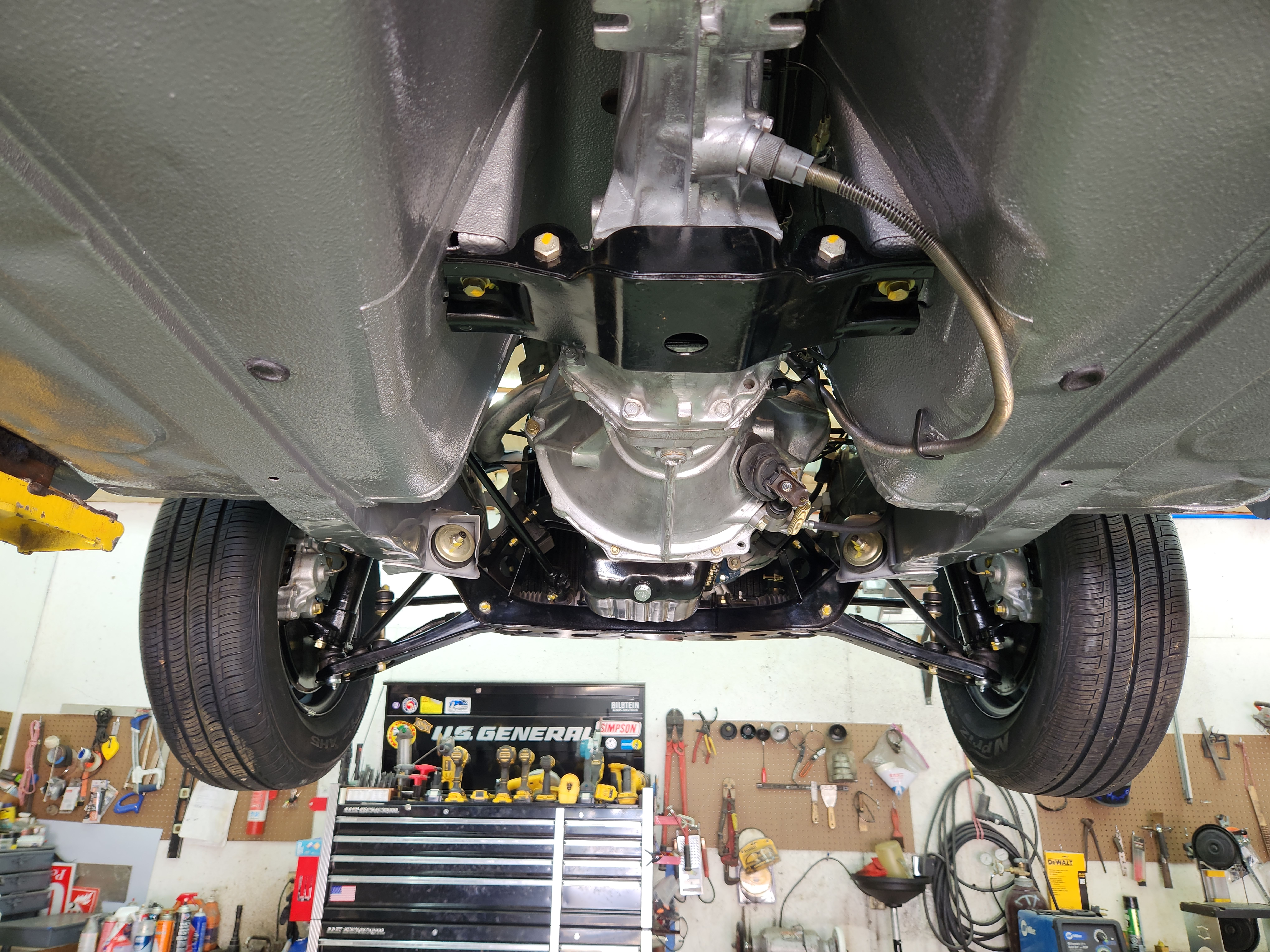

It was a raptor liner kit, then sprayed silver over it. I used it under the fenders and inside the doors.
I had one or two small places that we missed with the Raptor liner. I touched them up with some regular undercoat. In those areas the silver did not react well and left a yellow tint. I guess it is was the oil in the undercoating. The raptor liner is made to be able to overcoat with color.

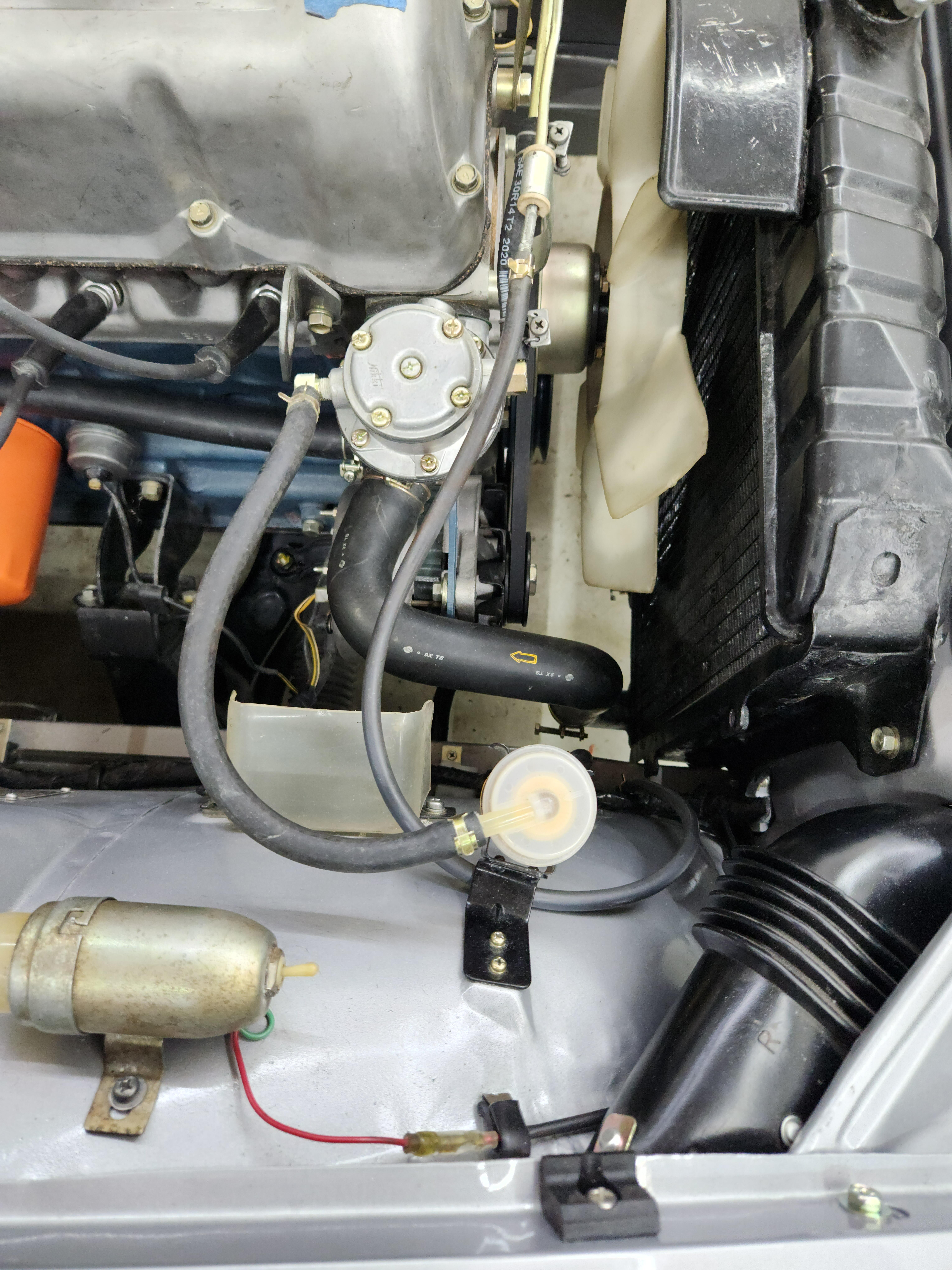

I have some braided fuel hose I am going to install. Anyone have a picture of the correct routing of the small fuel return rubber hose. This just doesnt look right:
Thanks!
