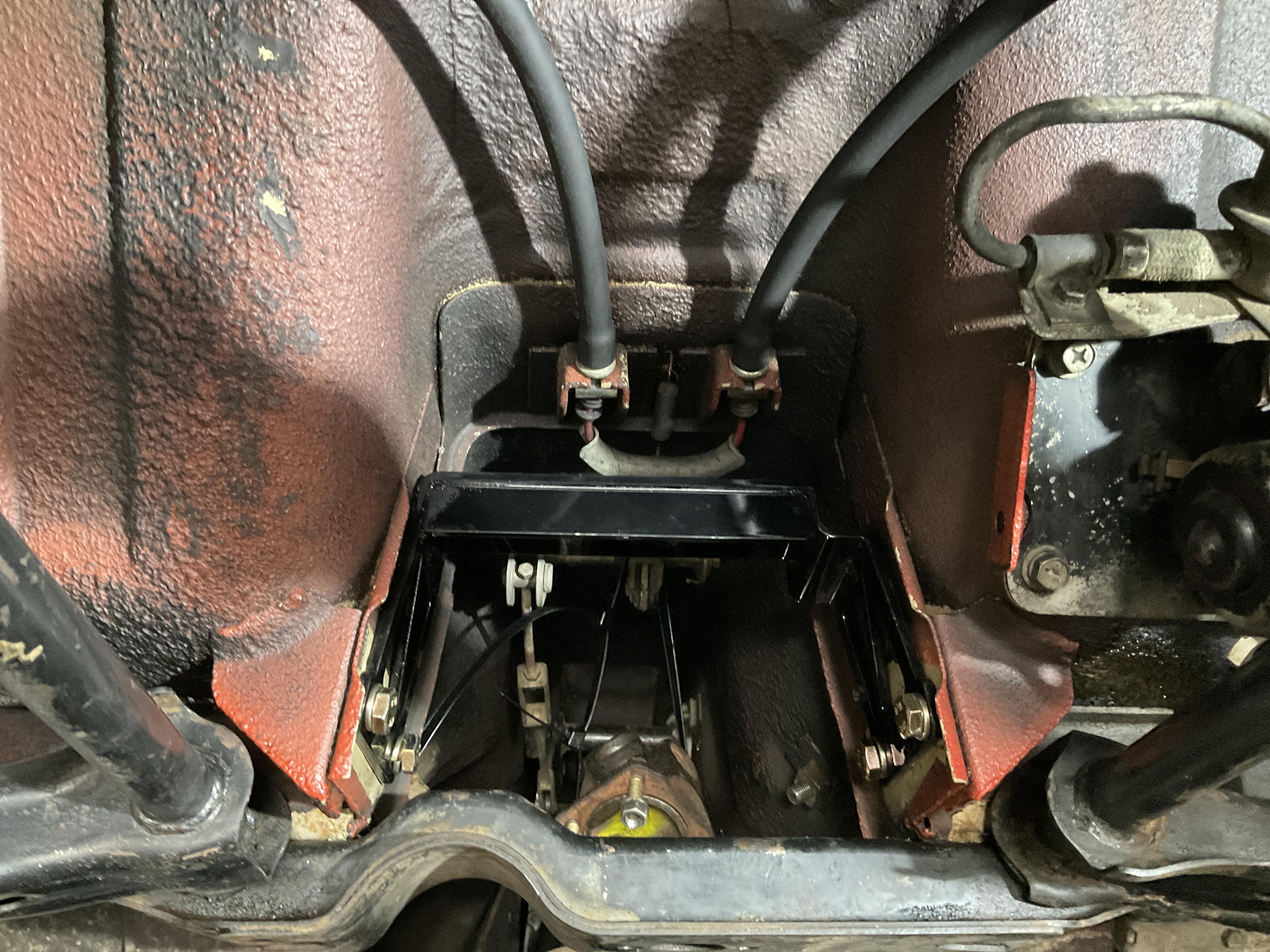

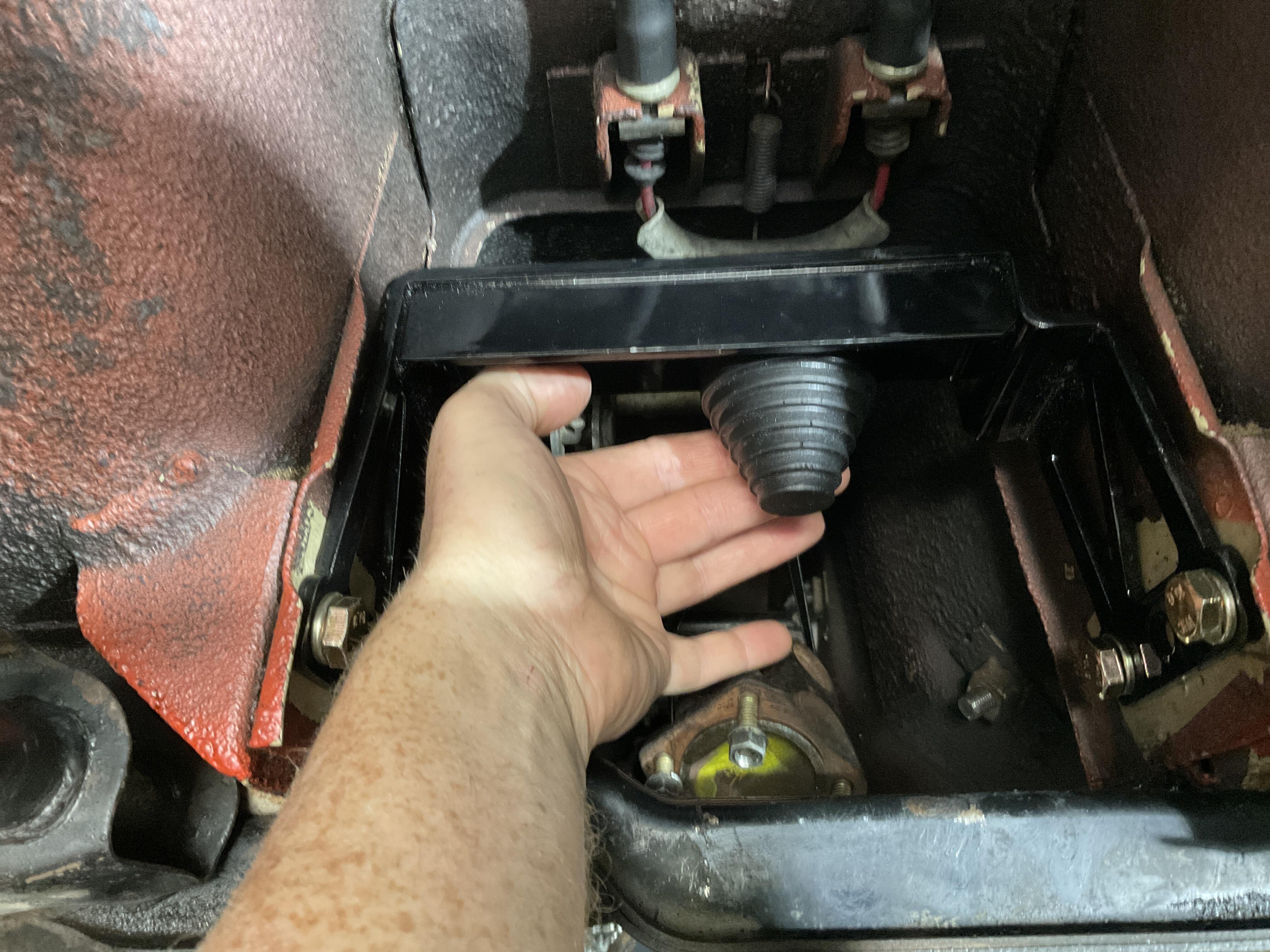

April 5, 20223 yr Author comment_638989 Today I’m installing the technoversion differential stop. I have the bracket in but was wondering how much material to remove from the snubber. The instructions says most applications should remove the bottom two steps but then it says but measure first. It’s a bit hard to measure holding an 80lb differential up there. What’s is the general consensus. Do you want the snubber touching the differential or do you want a small gap? I know a few folks installed these recently on a 280Z. Thanks Link to comment https://www.classiczcars.com/forums/topic/66453-77-280z-restoration/?&page=7#findComment-638989 Share on other sites More sharing options...

April 5, 20223 yr comment_638998 Here is what I found: Cut amounts 3/4" Definitely want a small gap, rather than compressing the bushing. Total length of the bushing after cut is about 31mm long. If you cut too much you can shim the bushing with washers. reference: Looks like what I was thinking of was the optional GM style mount that bolts to the differential. Oops! Link to comment https://www.classiczcars.com/forums/topic/66453-77-280z-restoration/?&page=7#findComment-638998 Share on other sites More sharing options...

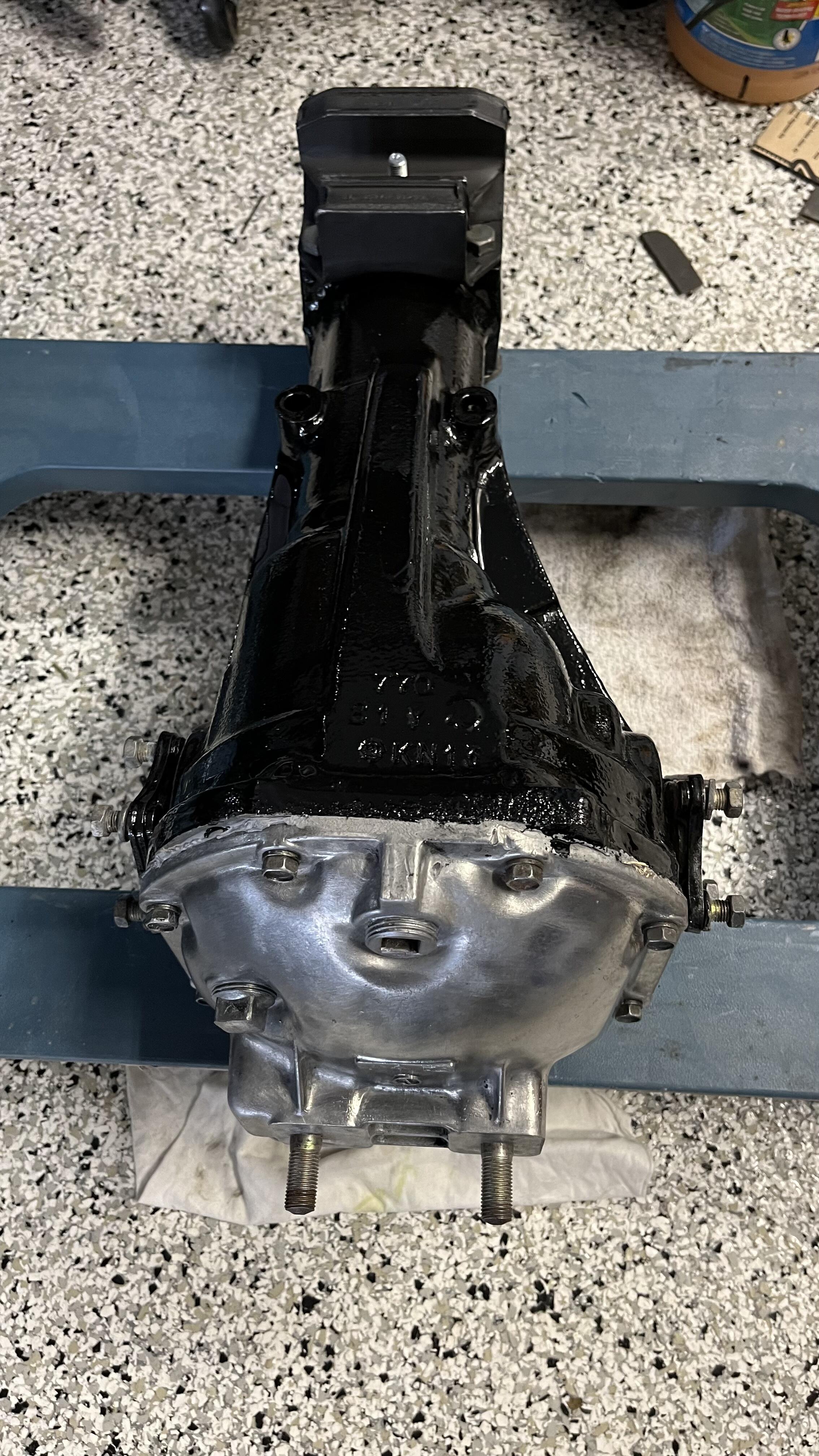

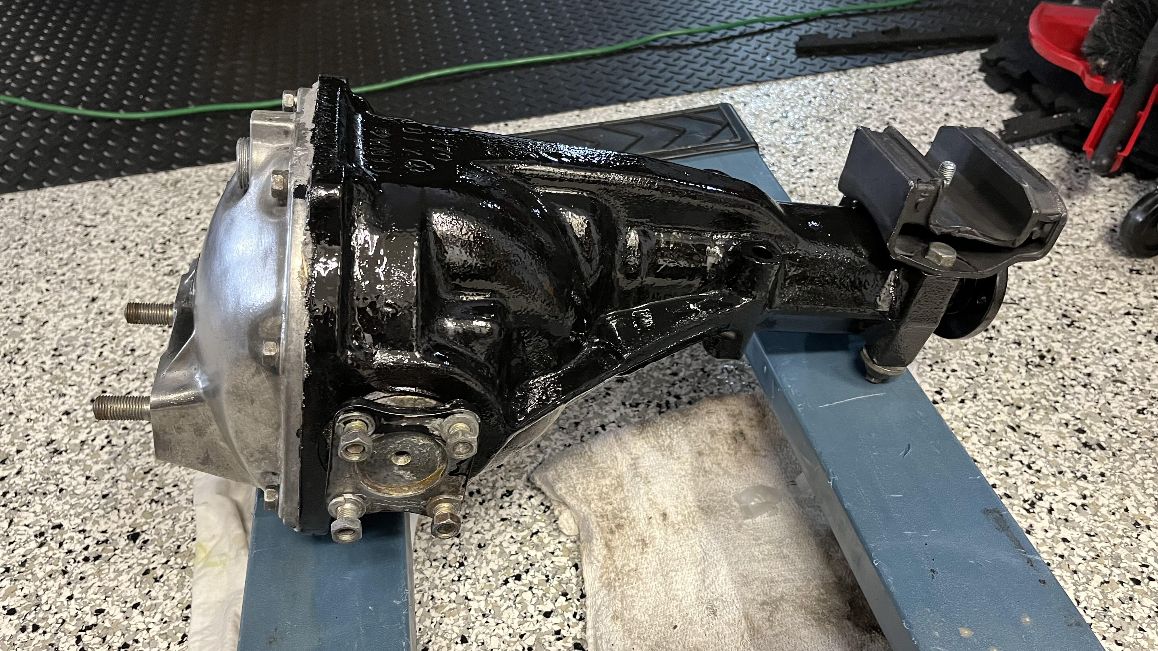

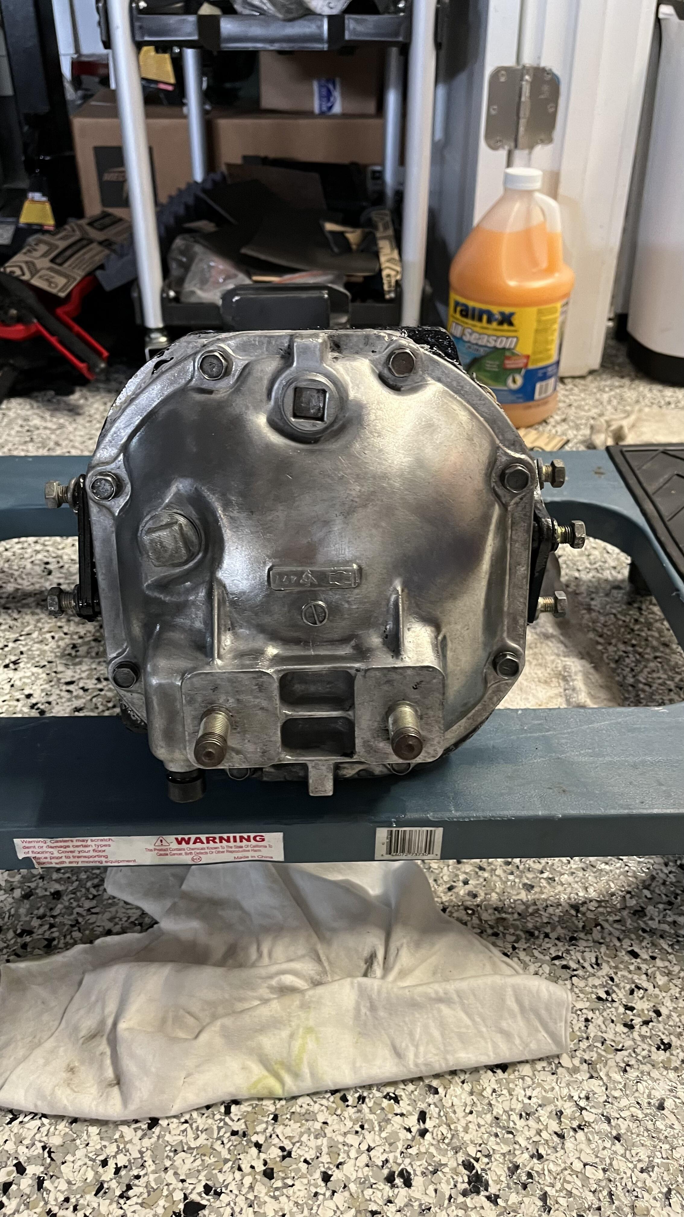

April 6, 20223 yr Author comment_639027 The ZX 39:10 differential I have is finally refreshed. I cleaned the inside with brake cleaner and wiped clean all the gears. The outside is painted with POR-15 and I kept the cover with the exposed aluminum. I put the old plug from my 3.54 differential into this one, because it uses a type for an box wrench vs the 1/2” drive type. I would not be able to service it with the ZX fill plug because there isn’t enough space between the back of the diff and the rear mount to inset a 1/2” drove socket. I put new synthetic 75W-90 gear oil in. Took more than what I expected. Read 1.3 quarts but it took about 1.7 before it began to run out the plug whole. Refreshing the 1/2 shafts now. Not fun cleaning all this gunk, and time consuming. Still waiting on my powder coated parts to be done. Sent from my iPhone using Tapatalk Edited April 6, 20223 yr by Av8ferg Link to comment https://www.classiczcars.com/forums/topic/66453-77-280z-restoration/?&page=7#findComment-639027 Share on other sites More sharing options...
April 6, 20223 yr comment_639029 On 4/5/2022 at 7:03 AM, Av8ferg said: Today I’m installing the technoversion differential stop. I have the bracket in but was wondering how much material to remove from the snubber. The instructions says most applications should remove the bottom two steps but then it says but measure first. It’s a bit hard to measure holding an 80lb differential up there. What’s is the general consensus. Do you want the snubber touching the differential or do you want a small gap? I know a few folks installed these recently on a 280Z. Thanks John, when I installed the TC mount in my 240Z, I bolted the differential in place without the snubber installed. Then got a few sockets of various lengths and started holding them up where the snubber should be until I found one that that allowed about 1/8" of up and down movement between the snubber mounting surface and top of differential. Then cut the snubber to the length of that socket. Just an idea. Link to comment https://www.classiczcars.com/forums/topic/66453-77-280z-restoration/?&page=7#findComment-639029 Share on other sites More sharing options...
April 6, 20223 yr Author comment_639030 John, when I installed the TC mount in my 240Z, I bolted the differential in place without the snubber installed. Then got a few sockets of various lengths and started holding them up where the snubber should be until I found one that that allowed about 1/8" of up and down movement between the snubber mounting surface and top of differential. Then cut the snubber to the length of that socket. Just an idea.Ken, thanks. Great idea. Wasn’t sure I was going to get in there once the differential was in. Glad to know it’s possible. Thank you! Sent from my iPhone using Tapatalk Link to comment https://www.classiczcars.com/forums/topic/66453-77-280z-restoration/?&page=7#findComment-639030 Share on other sites More sharing options...
April 6, 20223 yr comment_639036 When I did this I removed only the smallest two rings of the snubber cone. Mine does fit tight against the differential which is what I wanted for the time being (trying to remove all play from the driveline). There is some noise/vibration but t it's not terrible, and I honestly can't say for sure that it's due to the RT snubber. If you don't want any normal contact with the differential then you should probably shave off the next half a ring. Just a data point - the previous suggestion of trying various sizes of socket seems like a great idea.Sent from my KB2005 using Tapatalk Link to comment https://www.classiczcars.com/forums/topic/66453-77-280z-restoration/?&page=7#findComment-639036 Share on other sites More sharing options...

April 8, 20223 yr comment_639135 Looks great. Those half shafts came out awesome. Did you install new boots as well? Link to comment https://www.classiczcars.com/forums/topic/66453-77-280z-restoration/?&page=7#findComment-639135 Share on other sites More sharing options...
April 8, 20223 yr Author comment_639137 Dan, thanks. I hit those shafts with my power washer to knock of all the caked on grime. It was thick and struck in every crevice! I then metal etched the shafts and then painted them. Those l boots are not new, just cleaned them up . No cracks or dry rot there so I imagine they’re not so old. I put all my nuts and bolts in a shaker to clean them up also. Sent from my iPhone using Tapatalk Link to comment https://www.classiczcars.com/forums/topic/66453-77-280z-restoration/?&page=7#findComment-639137 Share on other sites More sharing options...
