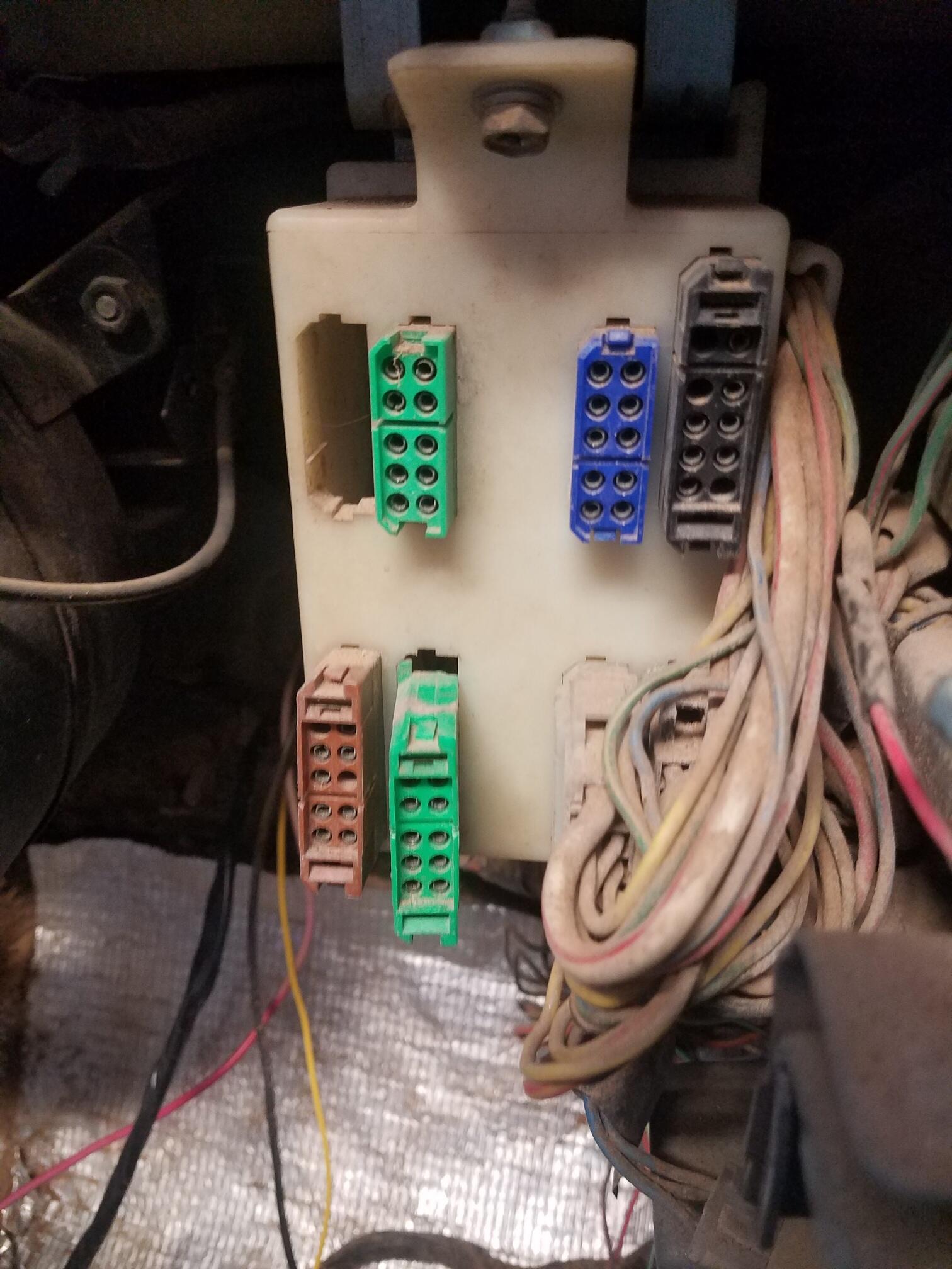

Now that I have the engine running it's time to address the dashboard electrical issues.  The only gauges that work are the speedo and ammeter.  I figured it might be a wiring issue related to them all so I pulled the dash.  I couldn't find any damaged wiring but notice the terminal block pic attached.  Possible connection issues at this point?  Is there any kind of cleaner or solvent that can be used to clean up the connectors?  Beyond that utilizing the wiring diagram I tried to figure out the concept behind the workings of the gauges.  Can't figure it out.  Black wires to all gauges are clearly ground. Red/blu wires to all gauges appear to be +12 but they are just for the lighting and it appears the resistor/dimmer is in parallel and shunts the voltage but this also doesn't seem right.  Basically I need to verify connectivity from the temperature sensor and oil pressure sensor and the fuel tank sensor to the appropriate gauges but can't verify the wires between the gauges and the sensors.  I have no idea how or where the tach connects so I need some assistance with that as well.  All these gauges worked prior to the engine rebuild so something has changed.  Looking forward to your assistance.

I was looking in the service manual and found wiring diagrams for the gauges on BE-33-36.  That has solved my problem with troubleshooting the gauges.  Still looking for suggestions on the terminal block.  Also need to verify that the in line resistor for the tach is 2.2k ohms.

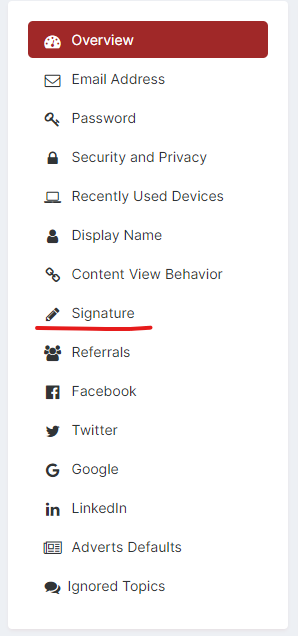

On the left hand side of the new screen, you will see Signature.
Click on that and add the year of your car to the signature block. Save it, and in future posts we will know what year car you need help with.
Contact cleaner is made for it.  Looks like a 74 260Z so it has the voltage driven tach.  Yes, 2.2 kohm is right.  You should still have the resistor on line, it's black and has two bullet terminals.  Edit - just remembered that the 260Z resistor looks different.  Very primitive looking.  Probably wrapped up in tape.
