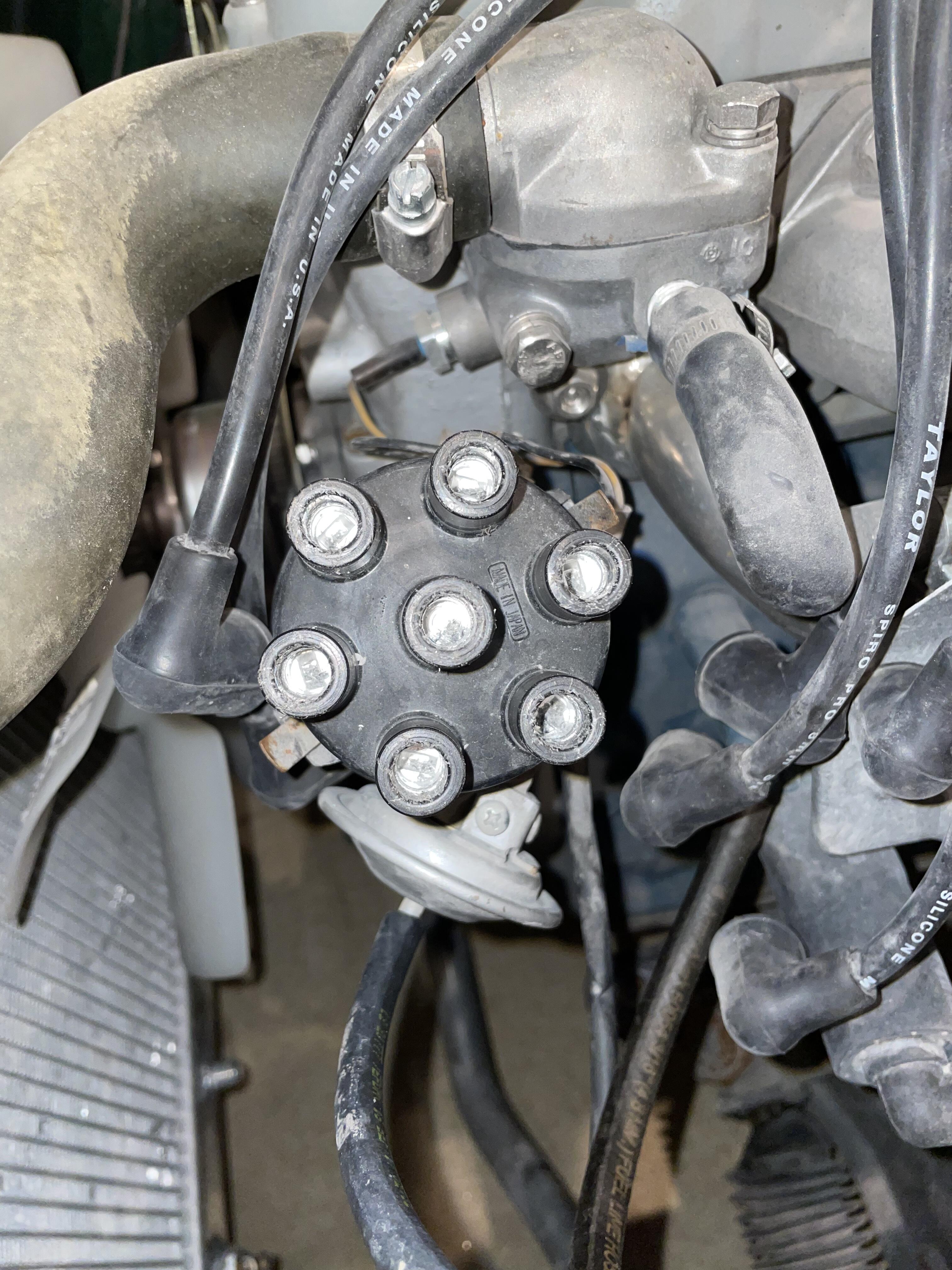

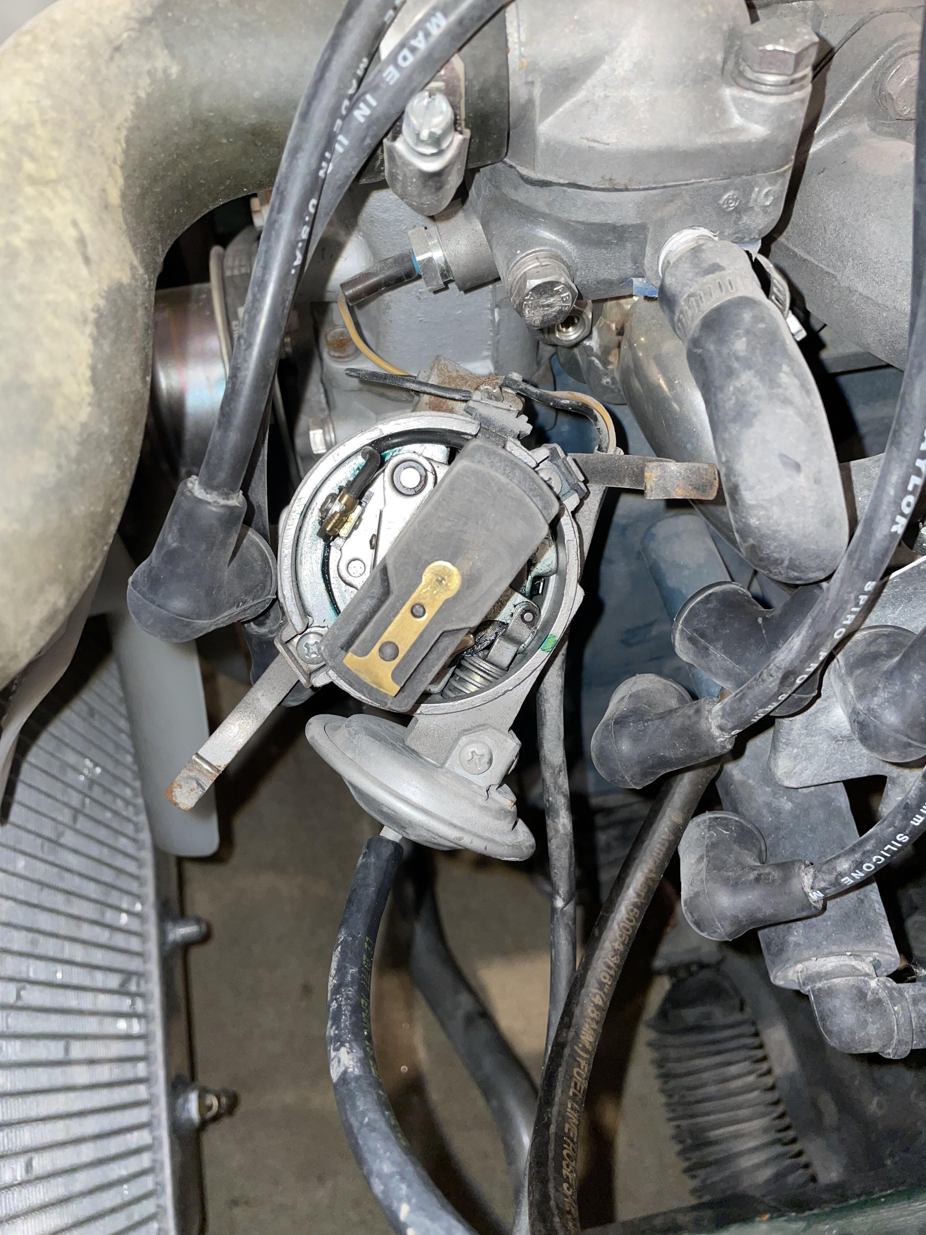

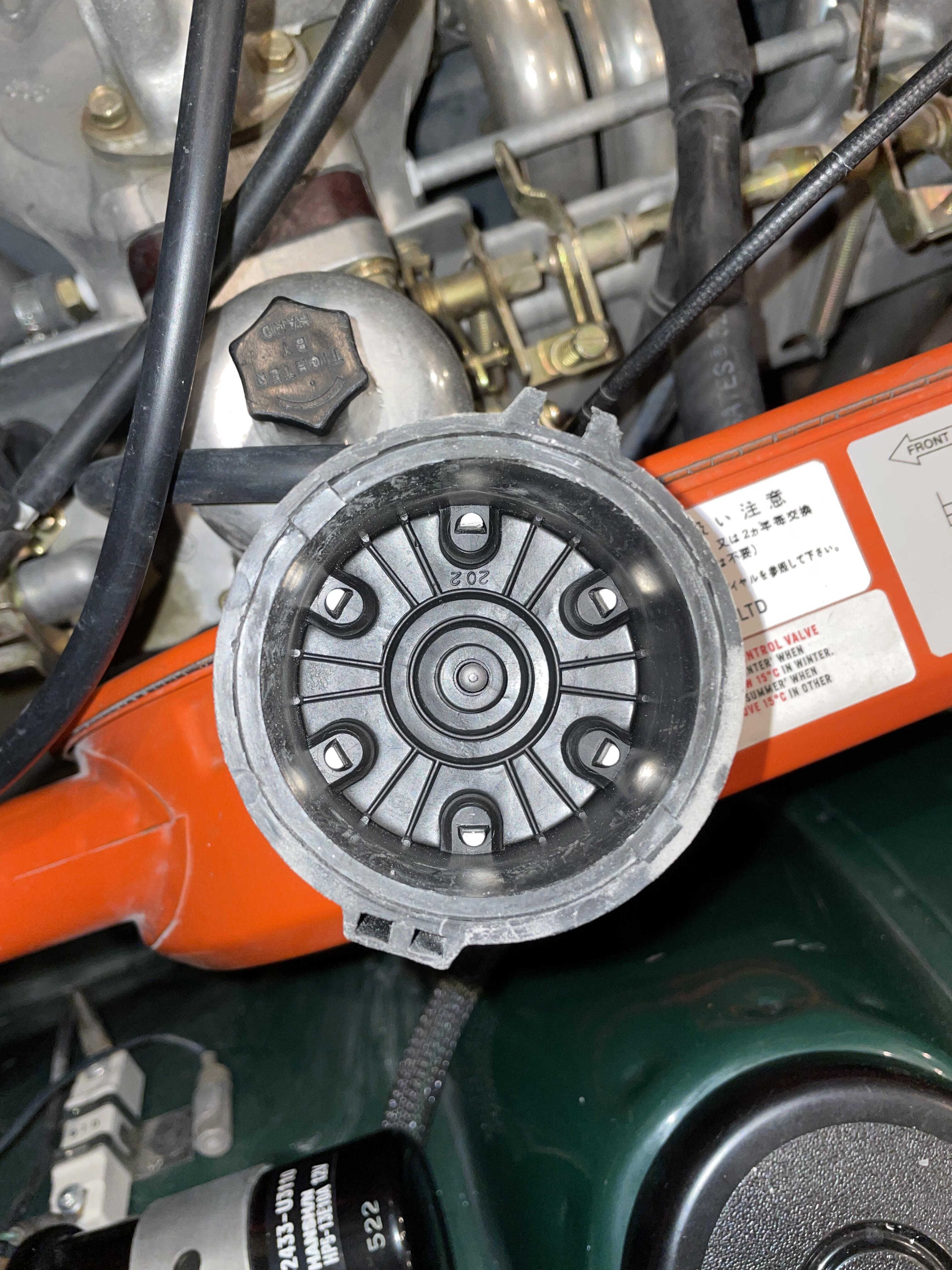

What ignition system is installed? Points? Pertronix? Crane? ZX distributor with ignition module? HEI? Other? If you're unsure, post photos of your distributor with the cap off.
What is the condition of the cap and rotor? (again photos) Remove the plug wires to assess the cap. Make sure you remember the order for the plug wires, too, so you don't install them wrong.

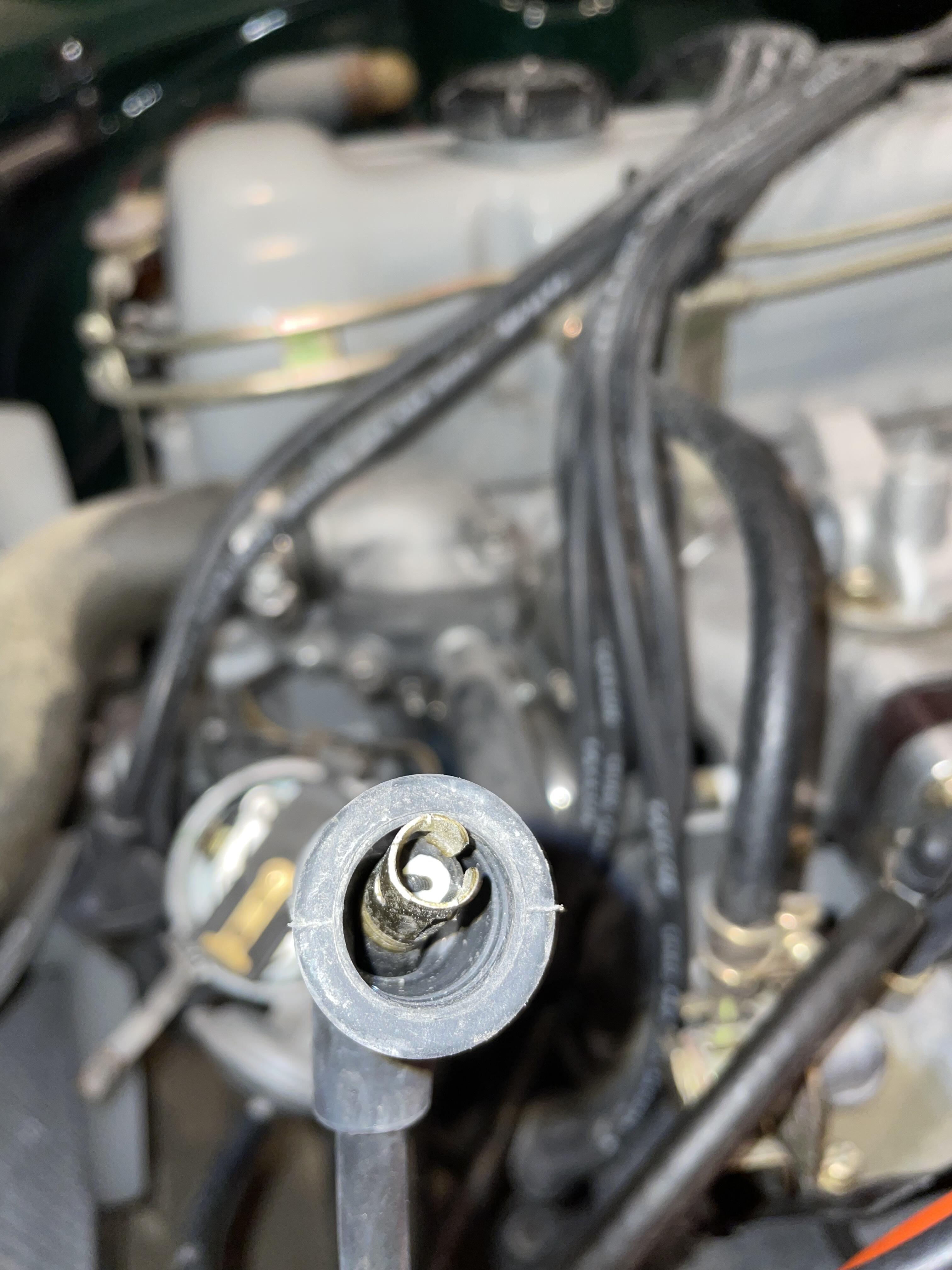

Here’s a couple of pictures of the cap and rotor:
To my eye, everything looks relatively sound (i.e. no burnt contacts) but you may tell me otherwise. The only thing that concerns me are the weird plastic shavings inside the connectors on top of the distributor cap.
Also, my wires looked a bit odd in my opinion:

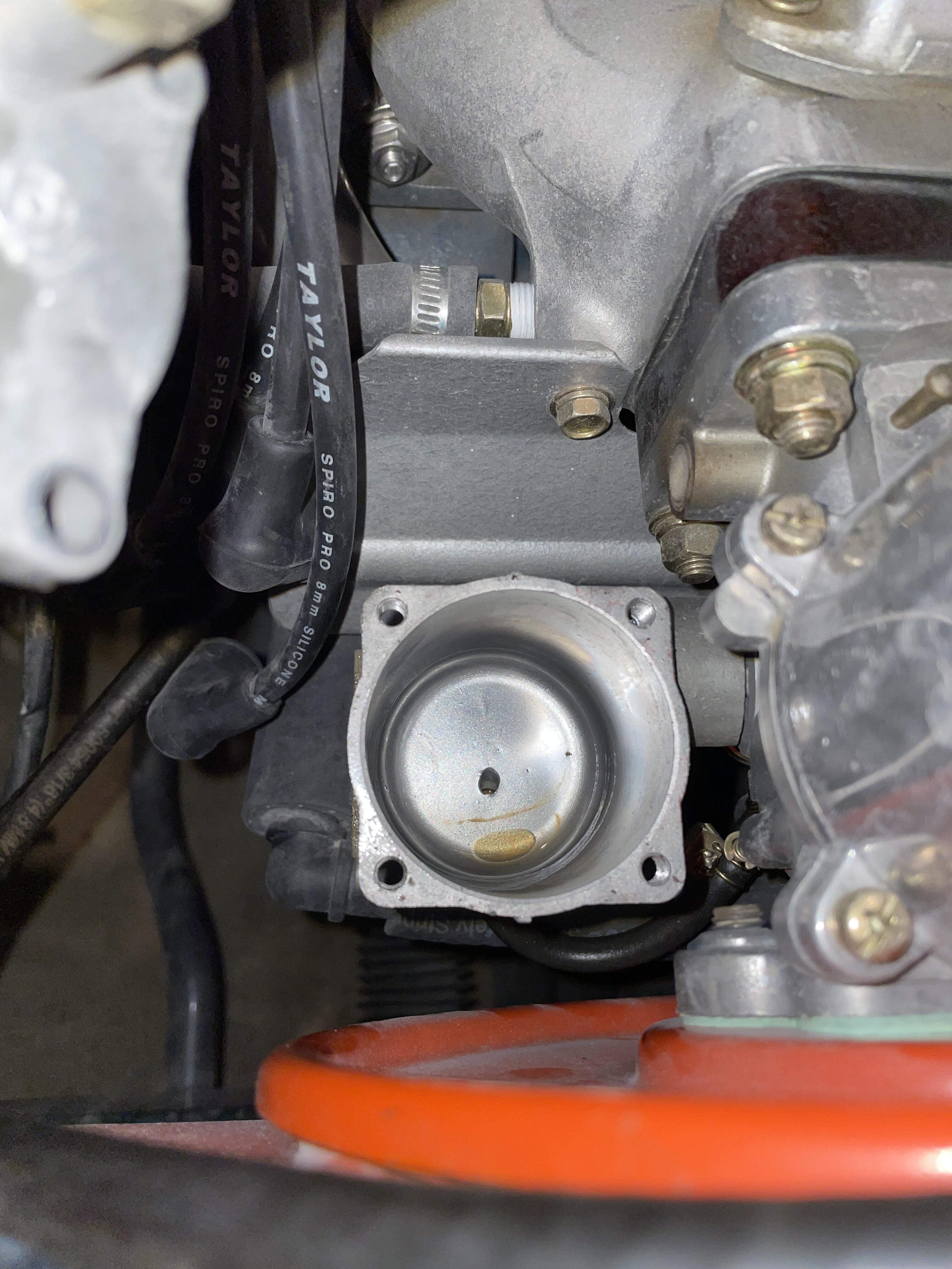

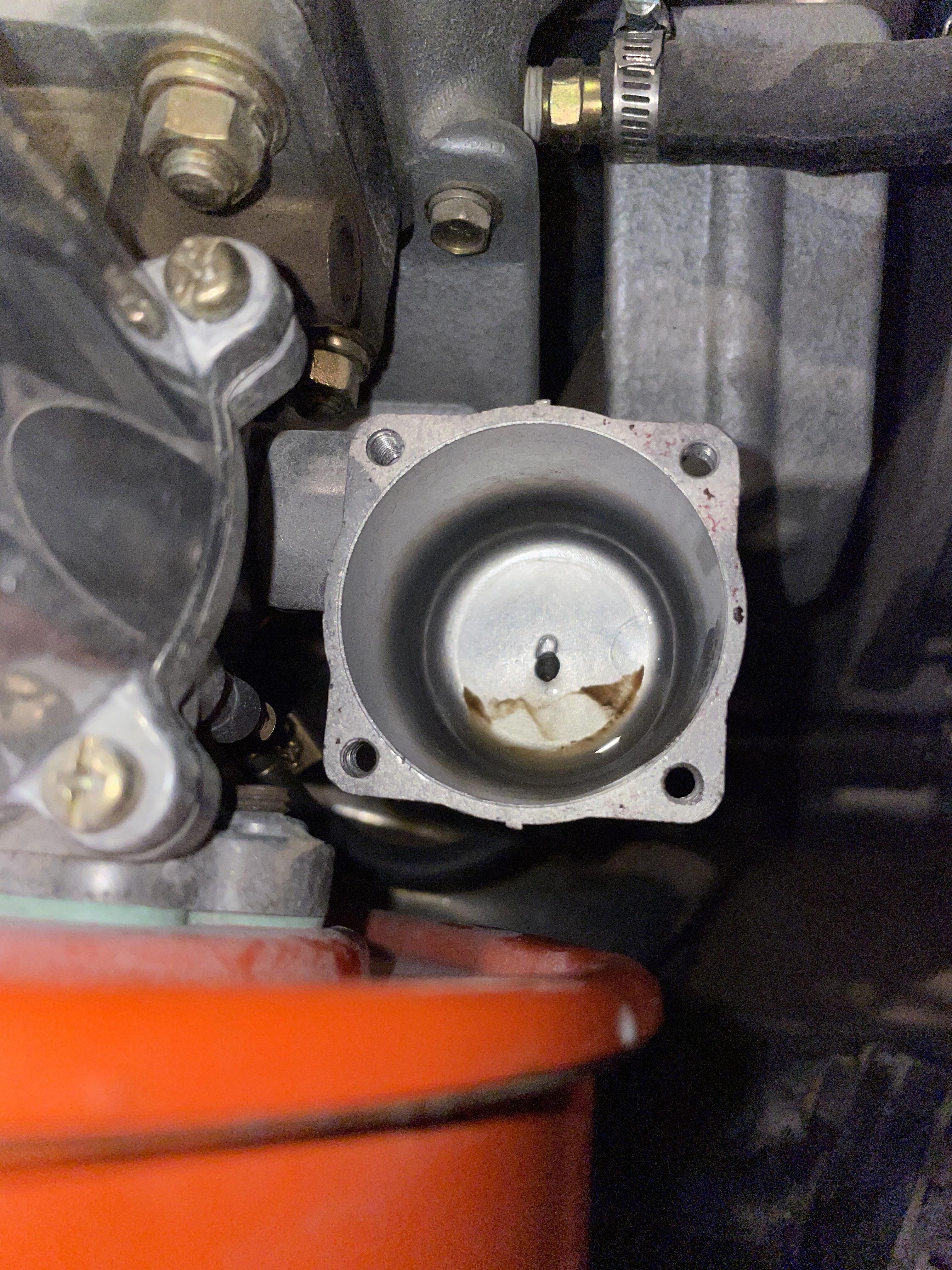

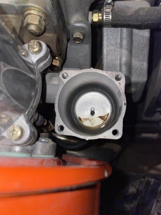

When I removed the lid on both float chambers they were virtually empty with a tiny puddle of gasoline at the bottom of each:
Should they always hold gas even when the car hasn’t been cranked recently? If so this may be the cause of the issue.
I noticed that my fuel filter has a decent amount of debris at the bottom. I’ll try swapping it out and let you know if that changes anything.
So is it too far out of line to say that your car died because it ran out of gas?
If the car ran this morning, there should be gas in the float bowls. Empty float bowls means that there is no gas available to be atomized. Try putting about an ounce of gas in each bowl. Shoot some starting fluid down the throat of each carburetor. (Tip: Have the air cleaner off and raise the piston in the carb to shoot the starting fluid into the intake.)
If you have gas in the tank, then why is it not getting to the carburetors? Fuel pump? Fuel filter? Rotten hoses? Rust clogging the system?
Fuel delivery was the issue. Replacing the filter fixed it for a while, but it’s back to having trouble starting.
I’m guessing more gunk from the gas tank made it throughout the fuel lines and is choking it out, so I’m having a shop clean out the tank and clear the lines.
