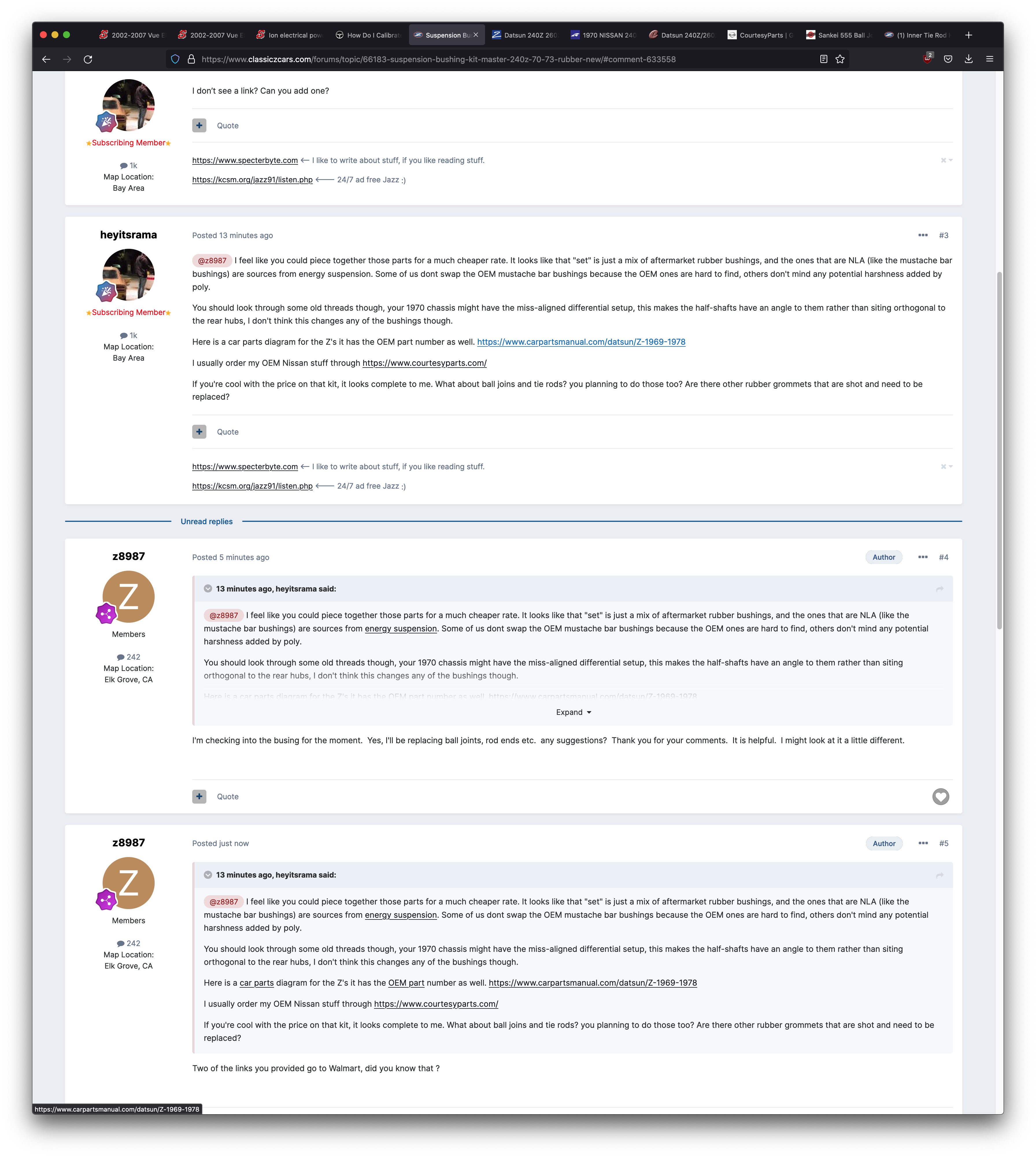

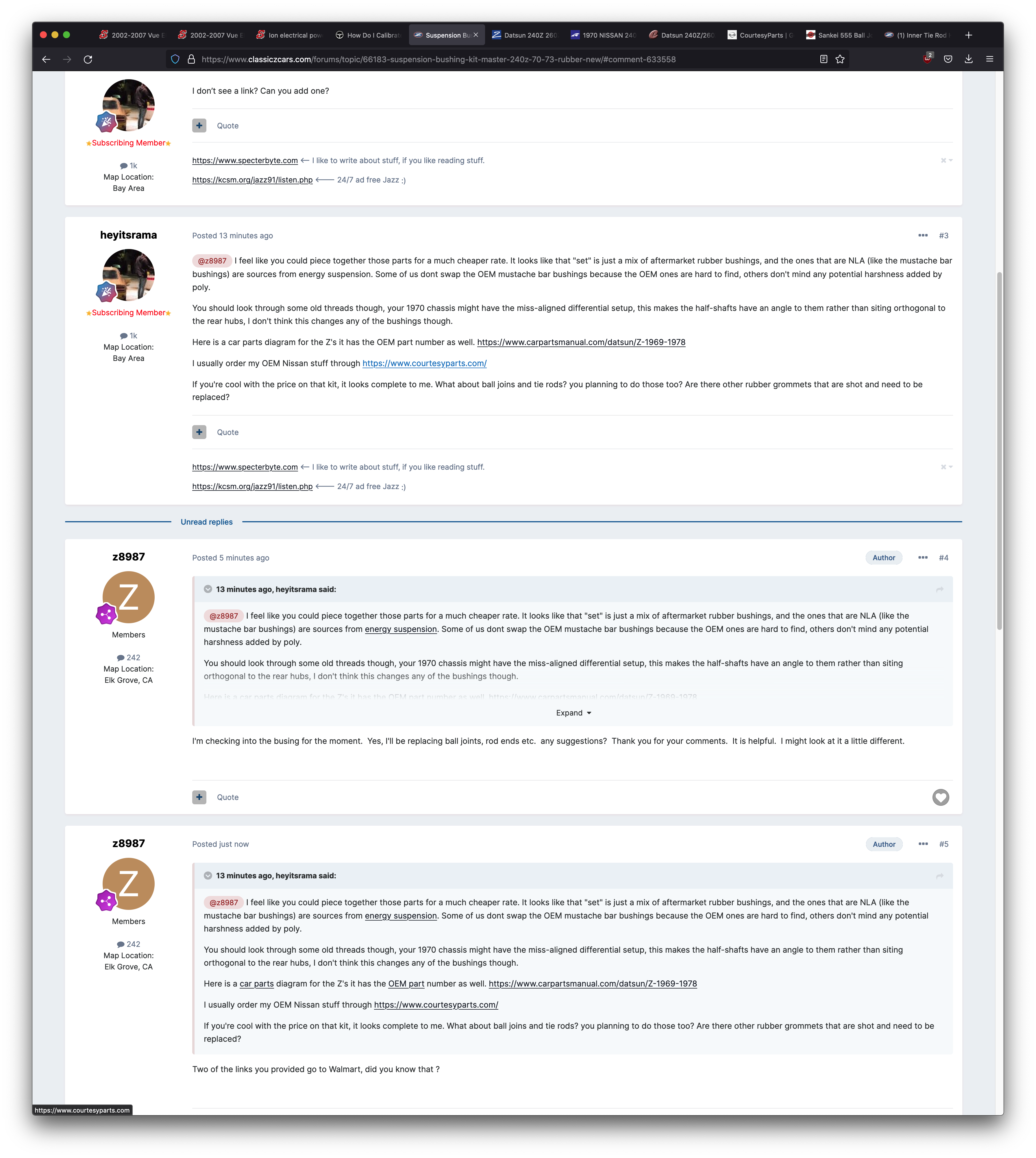

Two of the links you provided go to Walmart, did you know that ?
@z8987 they should not be going to Walmart, they work correctly on my machine.... Do you have any web browser plugins enabled? Maybe we should ping @Mike to make sure its not a problem with the site.

When I hover over Carparts and OEM in the post above it shows the link to walmart.com.  What do you see ?
Screen Shot 2021-12-26 at 6.53.48 PM.pngScreen Shot 2021-12-26 at 6.53.43 PM.png
The links can be seen in the lower left corner of the screen, I'm using Firefox with an ad-blocker. https://github.com/gorhill/uBlock
