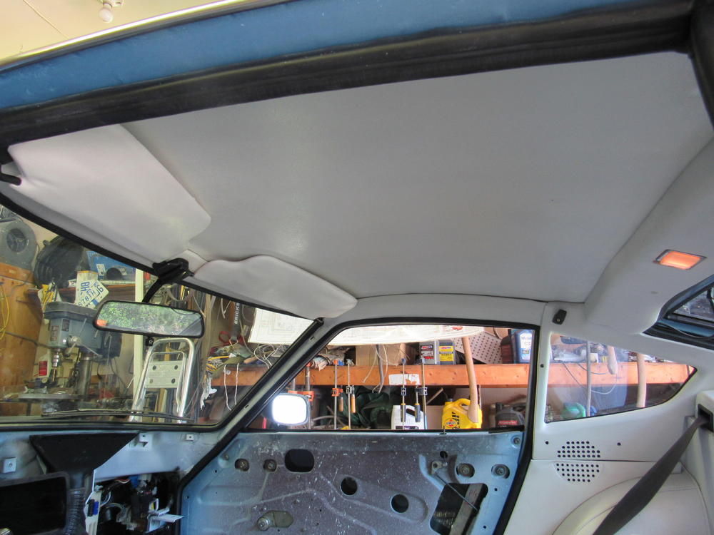

SEM automotive interior paint works very well. These are a couple of pics of a 77 280z I did a couple of yrs ago.

Can't speak for grannyknot but I foam brushed on some SEM white over the rear driver's side panel where the antenna goes and it turned out great.
I have spayed SEM before with great results but it has always been dark colors like black over black or black over green. I'm leery of white over black I guess.
23 hours ago, SJZ said:
Granny I assume you were spraying over panels that were already white?
Good question, hmmmm, I think they were white or actually a faded yellowy cream colour.
