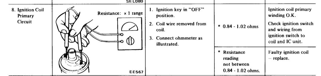

#1 was on the car with the stock ballast resistor in place, and the car ran.  I have subsequently removed the ballast resistor because I’m using the ZX e12 matchbox ignition.  The 82’. FSM says you want between .8k and 1.2k ohms across the center post and the (-) terminal.
So, I think the #2 coil that doesn’t fit the bracket has the proper resistance but doesn’t fit.  #1 coil has too much resistance.

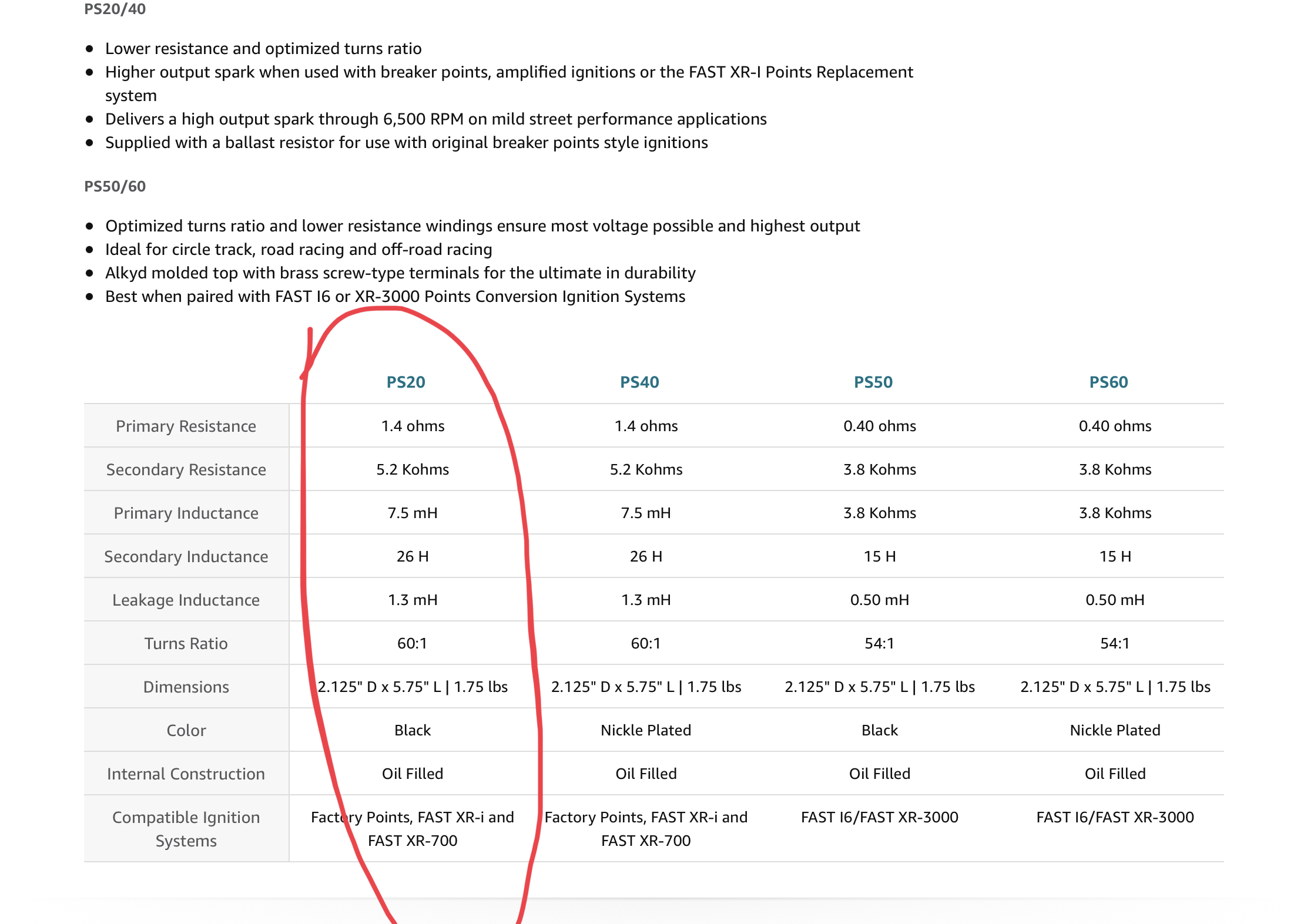

I use the Crane PS20 for my ZX E12-80 distributor on my 240. I think it's 1.3??? It did not fit the bracket but a piece of rubber underneath out of sight worked great for a shim. Very happy since 2016 conversion of the newer distributor. Bigger gap for the plugs too.
The primary circuit is what you want to match to your ignition module.  That's + terminal to the - terminal.
And if you got 1.2 ohms (not k-ohms) from the center post to the + on your #2 coil, it's no good.
Thanks Zedhead, I’ll try again.  Couldn’t get a stable reading between those posts last time, the meter was bouncing all over.  Changed the batteries on the meter and still no luck.  I’ll relook at it this AM.

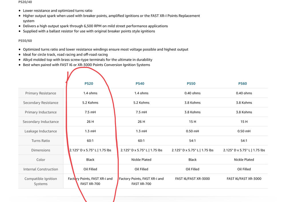

Cliff,  I think I’m going to buy that PS20.   I can’t get a stable reading from my coil.  It bounces from 1.6 to .8 and the center terminal is very rusty even have trying to clean it was sand paper.   I don’t want to be chasing gremlins on start.  What is the charge in gap setting for the plugs?   Specs say it’s a 1.4 ohm primary resistance.

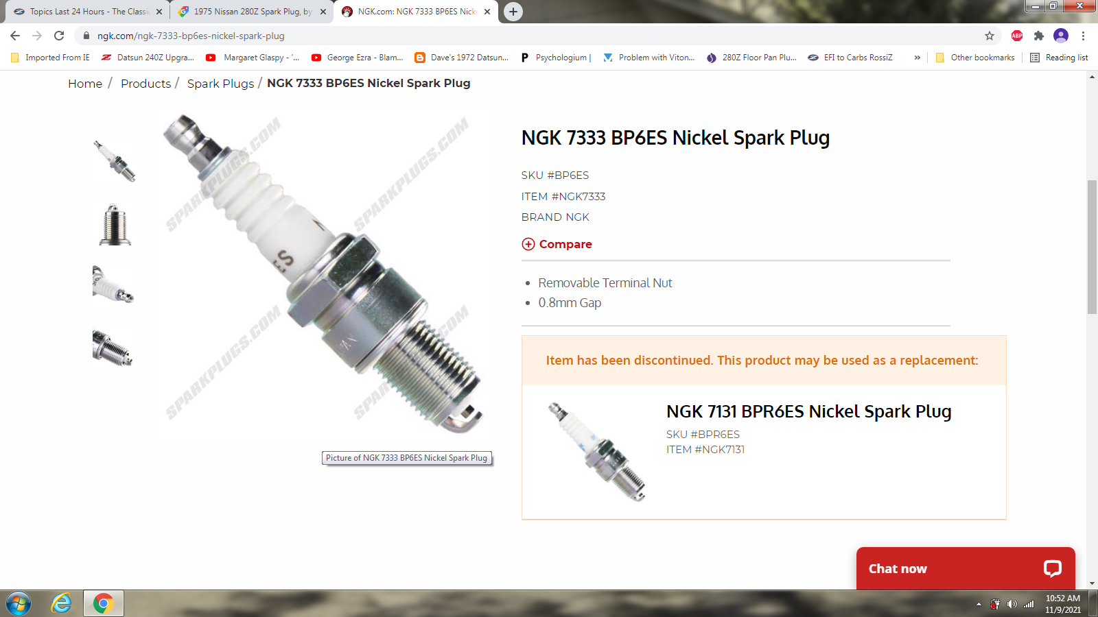

Read post 12. I think I went .45 or .44 in the end.
Oh yeah, bp6 in both my Zs. Copper tips.
