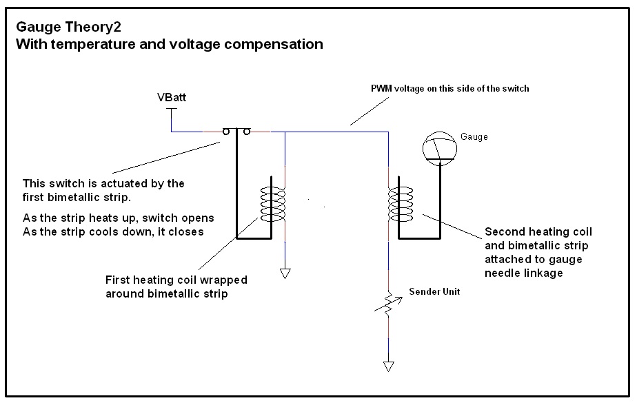

So I set up the gauge with my power supply and a variable resistor. It's interesting to me to watch the power supply ammeter while I'm doing the demonstration.
There will be some DC current draw variation due to the change in resistance of the sender unit, but the approx. once-per-second fluctuations in the current draw while you aren't changing the (simulated) sender resistance, that's not due to any divider. That's the temp/voltage regulator built into the switch. You're seeing the PWM draw from the regulator contacts opening and closing.
You won't see this when you first hook up the gauge because the regulator is cold. And a cold regulator will run full bore (100% duty cycle) until it heats up.
Thank you for the correction. What I wanted to show most in the video was that the voltage regulator should be connected while testing.
I have seen in the archives about people testing the fuel gauge out of the car, and it failed when they only connected the green and yellow wires (no wire from black to ground) for testing. The gauge I used was one I purchased about 10 years ago and never tested. Fortunately it is a good gauge.
Again, when testing, don't forget to connect the black wire to the negative of your power source.
Glad to help. That temperature compensator/regulator is really an ingenious little detail. I should really put together that "how the gauges really work" thread I suggested some time ago. In fact, I suspect the OP's issue with his gauge is dirty contacts in the regulator portion of his fuel gauge. (But I haven't officially suggested that yet because it's jumping the gun until you work through the other possibilities.)
So, you had previously mentioned (in another thread) the caution about damaging the gauge if you didn't connect the ground. That ground connection is the low side of the regulator heater, so if it's disconnected the PWM will run full bore 100% to the sender unit. But I'm surprised to hear it's enough power to burn out the sender heater. You've seen this happen? It's only about 240mA 130mA.

It was interesting to see in the video how much the current dropped after the first heating coil came up to temperature and started operating the voltage regulator. Mind you, that was on the second run of the day after I verified I had a working circuit. I just ran a test. It took about 7 seconds for the VR to come up to temperature with an ambient temperature of 64 degrees F. I don't really want to see what the power supply ammeter reads without the VR just in case I'm right that it could burn up the gauge.
The gauge current will actually drop completely to zero when the regulator opens. You're looking at a wildly swinging PWM signal with the digital current meter on your power supply and I didn't see a zero fly by on the gauge, but it does actually cut off completely.
And that comes back to the burn out the gauge question... In normal operation, the sender resistance could be zero. So in normal operation, the gauge heater will pass current proportional to it's heater resistance which is about 50 Ohms (which I believe is about 90-100 Ohms). But it doesn't pass that current 100% of the time. It's pulse width modulated and the average power is cut down because of that*. When you operate it without the regulator ground connected, it's running 240mA 130mA at a 100% duty cycle. And it sounds like given enough time, that's enough power to eventually heat up the nichrome wire to the point that it doesn't like it.
*I didn't write anything down, but memory says the regulator runs at about 50% duty cycle once it's warmed up.
Edited by Captain Obvious
Well that's what I get for relying on memory... I just took a quick look at a fuel gauge, and I got the heater resistances wrong. The heaters (both regulator and needle movement) resistances are about 50 Ohms each, not the 100 Ohms I mentioned above. The SENDER unit is 90-100 when empty, but the heaters in the gauge are about half that.
If the regulator is closed, it will pull about 240mA. And if the fuel sender is at zero (full scale), the needle heater will pull another 240mA.
So if you run the gauge without the regulator heater (no ground connected), the needle heater will see a constant 240mA at 100% duty cycle (not the 130 I mentioned above).
