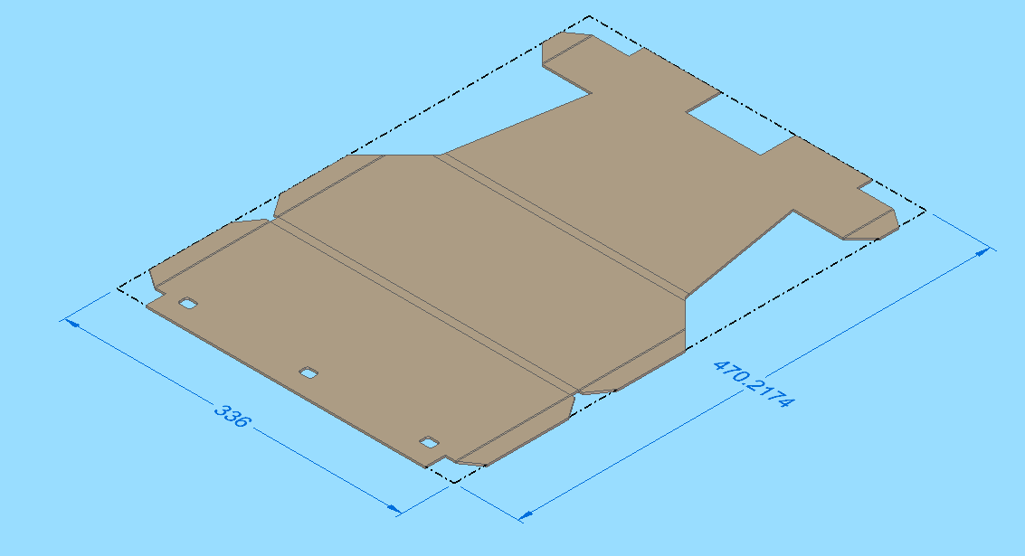

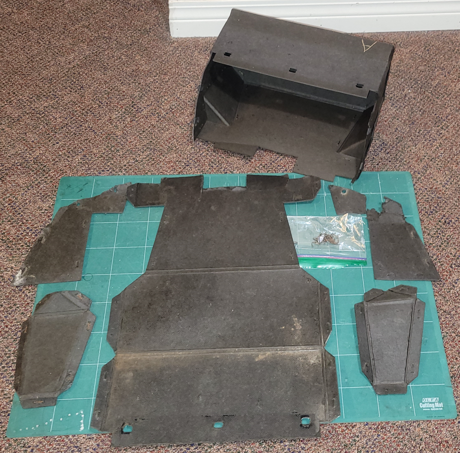

I had some free time today so I decided to take apart the glove box from my 12'70 parts car to make a 3D model and flat patterns for templates. I also have a pristine glove box from the 7'70 I'm restoring. Between the two I should be able to do this quite accurately. I will upload the results to the cad files section in downloads on this site and also post updates here as I make progress. Here is what I have done so far...
Thanks, CanTechZ.  What you're doing will be quite helpful to julitoMX_1964 as I think it will be better for him to cut the top, back and bottom parts out of one piece of PVC or ABS sheet and bend it as needed at the edges.  I have been working with ETI4K to produce mold core models for julitoMX-1964's thermoforming the side pieces and for me to do one-piece FRP lay-ups of the whole box.

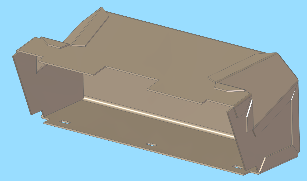

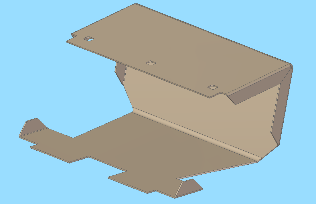

Finished modelling the glove box, not perfect but reasonably close. On the weekend I will post the model and flat patterns to the club downloads area.
