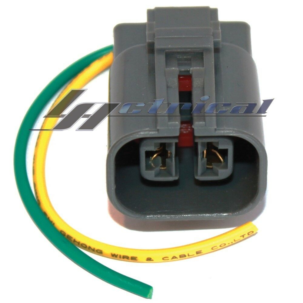

  2. I did some digging. The alternator in your photos is probably this one: https://www.obbstartersandalternators.com/13778n-lr170-757b-lr170-757br-lr170-765-lr170-766-p-894.html. I saw the 13778N sticker in your photos. I looked up alternator wiring for the Frontier and found this: https://www.ebay.com/itm/302008182071. Picture below. That has the color wires described on the ZCarDepot site.

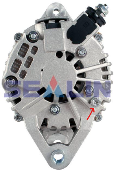

  3. From looking at some other images online, I would think that the Earth terminal is where I have the arrow drawn in the picture below.

2-the image you sent matches the image of the harness that was on the ZCarDepot site, but not the actual harness. the actual harness they sent has a green and red wire-the red wire is where the diagram shows a green wire, and the green wire is where the diagram shows a yellow wire. this would actually make more sense, as the red wire would be 12V post.
3-that is where I have the earth eyelet wiring from the car

  2. Color is relative. Position is everything. The picture I included does not show where the green and yellow wires land on the back of the connector. I was trying to show the origin of the description from ZCD. You need to verify which wire is which on the alternator you have. In your photos, it looks like the red wire is jumpered over to the B wire. I cannot tell you with any certainty that your wiring for that is correct as I have not physically examined the alternator, nor have I been able to track down a wiring diagram. Hence my suggestion for you to buy the Haynes manual to try to track it down. Are either pin marked with an L?

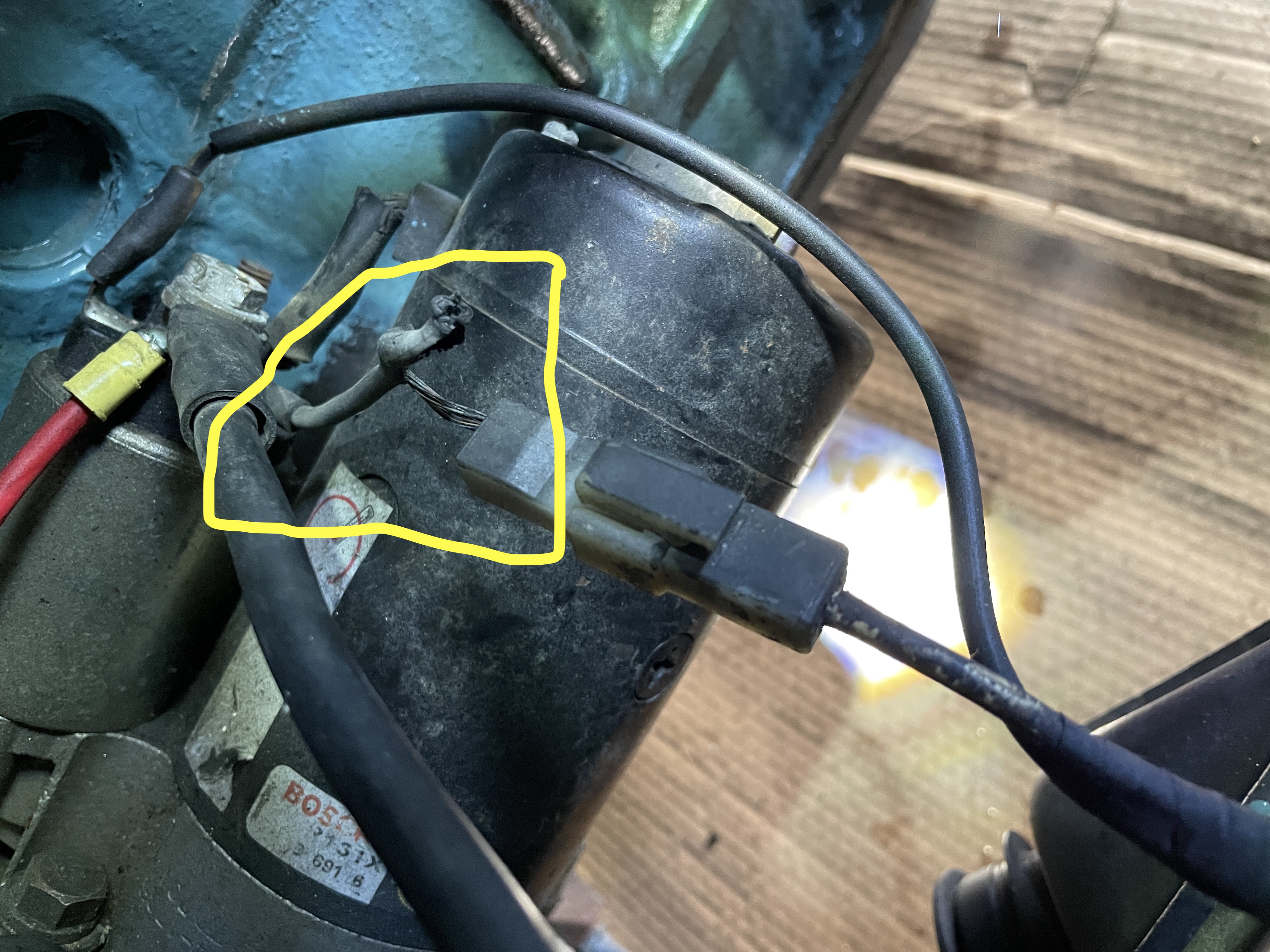

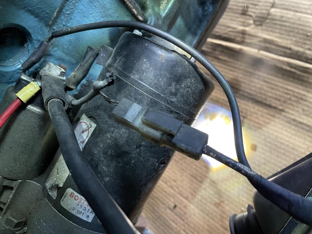

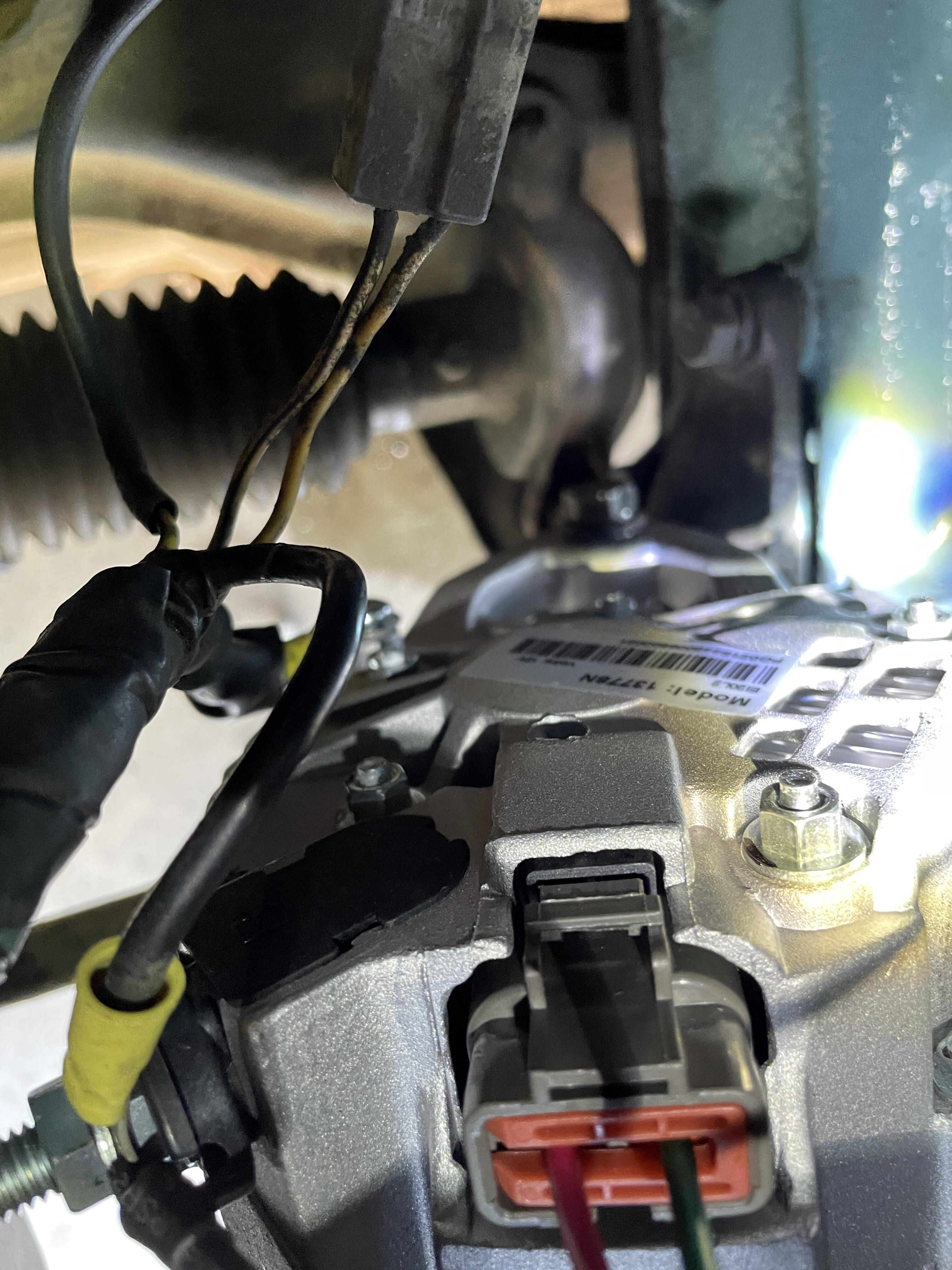

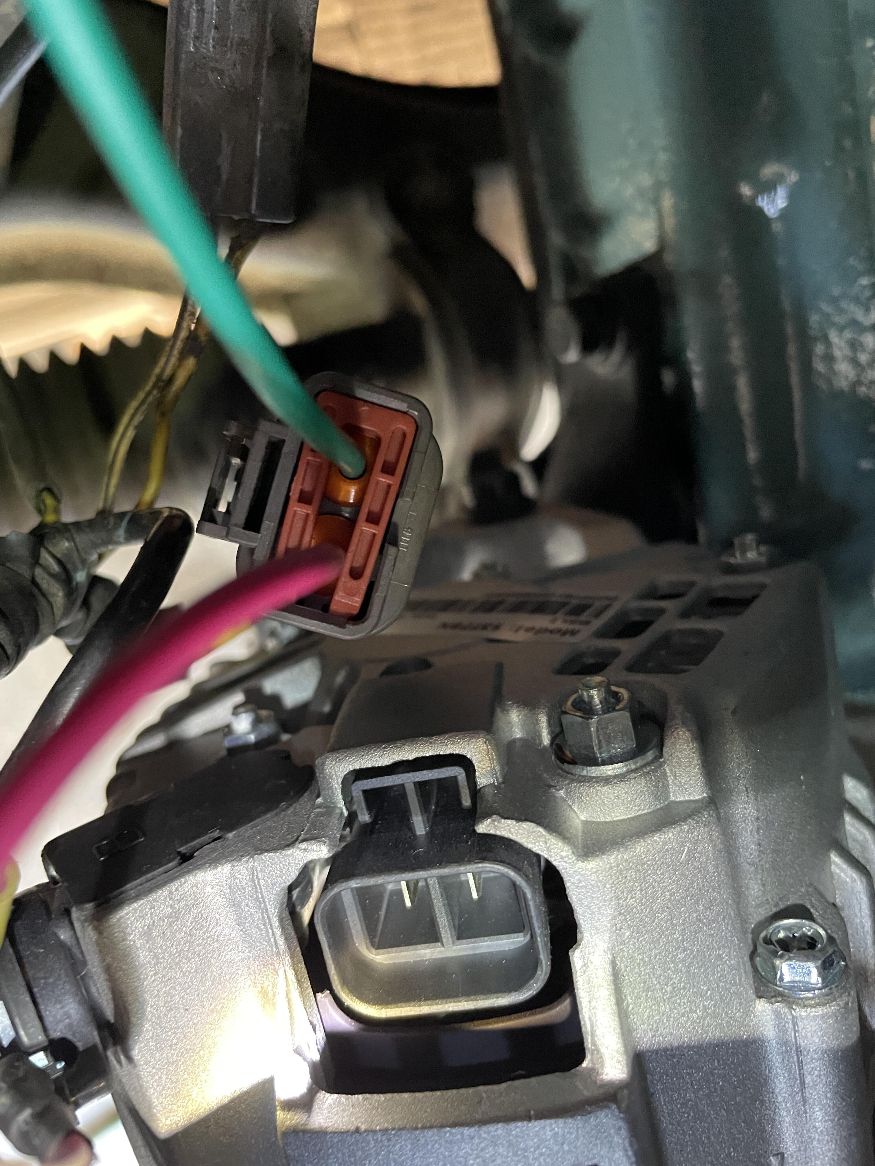

Attached are pictures of the alternator, as well as my fried starter wire. It appears as though I could just use heatshrink, and re-insulate the wire, but I'm also happy to roll my own from scratch(I have a lot of experience soldering via building synthesizers). The portion of wire to the right of the harness appears ok, visually. It travels through wrapping along the frame rail. I can test it on a DVM and see what it connects to; if there is unseen burned insulation that could be dangerous, I could always re-run that wire section in the interest of safety.
On the alternator, I don't see any designations of the output tabs themselves. The +V is notated "B", ground tab is not, but it's obviously contiguous metal with chassis, so I think it's a safe assumption.

That is NOT a starter wire. That is a fusible link. Don't know what a fusible link is? Click here: https://media.digikey.com/pdf/Data Sheets/Littelfuse PDFs/Fusible_Link_FAQ.pdf
Replace it. It is done. You can get a replacement from Banzai Motorworks (http://www.zzxdatsun.com/catWiring.php WH-03 @zspert) or  Motorsport Auto (https://www.thezstore.com/page/TZS/PROD/12-4332).
Ironically, the wire should have burned up leaving the insulation intact. In the meantime, disconnect the battery so you don't short out the link.
As for the alternator, since it does not have any identifying marks for the L and S wires, I will expand upon my previous suggestions (You need to do at least one.):
  1. Buy the Haynes manual for the Frontier (98-04). The electrical section may have the information on what you need. You can get a used copy off Amazon for about $14. How much is your car worth to you?
  2. Go to forums on the Nissan Frontier and see if someone with electrical knowledge can answer your question about which is L and which is S.
  3. Use a multimeter on the resistance setting. If it has multiple resistance settings, you may have to repeat the steps below on 1M ohm and 1K ohm settings.
    1. Touch the common probe to the red wire. Touch the other probe to the B terminal. Record the reading.
    2. Touch the common probe to the B terminal. Touch the other probe to the red wire. Record the reading.
    3. Touch the common probe to the green wire. Touch the other probe to the B terminal. Record the reading.
    4. Touch the common probe to the B terminal. Touch the other probe to the green wire. Record the reading.
    5. Repeat steps 1-4 replacing the B terminal with the E terminal (grounding point).
    6. Report your readings from each step. If it's like the ZX alternator, I should be able to tell which is L and which is S. I'll explain what I'm looking for when I see the results.

Might be that somebody left the fusible link out and that is "real" wire.  Anyway, I'd be wondering why it burned up.  Maybe somebody connected the (A) B+ wire to the E terminal at the alternator.

There are a lot of variables we don't know about that could have contributed to the failure the insulation of the fusible link. For instance, I believe I saw paint around the connector. Paint, corrosion, etc, would adversely affect current flow, building heat. We don't know the condition of the battery. If it wasn't fully charged, the alternator would be pushing more current across the link.
