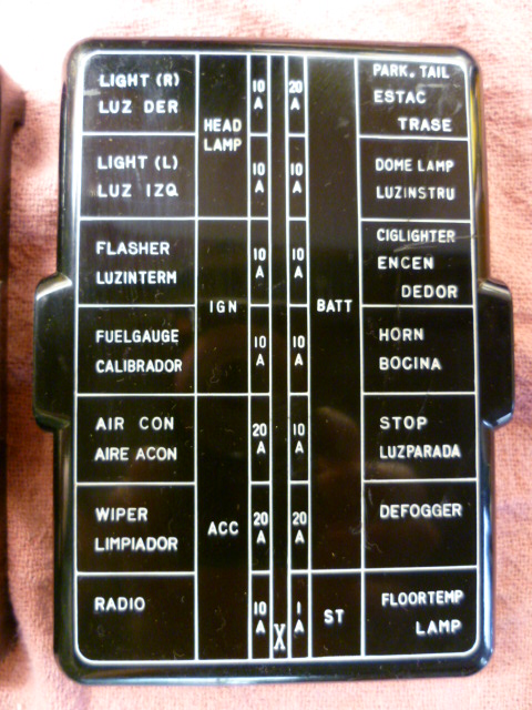

Here's a snippet from the 76 FSM showing the fuse block layout. Note that it shows the turn signals (FLASHER) coming from the third fuse down. This makes great sense to me since every other year from 74 through 78 uses the third fuse down on the left column to power the turn signals:
And here's a 76 cover I have here that confirms the accuracy of the pic in the manual:

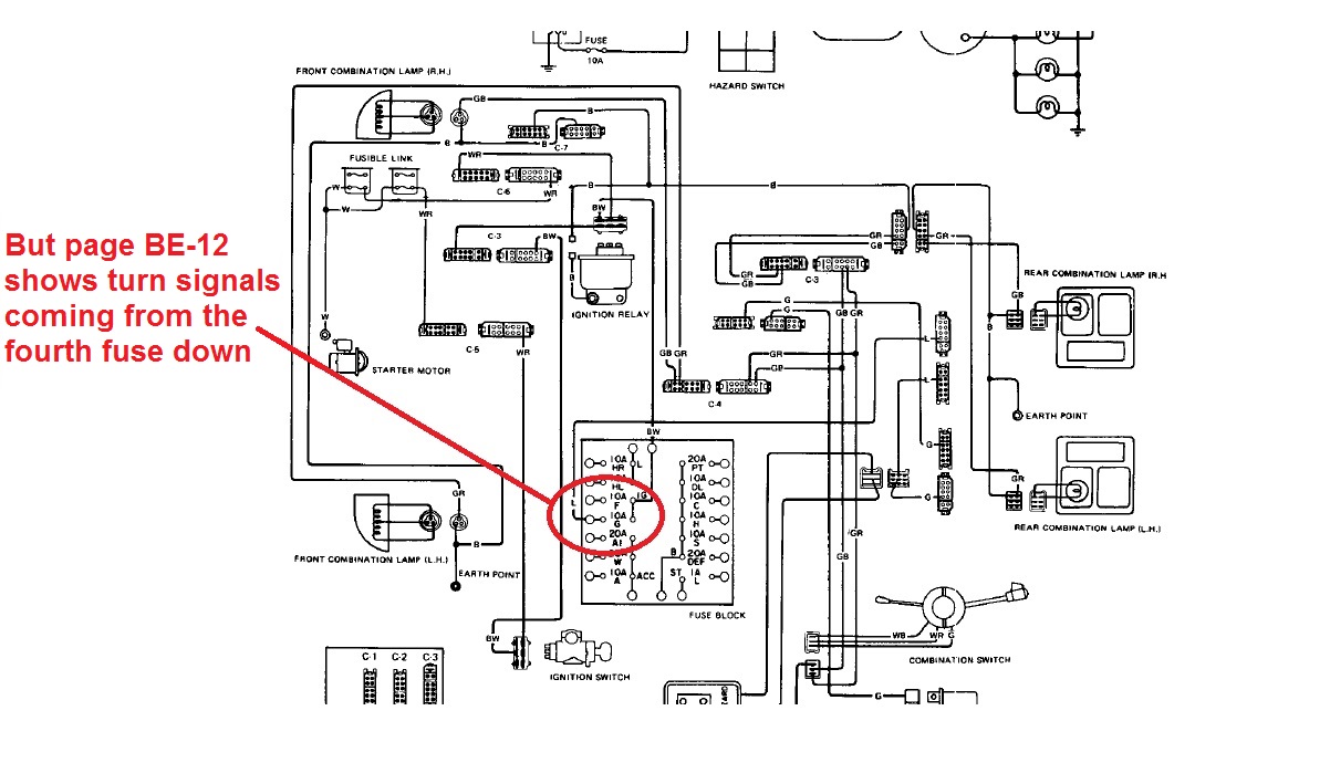

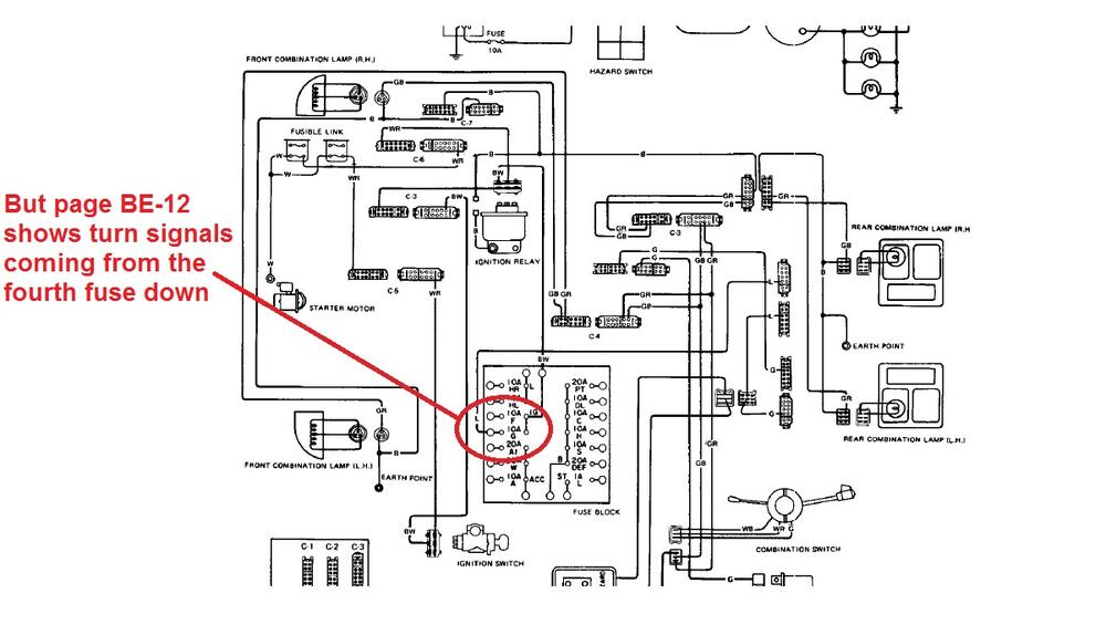

But then here's another snipped from the same FSM that details the turn signal circuit, and it uses a different fuse. According to this detail, the turn signals come from the FOURTH fuse down:
And important to note that the wiring diagram agrees... According to the wiring diagram from the same FSM, the turn signals come from the FOURTH fuse down.
So which is correct..... The parts of the manual that say third fuse, or the parts of the manual that say fourth fuse?
I sold my 76 otherwise I'd have an answer right now.  Should be able to pull the third and /or/then fourth fuses and see what happens.  I'm going to go with the BE-12 diagram is wrong.  The fuse box cover has a lot more expense invested in it.

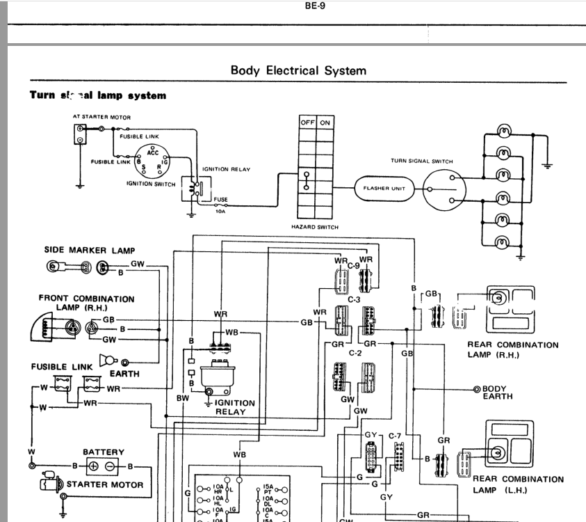

Does 77 have the same issue?  I've never been sure if there is a "real" 77 FSM available on the internet.  The ones I have downloaded look like 76 FSM's.
Actually, I just opened one of my 77 FSM's and it shows publication in 1976.  Which makes sense for 77.  And it shows turn signals on fuse 3.  So, it looks like the "76" FSM might be wrong.
Page BE-10 from the 77 FSM.  That's one of the beauties of the old Z cars.  So many layers to peel.  It's not just a sports car.
