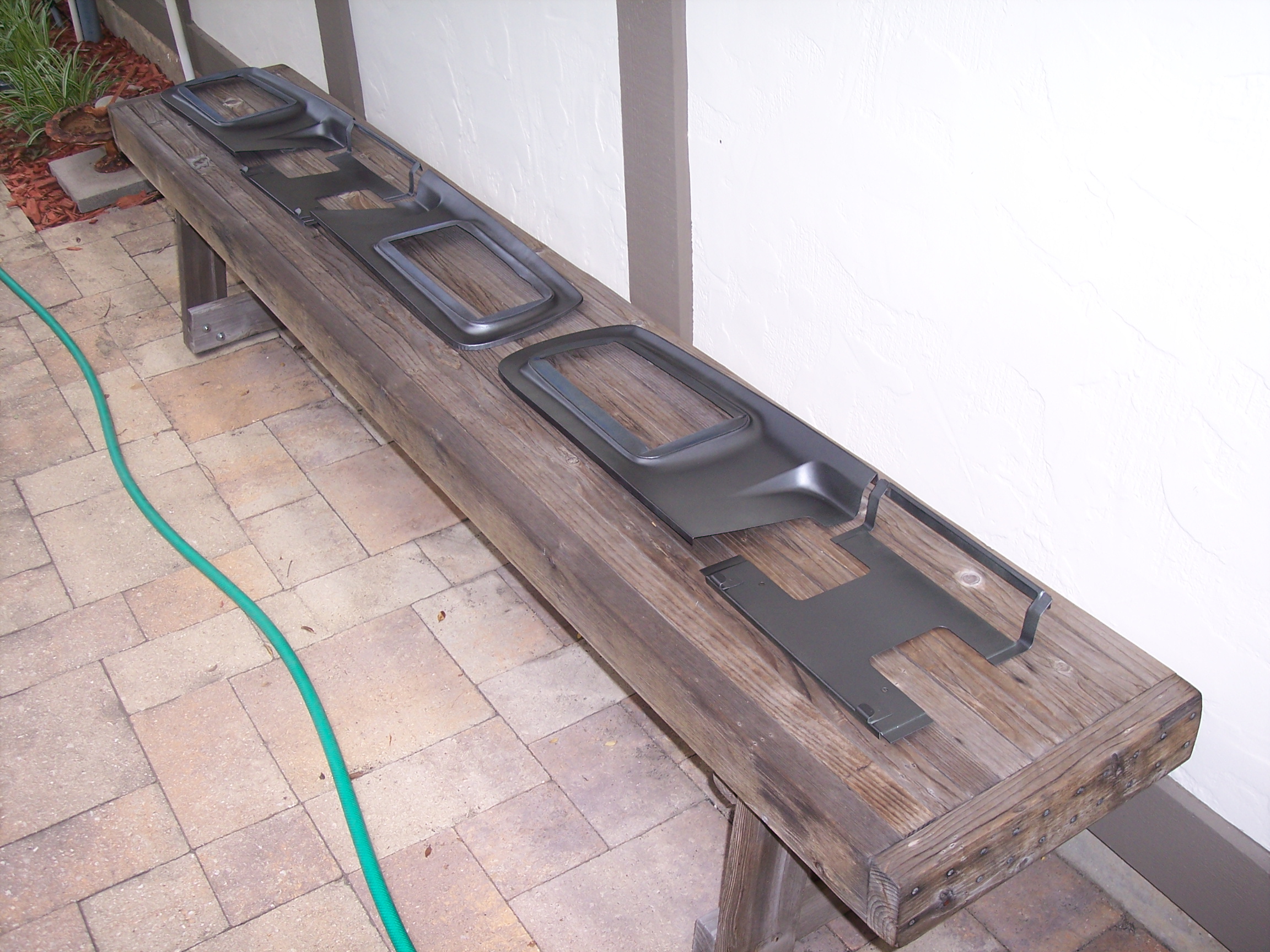

After weeks of rain we are finally getting some somewhat dry days (discounting Florida-quality humidity) and I can get a bit of painting done. Two sets of tail light panels got their first coat of Dark Shadow Gray today. One set is targeted for my ride to swap out the satin black set on it as part of the resto, the other set will hit the classifieds when complete. A grill to swap has been completed for some time.

The paint match was discovered by one of our fellow members. The color coat is Dupli-color BFM0360 Dark Shadow Gray, a Ford color. It is topped by Dupli-color Matte Wheel Clearcoat to eliminate the gloss of the color coat. All are spray cans.
You're welcome. LOL

6 hours ago, rcodyns said:
Looks awesome! Any special prep you did?
Oh heck yeah, lots of prep work:
Thoroughly clean both sides of the panels, fix any bends/dents/dings - sometimes requires multiple passes of filler primer and wet sanding, polish the stainless steel bezels, tape the front sides of the bezels. If the back sides have any surface rust: remove rust with light sanding, tape back sides of bezels, primer the back sides.
No sanding on the front sides until the bezels are taped and protected. Wet sand front sides, primer paint, wet sand primer, repeat as needed, color coat paint, wet sand, usually repeat at least once, apply clear coat, very lightly wet sand to remove any dust - just a kiss with the paper! Untape the bezels, wipe down with soft cloth, grab a beer to celebrate! :beer:
