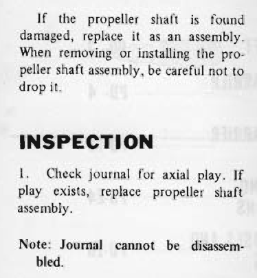

Progress slowly continues on our resurrection project.  The driveshaft is now removed and I would like to replace the u-joints.  40+ year old car that has not been on the road for over 20 years.  The joints are staked in and the repair manual says entire propeller shaft must be changed.  I have found 2 different catalog listings for u joints with different cap diameters, one of which comes with no hardware, clips-the other comes with clips.  I have not yet accurately measured the existing u joints for size yet but looking for some input from the more experienced Z experts here.  The Spicer brand u joints for the drive axles installed perfectly, just hoping to be able to do the same for the driveshaft.  I have also seen a listing for a center support bearing on the driveshaft but it does not appear there was ever one on this car, but there does appear to be a place to mount one at the front.  Thanks in advance for the help.  Just hate the idea of having 40 year old, I am sure deteriorated grease and u joints , in an otherwise good, undented driveshaft. Thanks, John-Lugoff, SC.

The propeller shaft u-joints are "staked" in.  They don't have the clips like the early Z shafts did.  Nissan made the change in 74 or 75.  There are shops that know how to get them out and convert them to clipped u-joints.  But you have to find the shop.  Or you can source a 240Z shaft.
Some research found that Rockford Drive Lines 815-962-1411-has developed a whole series of u joints for the many vehicles that have staked in, "non serviceable" driveshafts.  They have a very informative website, but the installation instructions are a bit generic in nature.  According to the specifications as well as the vehicle application chart found on their site, the staked in Z models can be replaced with #430-10 which includes the inner retainer clips and the grease zerk that is installed in one of the caps.  The specs are listed in standard sizes.  .867 cap size which is 22mm and the lock up dimension of 1.4.  Measuring my joints and yokes reveals an exact match.  I will keep you posted on the progress which will be slow.  My wife is having major surgery-spinal fusion-next week, and that obviously will be my top priority along with my job in the coming weeks.  We are just trusting the LORD for the whole outcome and recovery.  Hope this info may be a help to some others with an actual part number and reputable supplier.  Thanks, John-Lugoff, SC.
