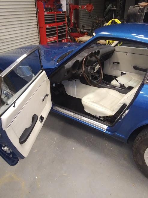

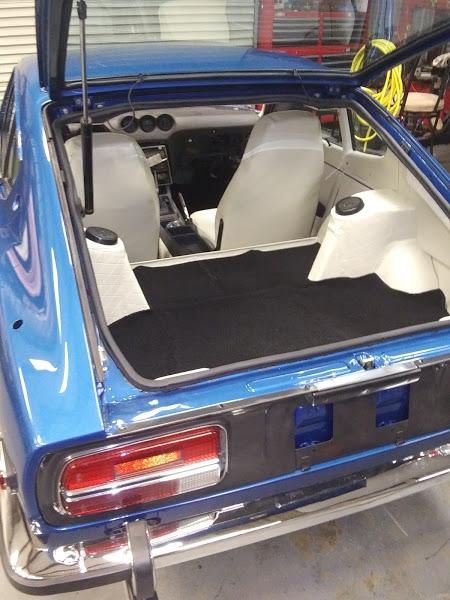

The sills were a thick, black, heavily-grained vinyl. The kit that I bought from MSA was much thinner and non-grained vinyl. I had carefully removed my originals, cleaned them up and am glad I did...! I returned the set to MSA and am very happy with the result. Your car had diamond vinyl on the transmission tunnel, the vertical surface behind the seats, the wheel arches and the rear strut towers (6 pieces). The transmission tunnel had jute padding underneath, the other pieces were adhered to the metal without padding. The diamond vinyl kit from MSA is VERY authentic. It is made by SEATZ Manufacturing and I cannot speak more highly about the quality. I chose to use a very thin (1/16") padding under the wheelarch and strut towers with excellent results. I also filled in the depressed areas of the luggage riser panel behind the seats with 1/4" foam...again, excellent results. I used 1/8" foam under the transmission tunnel and it turned out great after smoothing some of the original sound deadening material with a small disc sander. Original carpet was a nylon loop with whip-stitched edge binding. I bought the 5 piece kit from MSA. The edge binding is somewhat loose and I wonder what Newark's is like. I also like their 7 piece configuration, while not original, it provides pieces for directly under the seats. Carpet kits are available that eliminate the diamond vinyl all together and it is your choice as to what direction to go. I love the diamond vinyl and paid the price for professional install...well worth it in my book. All the best...Ryals in Ellijay, GA
