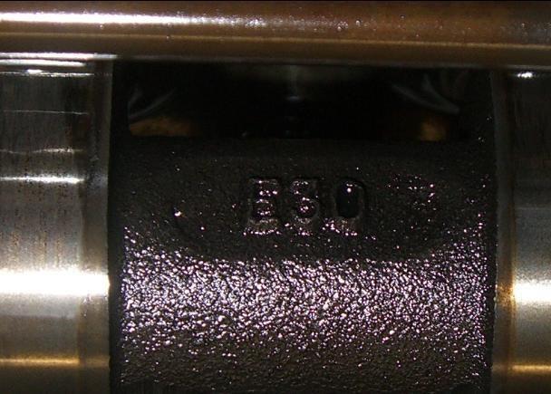

The premature wear you've heard of happens on they're new cam billets from all I read before ordering mine. You have to send in a original Japanese core with "E30" stamped on there. Like this...
trying to identify my cam (pics included) - Nissan L6 Forum - HybridZ
If you do buy that cam make sure it has this stamp, in my opinion, or I wouldn't trust it.
