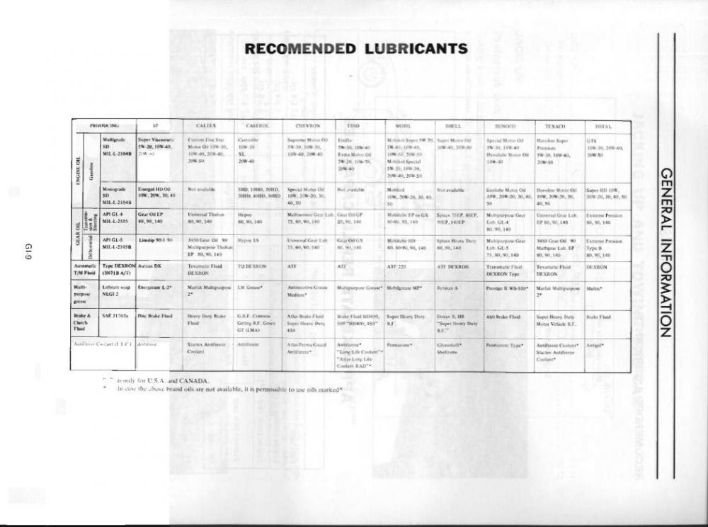

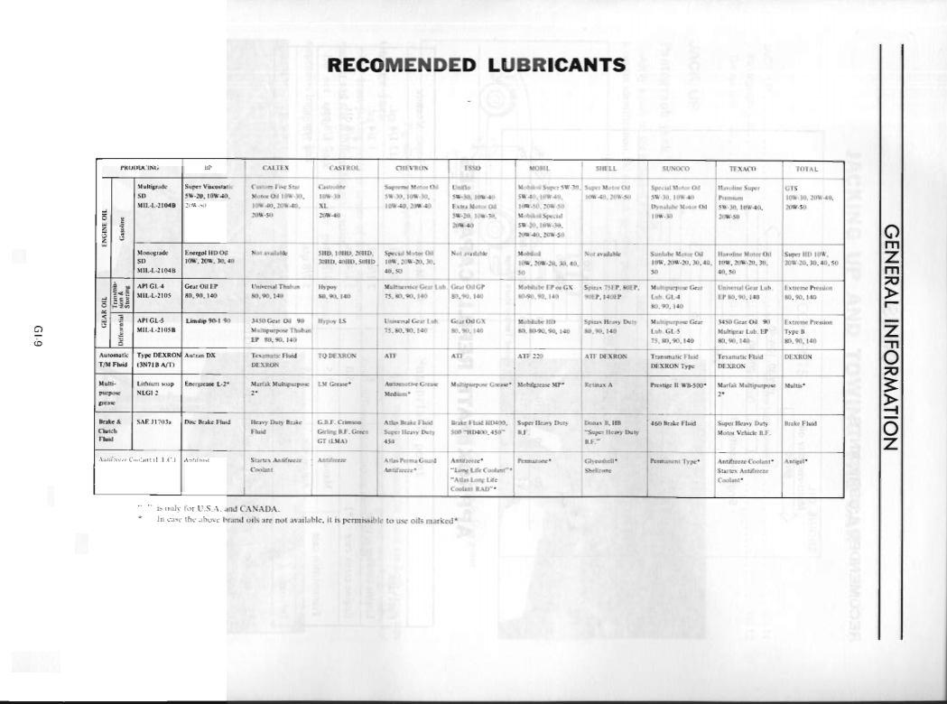

Meet or exceed the SAE spec. (from the FSM)
From the 73 FSM - Dot 3
+1 on DOT 3 for the brakes and clutch.
