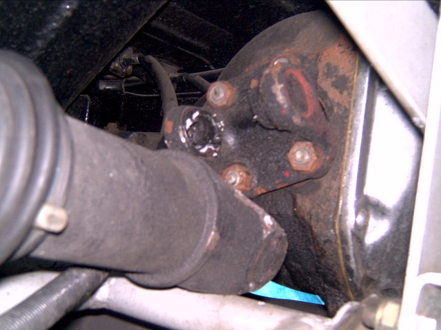

I had a look at the photo's of under your car and can almost be 100% positive there the 280zx CV unit's on there.
It's pretty hard to explain the differences but if I can find some photo's of what halfshaft uni joint type look like I'll upload em'.
Must be putting out alot of torque to bust those up, so what's it like driving a v8 Z as oppose to the inline 6?
The closer zoomed in shot of your car has changed my mind they are Uni joints which is a good thing because I don't know what you'd do if you were busting up CV's :).
Anyone else wanna confirm this?
Hey Gav. You are right, they are Uni's. Here's a photo.

So how much are one of these Uni's?
George the good news Uni joints are cheap and the halfshaft ones are easy to remove and replace no problem.
I remember paying $20 each for them the hard part is removing them but yours are broken so they might pop out.
I've never upgraded to the CV's but I believe they need to be shortened to adapt to the early Z's.
I think someone mentioned something around the $200 mark to me but I can't confirm this...
