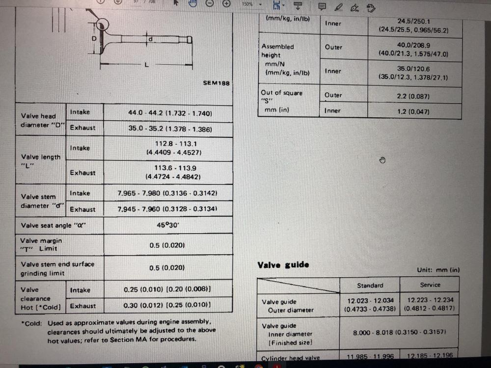

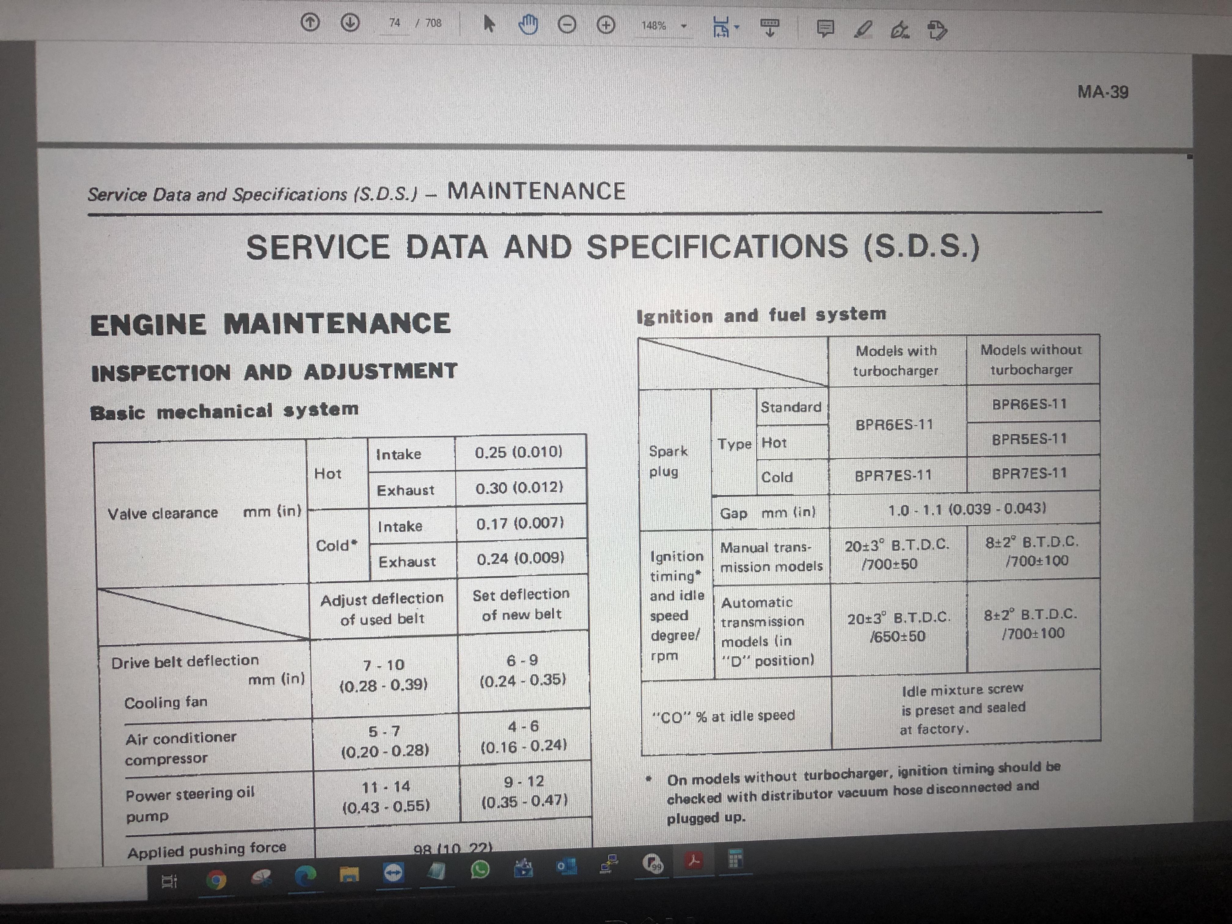

replacing inj#6 didn't make it run any better though.  so i moved on to checking the valves and noticed several exhaust and intake ones extremely tight.  The service manual indicated diff values on diff pages.  for example, on one page it said .008 & .010 when hot.  then few pages its said .010 & .012 when hot
i went with 10 & 12 since they were really tight.  i think i was barely able to fit a .007 feeler.

For the valve clearance, I would go with .008 .010 for the cold setting if you have the solid lifter head.
