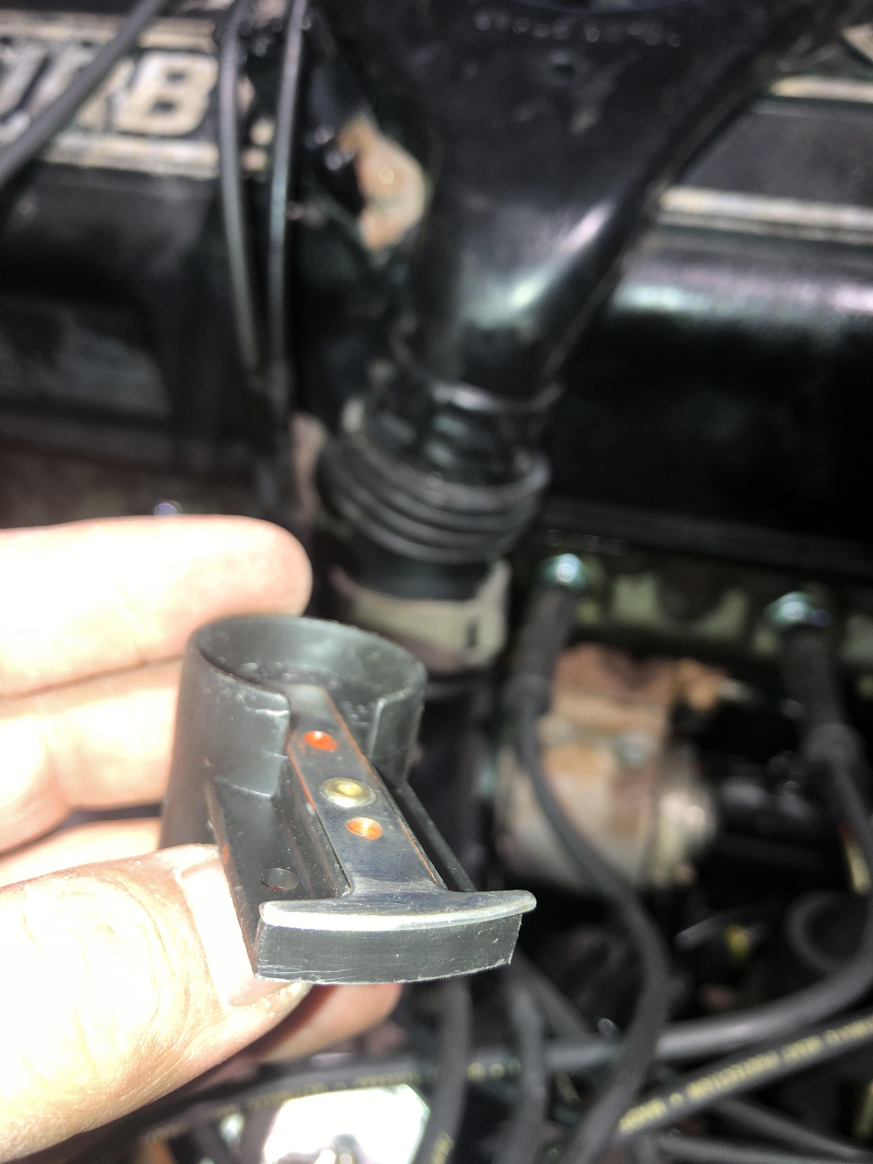

yeah, i forgot to mention that i did take it apart.  i cleaned up the little corrosion under the seal plate.
New NGK sparks plugs. don't know what spacing they need to have so i compared to old ones.

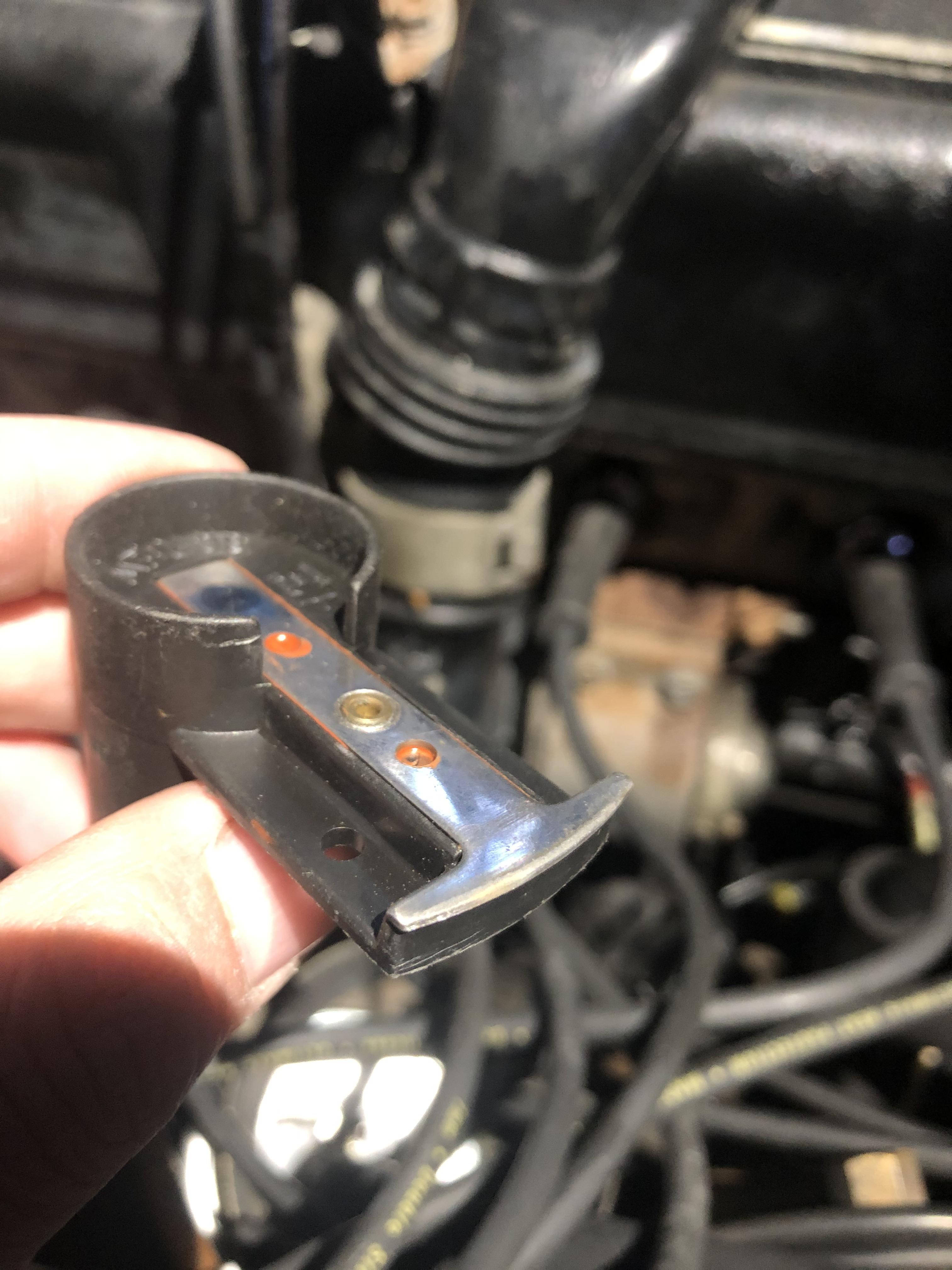

Rotor is firm, hardly has any up & down movement.  i did use a very fine sand  paper and gently scrubbed the tip to get rid of any accumulations

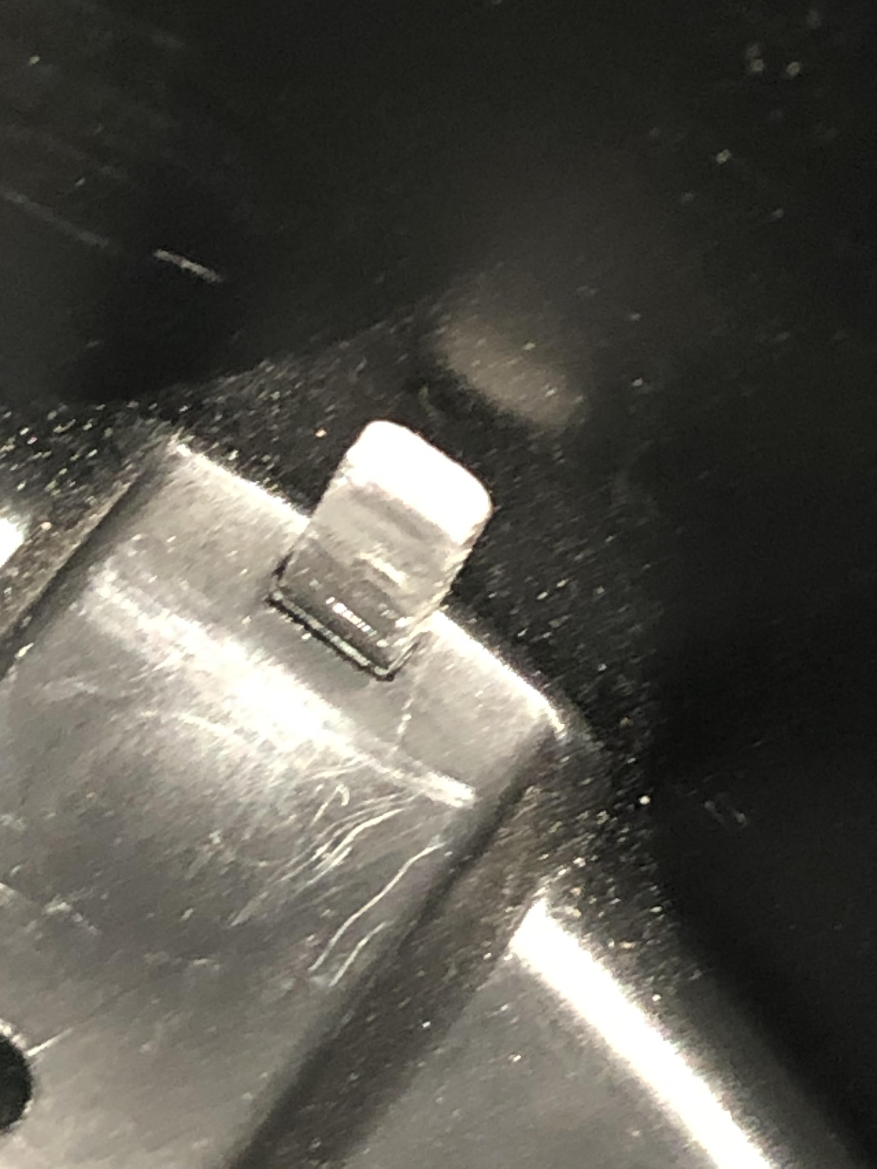

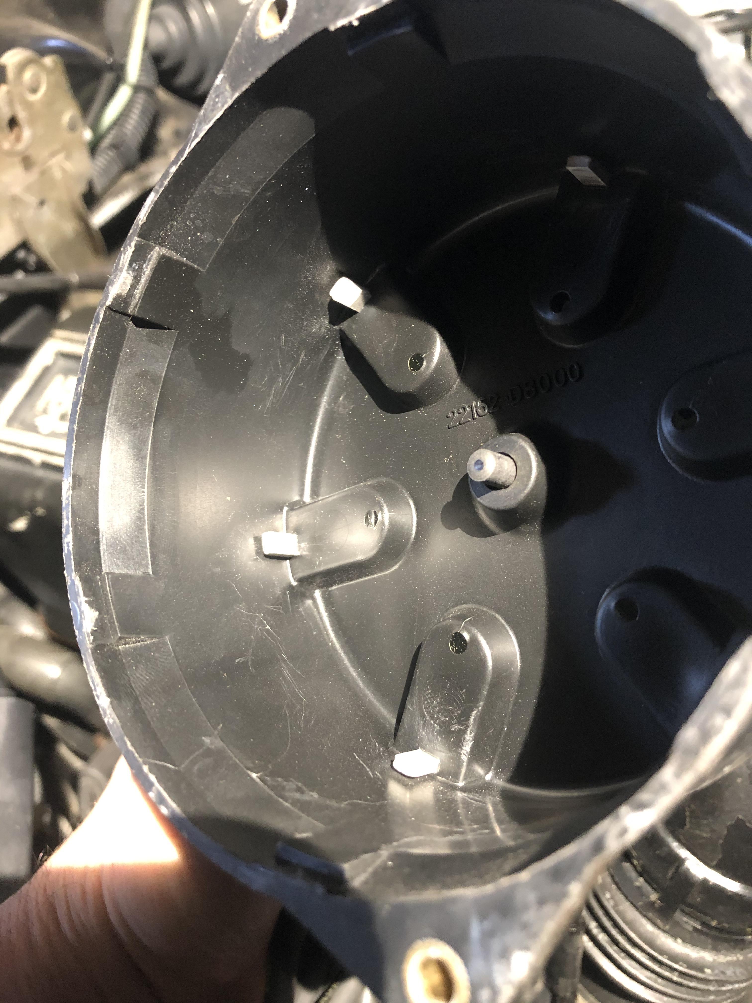

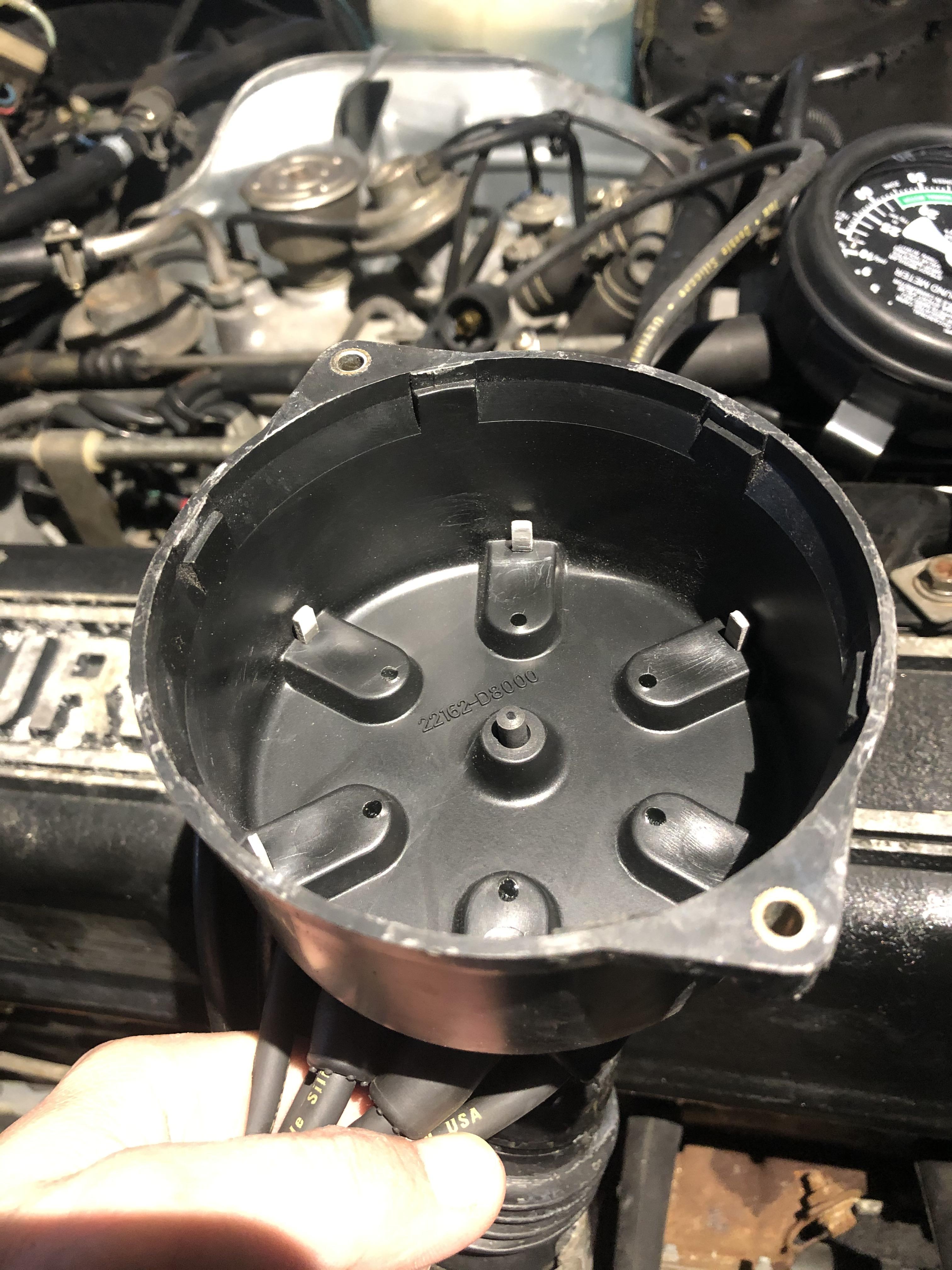

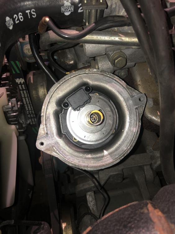

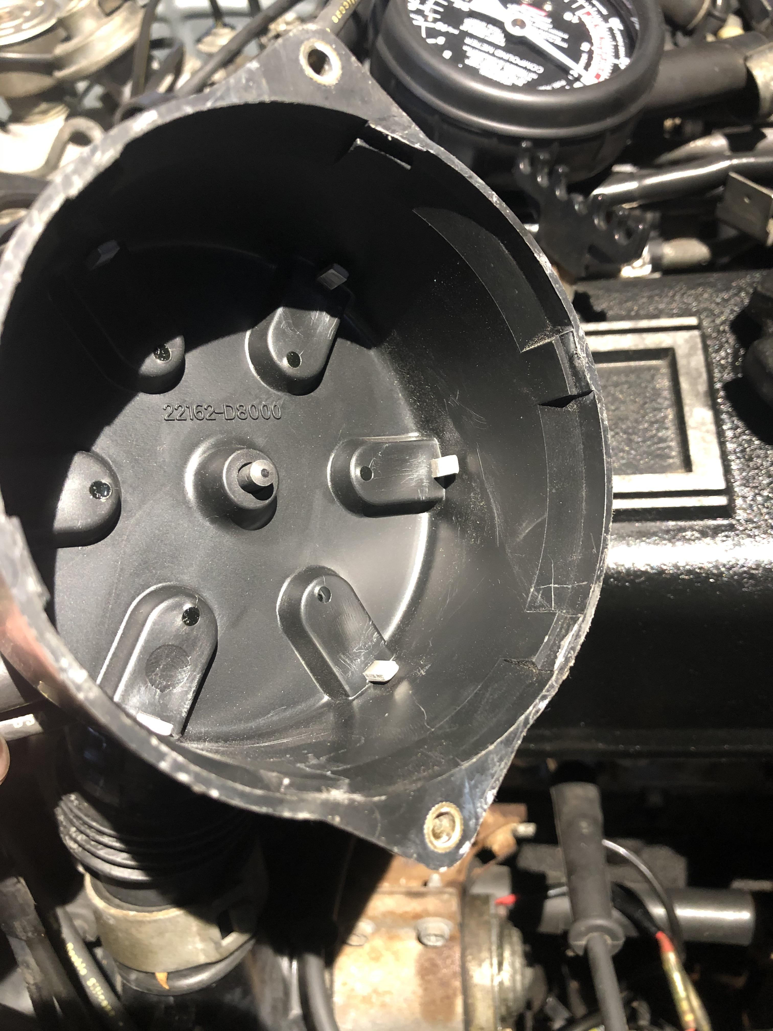

here are some pics

that cap looks a bit beat up from the rotor, maybe that is normal.
may as well put some spacers in there and run it with the cap up since that solves the problem. Looks like some alum dust sprinkled around, maybe enough to provide a ground path same as a carbon track?

Make sure you check the other odd things like the main wire from the coil to the distributor cap.  Things that move when you raise the cap.

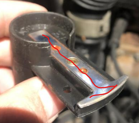

Seems like there's a lot of crusty stuff floating around in there.  The spark can jump anywhere along the path on top of the rotor.  When you raise the cap you move the rotor away from places to jump to.
I might try a piece of electrical tape on top of the metal as an insulator, just for an easy test.  Overall though, a simple tune-up with new parts might be the way to go.  The old pocket knife electrode scraping might not be good enough.
