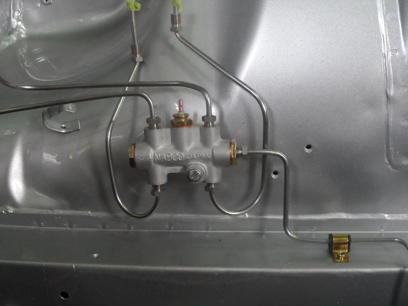

Here it is on a Z in case you visual learners need a picture.

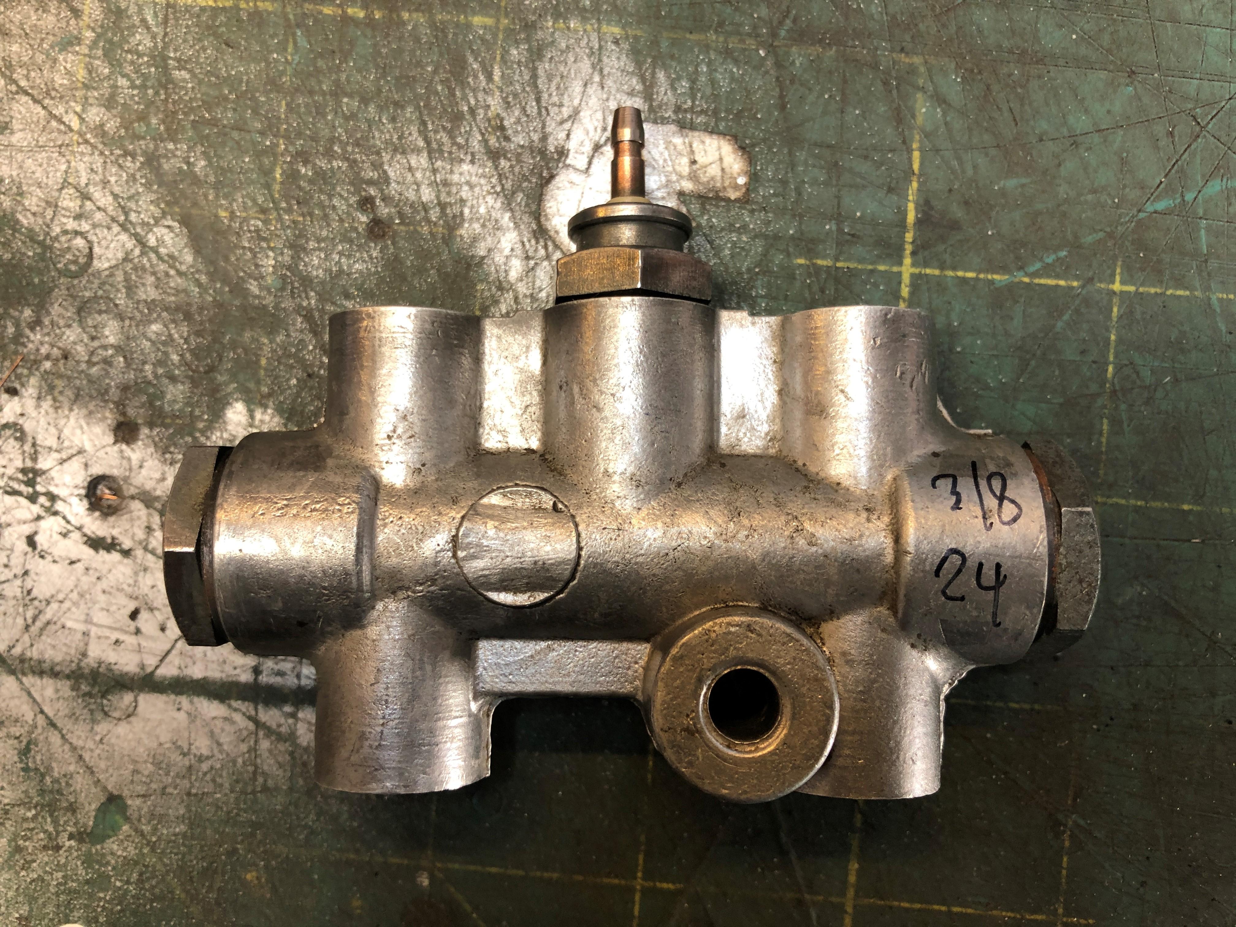

Here is the one he brought with him from his Roadster. I was questioning whether perhaps his ancient beast used DIN flares or some craziness and that might the source of his leakage, so he brought an example for me to examine.
Looks da same to me as our Z part, right?  We use the same one a 510 and I'm sure many other models, right?  WRONG!!!!
The tube nut threads on this abomination are some SAE nonsense, yikes 3/8-24!!  Yes the horror of it all. SAE parts on a Datsun. As if having SAE seat belt bolts isn't enough of a embarrassment for most Datsun owners already.
Now this comes as no surprise to any Roadster owner I'm sure, as they preach that the front half is SAE and the back half is Metric. Talk about fake news!
Anyway, some day, some kind hearted Roadster-owning soul may offer us unexpecting trusting Z owners his spare "Switch-Brake" when we are at our most vulnerable, stuck on the side of the road (in Podunk Kansas of course), and yee shall be sorely disappointed and down hearted should you attempt to install it. Ensure he attempts to thread in both M10x1.0mm nut and a 3/8-24 before bothering to send it.
It is true what is written...    46100-26001 is not the same as 46100-U5200
(maybe the insides are the same, doubt it though!)
You've been warned, my job is done here. Go forth and merrily forget this nugget of truth.
