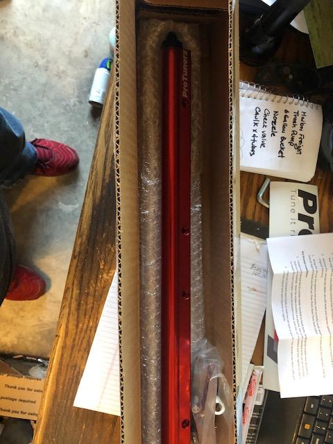

October 3, 20204 yr Author comment_607091 So a little more stuff came today. The fuel rail from ProTunerz in Canada. Nicely finished piece. Link to comment https://www.classiczcars.com/forums/topic/64413-just-another-damned-z-car-project-thread/?&page=5#findComment-607091 Share on other sites More sharing options...
