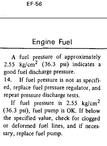

October 7, 20204 yr comment_607342 Make sure that your gauge is good, maybe doublecheck with a different one. But, yes, pressure is supposed to be about 36.3 (actually 2.5 bar, converted). Link to comment https://www.classiczcars.com/forums/topic/64412-1977-280z-prepup-for-smog-check/?&page=6#findComment-607342 Share on other sites More sharing options...
October 7, 20204 yr Author comment_607352 Look like need to pull the whole fuel rail and injectors to replace the regulator.  Say, will the fuel rail and regulator of 1978 works?  I might have access to that set.  For sure the regulator of ‘78 won’t fit ‘77 but I might be able to buy the complete set. thanks and regards  Link to comment https://www.classiczcars.com/forums/topic/64412-1977-280z-prepup-for-smog-check/?&page=6#findComment-607352 Share on other sites More sharing options...
October 7, 20204 yr comment_607354 A 78 rail with regulator would swap right over, bolt-on. It's actually a better rail it has fewer hose connections. But you should be able to change the FPR without removing the rail. Cut the hoses to get it off and slide the hoses back and forth to get it on. But, again, if you have the old hoses on your 77 it might be a good time to change them, so the 78 rail would be a good option. Always more work to do and decisions to make.  Edited October 7, 20204 yr by Zed Head Link to comment https://www.classiczcars.com/forums/topic/64412-1977-280z-prepup-for-smog-check/?&page=6#findComment-607354 Share on other sites More sharing options...

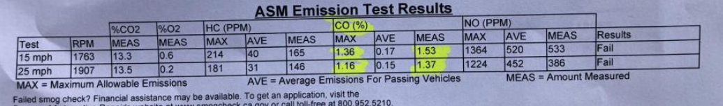

October 8, 20204 yr comment_607449 He's in CA where they do the rolling 15 and 25 mph tests. The idle air bypass probably won't help much, I'd guess. He's so close, I'd bet that an FPR that has correct pressure would get him in spec. 40 psi is 10% high. Whenever I worked on my car to pass emissions (idle only) I would get CO and HC numbers that were much higher than he's getting and could get them to drop with small changes in fuel pressure (I had an adjustable FPR). He just needs a tiny change to get his CO numbers down I think. Tiny. Maybe, in the same vein as the idle air bypass, he could just open up one of the vacuum ports on the manifold. Maybe the one for the heater controls. The FPR is probably more effective though. Edited October 8, 20204 yr by Zed Head Link to comment https://www.classiczcars.com/forums/topic/64412-1977-280z-prepup-for-smog-check/?&page=6#findComment-607449 Share on other sites More sharing options...

October 8, 20204 yr comment_607461 just for grins, remove the fuel return line for the metal hard line that goes to the tank, and just have it dump into a container. then to a engine off pump on test (solenoid disconnect, ign key to start) get a reading see if you still have 40psi. want to make sure you don't have a restriction in that return line to the tank. Link to comment https://www.classiczcars.com/forums/topic/64412-1977-280z-prepup-for-smog-check/?&page=6#findComment-607461 Share on other sites More sharing options...
